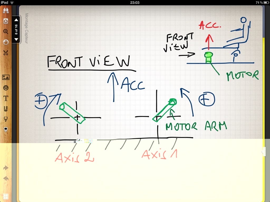

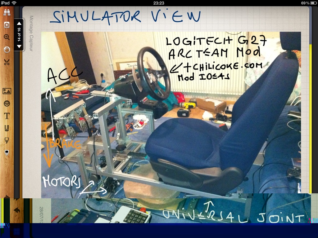

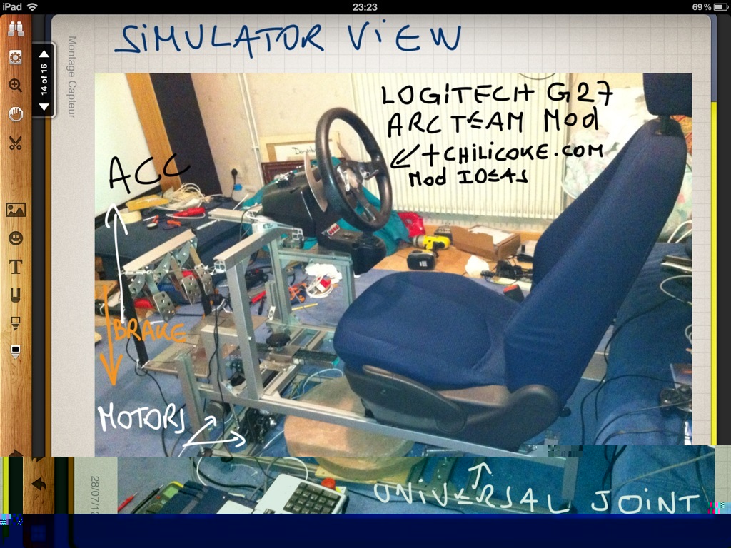

First of all a sketch from my simulator.
Sketch

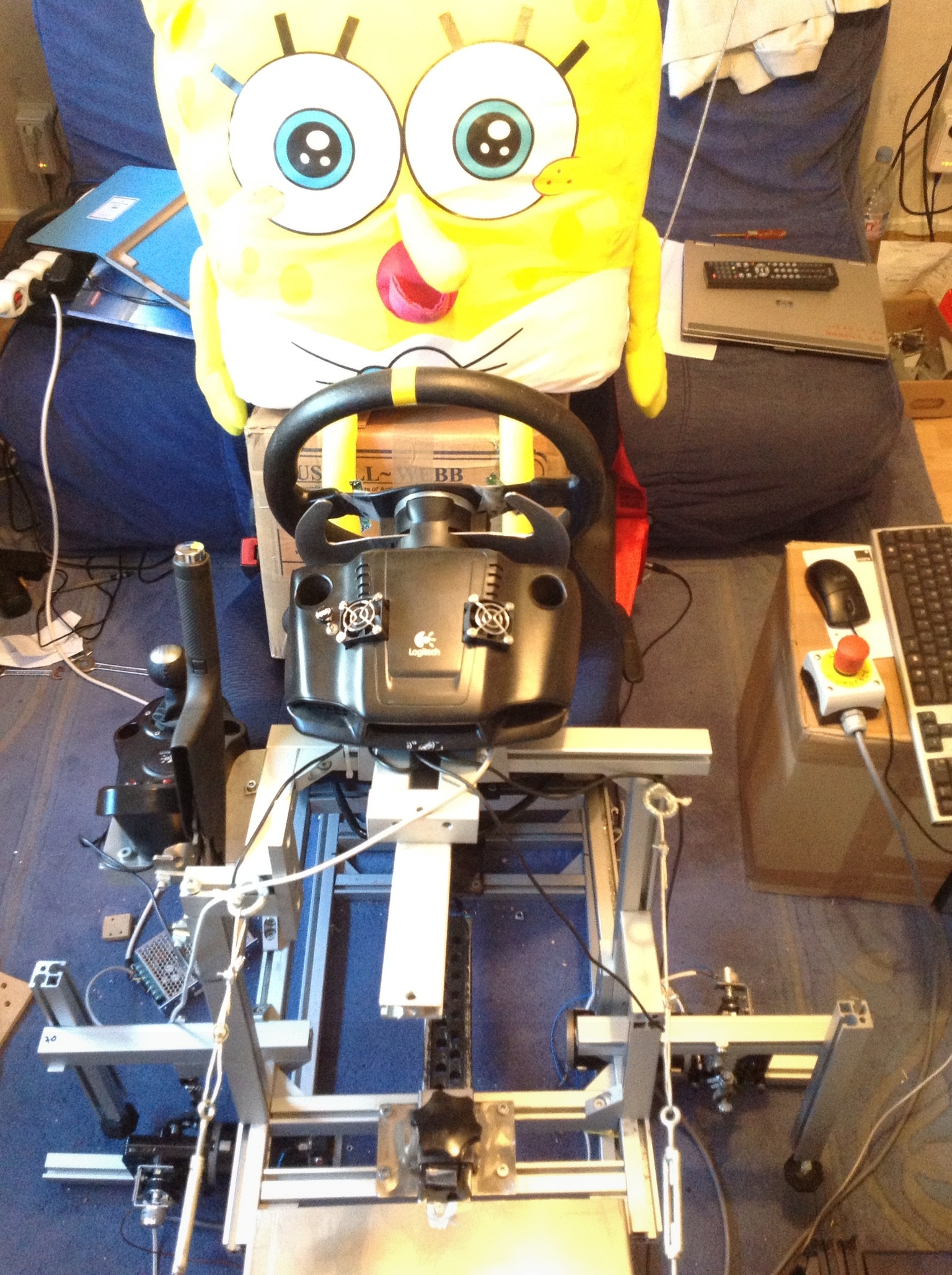

A real photo from the simulator.
Real simulator
Chilicoke web site for modding DIY your G27
http://www.chilicoke.com/mods.htm

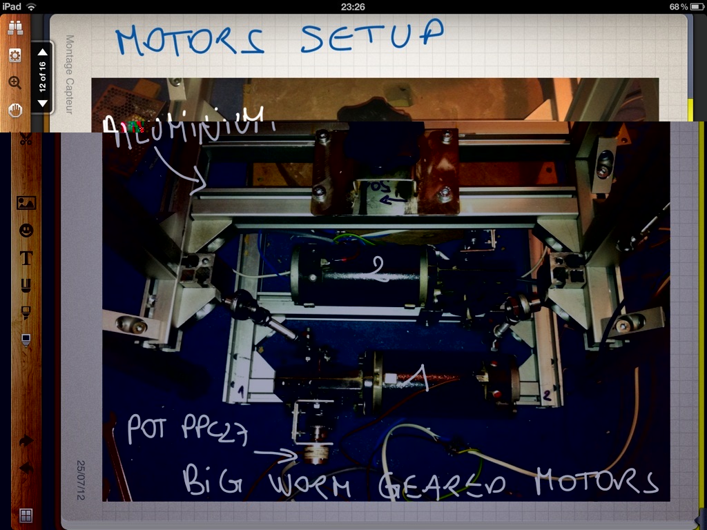

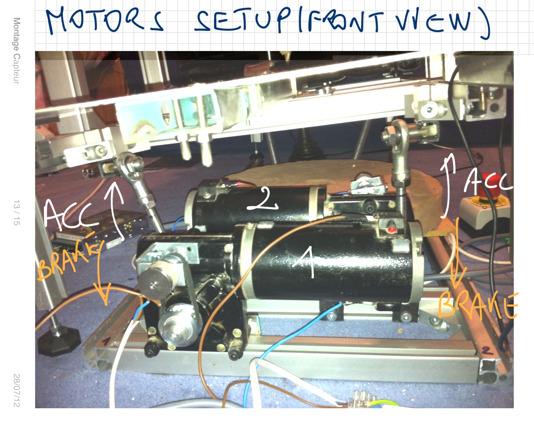

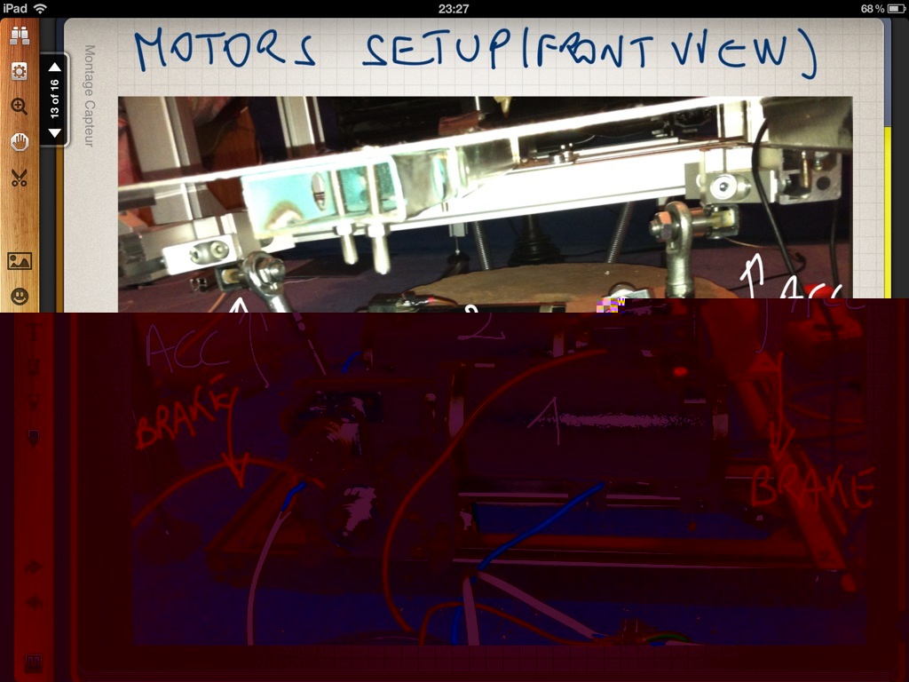

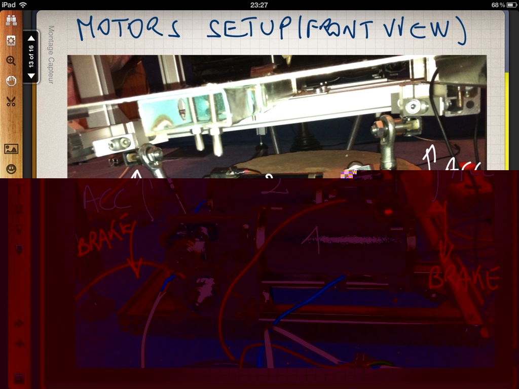

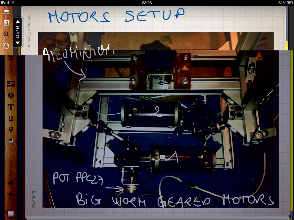

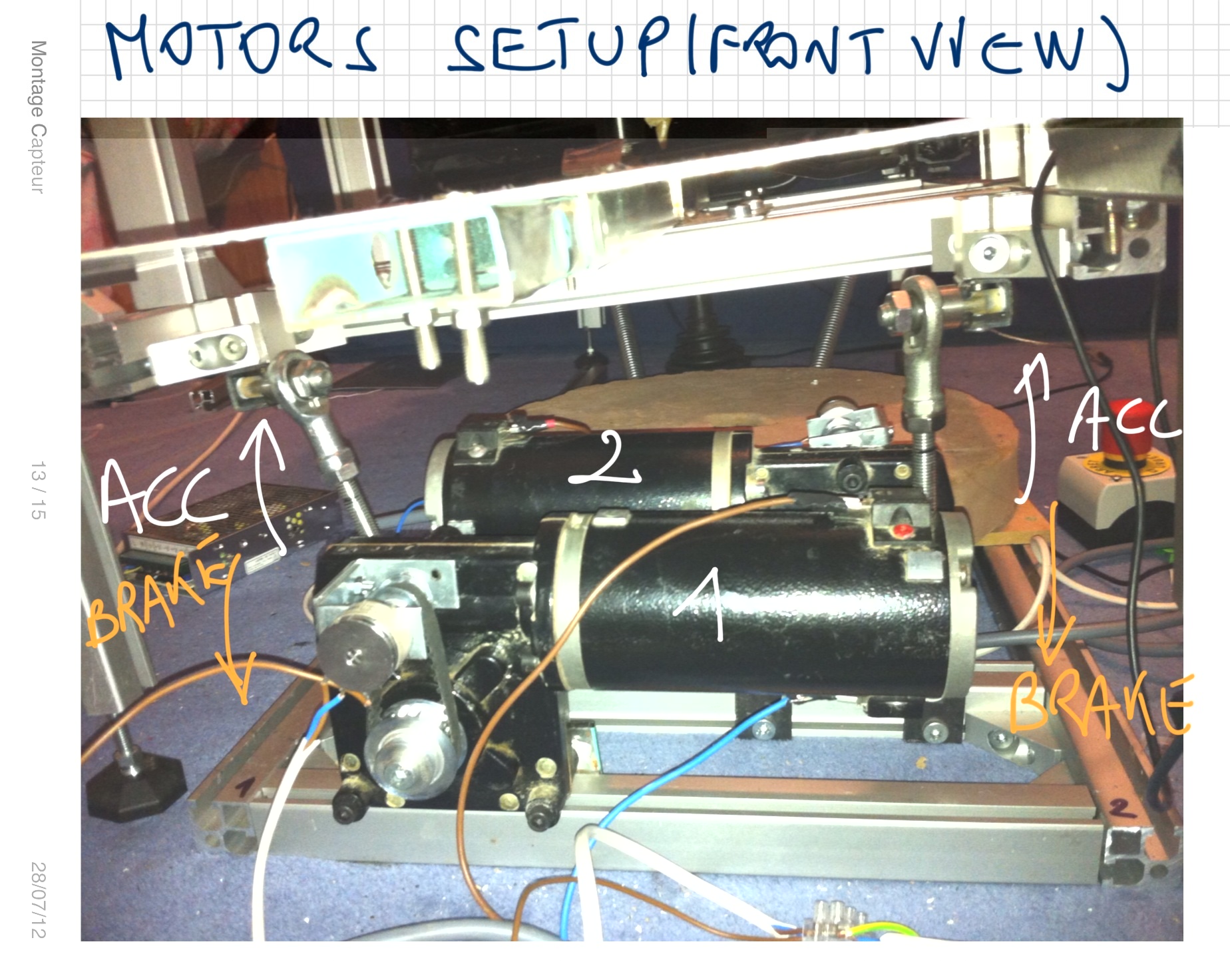

The motors are bigworm (12v 180 Watt), which mounted in front side of the simulator.
Photos from the motors.
Bigworm
Bigworm2

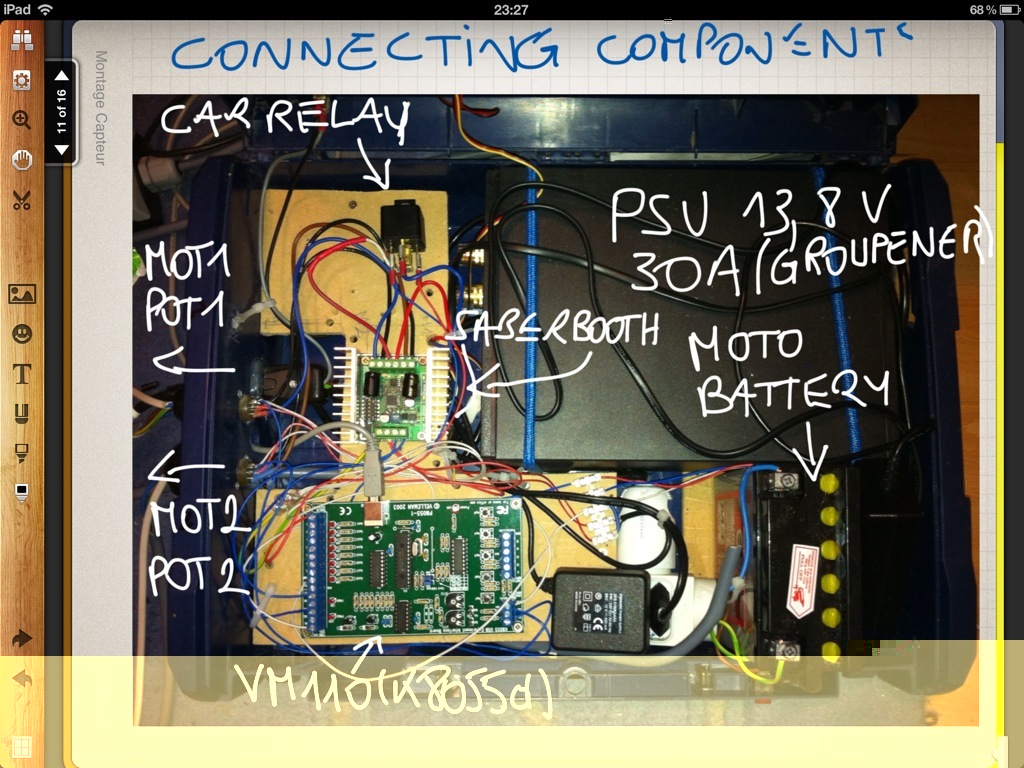

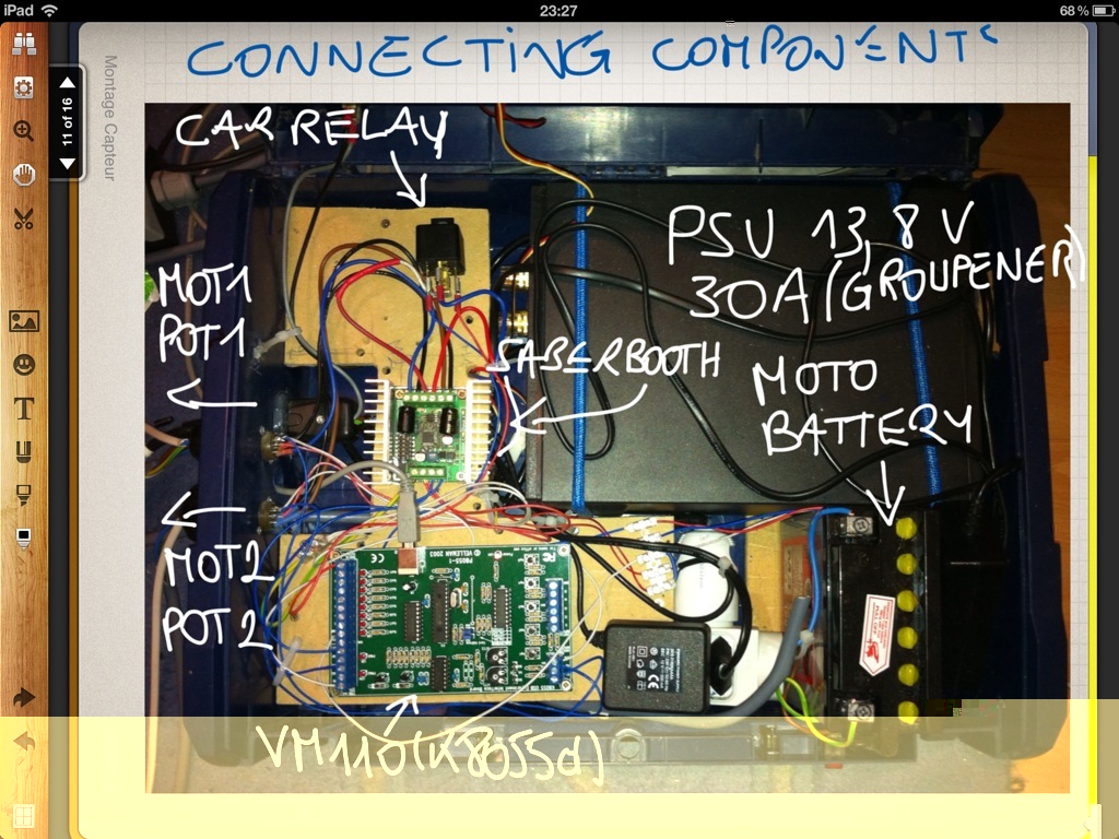

For connecting all these things , you will find a picture .The main problem with this configuration happen when xsim shutt down if the motors are always powered.Even 0 volt comes iin sabertooth the motors start unexceptly.To avoid this problem , you just have to connect a simple car relay (12v 30A) in the Psu ground.To obtain the relay communtation you have to use a digital output from the k8055 and a little psu (domestic material charger) with 9 volt!You must write in synaptrix in each sequence block a line which say to commute in digit 1 the Output choose.When a problem happen (xsim stops) ,the digital output changes to zero and the relay cut the power. :lol:
I post below a youtube video showing this configuration.
Connection

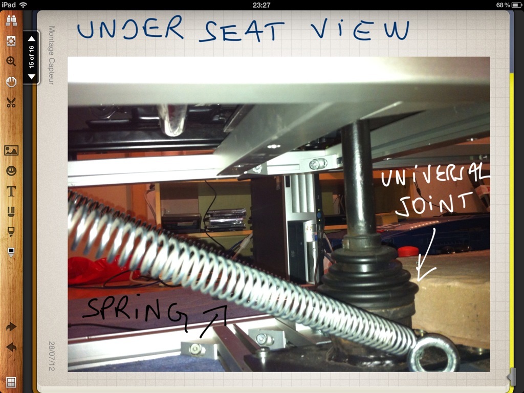

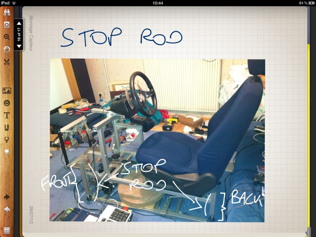

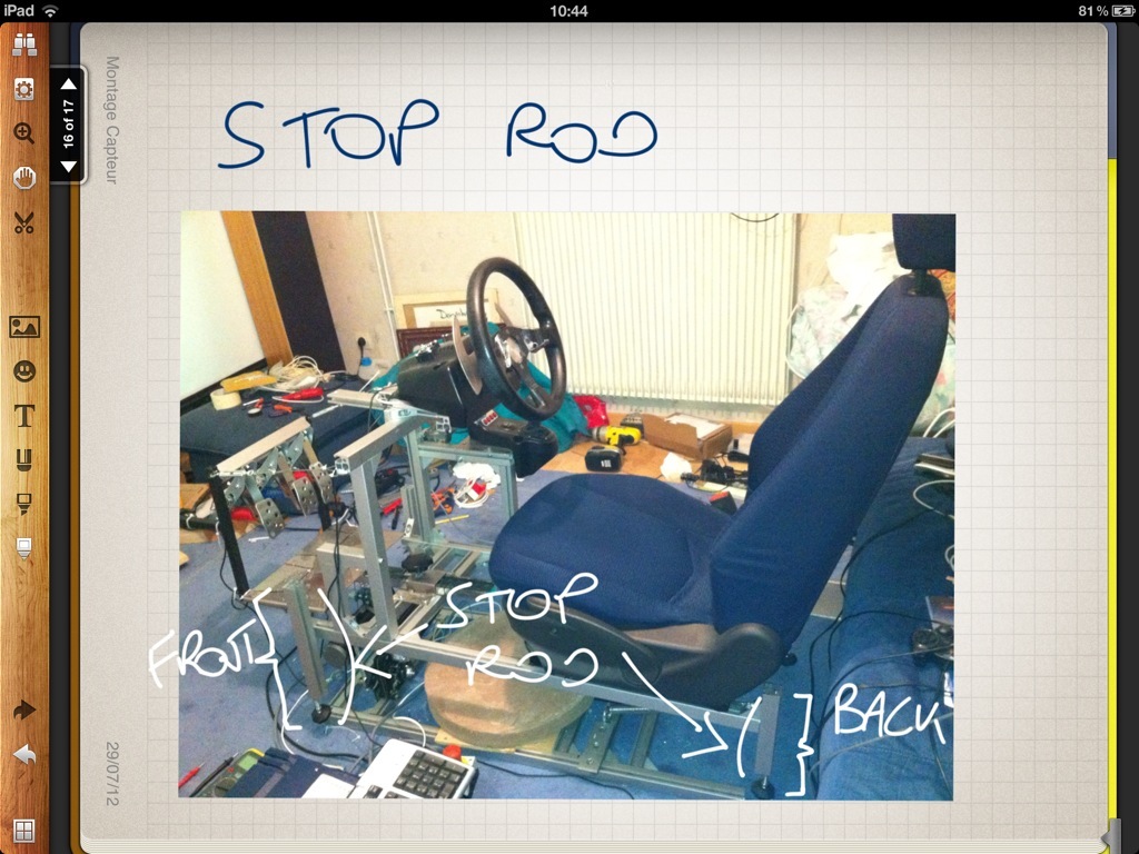

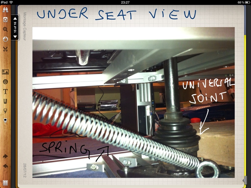

Under the seat I mounted springs which helping the motors (full load more than 100kg).I puted in the alumium structure for my seat stop rod (2x2 legs)for in case the motors can't support the weight with dynamics effects.That prevent that I crash out from the simulator. :shock:
Under the seat:
Under seat
The stop rod front and back:
Stop rod
Finally you can watch a little sequence from my son triyng to stay on the seat ! ;)

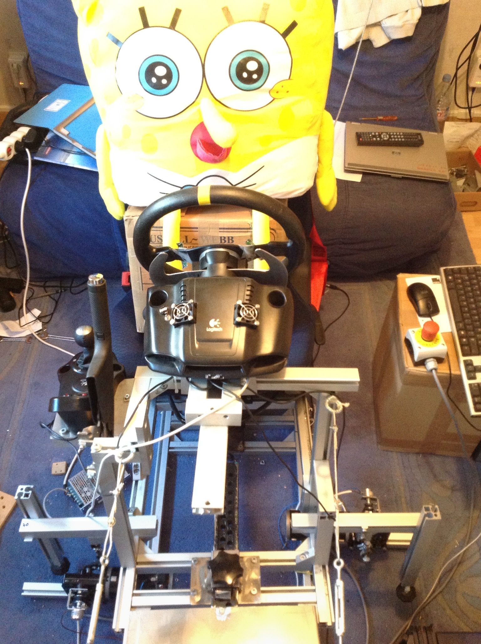

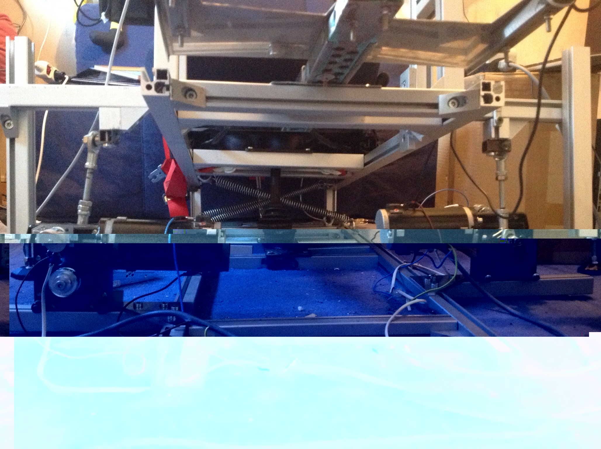

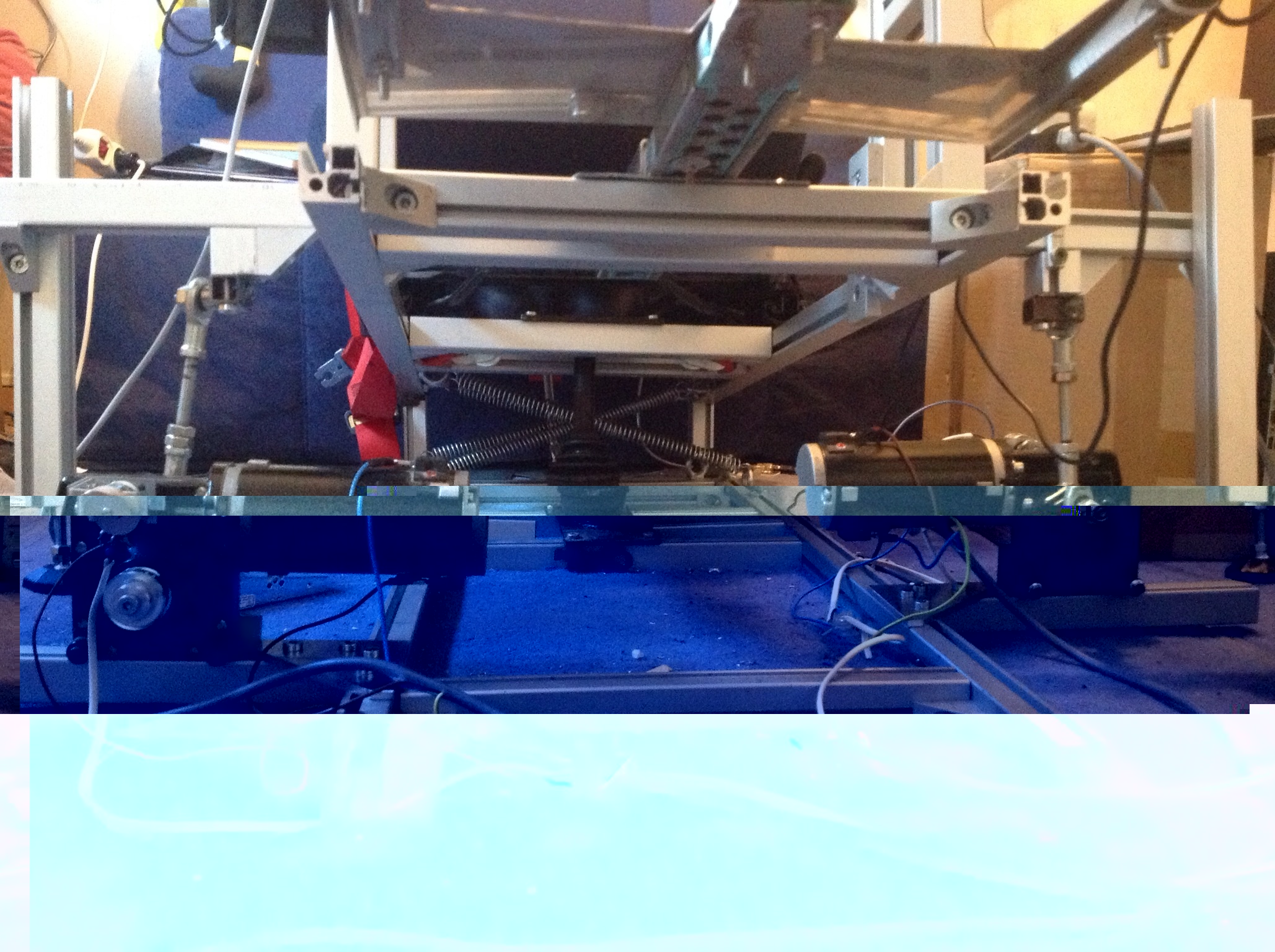

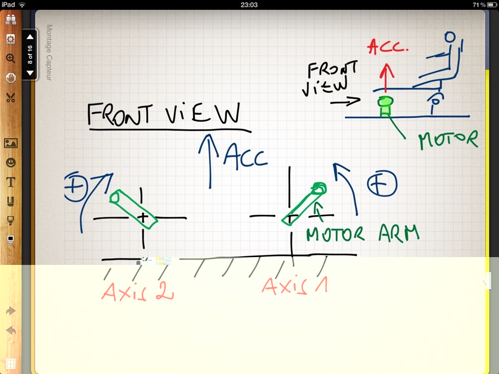

UPDATE 2/11/2012
After several weeks I decided to change the motors position because with lateral effect I didn't have enough stability(I was ejected from my seat :D )
I didn't change the position motor 90 ° reference to the axle simulator.The reason is that is this position with lateral effect all the forces are supported by the ball bearing gear shaft but only radial forces not axial force.If the motor would be in axle simulator in case lateral effect some forces would be supported in axial direction which was not good.
Some pictures:
Before
New layout
After: new layout
Bob is driving

Hi Motiondave,
Look the first topic and the 4 pictures after UPDATE 2/11/2012. I increased the distance between the 2 motors .With this modification the simulator is much more stable.
I will put the picture before and After to see the difference.
Re: 2dof k8055d + sabertooth
Postby motiondave » Sat 3. Nov 2012, 00:53
vicpopo wrote:
motiondave wrote:
vicpopo wrote:Hi everybody,
I made modifications on my simulator which improve a lot the stability.Look at the main page
Best Regards
ummm...cannot find it?
Hi Motiondave,
