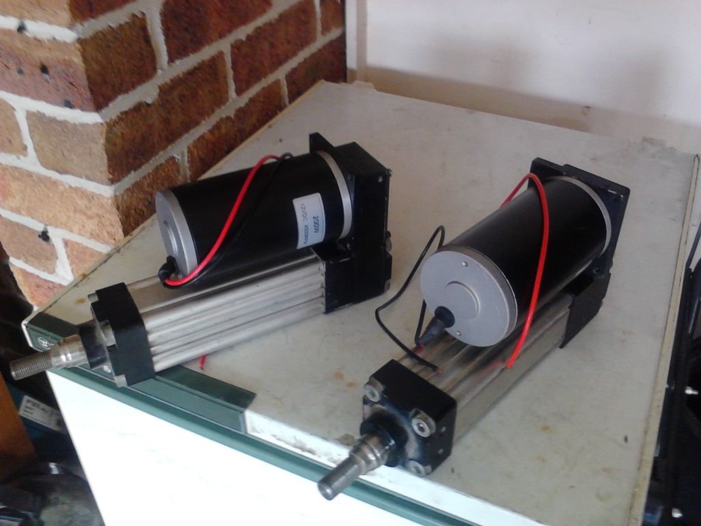

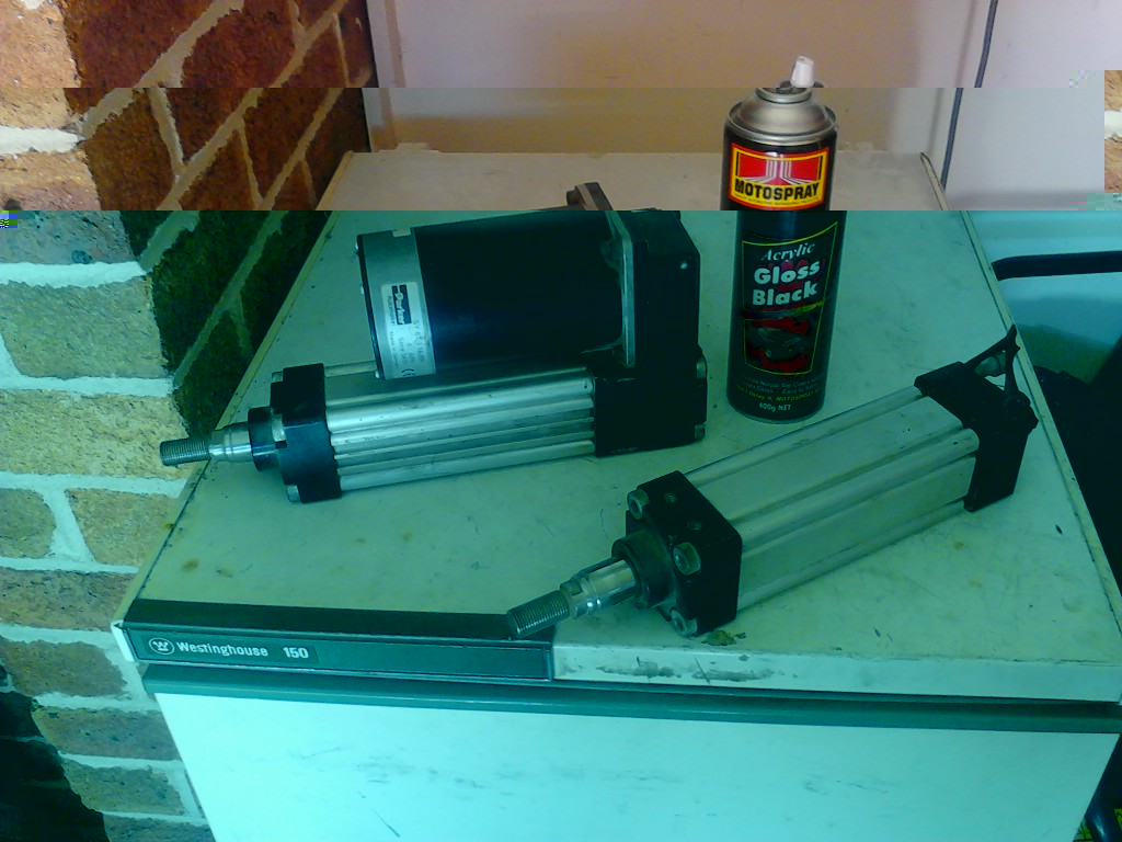

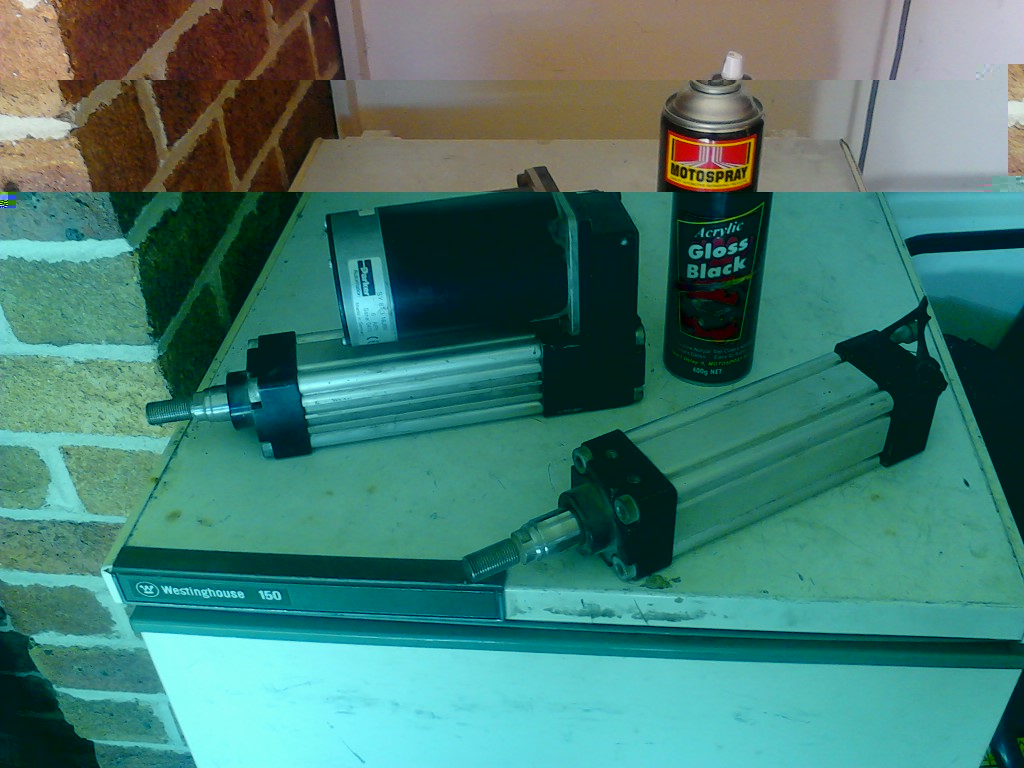

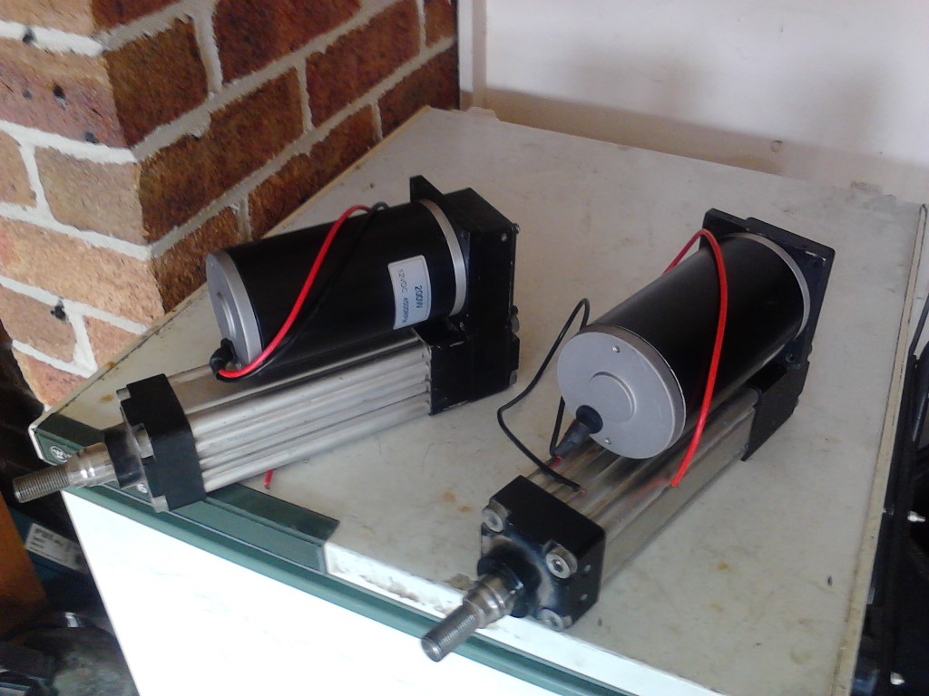

Heres the size of the actuators I am going to test, pity I cannot get some more, but you take what you can get.
You can see in relation to size of a big paint spray can. ;)

Postby Txus » Sun 29. Jul 2012, 23:20
Hi
Look great. Seem able to move anything. Do you have any estimate of the speed of movement that can be achieved with the new 12v engine?
Cheers
Jesus

Re: SimTxus 3 DOF my new simulator
Postby motiondave » Mon 30. Jul 2012, 00:14
Txus wrote:Hi
Cheers
Jesus
The actuator throw is 100mm, so I am going for 180mm per second or less - loaded.
Postby motiondave » Mon 30. Jul 2012, 15:17
Txus wrote:Hi
Yeah, very very fast and very very interesting.
Cheers
Jesus
Yes, they should have the "f.... me!" motion for sure!
http://www.youtube.com/watch?v=DXUR-kTz6YY heres a result I got from it. I use 12v 200w 4500 rpm motors and got at least 200mm per second.
That and I sat some weight on them, they moved 40kg under motion no problems. Total throw is 100mm.
Pity I cannot get more, but I guess they would cost about $1100 each with no motors.
