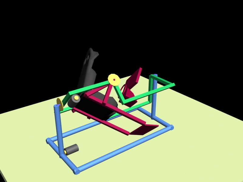

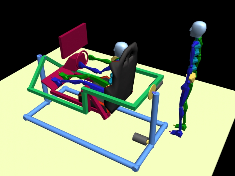

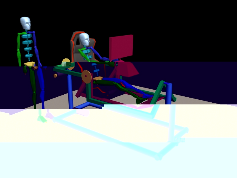

Hello All,
I'm Rens from the Netherlands. I have my own gamestudio which develops games for the internet, tablets en phones. So you can say I'm intrested in gaming.
I had to sell my MX-5 racer last year and since then i've been looking for a new thrill. It seems a simulator looks like a great way to have some fun.
Stuff i've had lying around from other projects. Velleman K8055, two wheelchairmotors + Gearing, Racing Seats (BucketSeats) and a Sabertooth Motorcontroller (2x12).
So i've already got some of the more important parts.
Things i'm gonna need: The steeringwheel + pedals, a frame, and some gears.
I want a +45 -45 degrees for both longitudinal and lateral forces.
Below is my design for * I know I miss some crossmembers. But it's a start to see if All the angles are possible.
It's made up from 3 different frames.
The blue frame is the base.
The green frame is for lateral forces
The Red frame is for longitudinal forces
The grey blops are the engines i've got
The yellow discs are the gears/sprockets i'm going to use.
The output shaft of my gearbox (1:25 160rpm engine) rotate with 38,4 degrees a second. I hope this is fast enough for a thrillride.

Postby floriske » Fri 27. Jul 2012, 11:45
Hi rens,
Good to see your project here!
Your initial design looks good, but what a massive angle you are looking for :D Since you are aiming for 45 degrees I reckon you are going to use it for flight sims as well?
Looking forward to seeing your progress!

Re: Rkade's 2DOF first attempt
Postby motiondave » Fri 27. Jul 2012, 13:11
45 deg race...that could be interesting. It would be like driving a wheelstander at the drag races
Postby RensLensvelt » Fri 27. Jul 2012, 13:52
45 degrees sounds like a lot. But when you remember that the horizon stays the same (your monitor moves with you) you will only experience it as G-forces putting you in the back of your seat, or when braking giving you the falling sensation.
