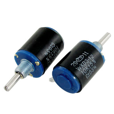

I found these on ebay,
http://www.ebay.com.au/itm/320925459304 ... 1439.l2649
They are 10k 5turn pots (not 3turn as advertised)
I cannot vouch for their quality but they are certainly cheap!
I will give them a try.

Postby motiondave » Tue 24. Jul 2012, 04:17
That will work, but you need to find plastic gears to turn them correctly. Have a dig through a local hobby shop or two and yo may find something.
