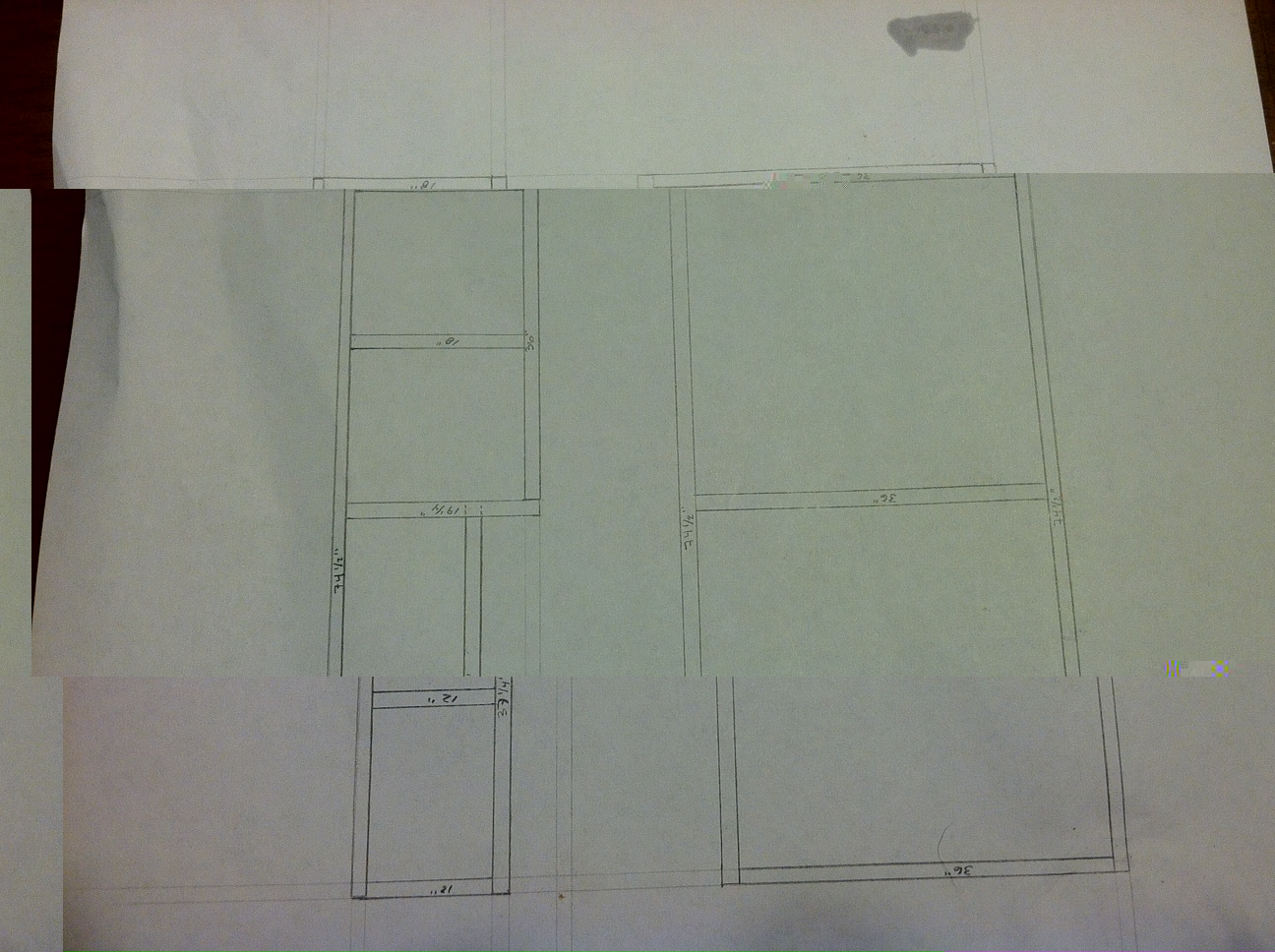

So I will post my drawing of the cockpit frame that I drew that include dimensions, so if anyone has any pointers please tell me so I can avoid wasting time and resource. Thank you community.
My first question to those who have built a joyrider out of metal would be how did you hook your potentiometers to the motor or drive gear? Next did you use belt or steel cable and what did you use for a pulley on the wiper motor? Finally for now how did you build th mounts for the motors on each axis do you have rough dimensions you could share? Thanks everyone again.
Here is my rough drawing of the cockpit frame.

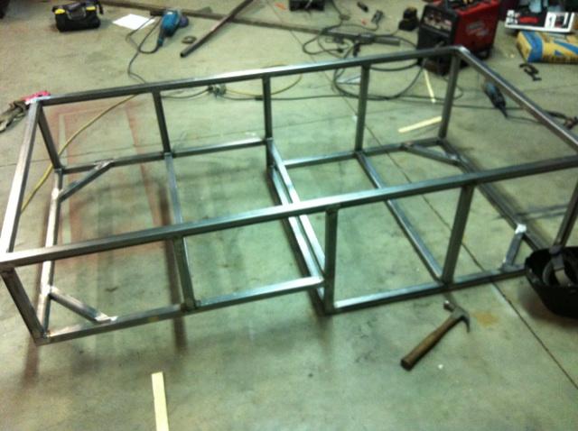

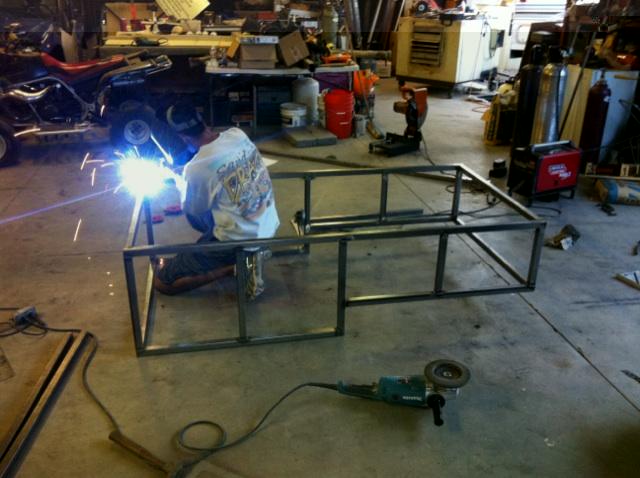

Here are some pictures of the cockpit assembled
test fit with the seat.
cockpit frame welding completed.
cockpit being assembled

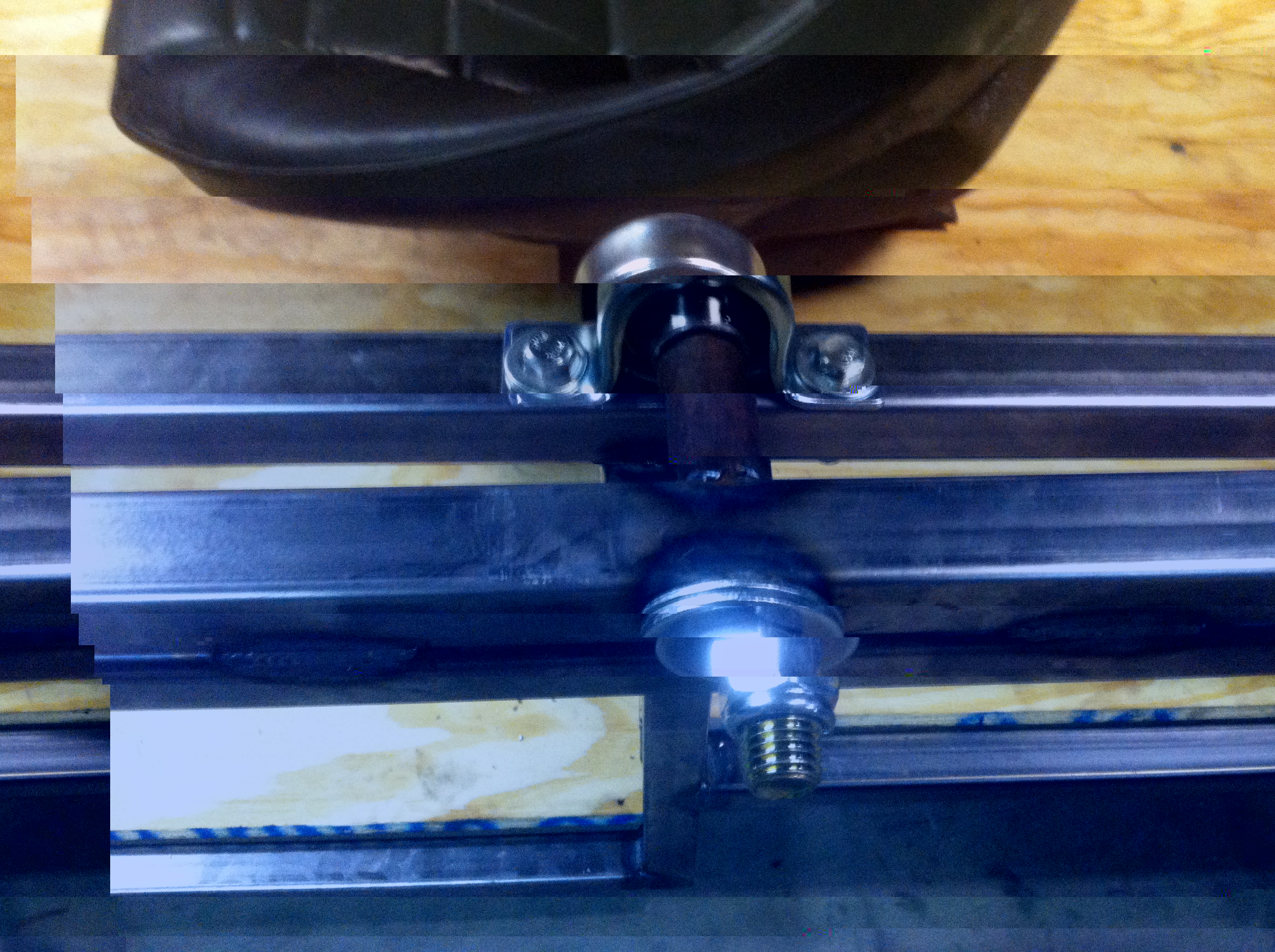

picture of the bearing set up
another angle.
Sitting on saw horses
