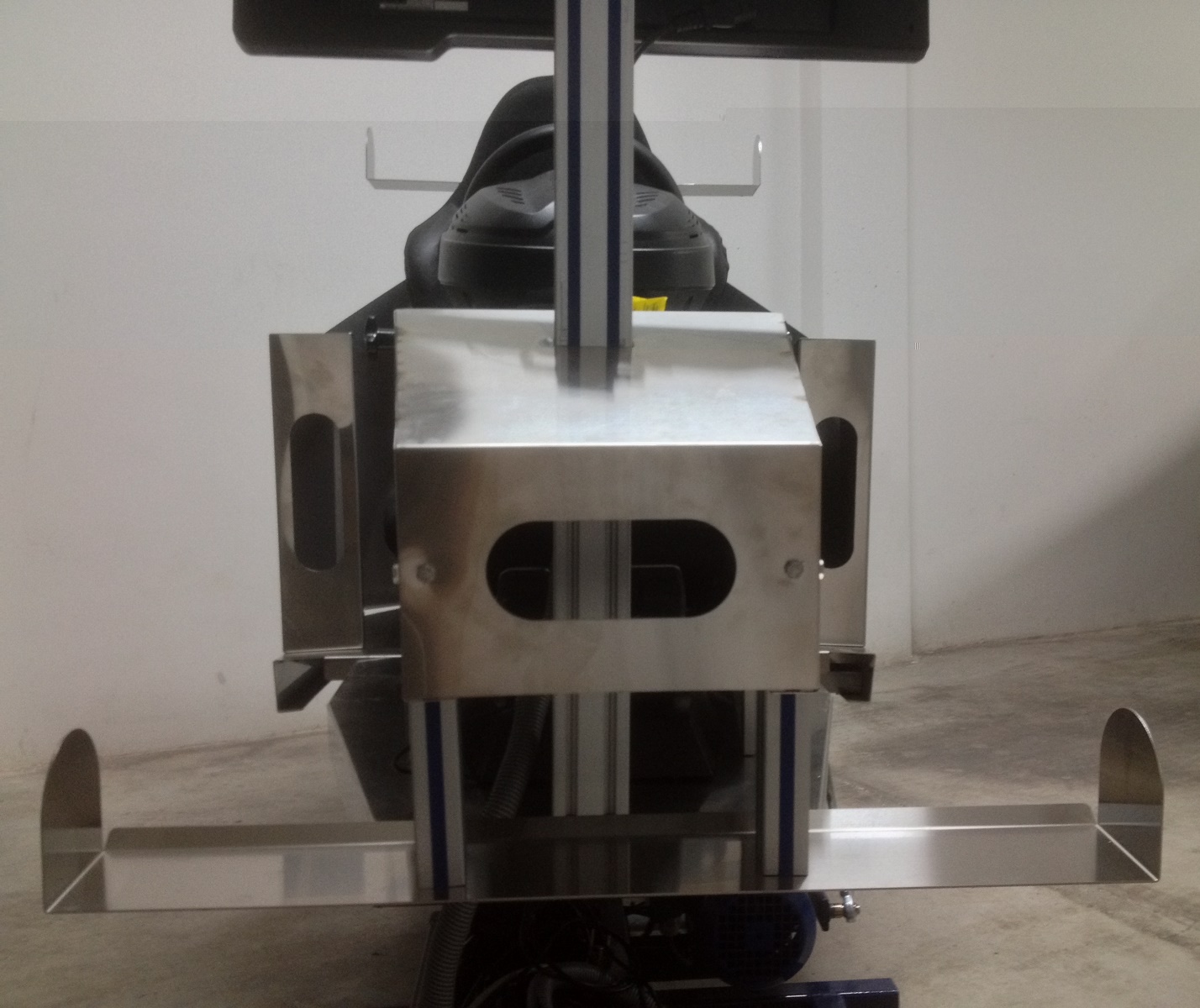

Postby simupp » Mon 4. Jan 2016, 11:35
Hi, this is our motion simulator projects in progress with two motors AC + VSD + Arduino Uno.
We need help on the code needed to work with x-sim telemetry and transmit the necessary orders drives through arduino code. In principle, we know which are modbus commands for working with the variators of frequency (March, stop, frequency, speed, etc.)

We managed to communicate with the variable speed drives through modbus with arduino code. We are able to start, stop, vary the frequency, speed of the motors.

Les moteurs à courant alternatif 220V sont nourris . Arduino max 485 est chargé de donner lieu à des variateurs de fréquence via les commandes Modbus .

The AC motors are fed 220V . Arduino max 485 converter is responsible for giving appropriate to the frequency inverters via Modbus commands.

Hola !. Hemos sustituido la Arduino por PLC.
En la galería dejamos nuevas fotos.
Ahora estamos "peleando" con los motores/reductores y creando el perfil para converter. Admitimos cualquier sugerencia.
Muchas gracias.
