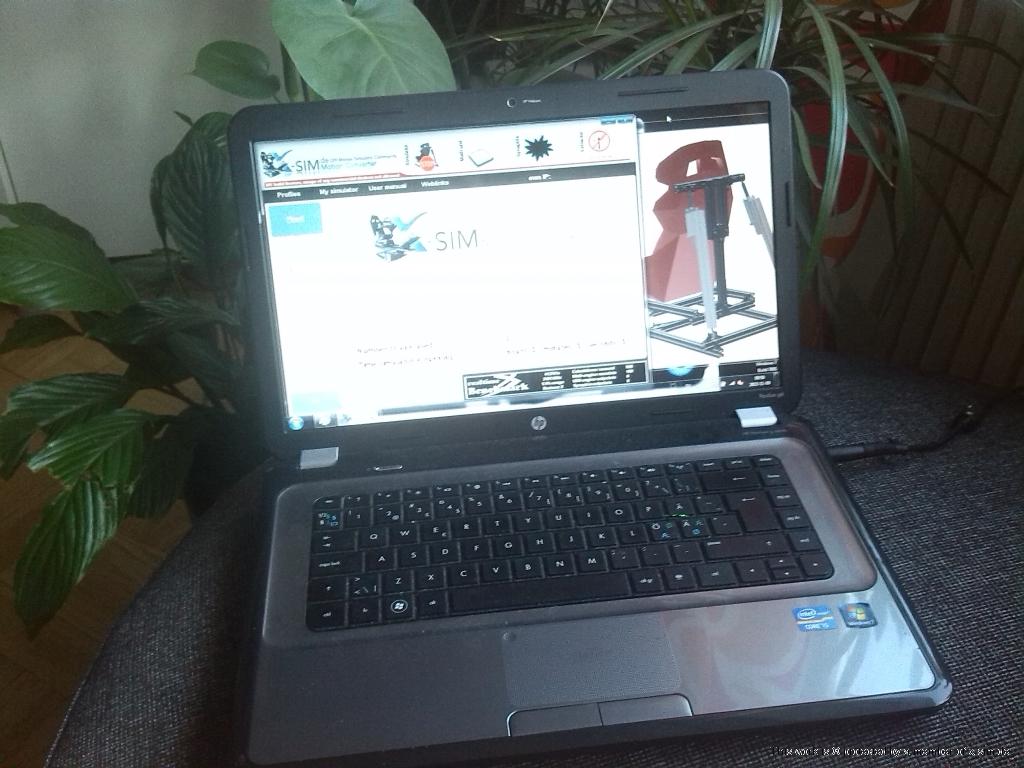

My main computer (Gaming computer) atm

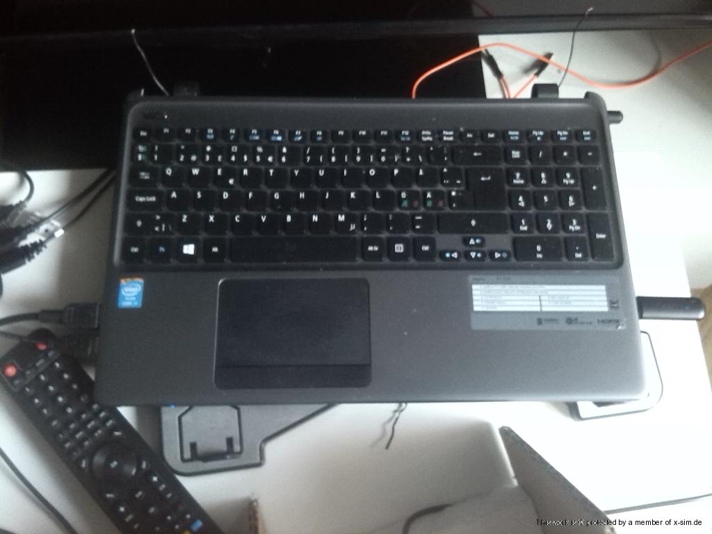

Its an old laptop with intel gfx so not very good ingame gfx but it will do for now since the games are playable. It has no lcd so it is hooked up to my 50" 100Hz JVC.

My Control computer
This one will have all the controll software for the motors and guages.

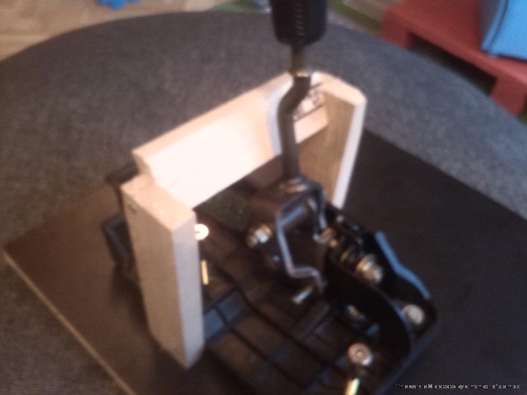

The shifter prototype build.
The shifter is from a 2000 Hyundai Tiburon
3881

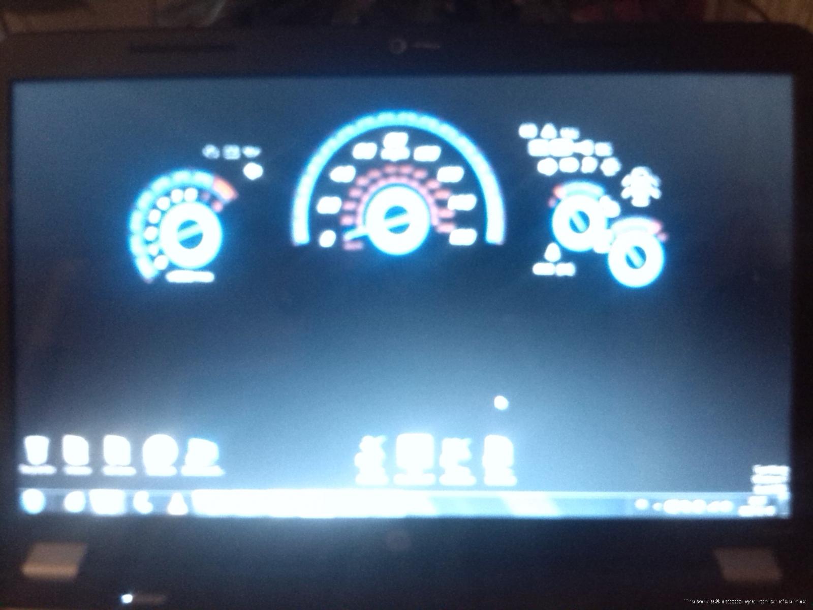

Worked a little with Desktop Dash. Not done this one i made in about 30min. So some adjustments needs to be done. Now im just glad its all working on my control PC.
3891
*EDIT I Made the gfx in Gimp and not Photoshop as suggested in the tut, since Gimp is free and can do the same job..
