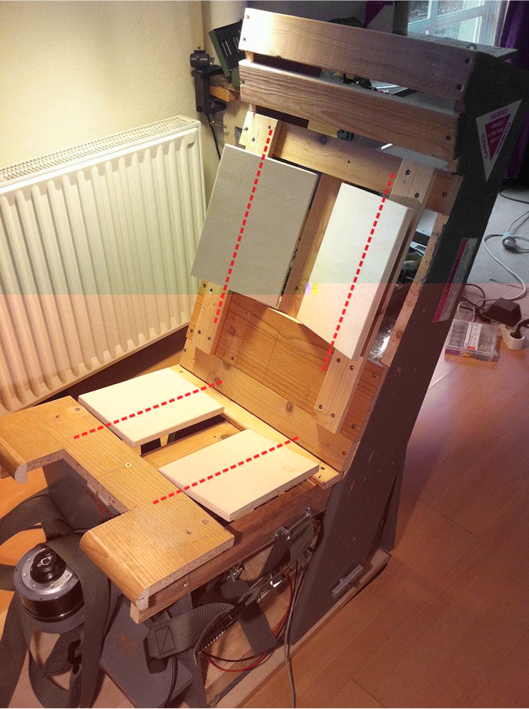

Wow, I'm deeply impressed at your G-Seat build BrassEm! Good job! It looks WAY more professional and elaborate than mine :oops:
Just one thought: the axes on your flaps are far more to the outboard than in my build (see attached picture), did you find they give a better sensation that way? I'm just curious...

Thank you sir, you lead the way. I would never have achieved this without your work. The pivot points were calculated to give a bit more loft and side pressure on the higher G's. KLR Rico mentioned about having more movement a while back (Can't reference his post unfortunately). I hope I am interpretting that correctly. I am still months away from the first flight and will probably need to adjust the pivots to suit more than likely. When I finally get there I will post how it goes.
