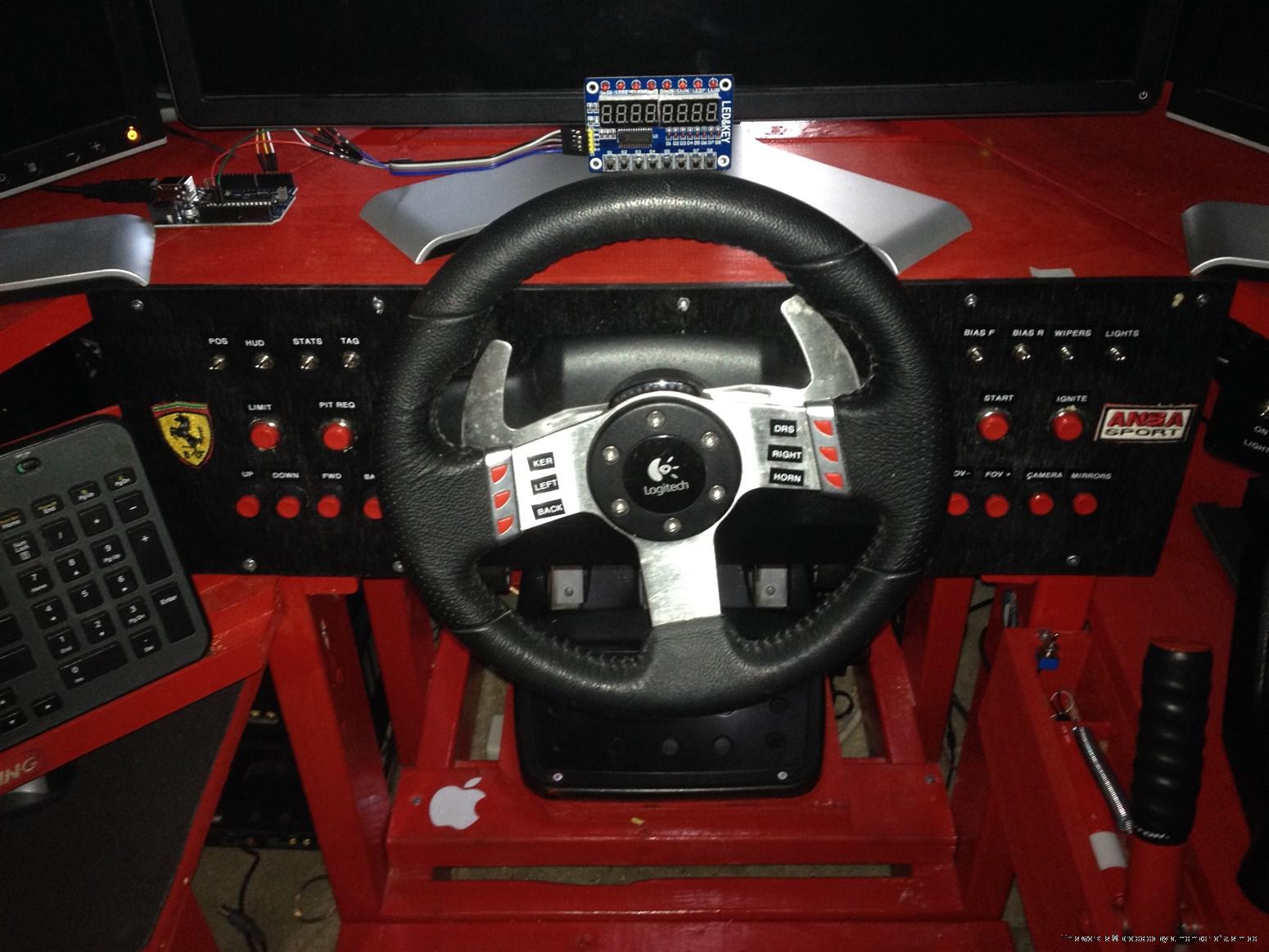

Hi all,
this is my never ending evolving project that is started in 2010 and it went trough major improvement and modification during the last past 5 years
i will try to find a picture when i started it when i was sitting on a pathetic red camping chair with bass shaker attached..
Being Italian living in canada i was inspired by Ferrari and Canadian colors so the project it is all red and black.

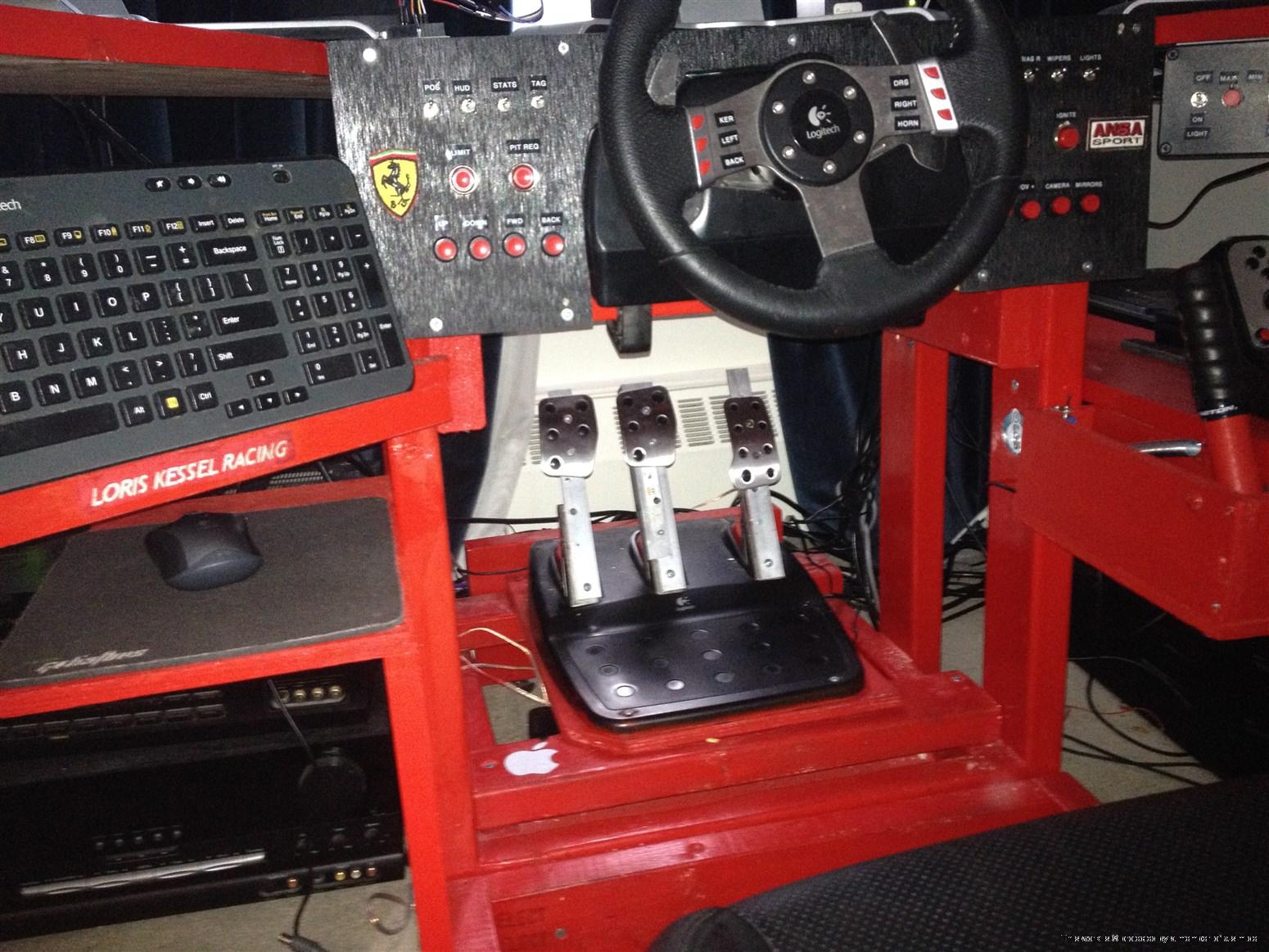

it is a very sturdy wood frame mostly 2x4 with 2 main detachable parts, Seat Base and Wheel + Monitor Base
I have 6 bass shakers, 3 embedded in the car seat and 3 under the pedals the bass shaker are drive by SimCommader + 2 wi-fi receivers
Recently i added the support for triple monitors, Keyboard and mouse support, and arm rest with embedded logitech shifter and 20 switches button box driven by arduino megajoy.
Very recently i added home made 5$ analog or digital hand brake drive by the Arduino mega , Fan and Keyboard light control box driven by a second Arduino uno , a tm1638 for speed + rpm +gear drive by my third Arduino uno.
For the TM1638 i run x-sim extractor + second pc running the converters
My Next step it is to add a seat mover driven by the third arduino or maybe mega and with 2 wiper motors, i will post some sketch with my ideas
Another improvement i would like to do are Fuel gauge + Oil Temp gauge + Water Temp gauge all driven by servo motor and arduino
I already got 2 HP servers power supply a Monster Moto Shield and the 3 mini servos but will take a while to complete the project since i am running low on cash and need to buy the motors , rods and universal joint and frame material

Here a list of material i used for the project:
motherboard:970A-g46
processor: FX6300 6 cores
RAM: 16gb
Disk: 1tb Hard Drive
Videocard: 7950 3gb ram
SoundCards: Embedded 7+1 - SB 5+1 - Generic USB 7+1
LCDs: Main 1920x1080 - left and right 1280x1024
Keyboard and Mouse: wireless
Headset: G230
OS: Win10 64bit
Steering Wheel: G27
Wheel Mods: Aluminum Pedal Raisers - Elastic Sequential Shifter
Button Box: Ard-Mega with Megajoy firmware
Home made 20 momentary switch panel
Fan Control: Ard-Uno + 2 Desktop Fan 4pin with PWM
12v DC power supply
HandBrake: Analog+digital home made Wood lever connected to Button Box
Digital Display: Ard-Uno + TM1638
Bass Shaker: 2 AST-2B4 (pedals and Seat) 4 Pucks (Chassis)
Amplifiers: 100w receivers for bass shakers
