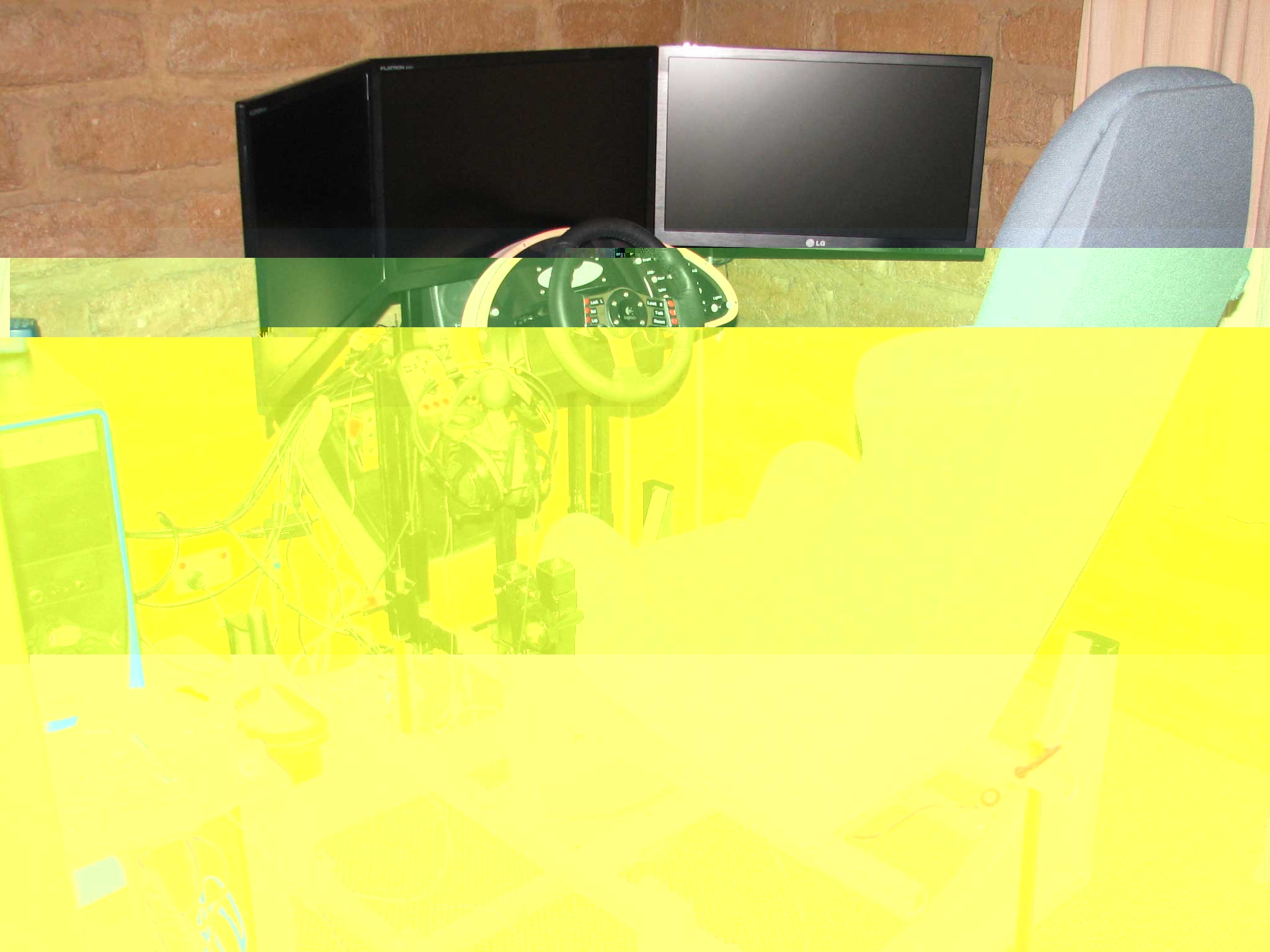

Construction finished, just need to get the motion going.
(Thanks Deriy for the seat design)

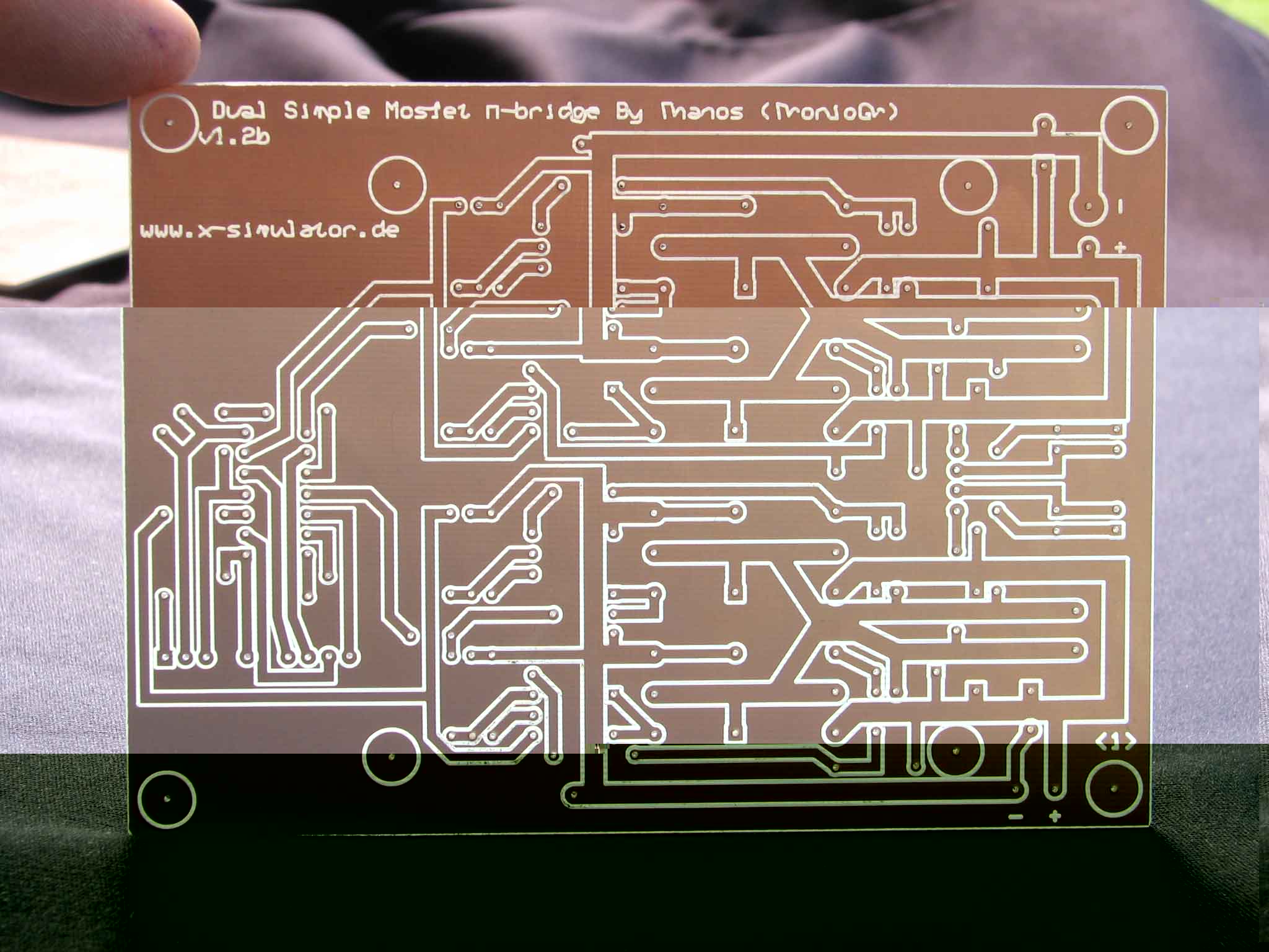

CNC engraved PCB
Bit of a sculpture!

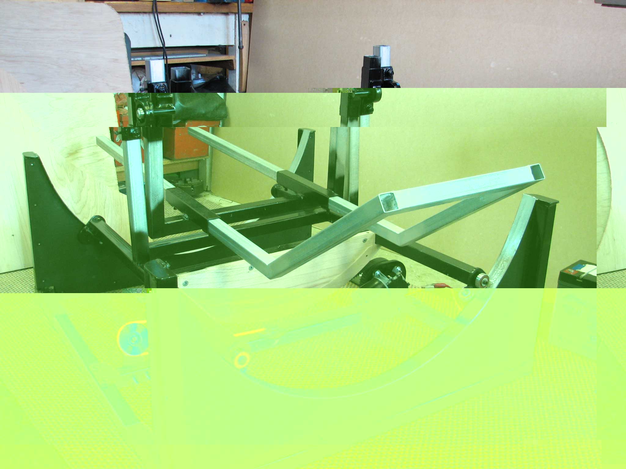

Pitch and Roll frame with revised wiper actuator system
(descarded motion actuator - did not use this system in the final version)

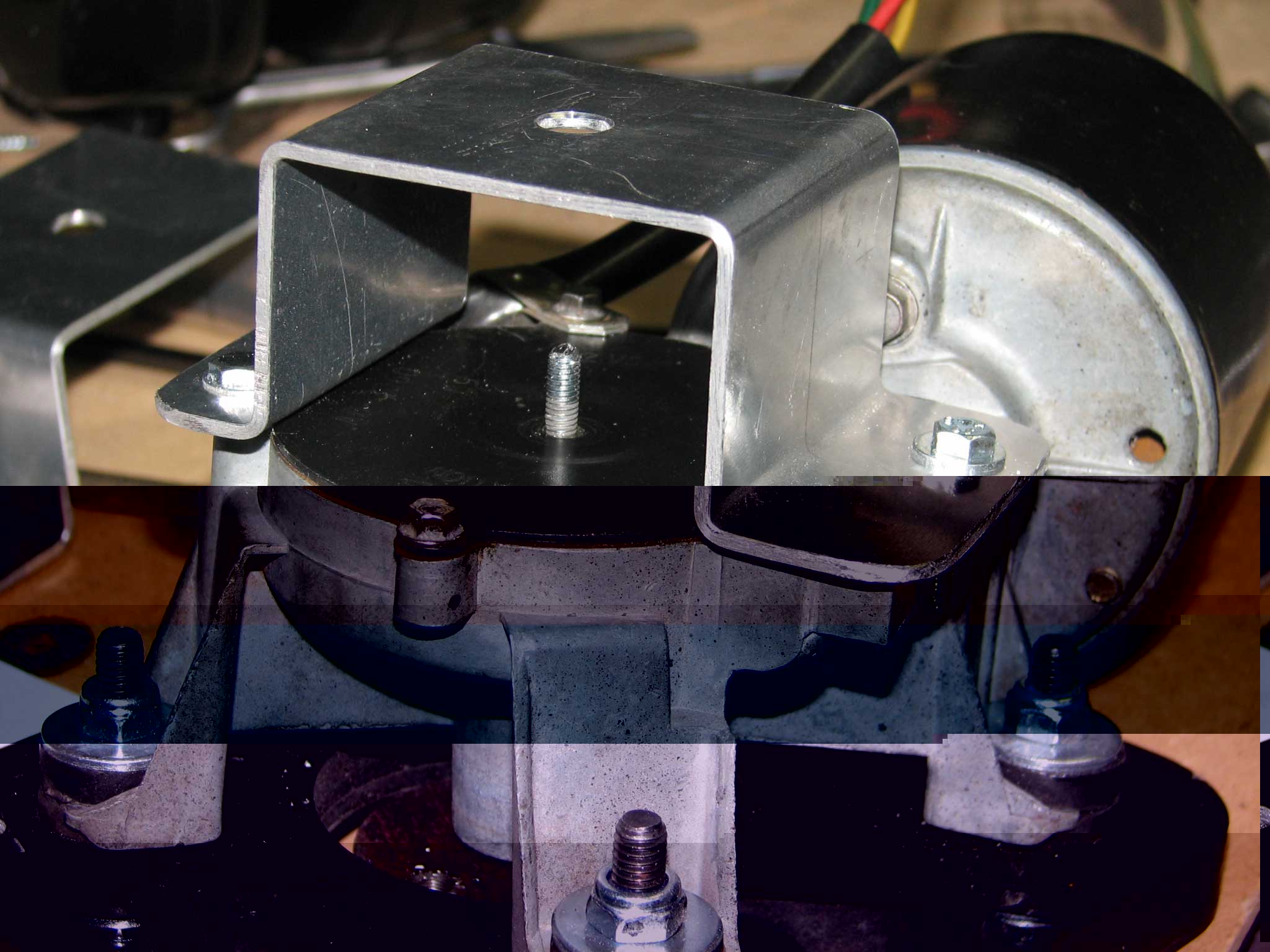

The latest version of the motion actuator system
Pitch frame motion . Cable tension adjustment on ends

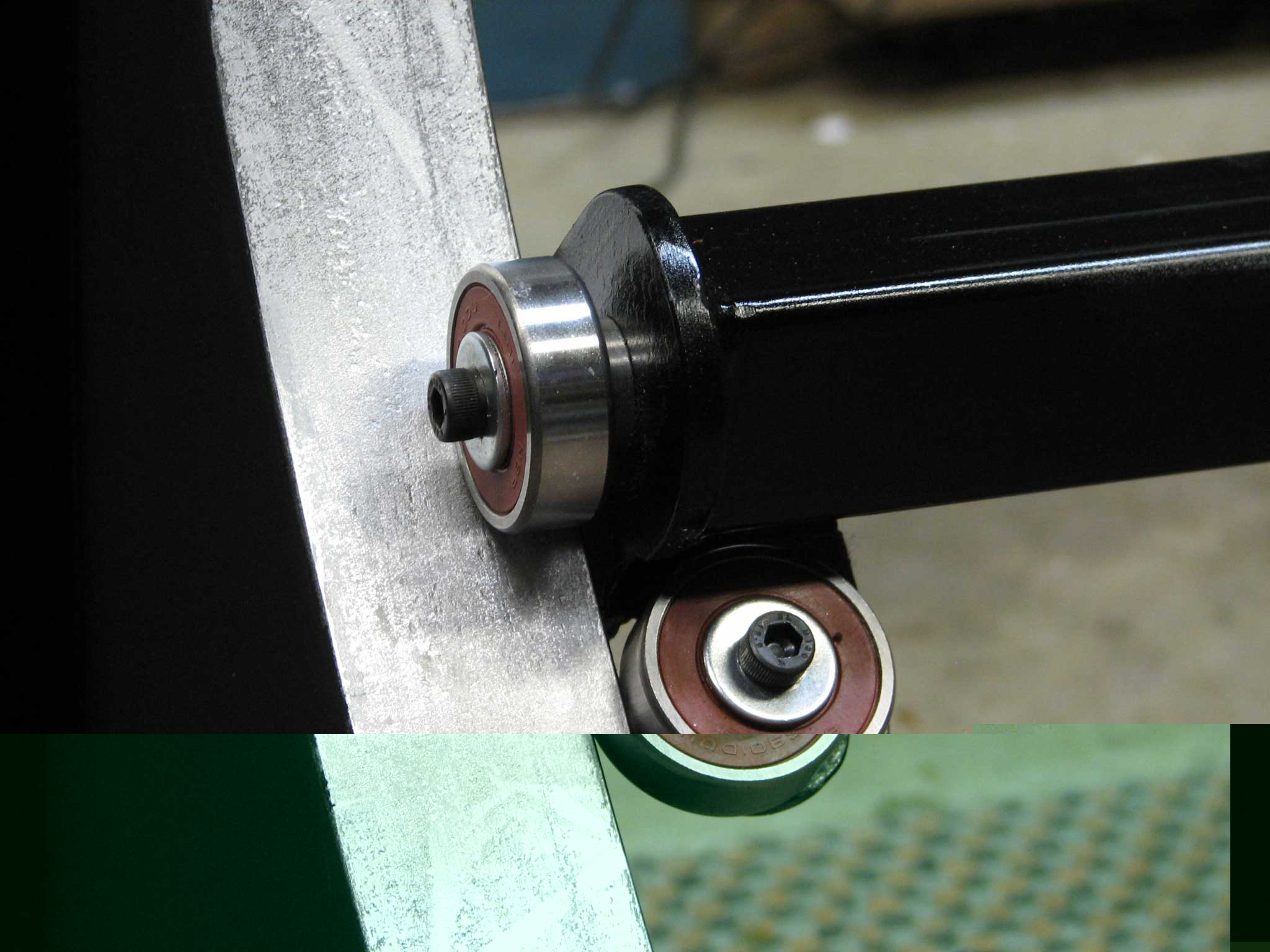

Roll frame bearing detail.

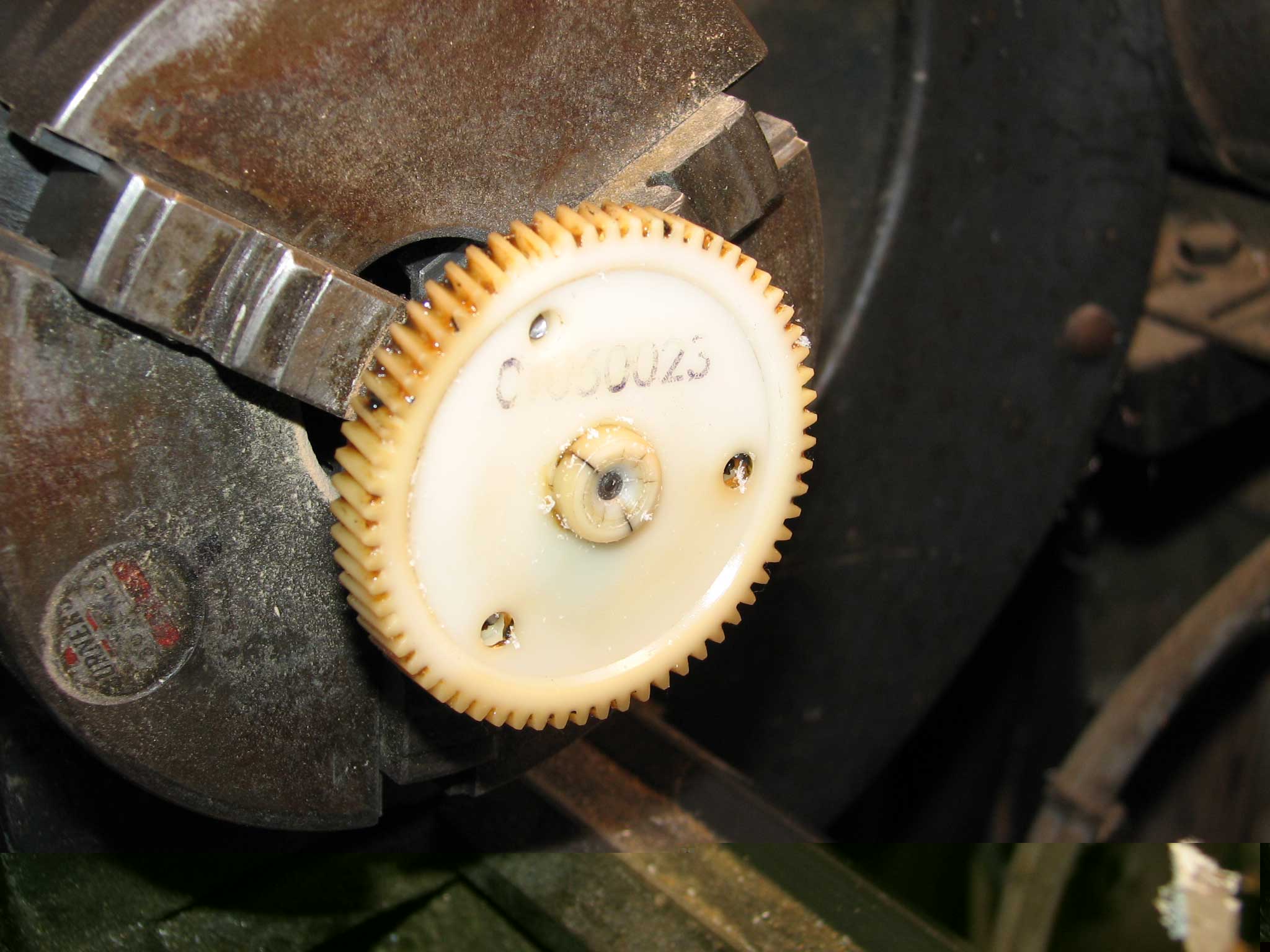

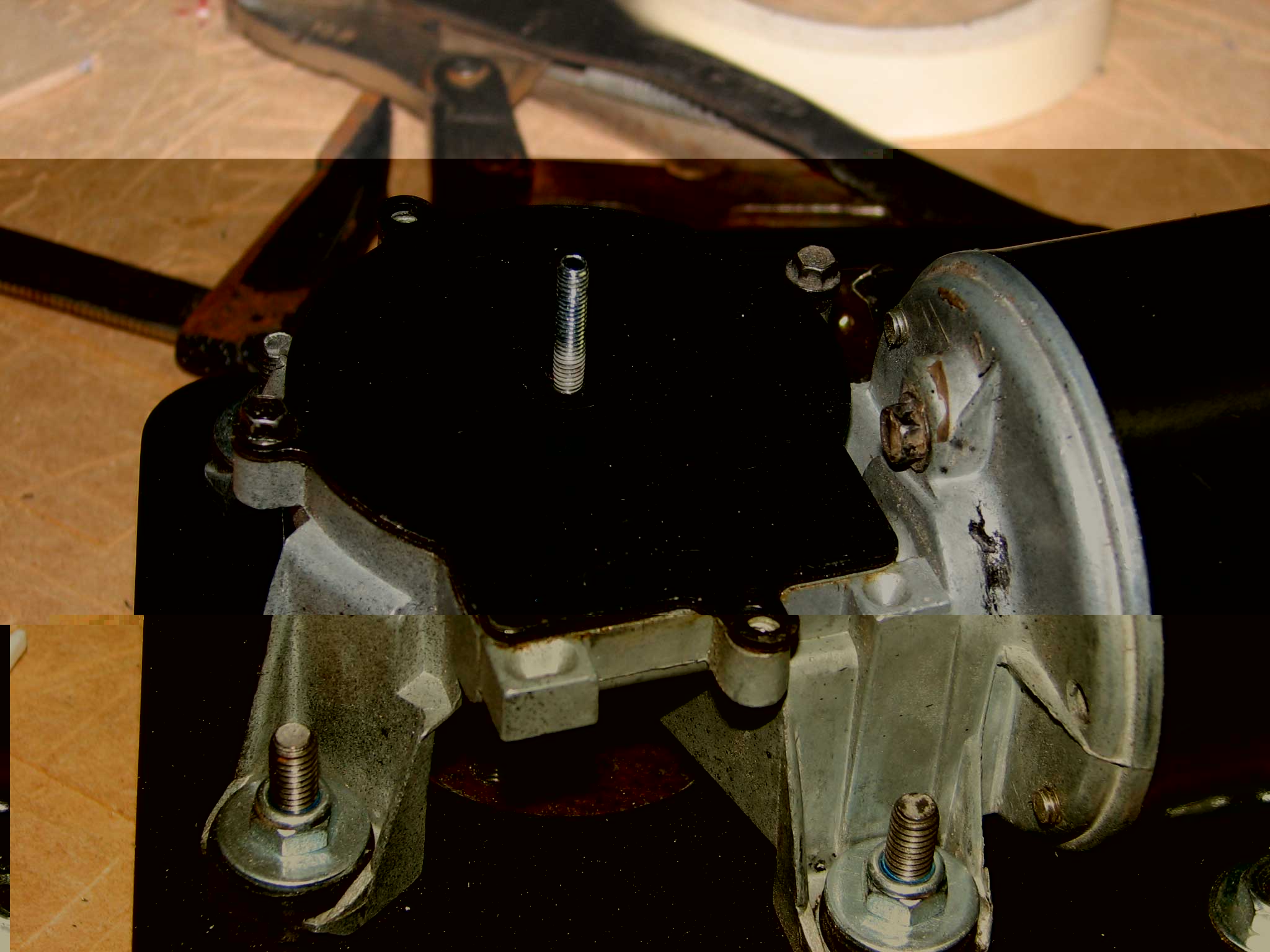

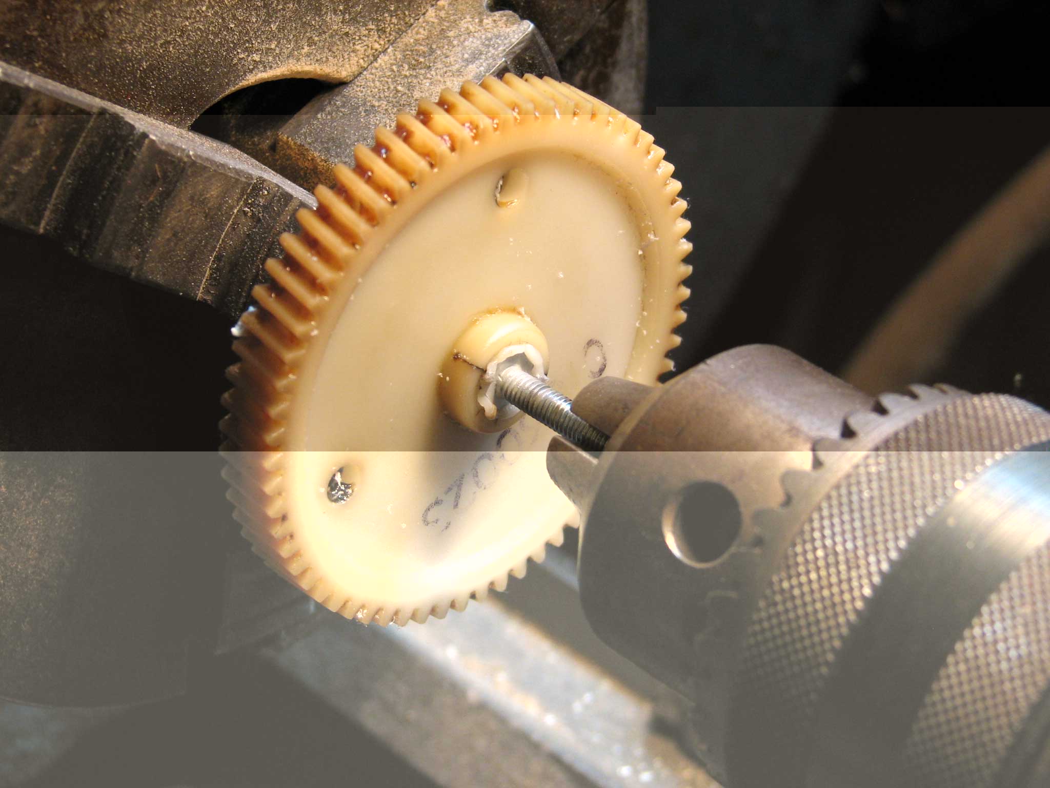

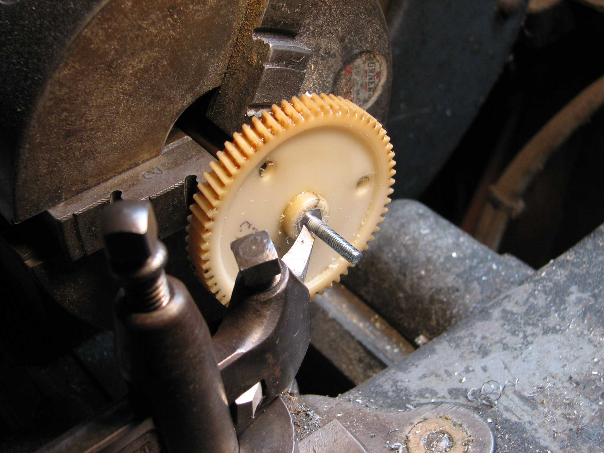

Wiper Motor Modification for fitting the feedback pots directly to the motor output shaft.
Output gear removed fro motor and held in lathe
Turn down the thickness of the bolt head so that it can be "melted' into the plastic gear.( heat bolt head with a small butane torch)
Hold the bolt in the the lathe tailstock chuck to produce a perfect alignment to the gear shaft.
push the hot bolt head into the gear with the tailstock chuck
Turn the face flush under the bolt head to restore the "bearing" face
Drill a hole in the motor cover plate using the lathe.
The reassemble the motor so that the bolt protrudes through the motor cover plate.
Make a mounting bracket to hold the feedback pot in allignment with the motor shaft

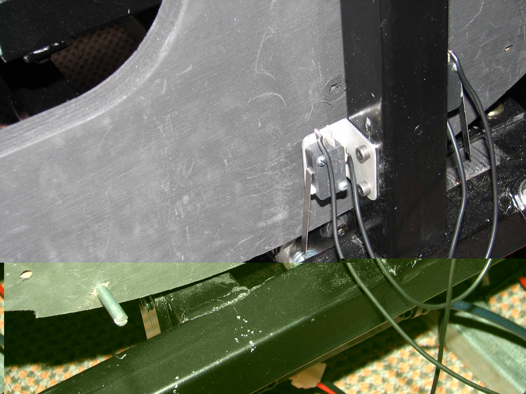

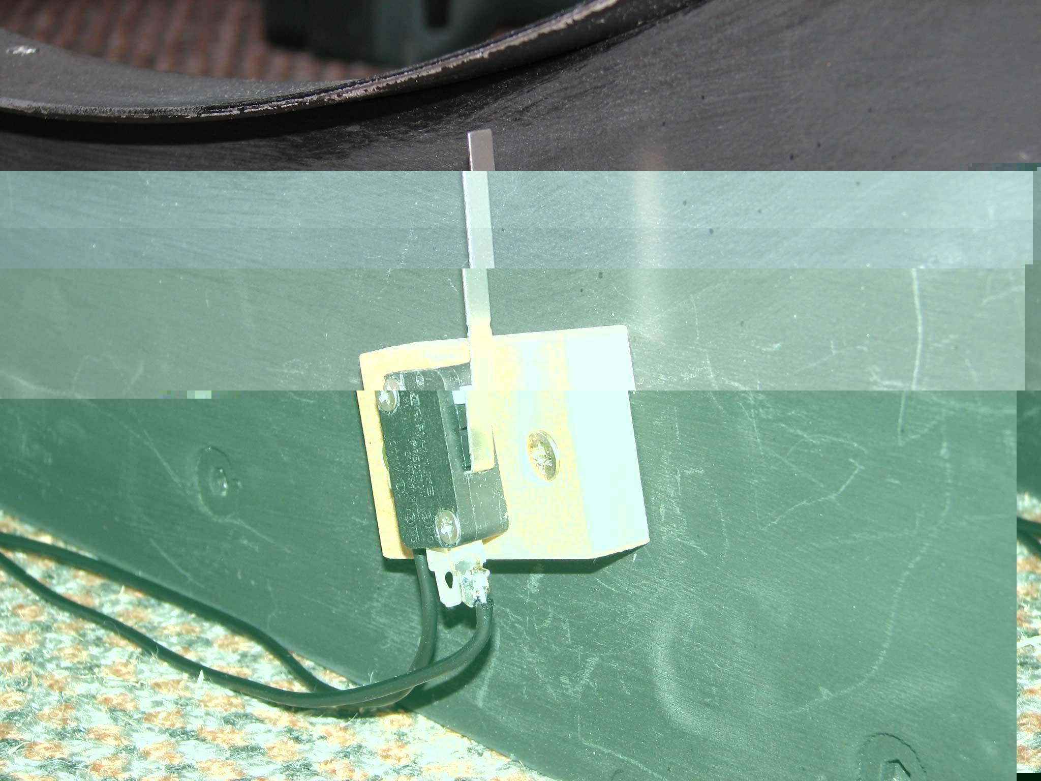

In the process of fitting Limit switches to both X and Y Axis. I am wiring the switches to control a contactor. The limit switches are wired in series with a toggle switch that controls the contactor, so that the 12v supplies to the input of the H bridge can be isolated manually as well as by the limit switches.

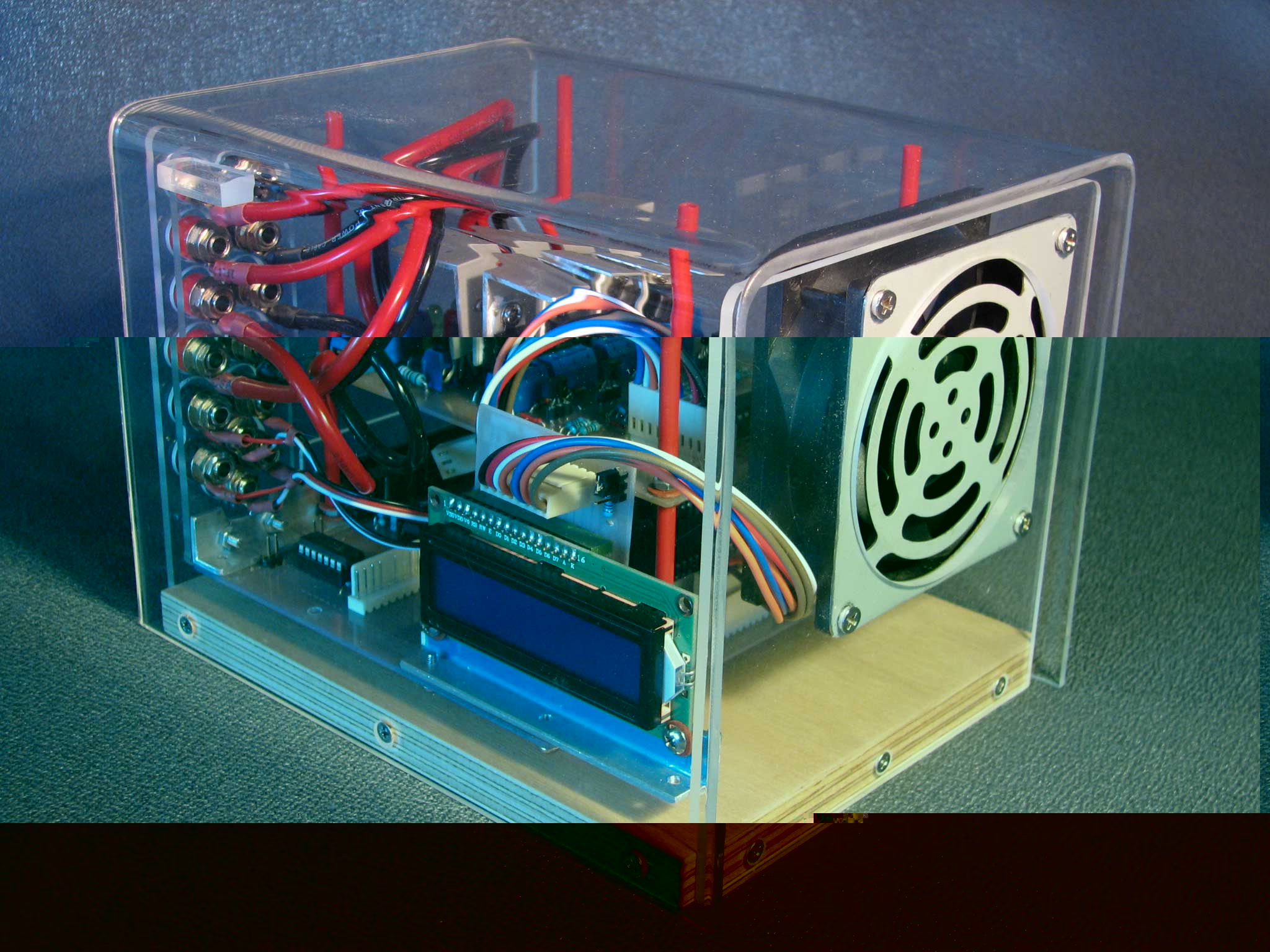

Postby Bruceaust » Thu 26. Jul 2012, 14:02
Oh well :?
Had limited success testing the motion.
The AVR/Hbridge worked ok, except I overheated and blew a couple of Fets in the Hbridge.
I think I am trying to move to much mass to quickly, or the Hbridge is not able to supply enough current when
the wiper is struggling to move.
I will need to re-think my motor/motor driver options.
Nice to get it moving though!
Bruceaust
Posts: 72
Joined: Thu 10. May 2012, 10:52
Location: Launceston, Tasmania, Australia
Re: Raceflight V2
Postby floriske » Thu 26. Jul 2012, 14:24
Ouch! Always a pain if something breaks :(
But like you said, I think you are indeed expecting a bit too much from your motors.
Nevertheless congrats on getting it moving!
