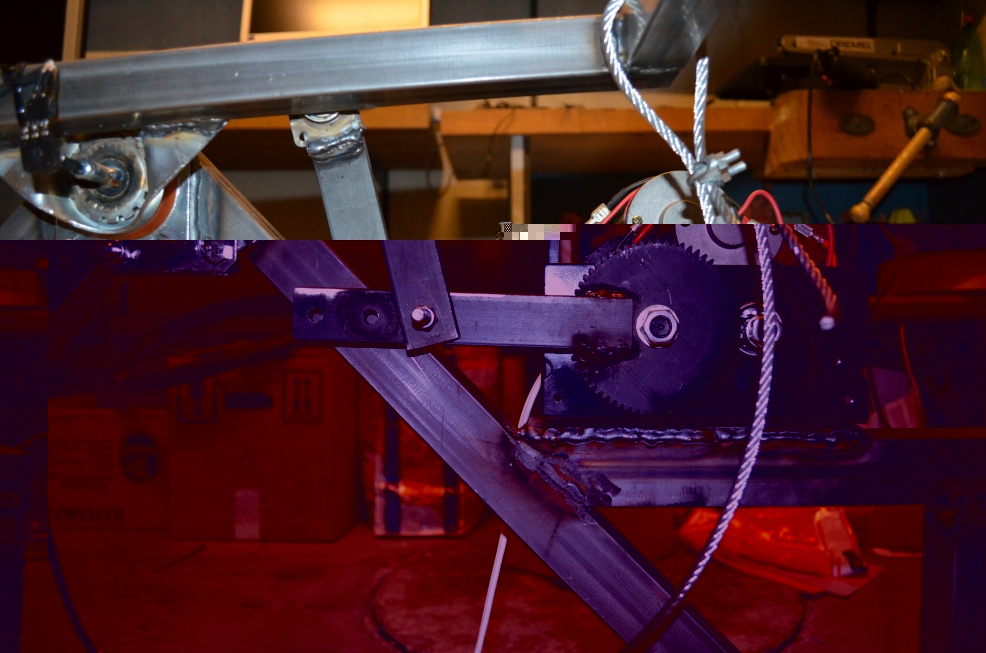

I have installed the second axis (roll). Instead of a chain drive I (remember the hilarious backlash ) I designed a lever drive.
Roll axis
(The steel cable is a bandaid to limit the roll to less than 36°.)
Unfortunately the combination of weight (180 kg including the pilot), centre of gravity (above the axes) and the power of the winch is not good enough to allow to move the joyrider sufficiently and it even stalls in the end positions (left and right)
It looks like the backlash of the lever drive is not any better than the chain drive. And the backlash even grows as the gears wear (really soft steel of the winch gear!).

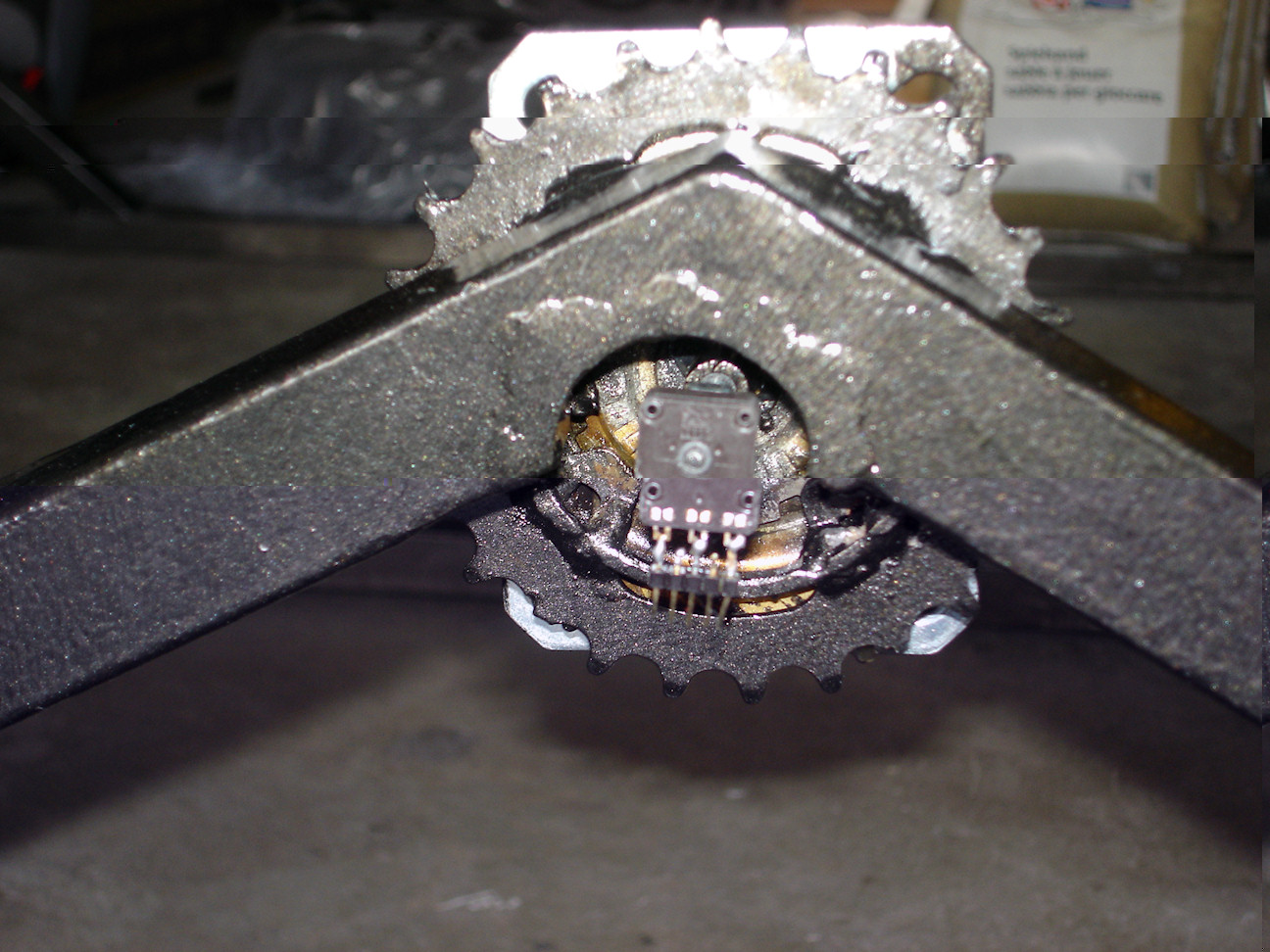

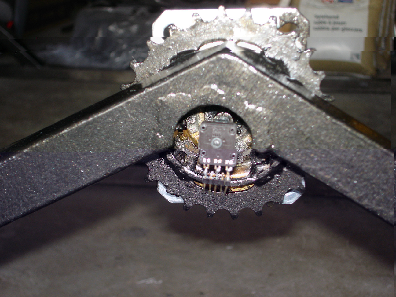

At least the design allows a nice placement of the potentiometers in the axis of rotation rather than somewhere on the winch. This should allow me better control of the movement – in theory.
Potentiometer

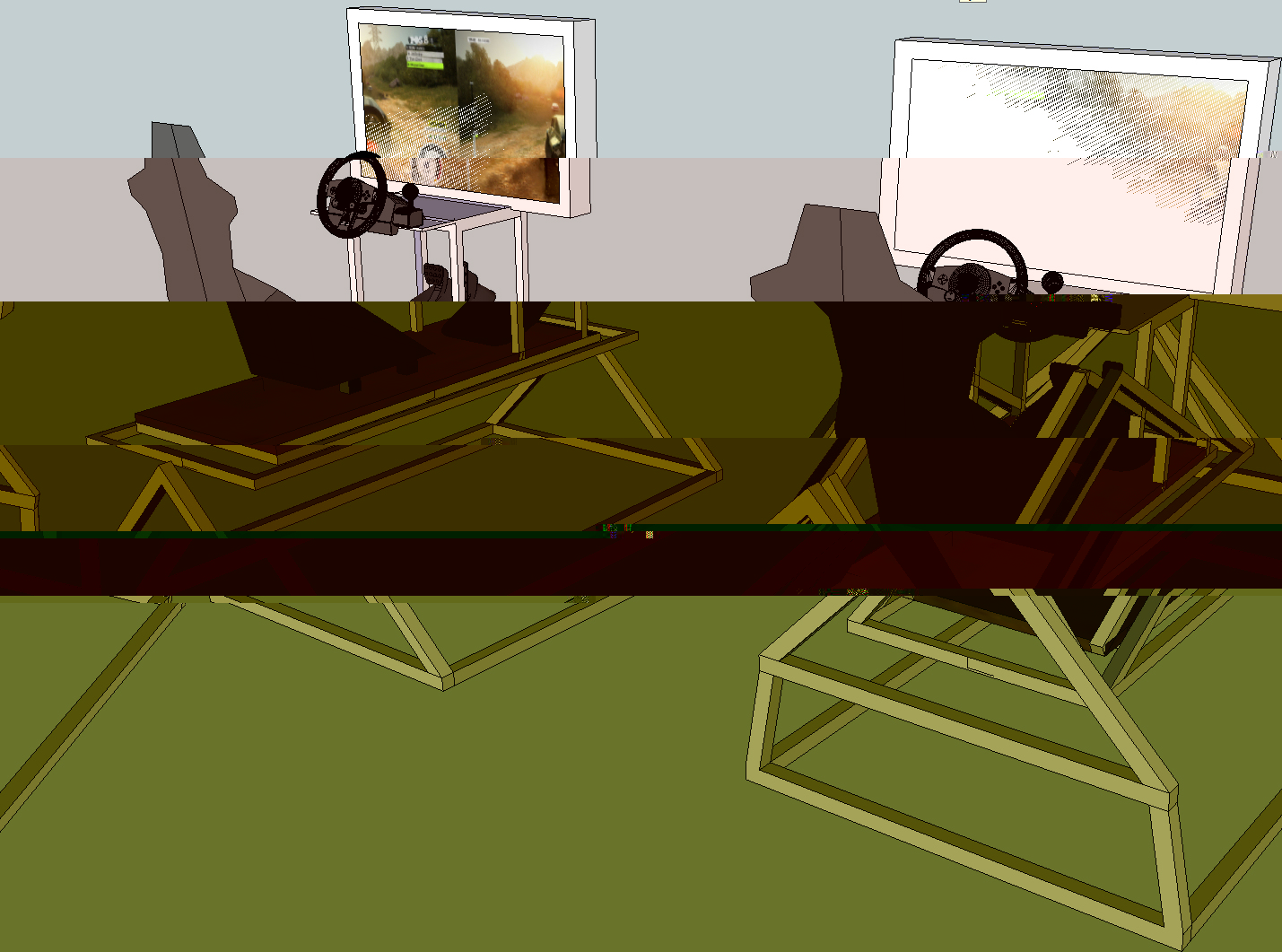

Thanks to the hint of pippo978 to SketchyPhysics, I have drawn a dynamic model of my sim.
SimPlatform %28Google Sketchup skp file%29.zip
(1.55 MiB) Downloaded 2080 times
You'll need Google Sketchup and SketchyPhysics to display and move the sim.
I'll have to resolve the issue with the lack movement – probably go back to the drawing board...

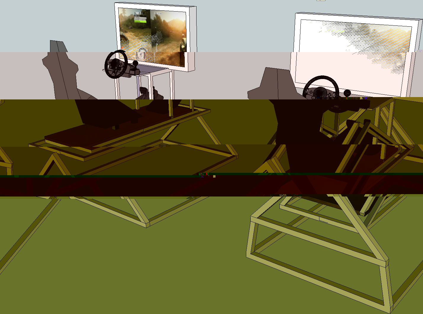

bsft wrote:Nice design there, I still suggest lowering the middle frame to improve centre of gravity though, that may help increase movement.
Yes, I did some basic FE calculation of my original design and the outcome was that by no means I would be able to move the platform more than a few degrees with the winch motors. So I decided to follow the advice of several of you and go through a redesign. The axes now pass through the centre of gravity rather than below it. It meant that I had to add tubes all over.
Comparison old vs new version
Overview new design
With this much more balanced design the forces of the winches are matching the load of the platform

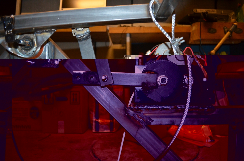

The motors shall pull 2 steel cables connected to the inner and outer frame. Geometric details still to be worked out.

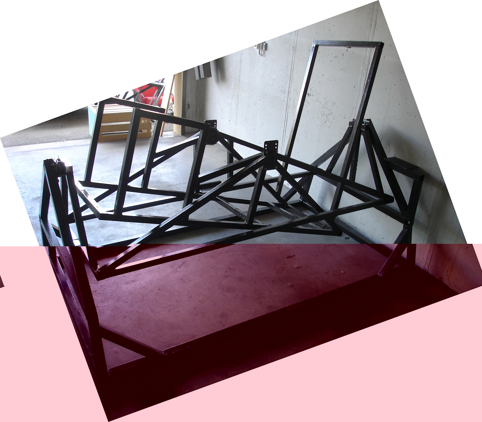

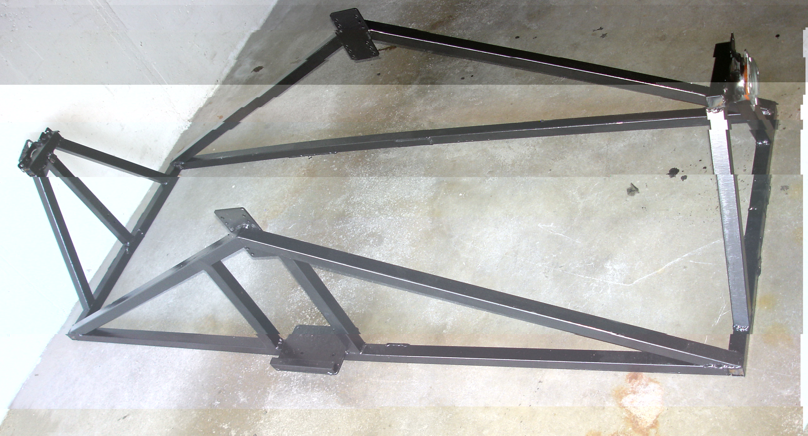

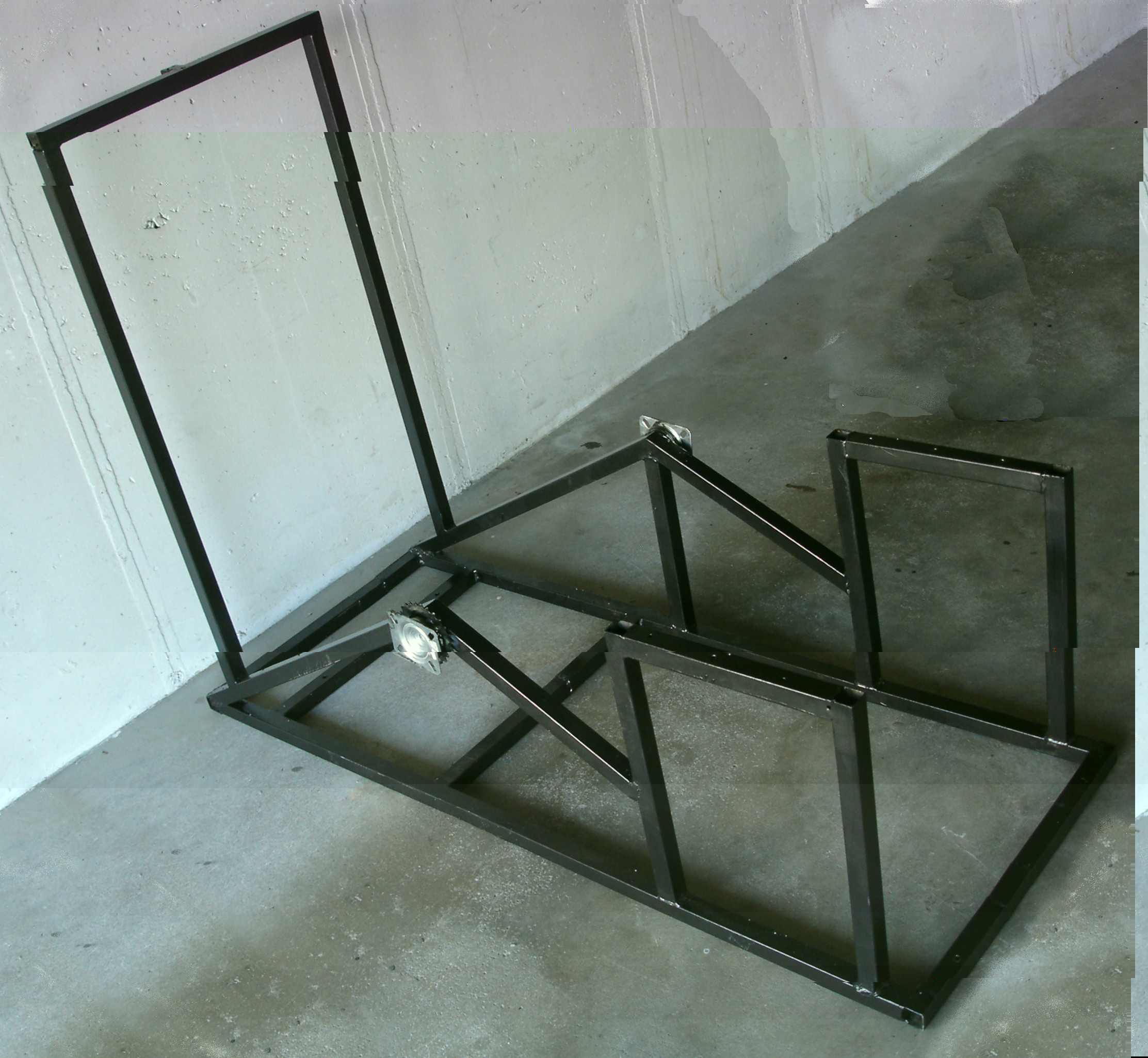

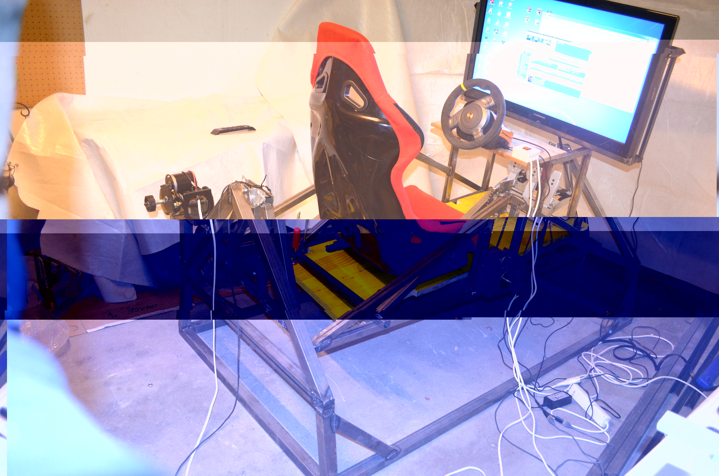

Here some pics of the metal frame.

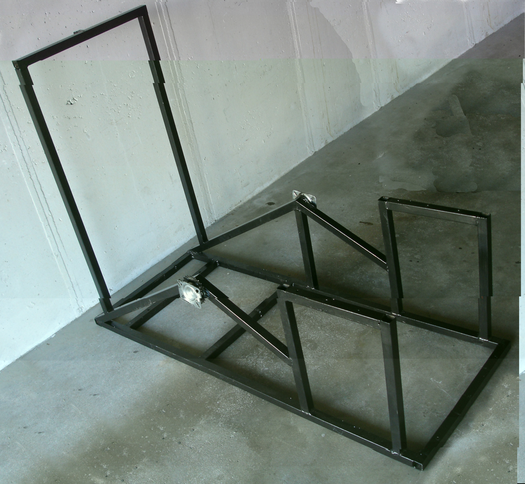

Base frame

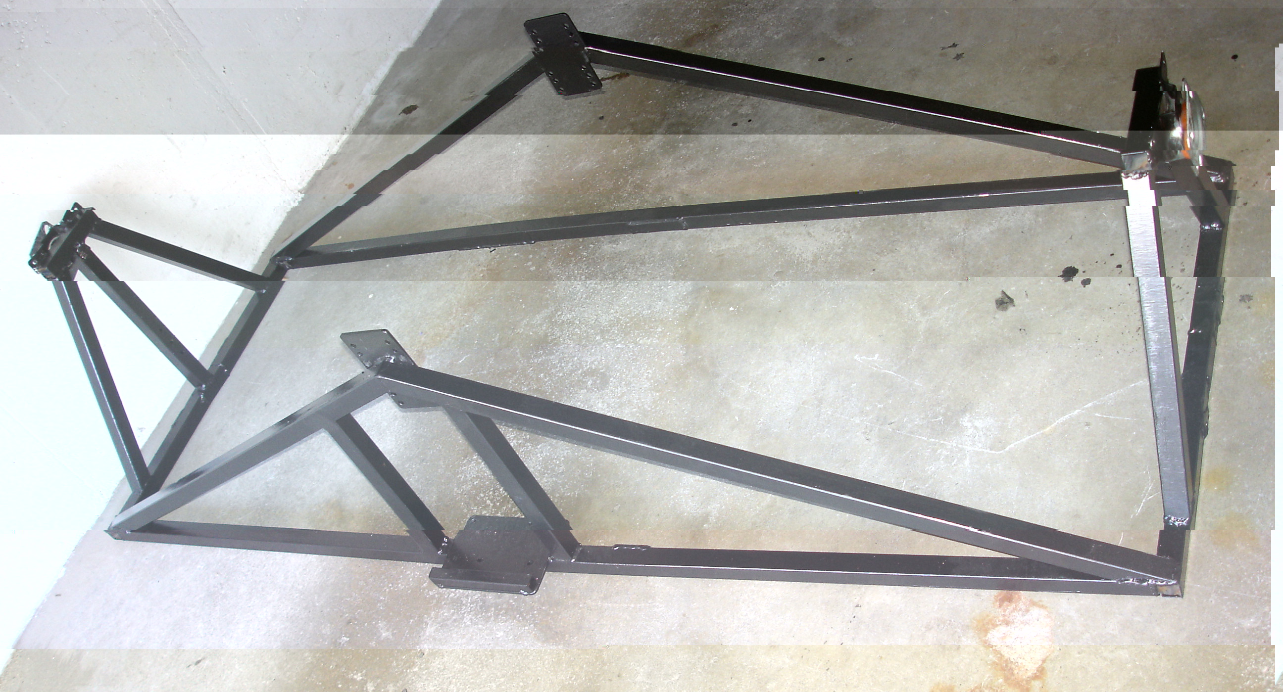

Outer Frame, side acceleration (roll), 18.4 kg

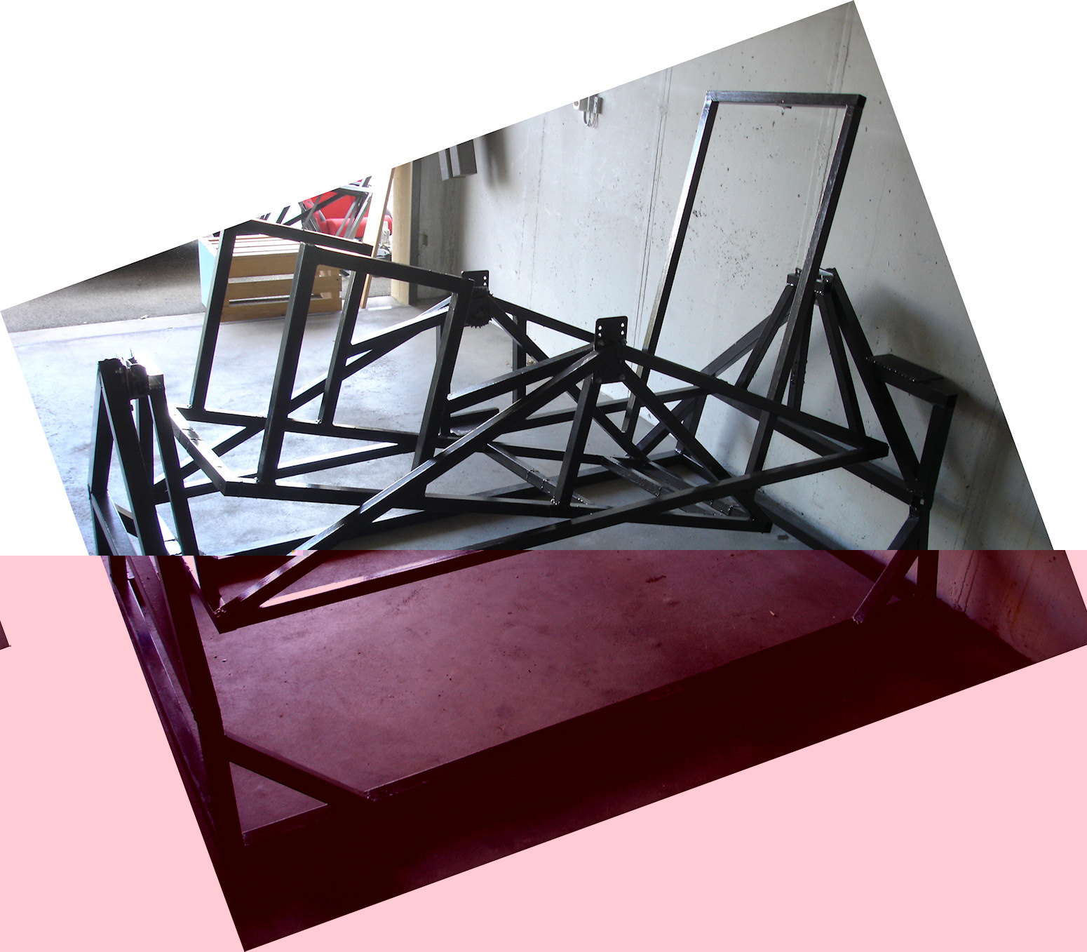

Inner Frame, acceleration, braking (pitch), 16.7 kg
Assembled frames

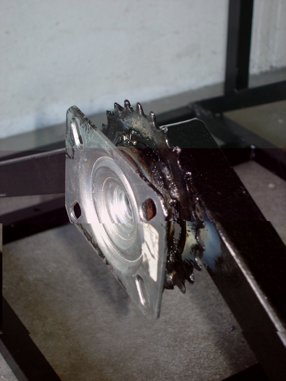

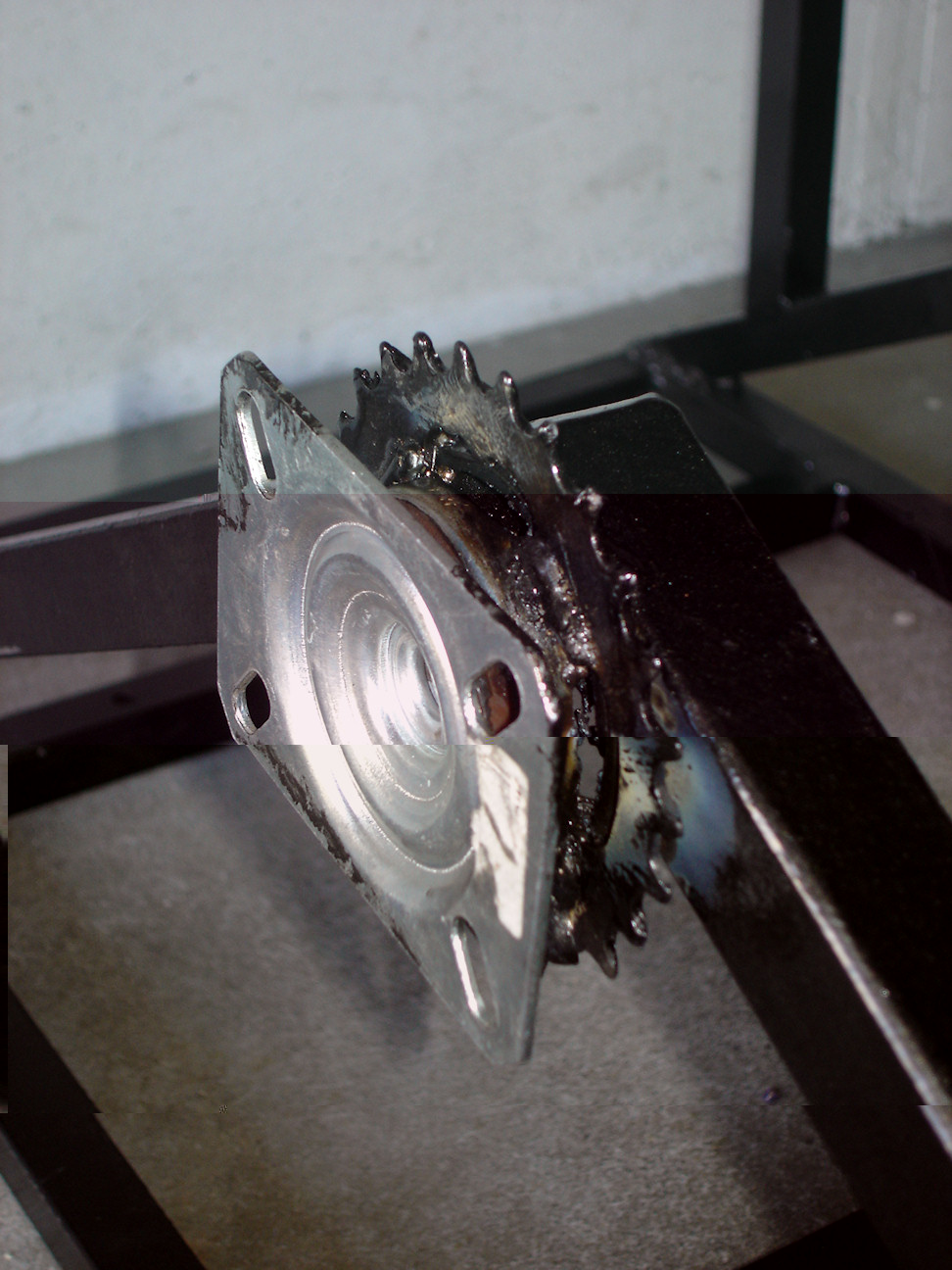

Axis with integrated cogwheel
Fixture of potentiometer (pitch)

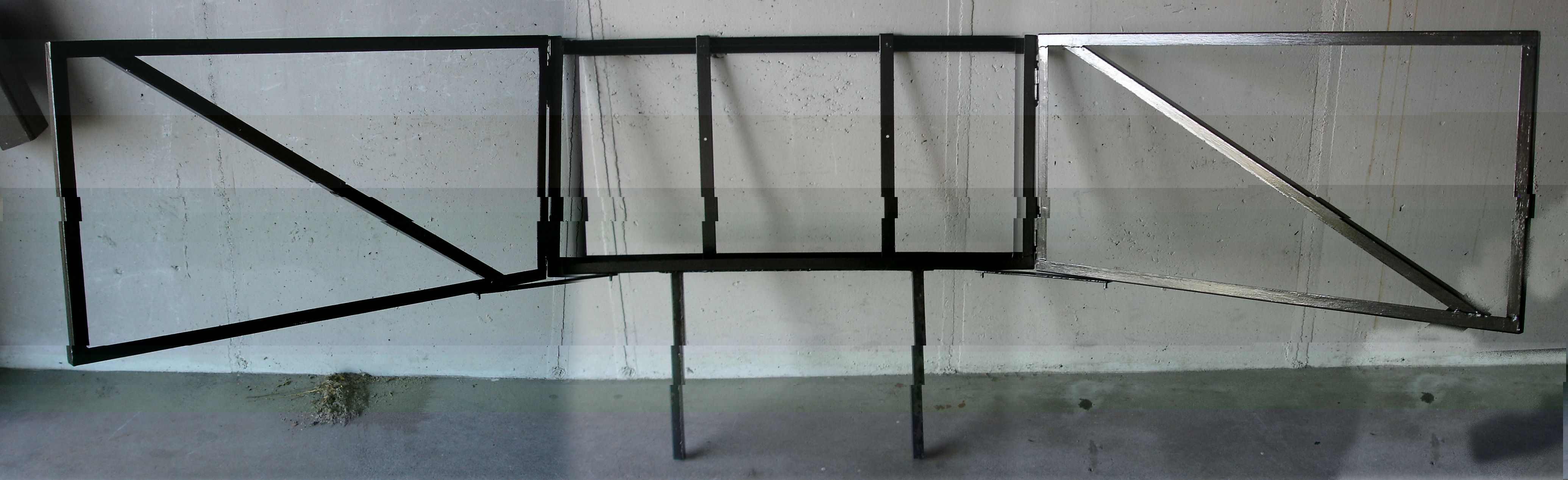

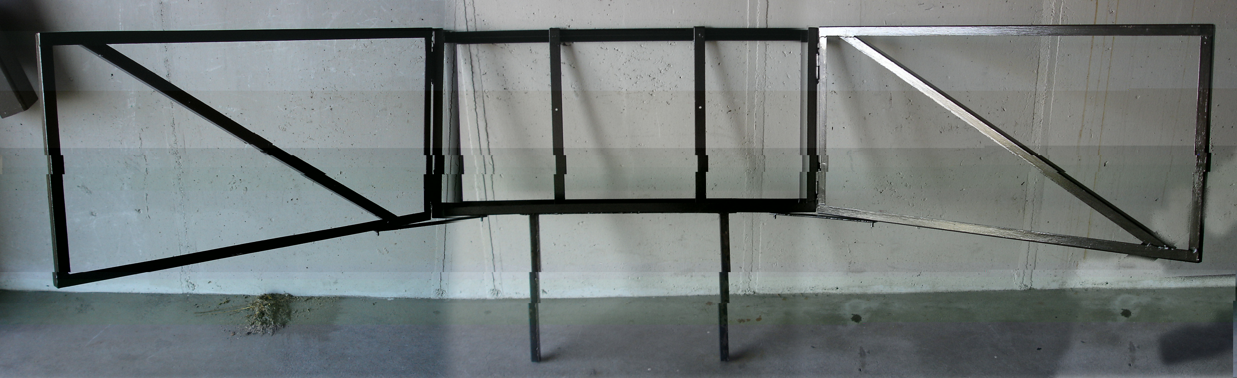

Screen Frame, 14.4 kg

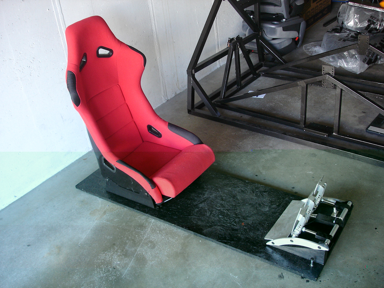

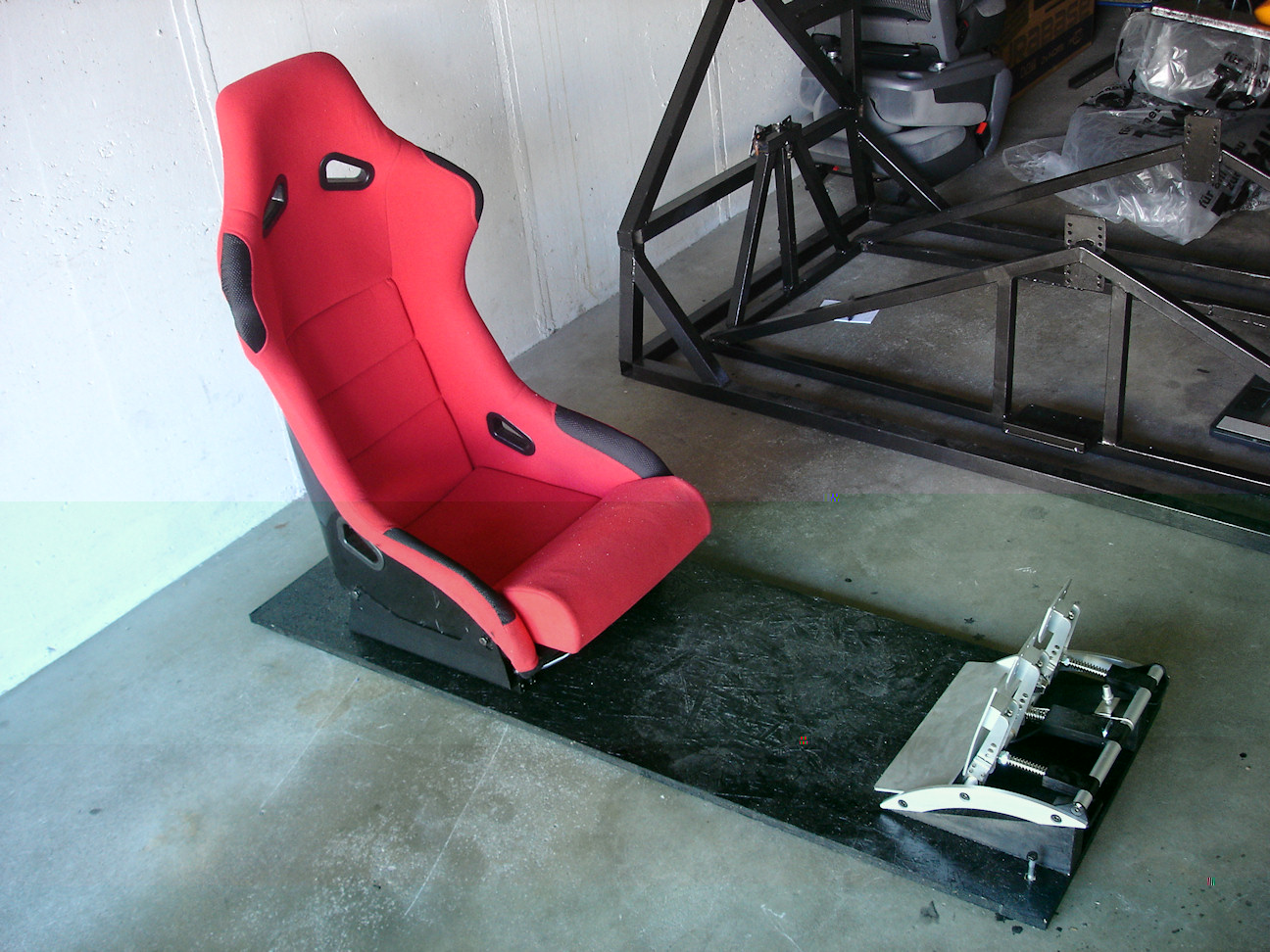

Seat (6.7 kg) and pedals (5.3 kg) on OSB (Oriented Strand Board, 14.2 kg)
I'm finishing the assembly and the wiring. Next will be the electrics and electronis.

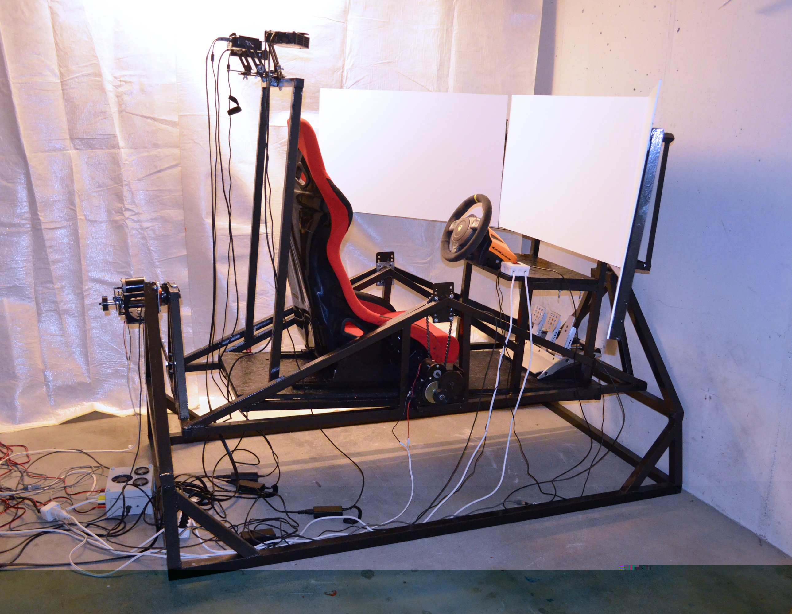

Re: Joyrider
Postby value1 » Sat 14. Jul 2012, 16:40

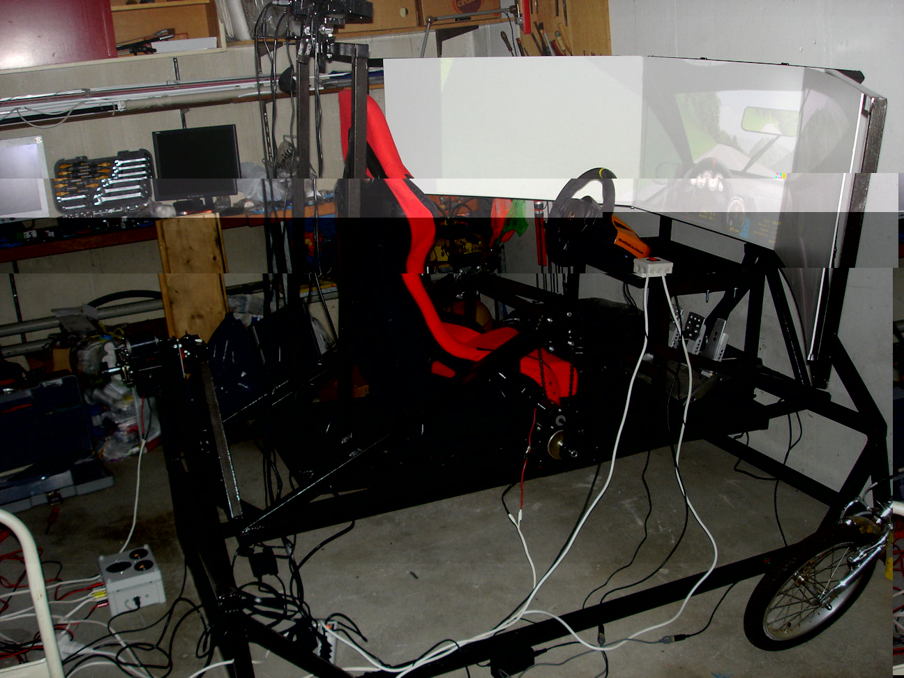

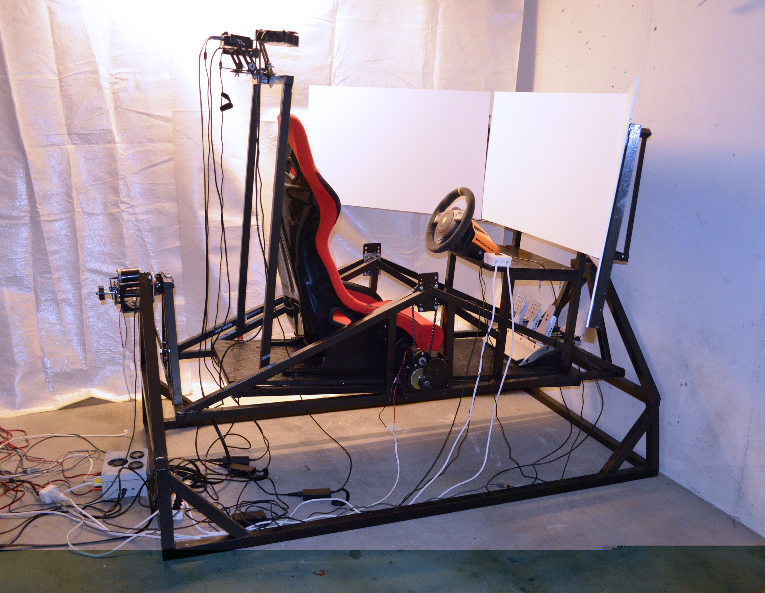

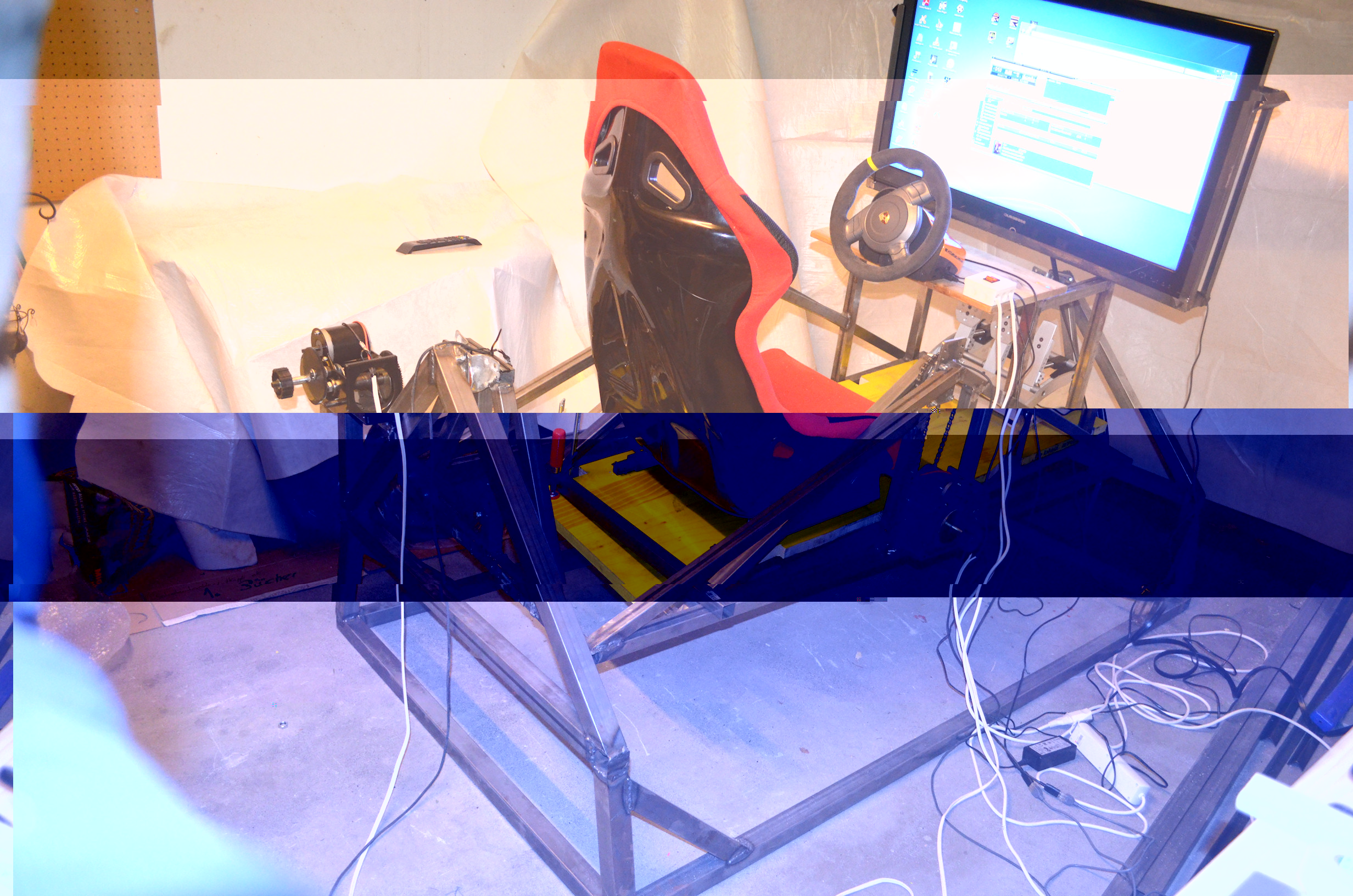

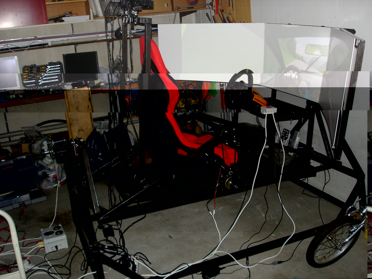

For today just another picture. The sim is moving again :D after being disassembled for refurbishment for several weeks!
I haven't any video footage as 1/ I didn't have time and 2/ even if I had had time I I'm not yet satisfied with the movements. In Dirt 2 it was semi-ok, in rFactor just crap. The tripplescreen is fantastic!
Overview all assembled (and moving)
The white box right to the steering wheel is my emergency stop. It just cuts off the 12 V power from the jrks. The grey box on the left on the floor is the two jrks with a blower. And yes, the cables need clean up ;)

I love this triple-screen projector!!! I bet its more lightweight and cheaper than using three LCD screens!!!

tronicgr wrote:I love this triple-screen projector!!! I bet its more lightweight and cheaper than using three LCD screens!!!
I love it too. It makes a big difference for the game immersion when driving!
• The previous 40" monitor was 13.3 kg, the monitor holding frame 7.2 kg. For a tripplescreen this would be around 60 kg!
• Now the whole frame for the tripplescreen is 14.4 kg + 4.2 kg for the three white PVC boards. Some of this weight is offset by the 1.2 kg (3x400gr) for the projectors behind the seat. Cost wise both options are about the same.
