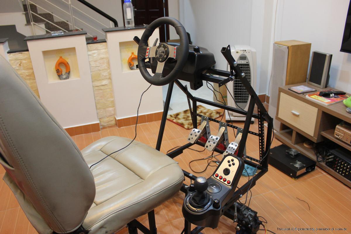

My motion simulator work with 2 wiper motor like RacingMat's projects !
*Update 1st May 2015 :
*Update 26th May 2015 :
<<<<<<DASHBOARD(finished)>>>>>

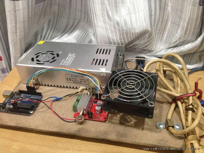

My hardware :
+ Arduino Uno R3
+ Moto Monster Shield
+ 2 wiper motor ( Toyota - used )
+ PSU 12V-30A
+ Logitech G27
+ some ...
My first test : ( successfully - thank RacingMat )

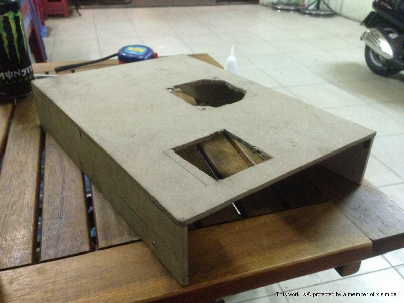

My electrical- box :

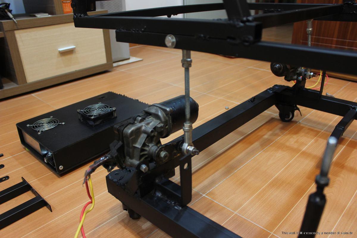

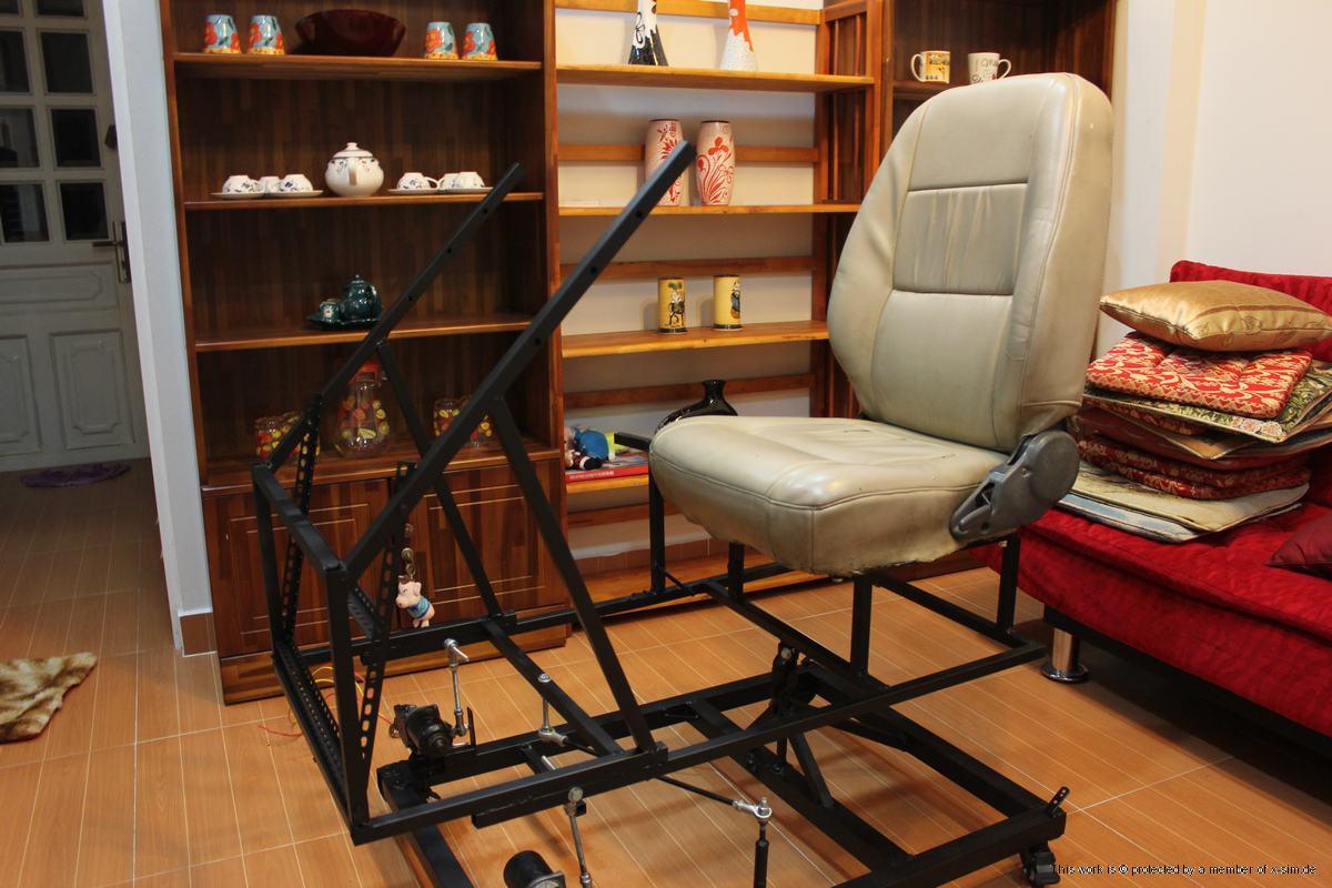

My motion platform in progress :
3698370736993700370137023703370437063708370937103711
My hardware :
371337143715 .

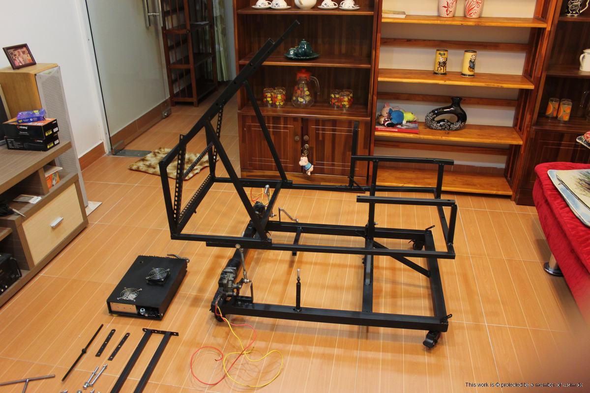

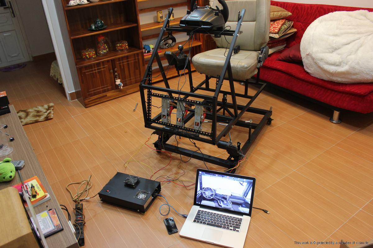

MY MOTION SIMUALTOR IN PROGGRESS :
Today, I begin to building parts together, I worked until 3:00 AM :( , but I feel happy and exciting :
3717371837193720372137223723372437253726372737283729373037313732373337343735
Tonight I will record my first testing, waiting ..... :D
Update 2/4/2015 : Upload my first test video :
I do not good at writing English so I couln't show you more detail about my project, hope you feel good and excuse me .

Postby cubizme » Fri 22. May 2015, 20:52

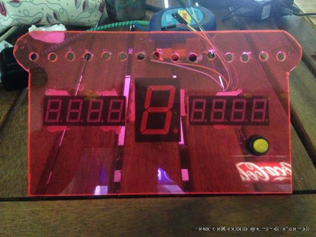

My dashboard graphic ( progressing ) :
3764
My working :
3765
3763

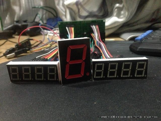

GEAR which I use pin 6,7,8,9,10,11,12 to control led 7 segment, very simple wire, simple code, no need external power supply :D !
Shiftlight I replace 2 leds RG(pos 6,7) by 2 led RGB.
Total 15 leds of shiftlight ( mirror effect )

Today I almost finished my dashboard :
3766
3767
3768
3769
3770
3771
3772
3773
