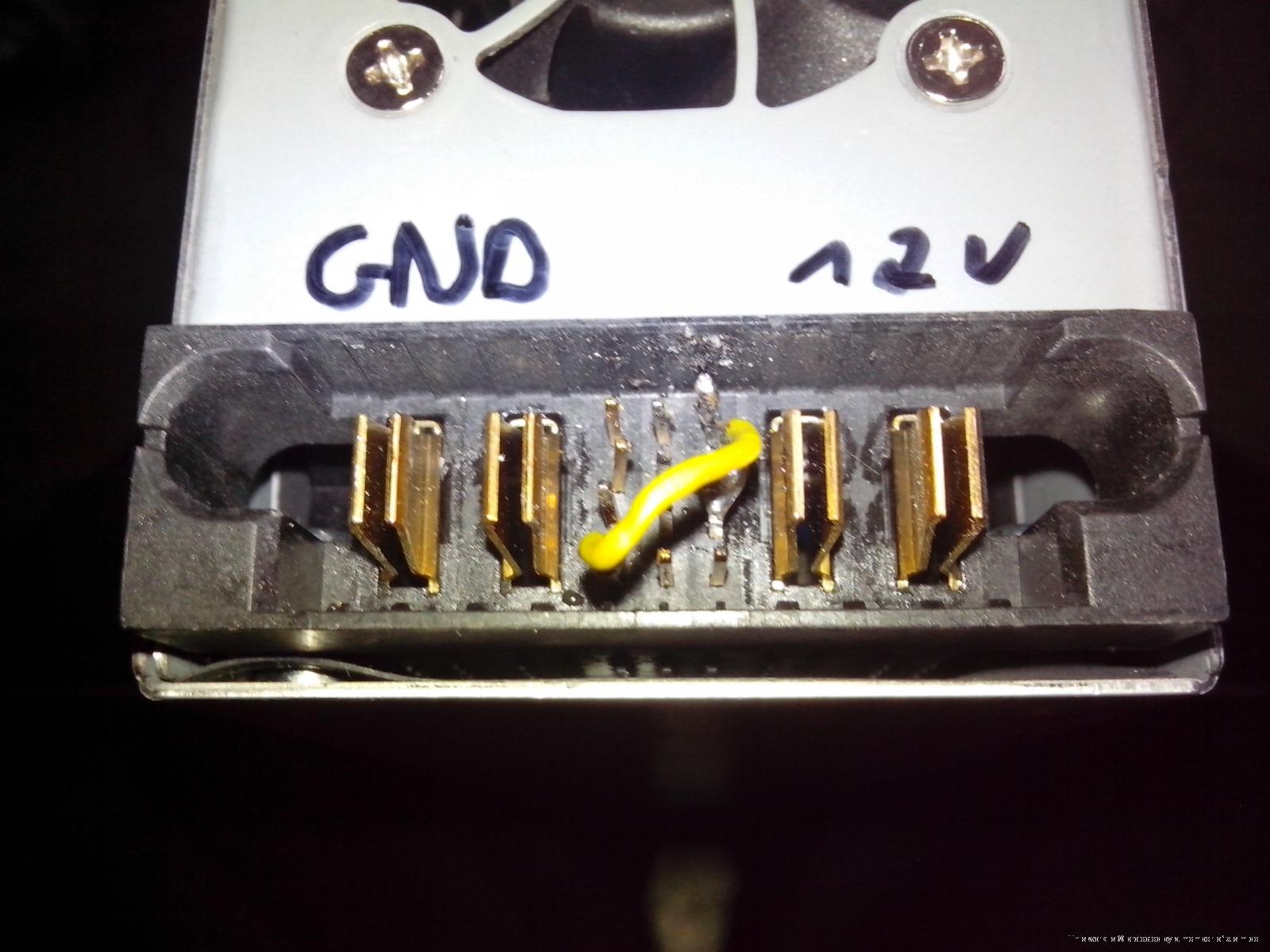

The HP Server DPS-600PB will not work if you don't connect some pins.
More information, you can find here: https://sites.google.com/site/tjinguyte ... ects/HP47A
3333
After I connected the pins, I had 12.6V.
I also connect Pin 4 and 8 of the psu.
(The psu powered on the fan started spinning at 100% without it. So I shorted pins 4-8 to reduce the fan rpm to minimum. The fan still spins up when needed but stays quiet when the psu doesn't require cooling.)

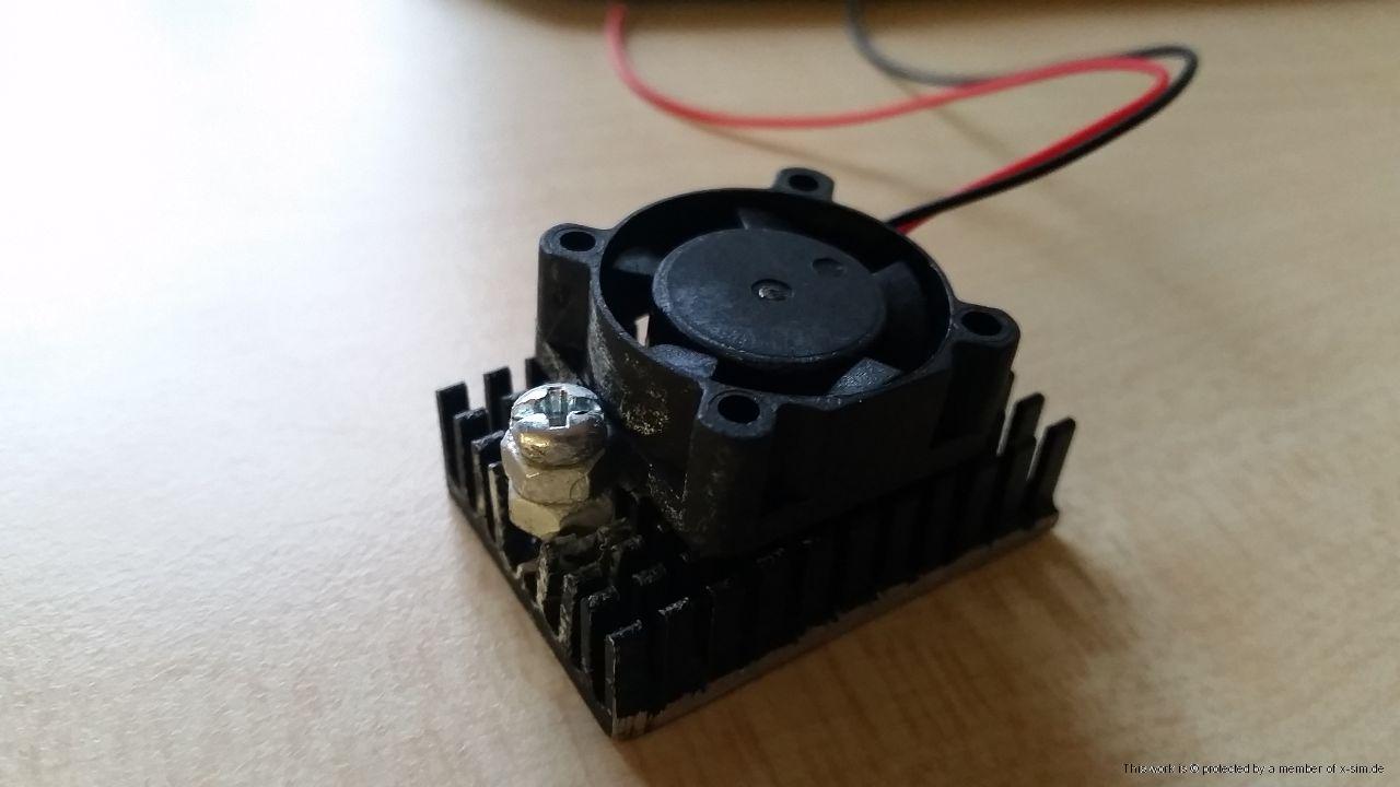

Place a heat sink on the shield! I have also a ventilator on the shield, for maximum cooling.

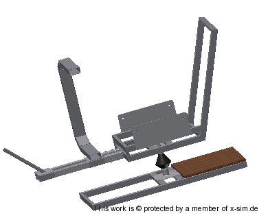

I’m working on the design of the structure. The complete drawing will follow soon.
This is one piece from what I have for the moment:
3332

And Pin 4 and 8 of the psu. (The psu powered on the fan started spinning at 100% without it.

I bought this: http://www.benl.ebay.be/itm/32127879964 ... 1439.l2649.
This DC cooling fits perfectly on the Moto Monster.
