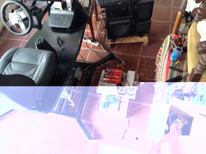

Now for the "forum" part, haha. I got about 1 hour play time out of this baby and the cheap ass bushings on the output shafts of the motors developed enough play that the sim was constantly pulsing (because the pots thought the chair was supposed to be moving). This thing was a blast for that 1 hour though! I now have some different motors on order, gonna redesign that area a little and try and mount the pots a little better (sorry i forgot to take pics of the current pot setup). Anywho, let me know what you guys think! If you have any questions or suggestions hit me up! :mrgreen:

Good job. That looks awful similar to this:
Or maybe not... ;)

Haha, you have waaay too high hopes about it :P. Hopefully get a little more structural integrity out of it with a better motor setup but it's still got a long ways to come before it's that pretty :)
