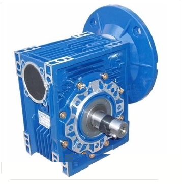

The gearboxes are being made in China at the moment (60:1, 450Nm, dual output shaft) ($150 each)
