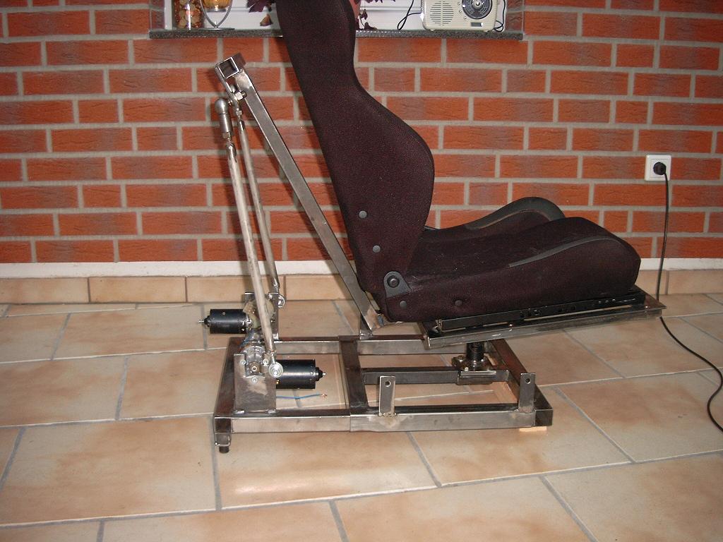

this is my Simulator, build the last 4 years, that was presented also at the old Forum. Powered by the old AMC 1.5 and DSMhb from Thanos.

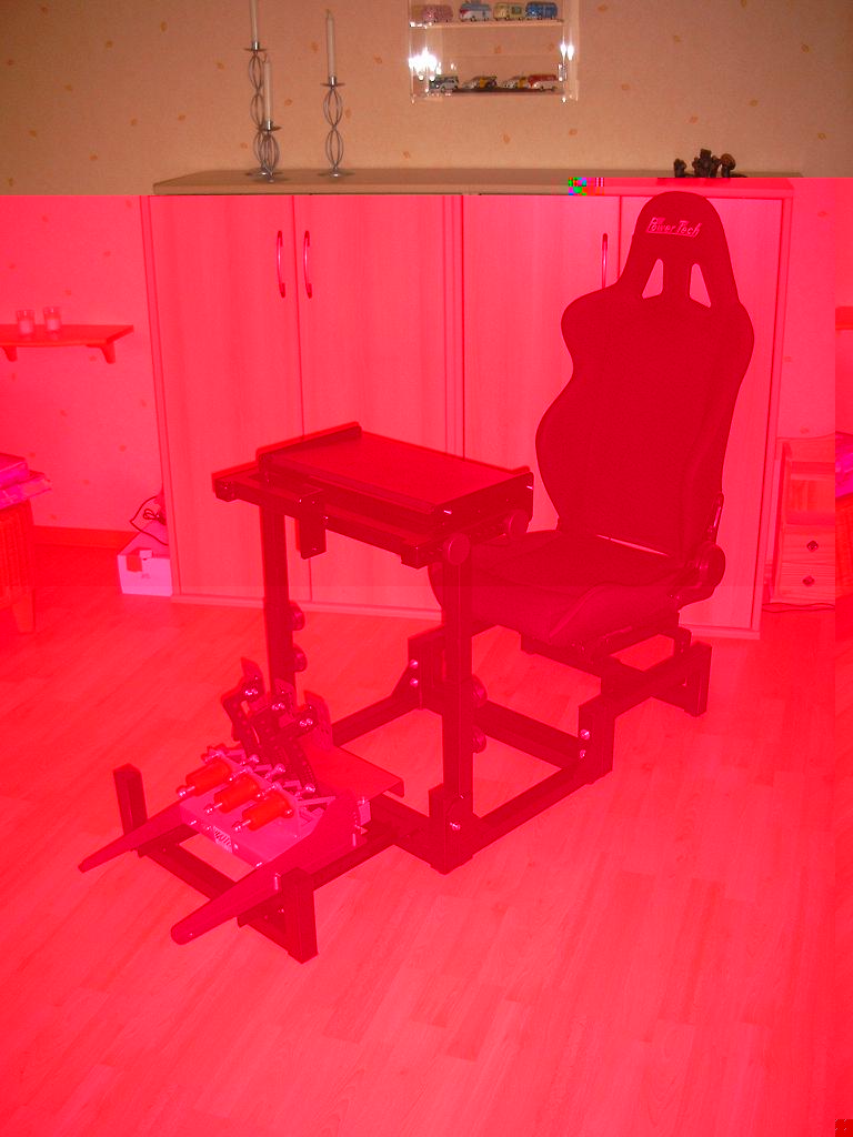

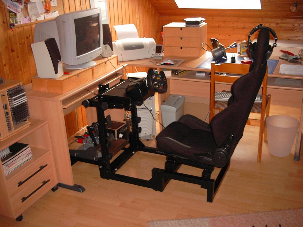

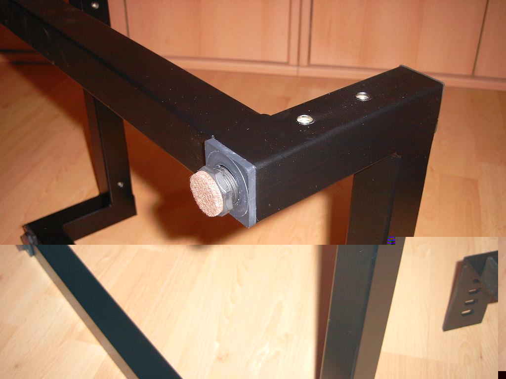

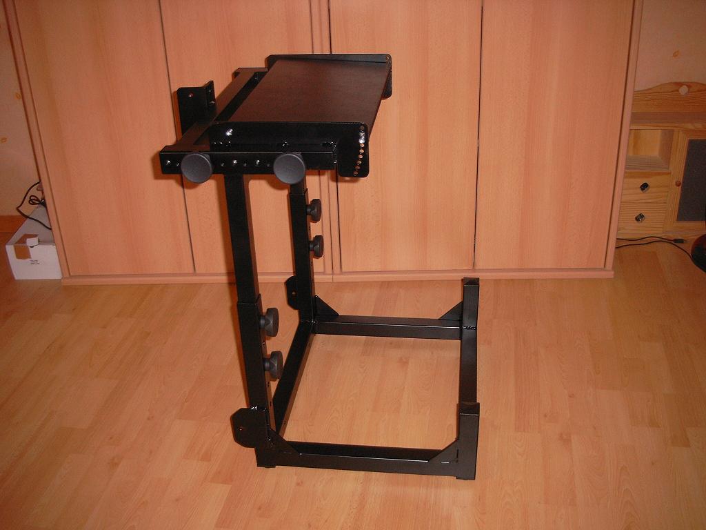

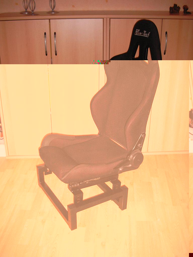

This was the look from my Rcing-Rack before getting movements. I have build them on my own and looks like the commercial VPP-Professionel-Racing-Rack.

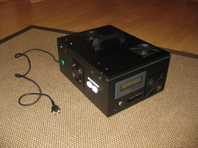

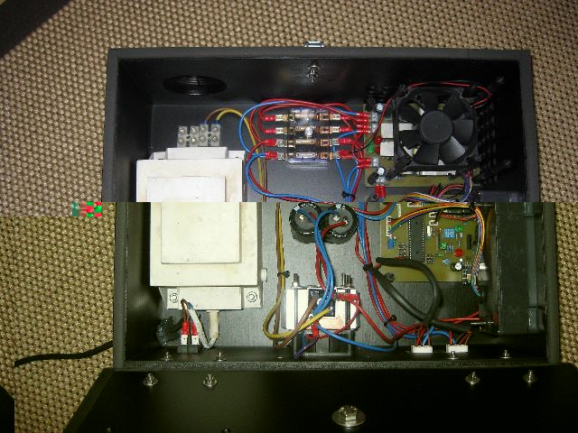

This is the House for my electronics :D

and now I want to update my Simulator with stronger Motors in the next weeks. At the moment i`m using light Car Wipermotors and i think they have reached their limits (already at the beginning not optimal) and meanwhile the wormgear (plastic inside) had some play in the mechanics. i found some Golf Trolley Motors and the Specification of them is, 12V, 15A, 180W, 177rpm (wormgear), 25:1 gear ratio, Rated Torque 5,5 Nm and Peak Torque 64 Nm :brows: , weight 3kg :eek:

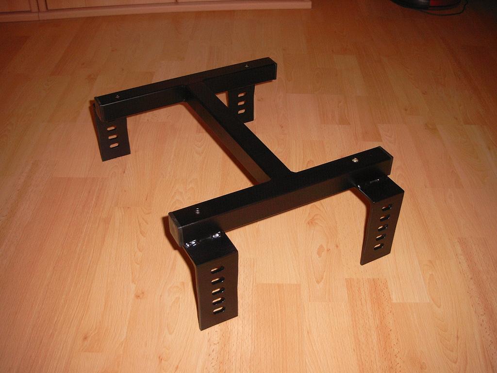

Postby Michael » Mon 9. Jul 2012, 17:31

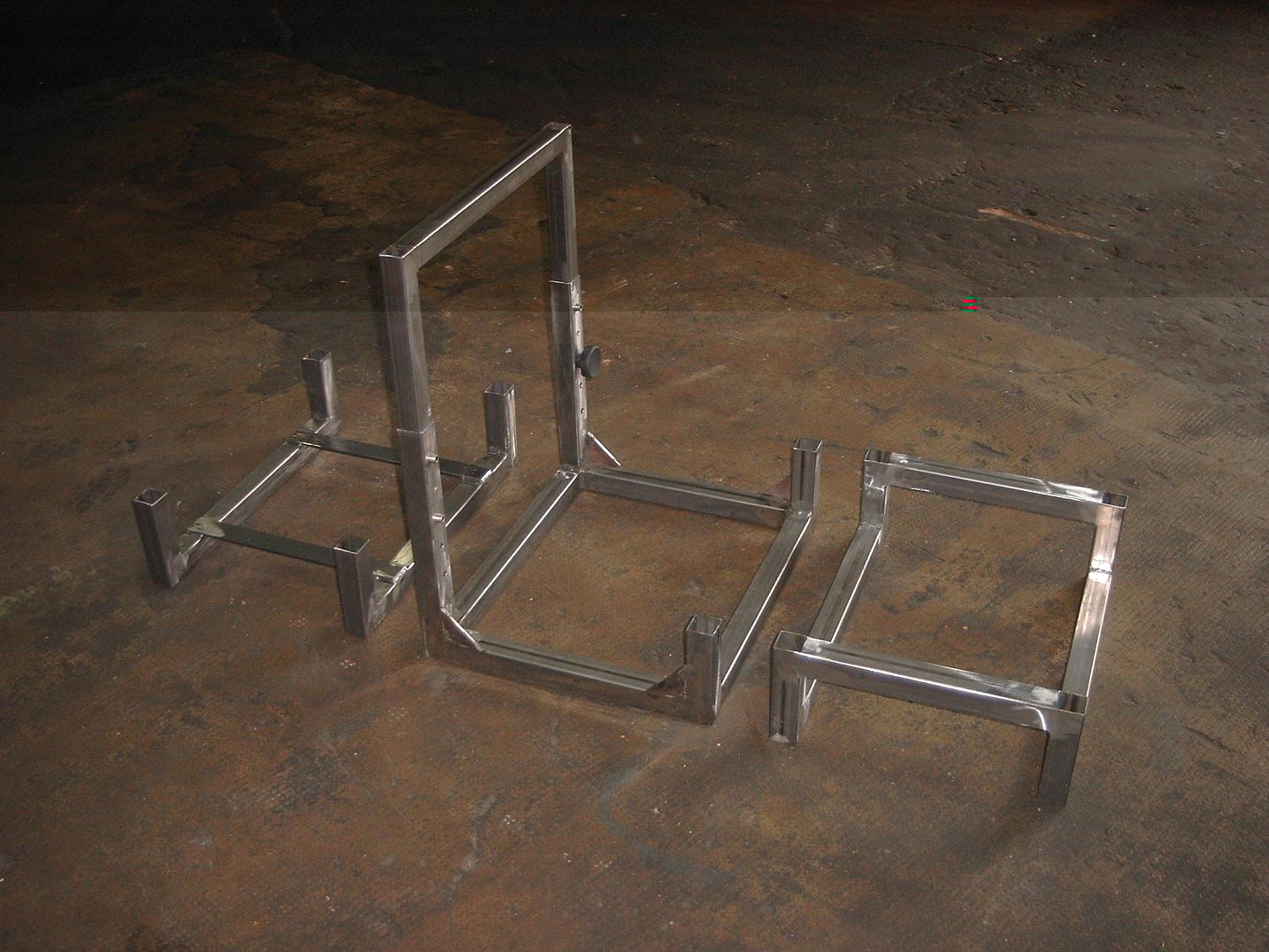

here some old Photos from the building phase of my Standard Racing Rack.

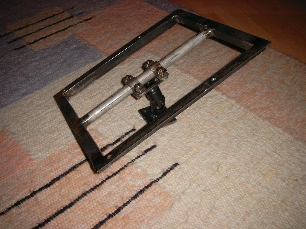

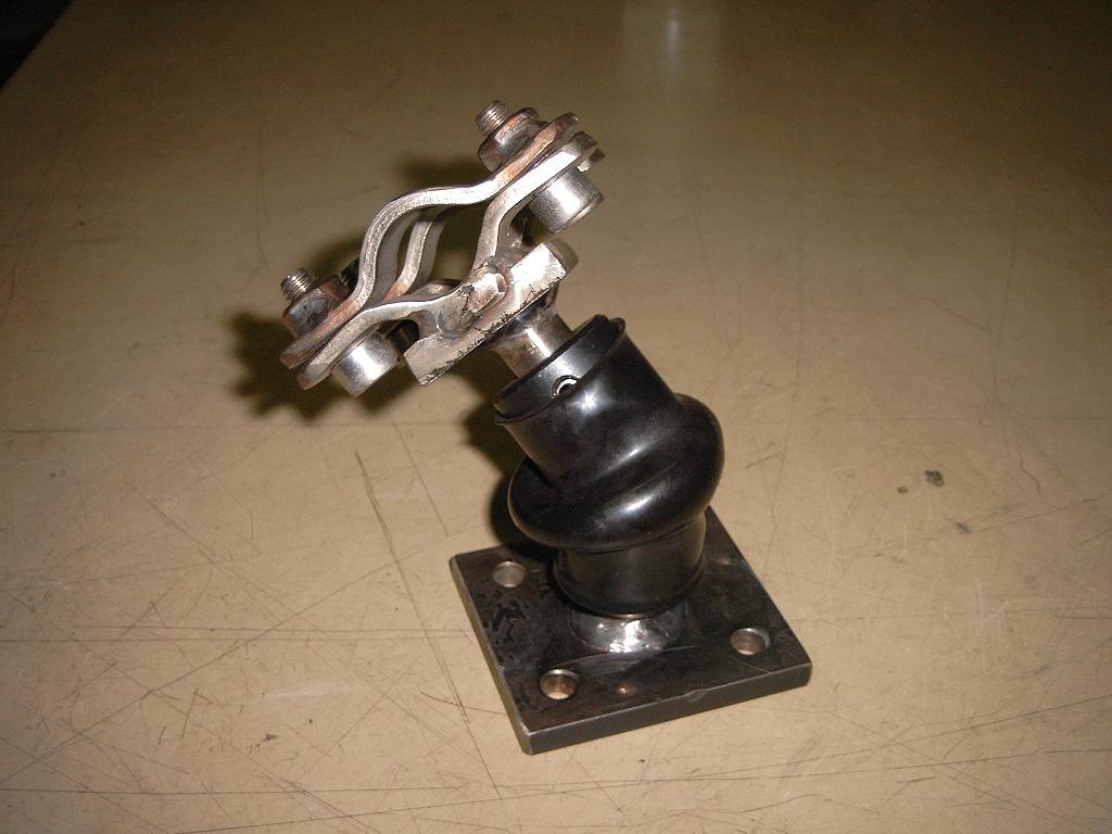

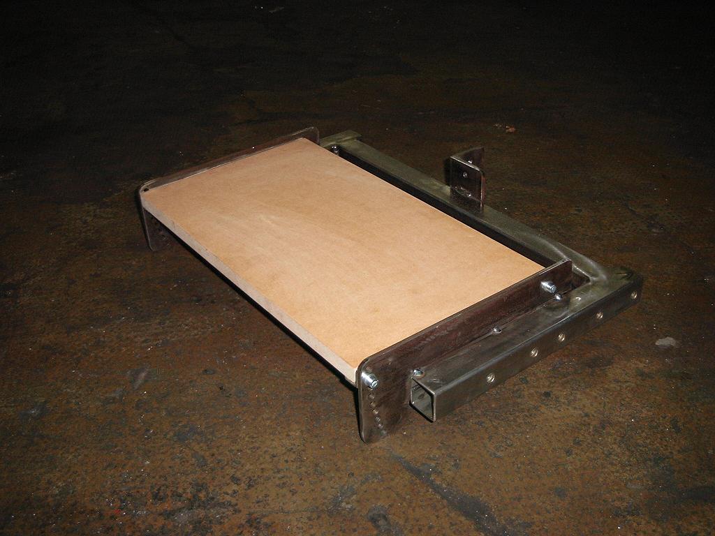

Postby Michael » Mon 9. Jul 2012, 17:35

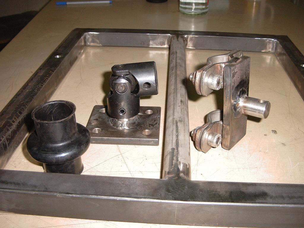

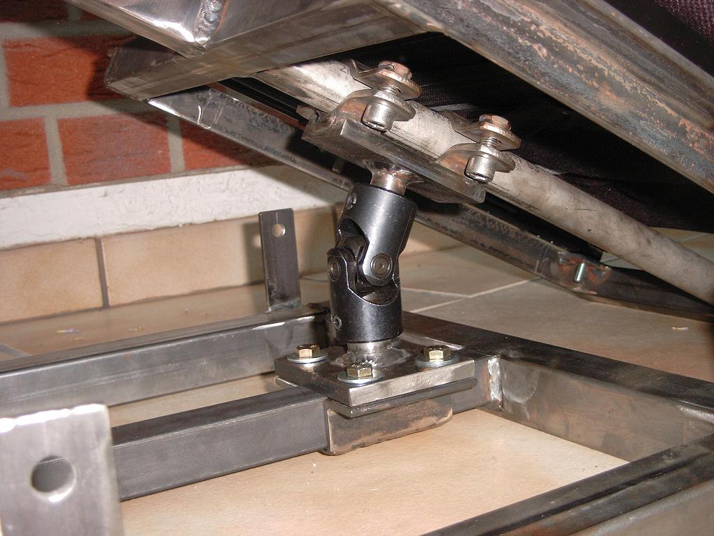

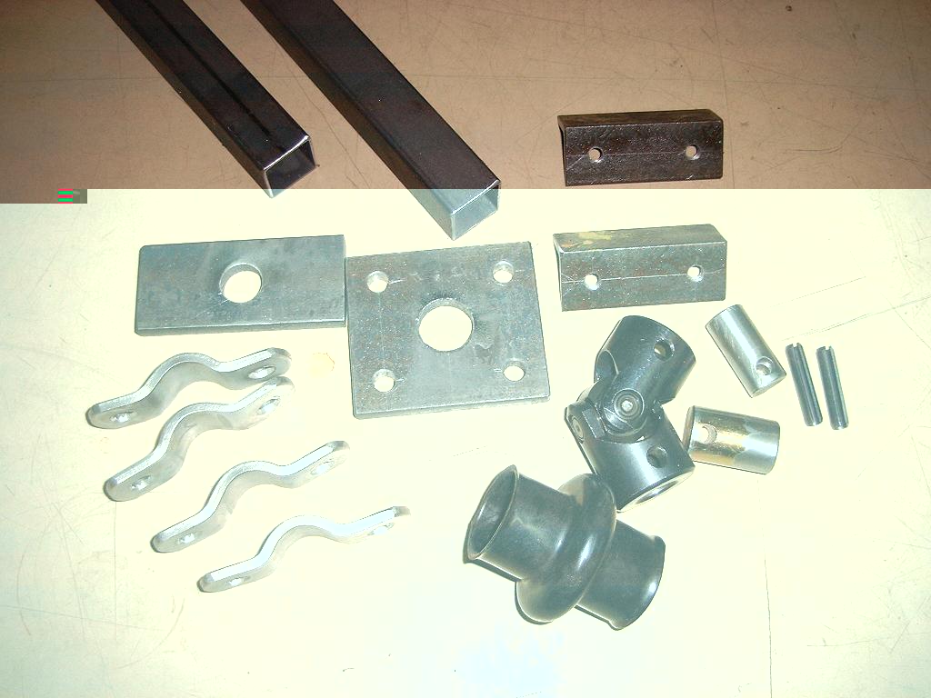

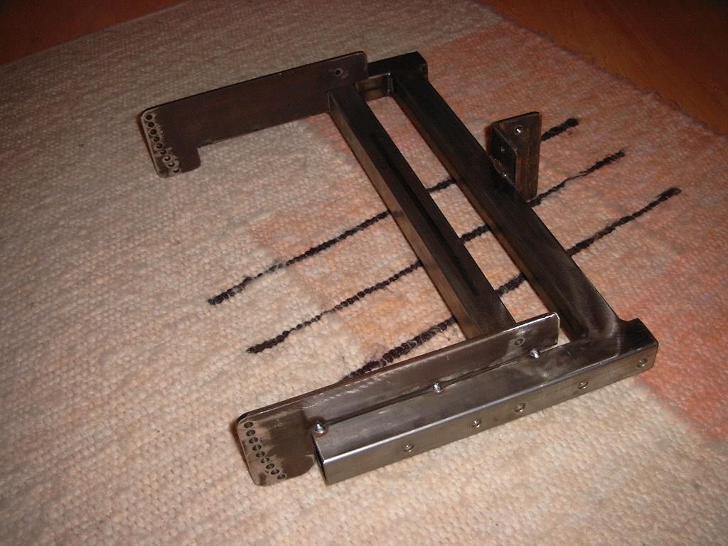

and here you can see Photos how i make the stiff Racing Rack to become Movement :) .
needed Parts
Pivot
Adjusttable Pivot
Adjusttable in 2 direction
That was the first Design, now i have a another angle and the lenght of the arms is much more. As you can see in the Video above

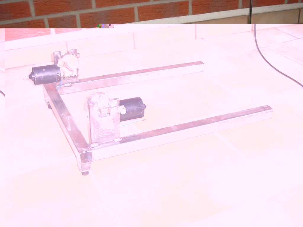

here a current photo comparison of size of the old carwipermotor and the big golftrolley-motor :o . The carwipermotor has half the size of the golftrolley-motor.
