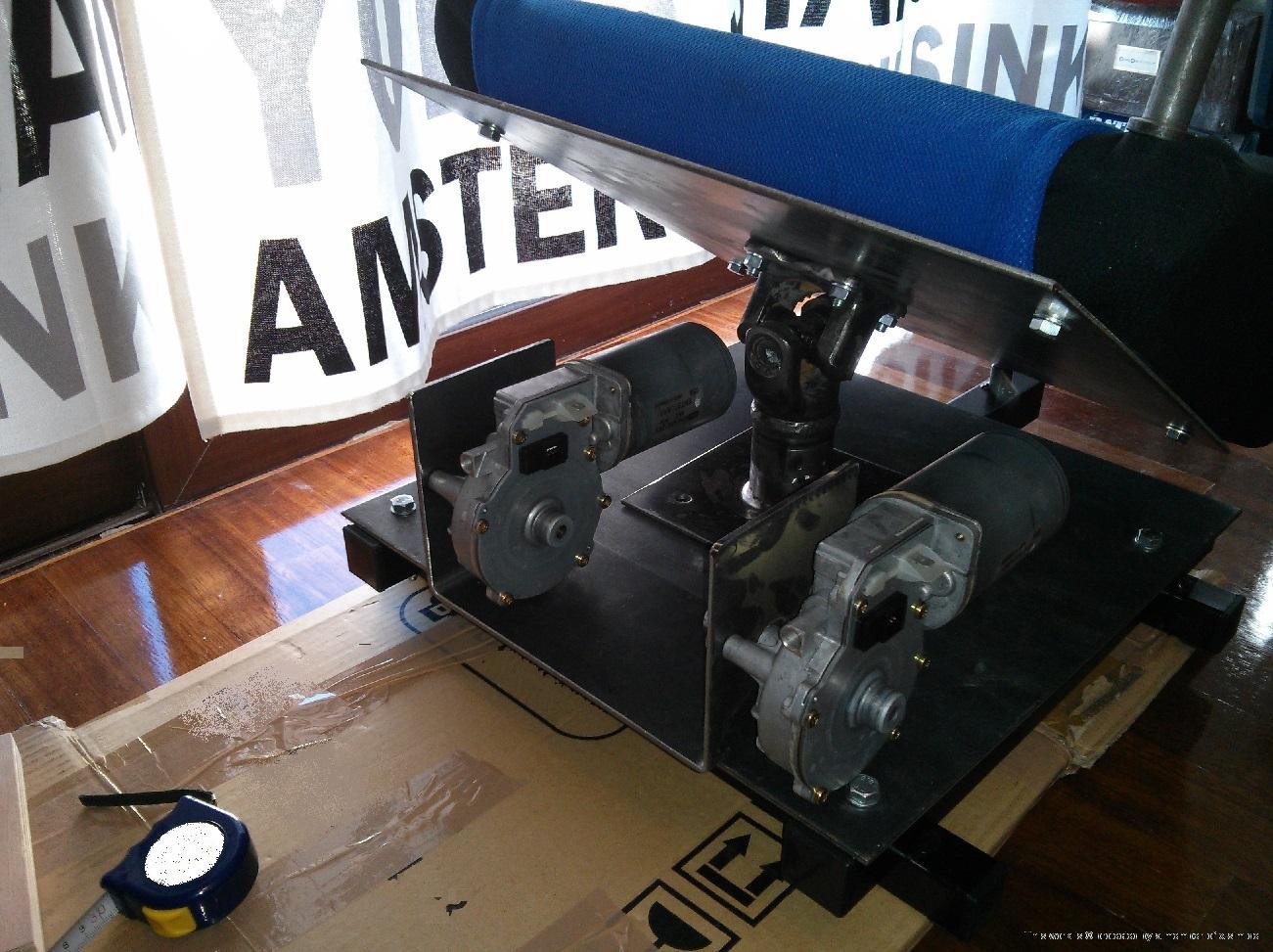

Motor chassis with wiper motors under the seat.
3004
closeup on the motor chassis. check the drilling details.
3005
both motors mounted.
3006
Motor chassis placed under the seat.... very tight fit ... (i hope all calculations are right).
3007

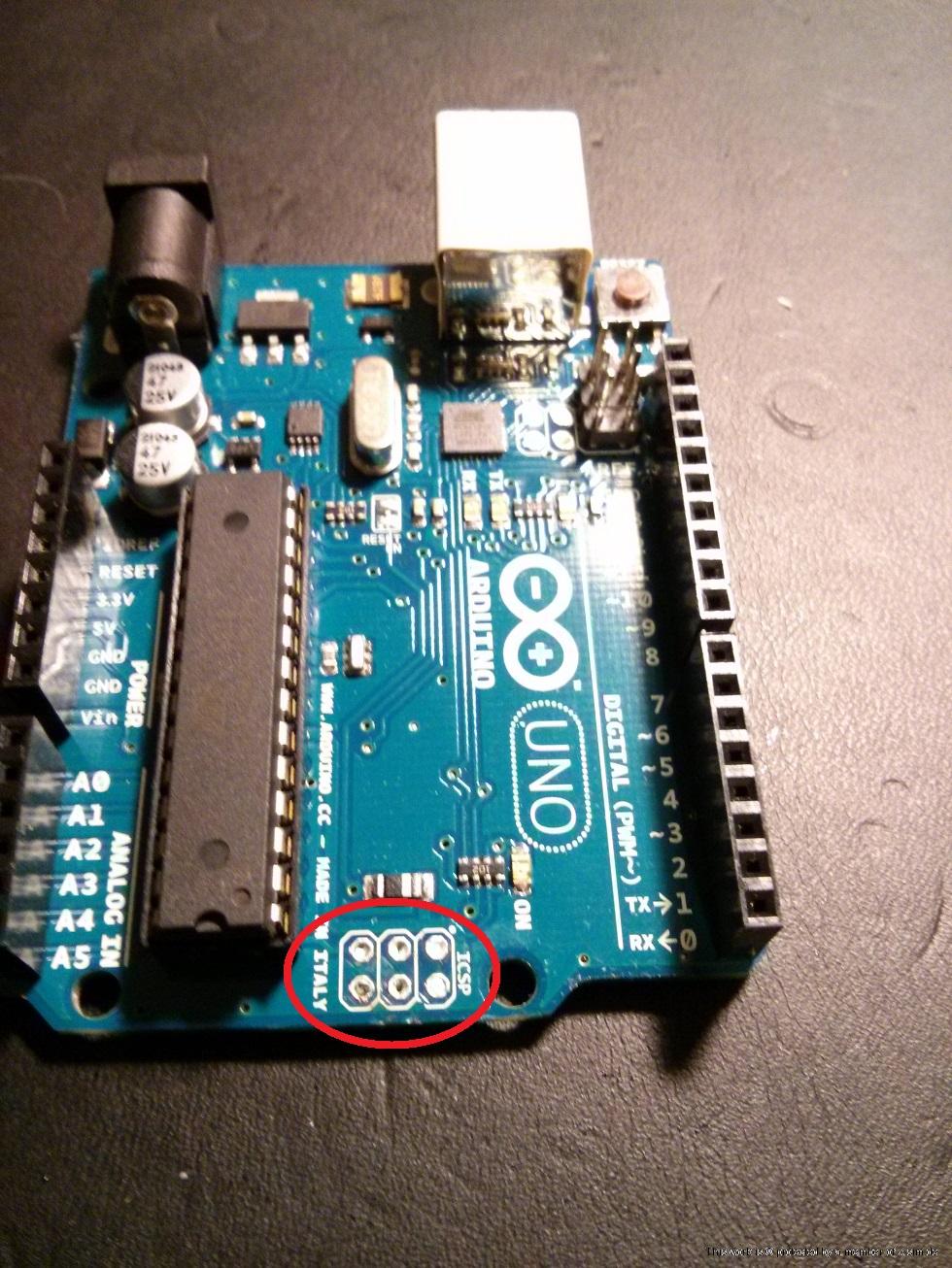

After some soldering and fitting ... i noticed that a ground pin from Pololu Dual VNH5019 was in contact with arduino usb chassis.
3097
Just to be sure i used some tape on both the arduino
3099
and Pololu Dual VNH5019
3098
Taking a look at the arduino board ... six ICSP pins seem to stand very close to the power input/output of the Hbridge (which sits on top of the arduino board).
3257
After removal
3258
arduino+Hbridge
3259

As an extra precaution i used a USB isolator to keep my computer safe-er:
3603
Even though both the h_bridge and the wipers can work with 24volts, i will try some tests with just one psu and see how it goes. To my surprise one psu (12v) seems to be more than enough.
My suggestion is that even if u are 100% sure that everything is correct NEVER test the motors for the first time connected to your chair, or something like this may happen(if your settings are not correct):

I started testing with the code provided by Racingmat in his project just altering the lines suggested by Tombo in this post to account for the pinout change for use with the pololu vnh5019 Arduino shield.
Of course some changes need to be made (to trim sensitivity and control) to account for the 2,7:1 ratio between the motor axle and pot axle.
3666
3673
After some testing i am glad to say that the motion is so intense and accurate that exceeded my expectations.
I dont think there is any need for more than 12volts. For the moment at least.
