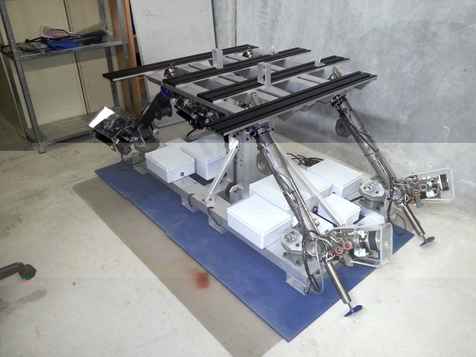

A more recent picture of the simulator.
Electronics further implemented and more safety features installed.
4DOF Sim - Electronics 90% installed - Shown in full down position

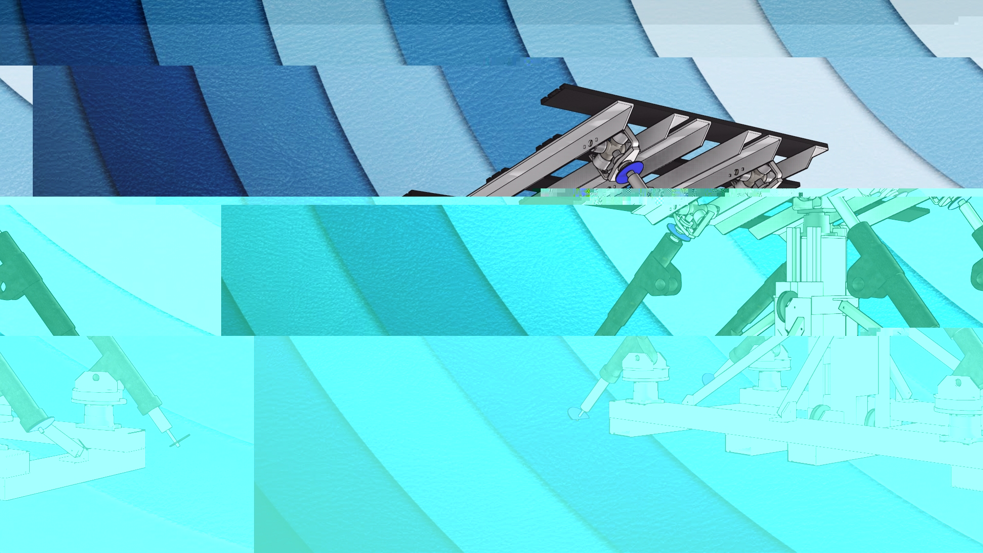

Further CAD work (with a view to possibly implimenting a Matlab/Simulink application for testing).
Inventor model of simulator - Mechanical properties added to assemblies

The most I've set them to at the moment is 0.7Hz sinusoidal motion (full travel just under 300mm), but with the servo specs stating max constant speed at 3200 RPM, I'd hazard that I could move them at least twice that speed (at usable torque). Although I really wouldn't like to be on the ride for that kind of motion :)
BTW - The gearing is set at the moment to approx. 1:12 reduction (1:4 reduction belts/pulleys and 1:3 reduction inherent in the steering rack unit)
...possibly for small movements, yes - the higher frequency could be used for vibration reproduction (engine vibration, touchdown, ripple strips, stones, etc.) but I'm not that far into the software side just yet.
Also, I really need to make sure that the frame is up to the task. I used to work on helicopters and I know just how much havoc that constant vibration can cause on structures and fasteners. ...lots of testing needed

Yes, the servo is attached to the steering wheel input shaft via a reduction timing belt. You can make out the belt/timing pulley rotation at the base of the actuator.
I've just uploaded an early video on YouTube for you to look at:
Note: It starts off a little slow, but it moves faster towards the end (more comments on the YouTube page)
It's an early video, showing a single actuator under manual control. I was a little reluctant to do much more at that stage due to fear of damaging the racks (if I hit the end stops at full speed). It gives a good impression of the speed and response though. Very crisp.
