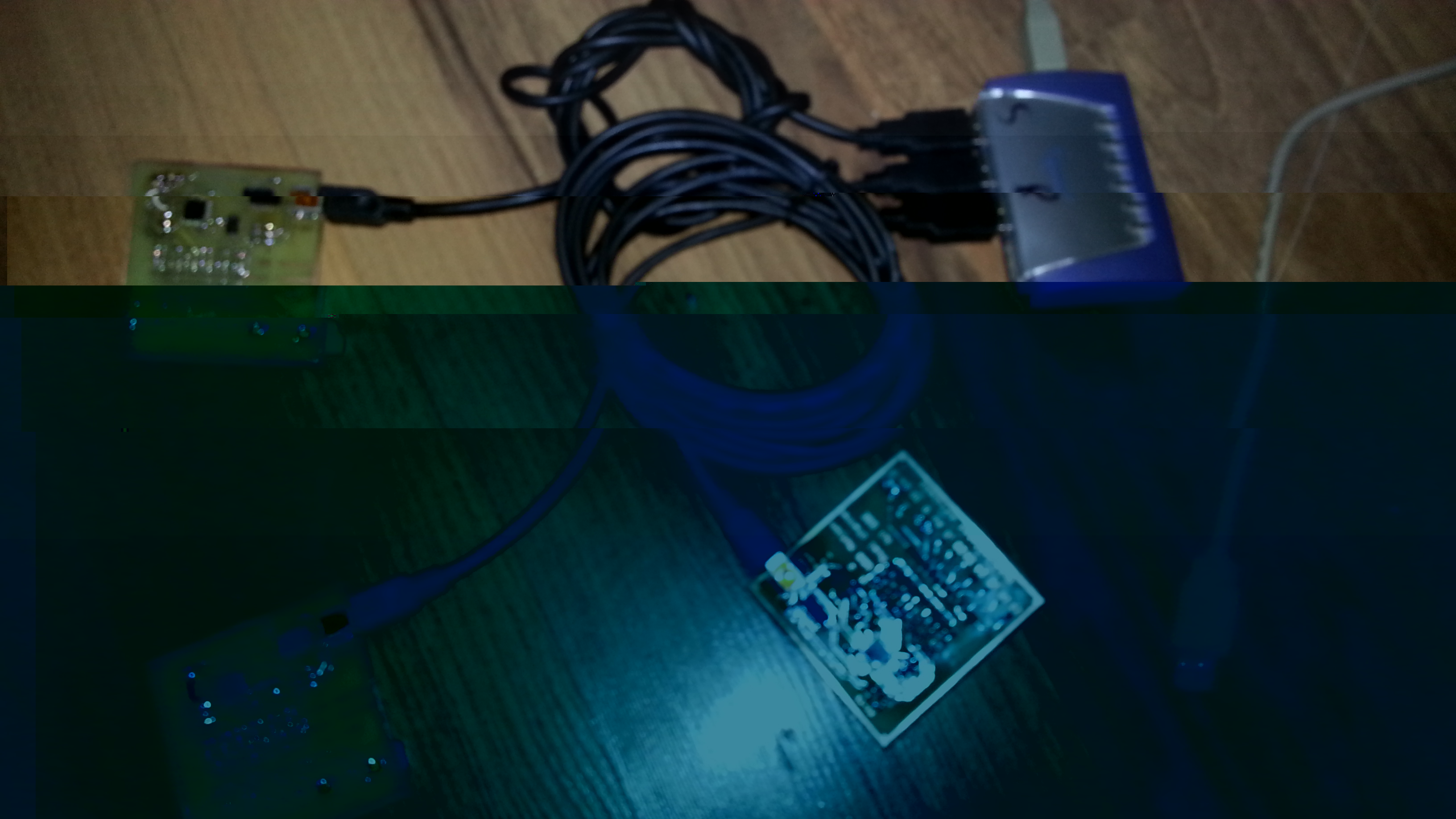

I want to do a 6 dof setup using xpid . If someone want more information feel free . i hope it will drift :))
pcb
under construction

Postby gerad » Sun 2. Feb 2014, 13:34
arduino duemilanove boot as base , ft232rl for ttl , opto dir and pwm to analog . no extra power . 24v & 10v are from vfd .

Postby tronicgr » Mon 3. Feb 2014, 20:07
Good job, did you manage to get linear analog output from the PWM? I think near the edges the signal it becames flat because of the optoisolation. I don't use isolation at all and real DAC for the analog signals, and never had any issues with leaking currents.
Also you will have to synchronize a little bit the 3 arduinos (three seperate COM ports)... ;)
Also make sure to use an emergency power cutoff for the AC motors, they are not toys!!!

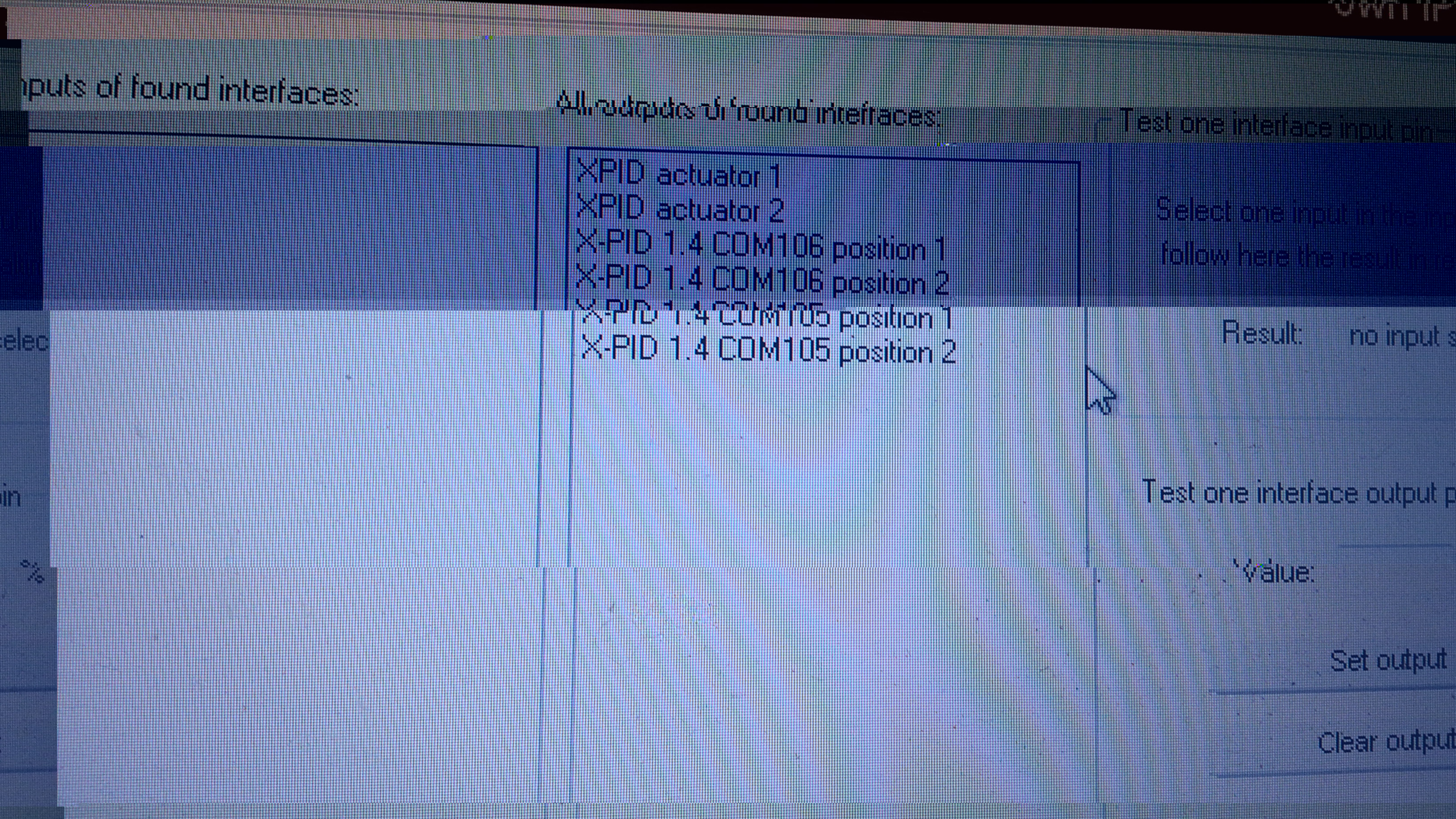

i rename the channels , put them in the 6dof plugin but i need more in math setup i think.

Postby sirnoname » Wed 5. Feb 2014, 17:38
Yes, you need the setup of thanos 6dof hardware plugin. You run this plugin in software simulation mode. The first step is to get the software simulation working perfectly. Then (if the 3D simulation works) add another 6 axis in math and on top you can add on each the 6dof math plugin (this will wrap the 6DOF motor HW plugin results back to the math setup) where you get the calculated motor output of the 6DOF plugin. This output you can transfere to a XPID output or you can use them for analysing.
OR
You write a own 6DOF plugin inside the XPID sample dialog ;)

Postby tronicgr » Wed 5. Feb 2014, 19:51
Hi Gerald,
Just suggestion... try to avoid using USB hub to transfer fast data packets to your arduino boards. There will be a bottleneck there where the USB controller is trying to handle the massive amount of data between the three usb devices. I had packet drops or even USB controller driver freezing on the hub sometimes. Connect each USB directly on a USB port on your computer (add USB expansion card if you don't have enough).
You can use USB hub for other peripherals like joysticks, mouse etc... they have higher latency requirements.
Thanks
