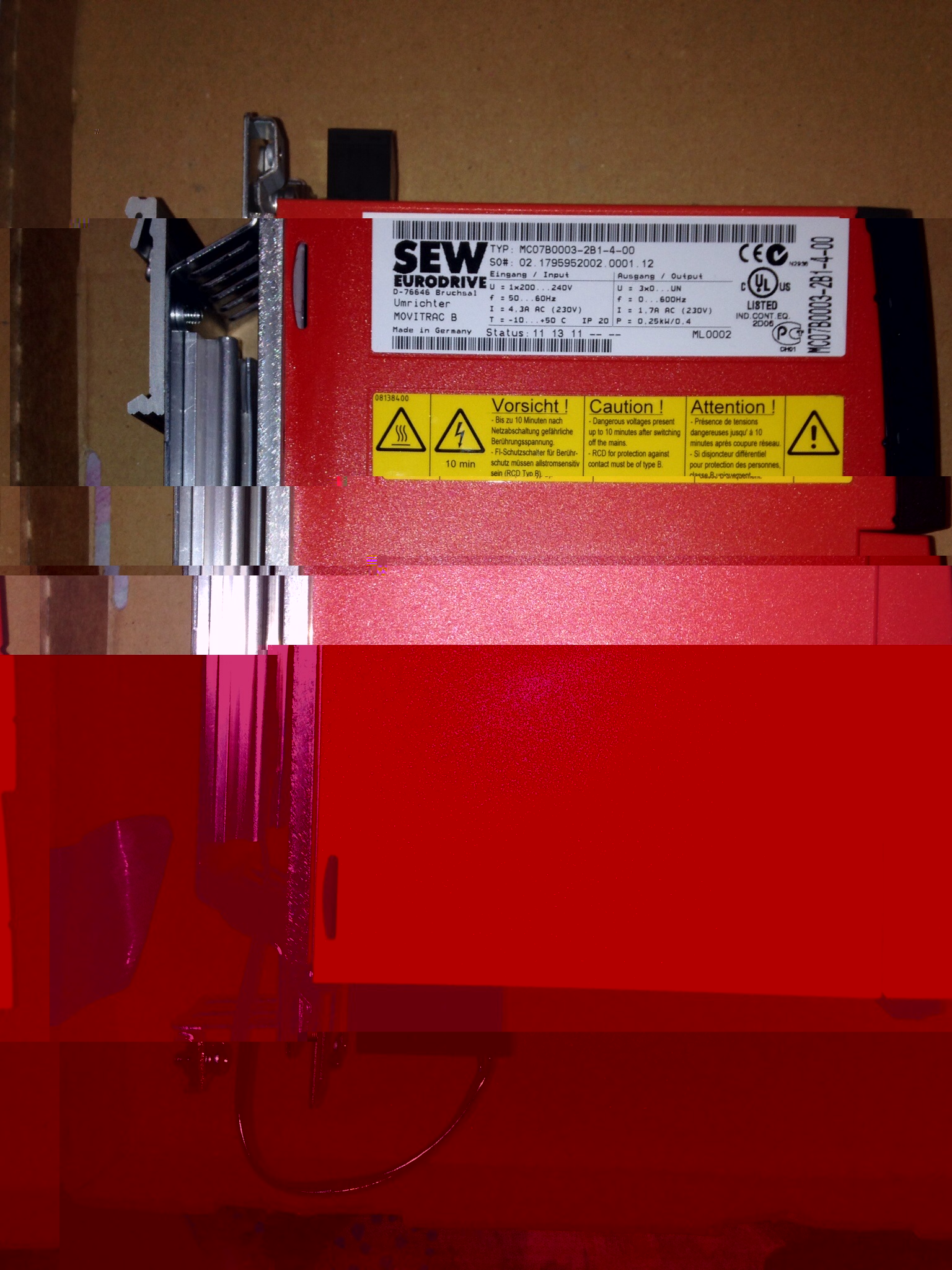

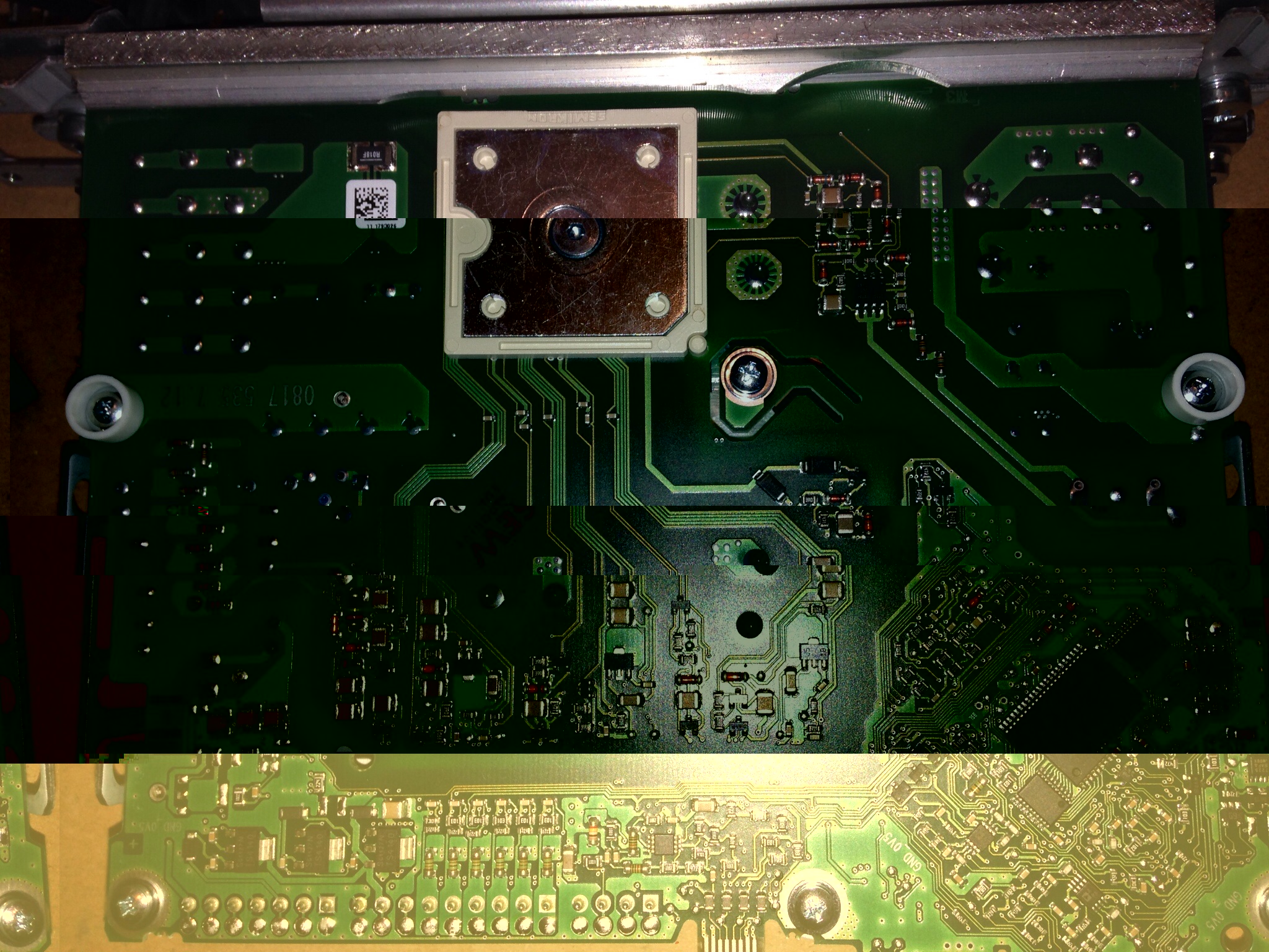

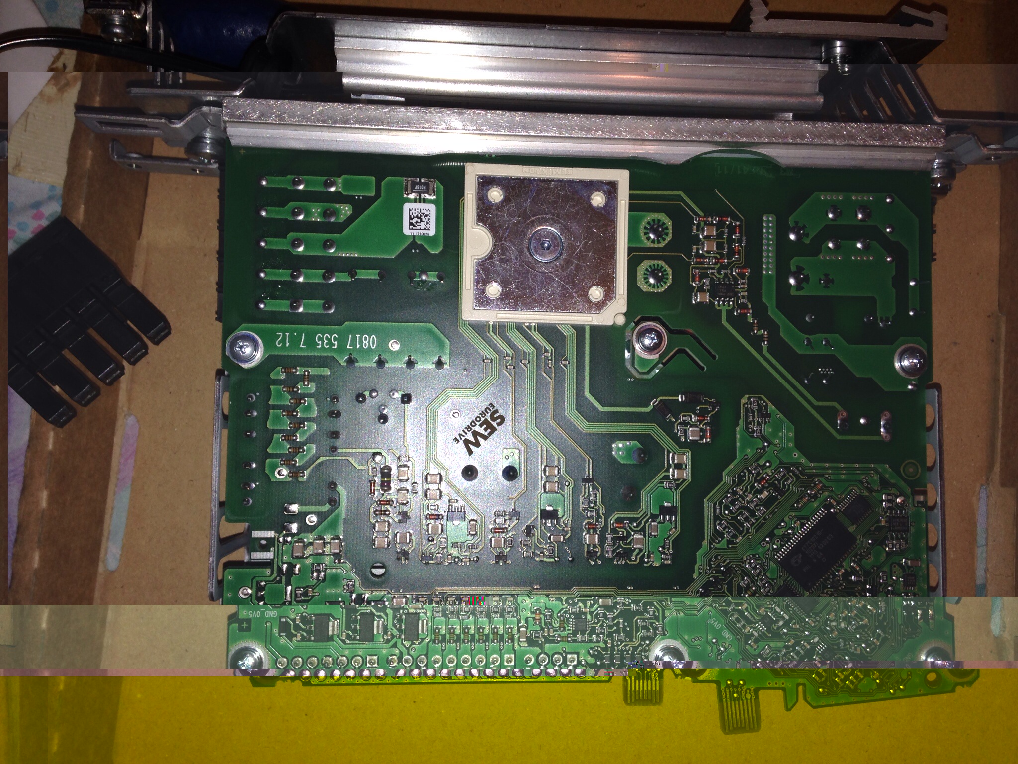

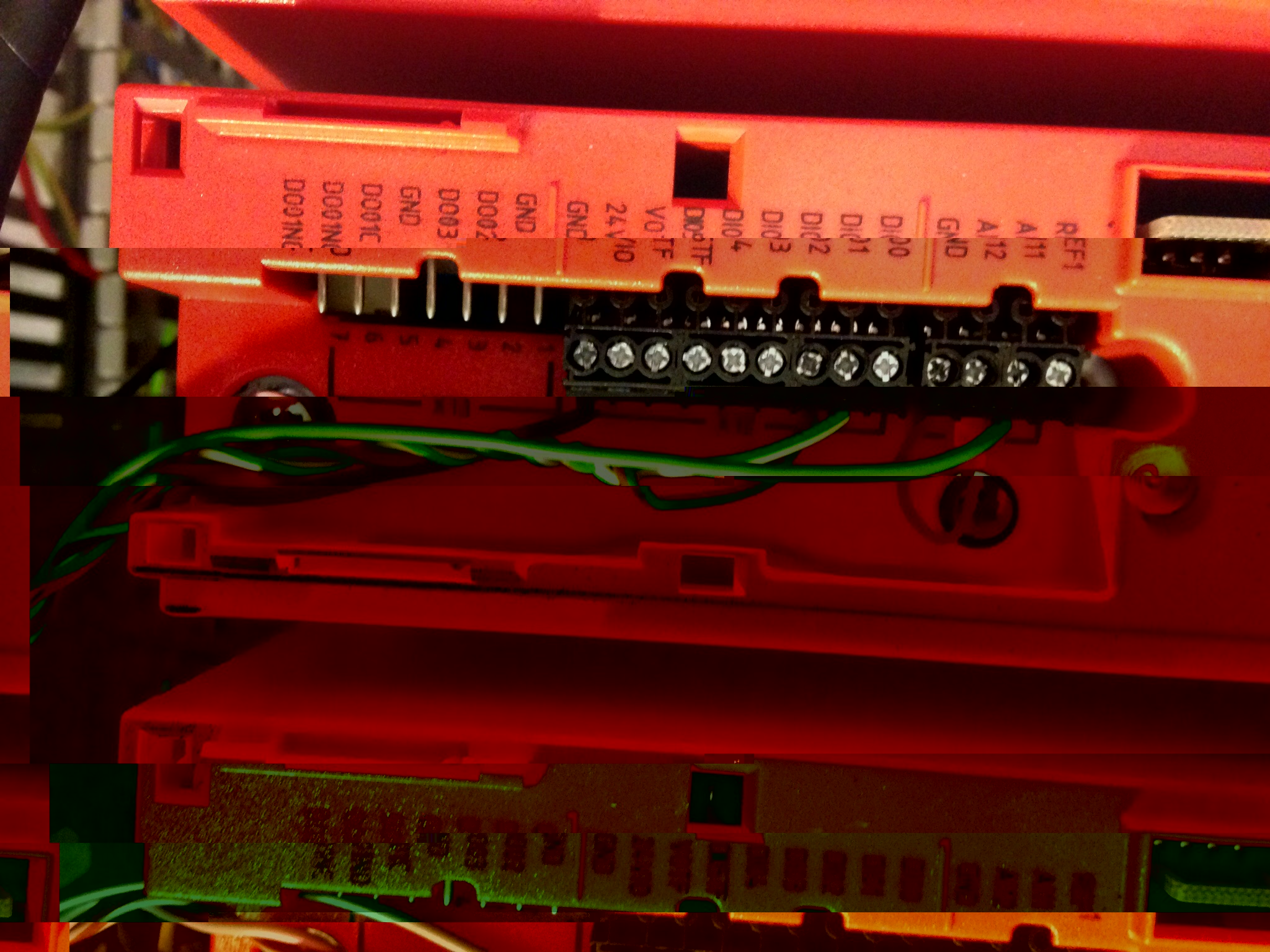

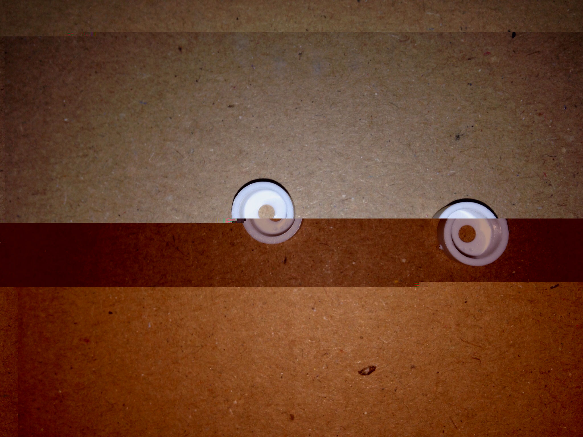

Inverters:
- the inverters have a particularity . They always can shut down your home electrical net because there are inside Capacitors which are used for the Electromagnety Compatibility ( CEM in french "Compatibilité Electro-Magnétique").These capacitors are grounded so when the current over come to the human protection (30mA) ,the disjonctor cut off the main current.
To avoid this you can make a shunt for this capacitors but only possible for the little power Inverters size0 .
This is easy to proceed .You just have to put 2 plastic cap supplied with the inverter to shunt the capacitors from the ground
plastic cap
Plastic cap
Before installation
Before
After installation
After

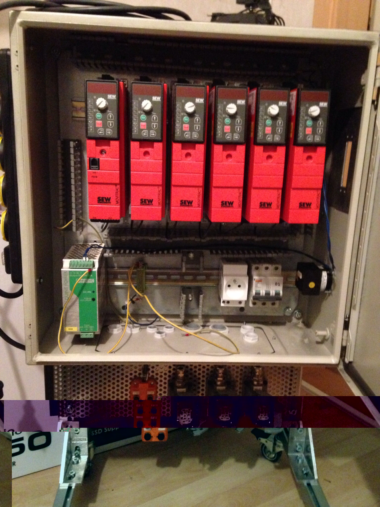

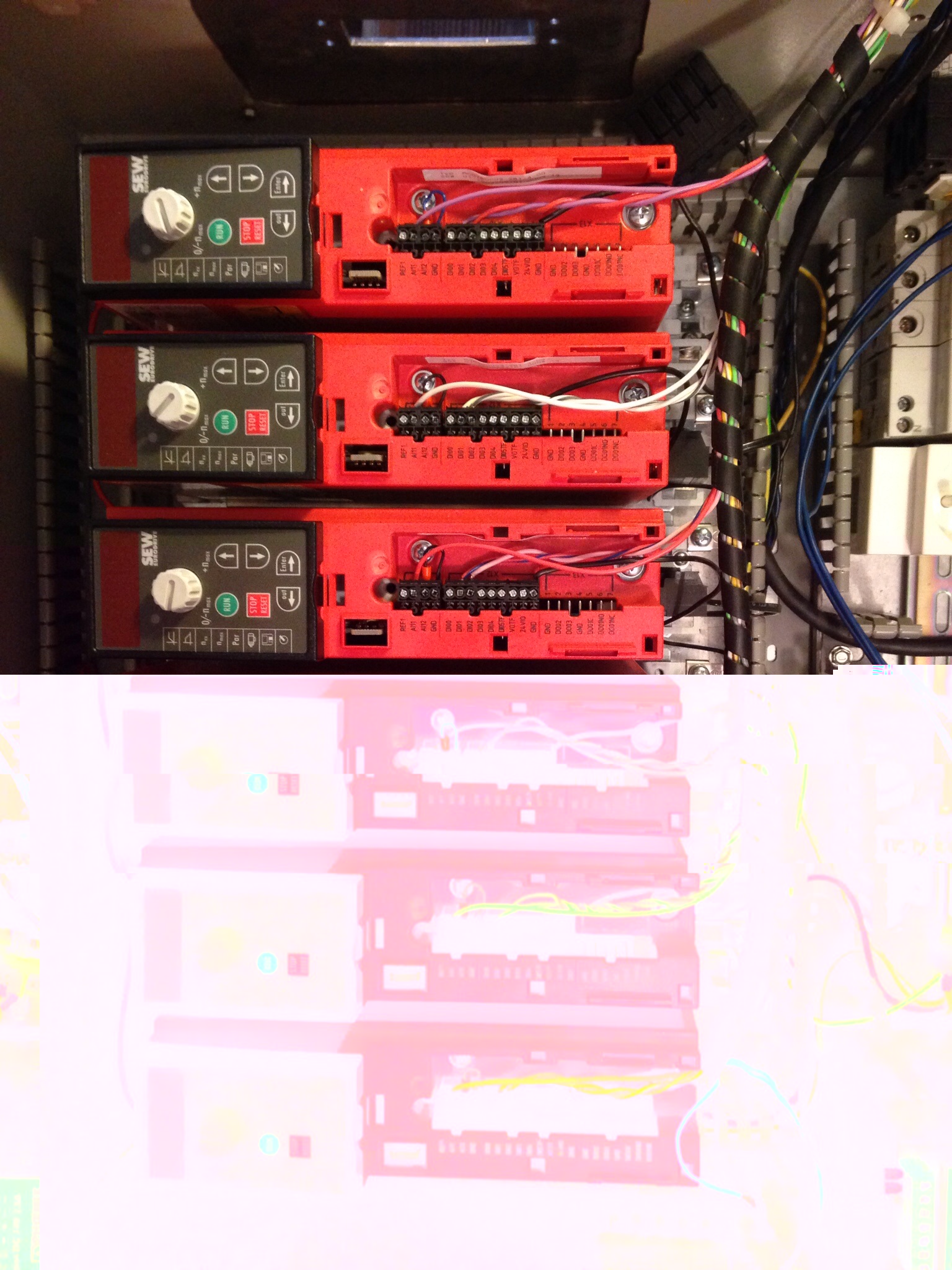

Electrical box
To put the inverter in the electrical box easily on the rail I used a frame on which I assembled the inverter and behind the braking resistor bw4 with 87,5 Ohms.This frame was provided with the inverters ( 20€ each).It's simple to use and the solution is very compact.
Inverter frame
Frame

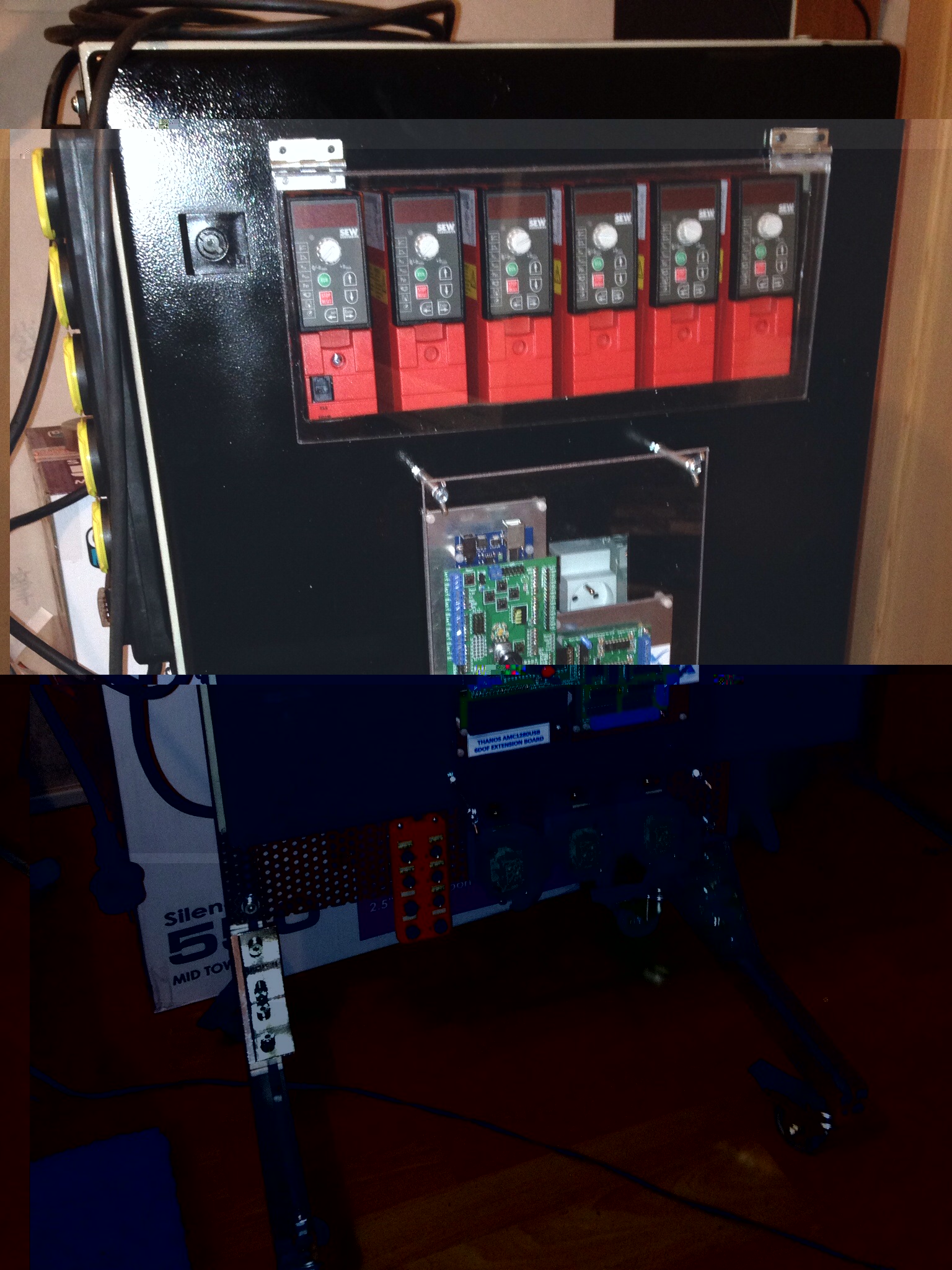

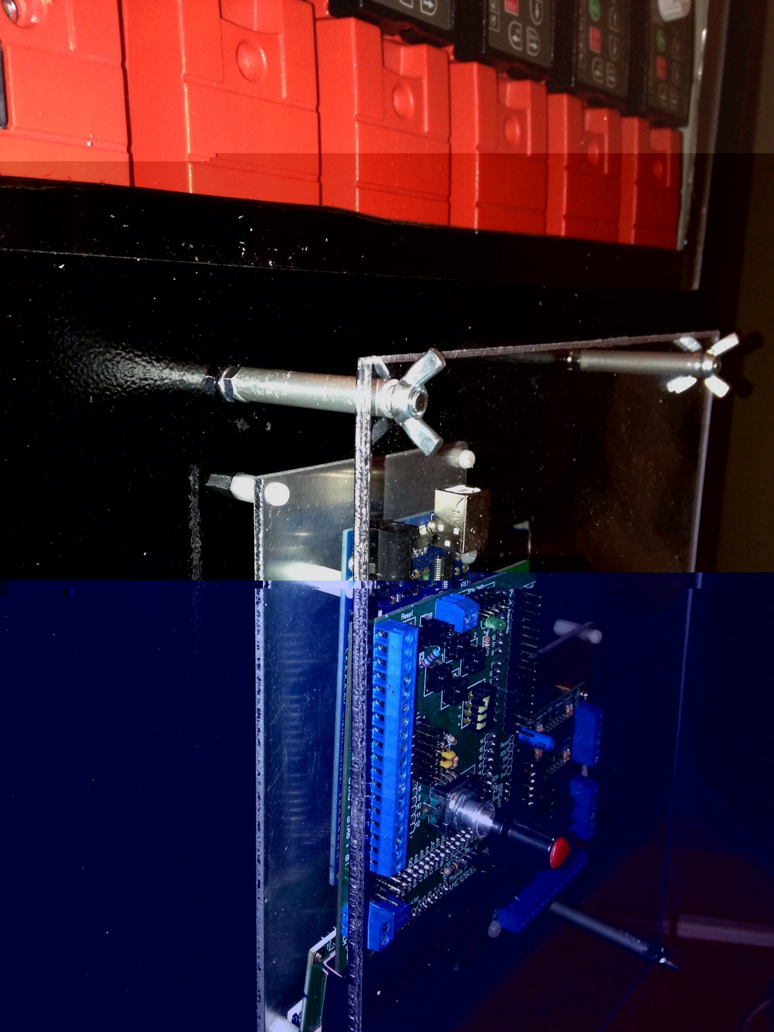

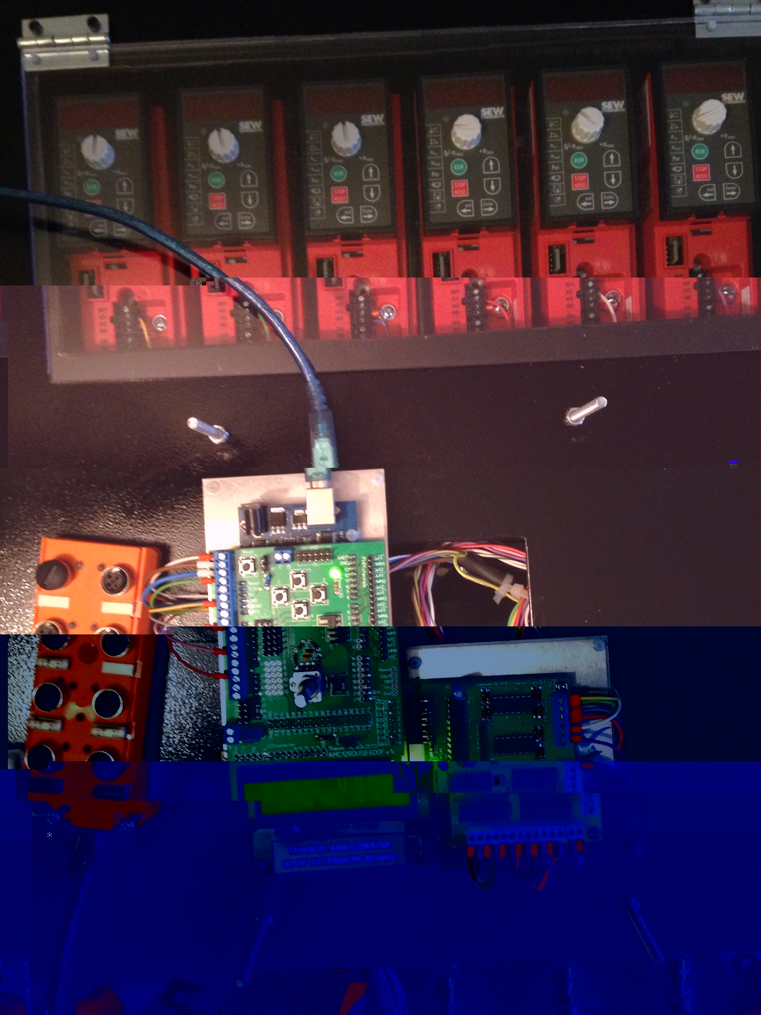

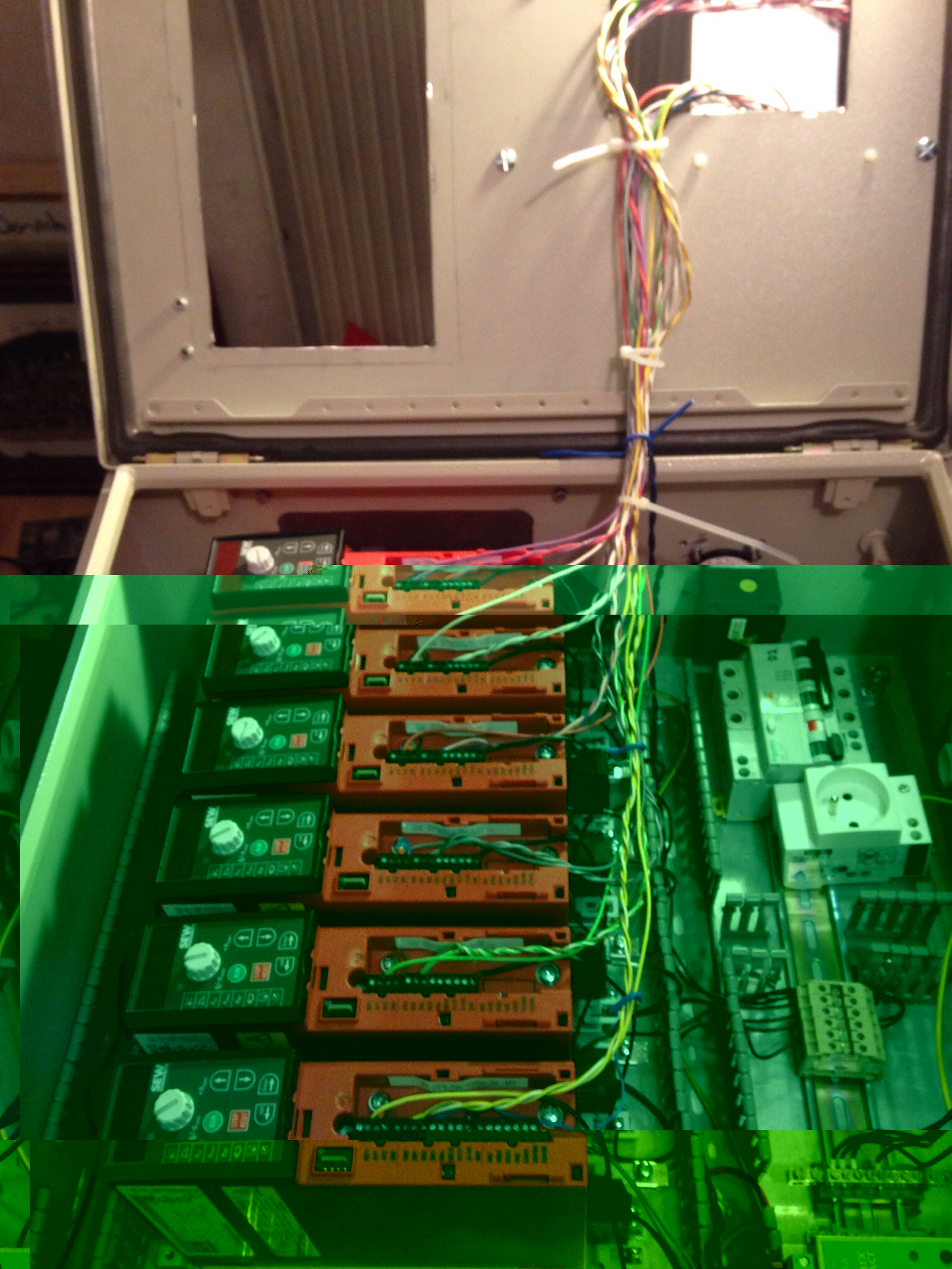

The electrical bix is still in progress.As I was wanting that all electronic stuff stay watchable I used Plexiglas on the electrical box front side.
Box1
Box2

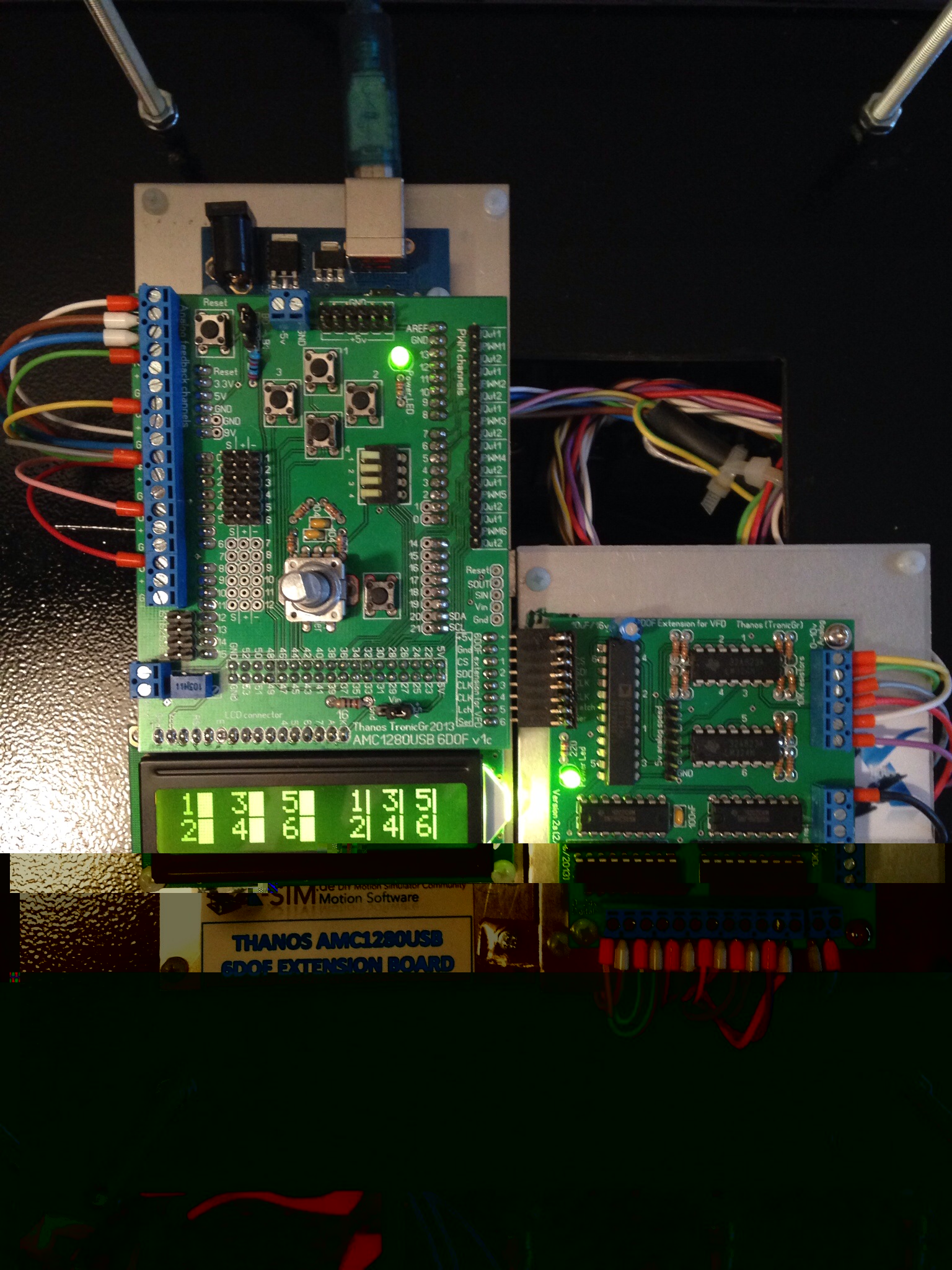

Amc1280usb

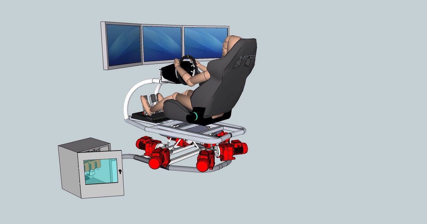

The simulator frame
Design 6dof
Design

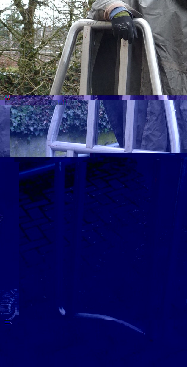

The real frame is still in progress.
A view from the job yet made.
Frame

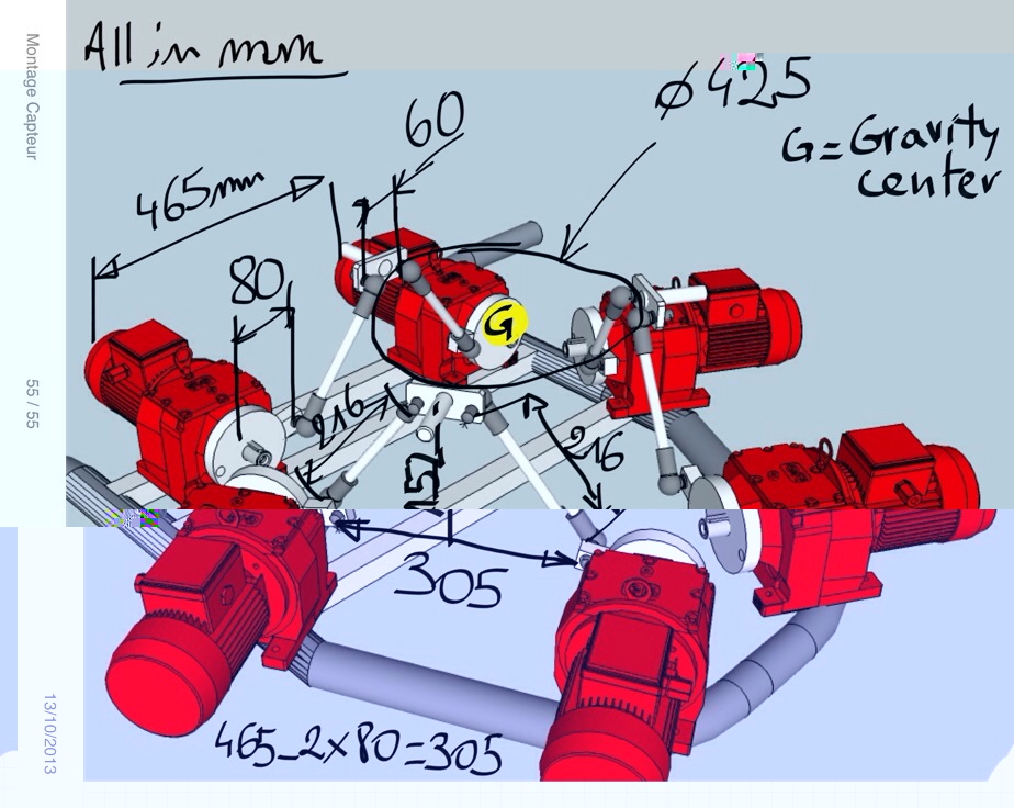

Hi ,
I can share some information.You will find attached a design I thought with dimensions.It's based on my experience until now in simulators (building simulators , watching on internet working solutions , searching on forums , etc...) ,but not with a lot of mecanical calculations.
I will follow my step by step own methodic :
1 - according to my first design attached I will build my simulator with the avaibility to make adjustable the following dimensions:
A- the diameter from the frame where the motor are attached .I have to fix the the value for the diameter where the moving plateform is attached ( diam 425 mm in the drawing)
B - the distance between pair of motors will be adjustable ( three positions , 305 mm will the max
C - the high between both frame ( up moving and down fixed) with the legs.
D - the arm on the gear output shaft , here in the drawing with 80mm but I will make a arm with 2 positions (80mm and 100mm).I don't want long arm because for a car simulator I need short movements with short angular range (100°).For the same simulator for flight I will increase the angle 180 °.It's the reason why I have to choose a right diameter for the upper moving plateform where the legs are attached.So little is this diameter so little is the neccassary arm level and angular movement for a big tilt angle.I have to find the right value according to my motors power.For me the right value should be between in range diameter from 400 mm to 200 mm .
Helping me for all these tasks I will use before the 6dof plugin in simulation mode trying to adjust some values .
The drawing :
Design
Re: 6dof motion simulator

Thx very much for your reply. I find it interesting you make a distiction between a car simulation and a flight simulation...not quite sure what you mean with angular range - 100° for car simulation and 180° for flight simulation ? Is this the angular range of the motor axis ? You say you need short movements for car simulation ... does this mean more g-forces ?
Until the end of this month I won't have much time because of another project deadline. When I have some spare time and certainly early februari I will try to make a working model in OpenModelica and post the results in this forum. I think it will be interesting to see the correlation between different parameters like workspace, power, torque, payload .... for example I wanna find out how much extra power is needed for heavier payloads. I'm thinking of a stewart platform with dual seats.
Last question : your 3D model, did you make it in Solidworks or other CAD program ?
Good luck with the project.
Xa4
xa4123
Posts: 6
Joined: Thu 6. Jun 2013, 18:49
Postby vicpopo » Thu 16. Jan 2014, 07:52
xa4123 wrote:Hi vicpopo,
I would say :
Car simulator : I want more dynamics movement ,that means shortest angular gearbox output shaft range (100°).I will use the capability of the motors to run fast ( max rpm )
Flight simulator : I want more tilt angle for the platform , that means ( with the same arm level) more angular gearbox output shaft range (180°).And the motors didn't have to run to their max speed.
xa4123 wrote:Last question : your 3D model, did you make it in Solidworks or other CAD program ?
Xa4
Sketchup ;)

Some pics from my work.I'm building the electrical box and that works good , step by step .Not so complicated because I made once a 2dof and the wiring diagram is the same.
The amc1280usb is wired , finished!
But there are much more wires and that takes time to connect all stuff.I just pray that I connect all right because if there is a mistake what spagetti dish ! :lol:
Pics below :
Inverters
Box
Amc1280usb
Amc&VerteilerIFM
Inverter
