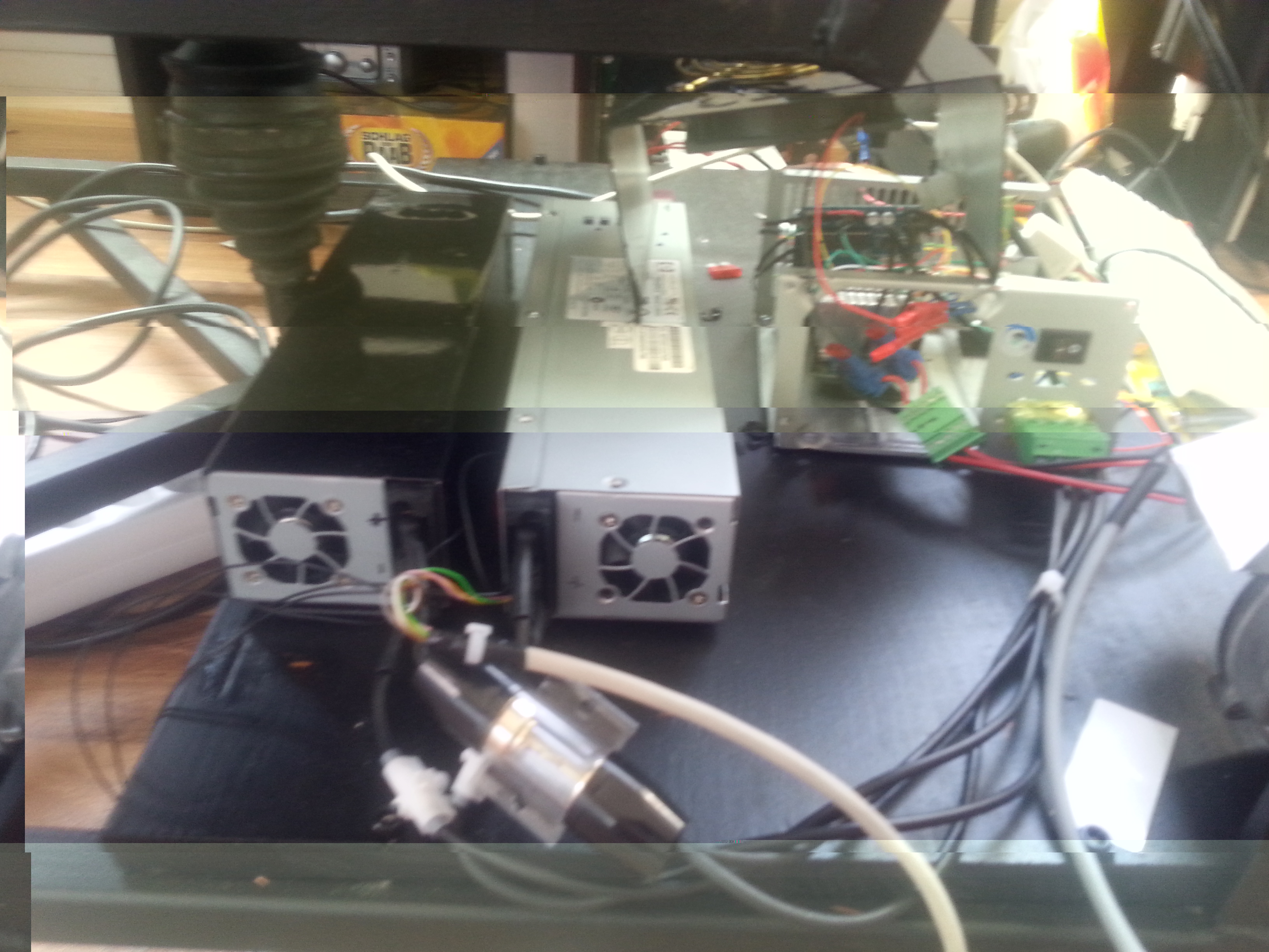

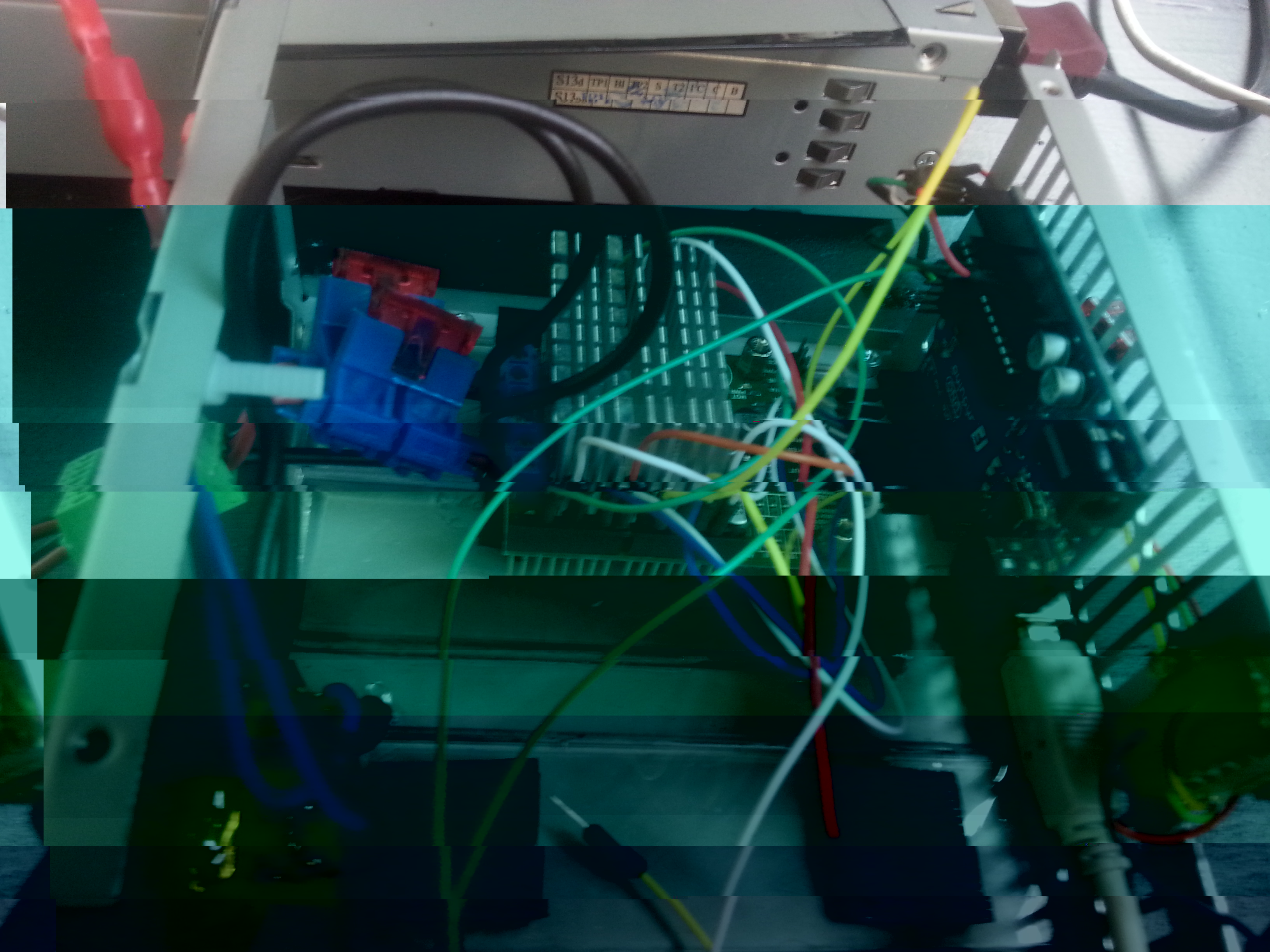

When iam finished and wanted to play i had some Problems. with the supply. I cant get the current for the wipers with only one dps 600pb.
So i had to use two and share current. The Pinout is here.
http://www.rcgroups.com/forums/showthread.php?t=1581061
(I testet with 24V for the vipers. But i really want to say, that this is to much. The whole seat is jumping arround. :-) )

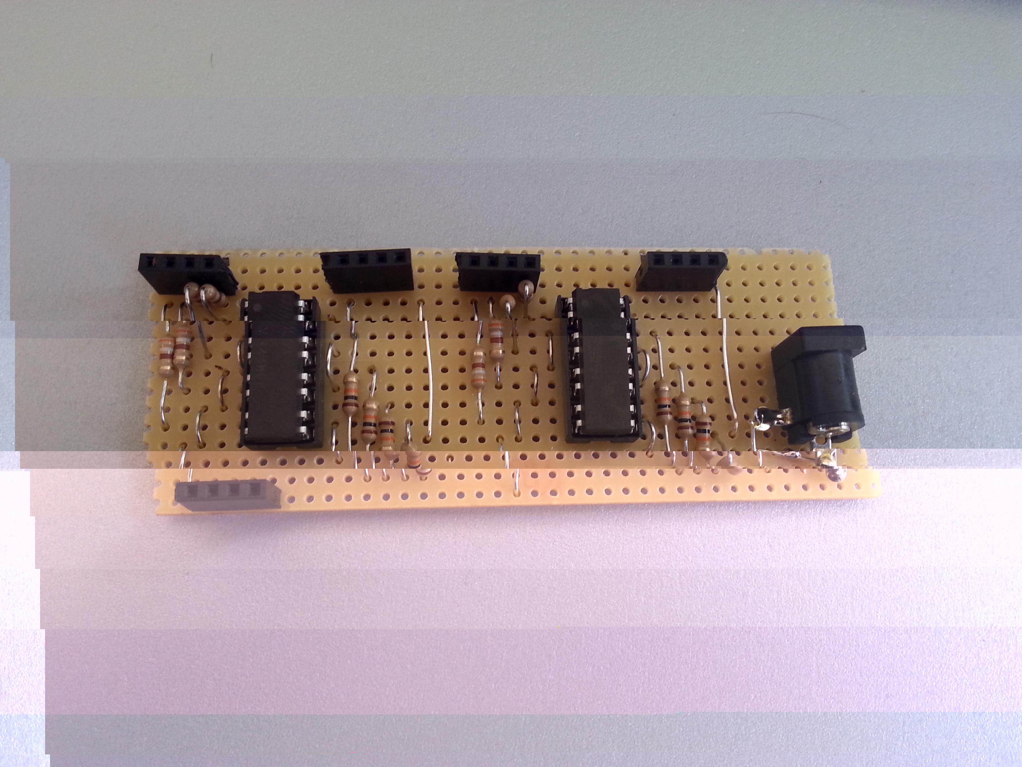

Next dejam the pololu from the arduino. Herefor i build a 8 Port optocuppler Board. You see the Board and shematic in the rar file.
I think thats it. matracing done the experience at first i just followed and optimized something.

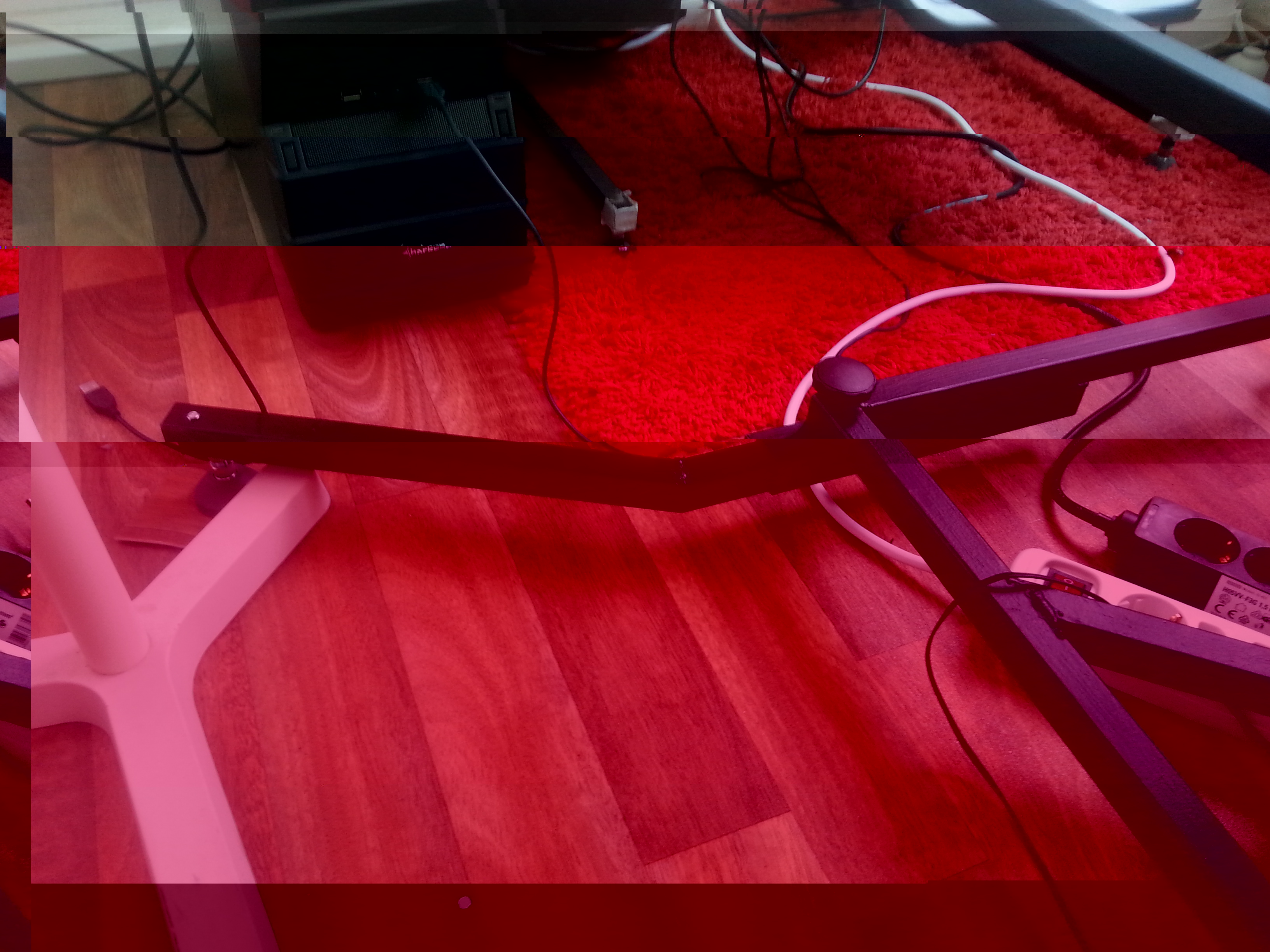

As i saw on this Video his seat was jumping arround so i used bigger arms to get the seat stable.
Any questions, ask me like i asked the DOF builder :-)

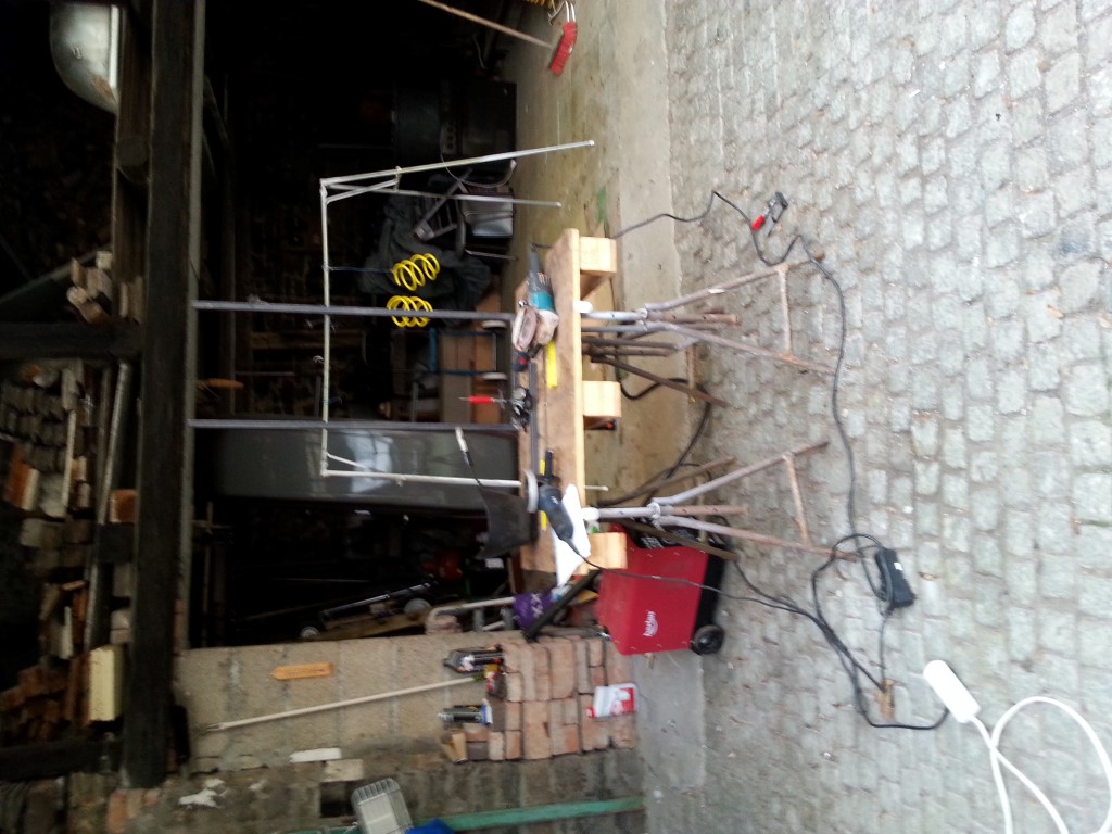

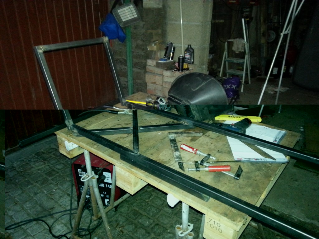

Thank you Tombo. I will ask you if i get some problems with my software.

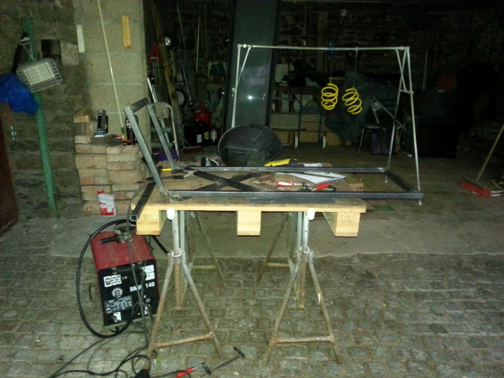

Today i started my Project.
25x25x2mm steel

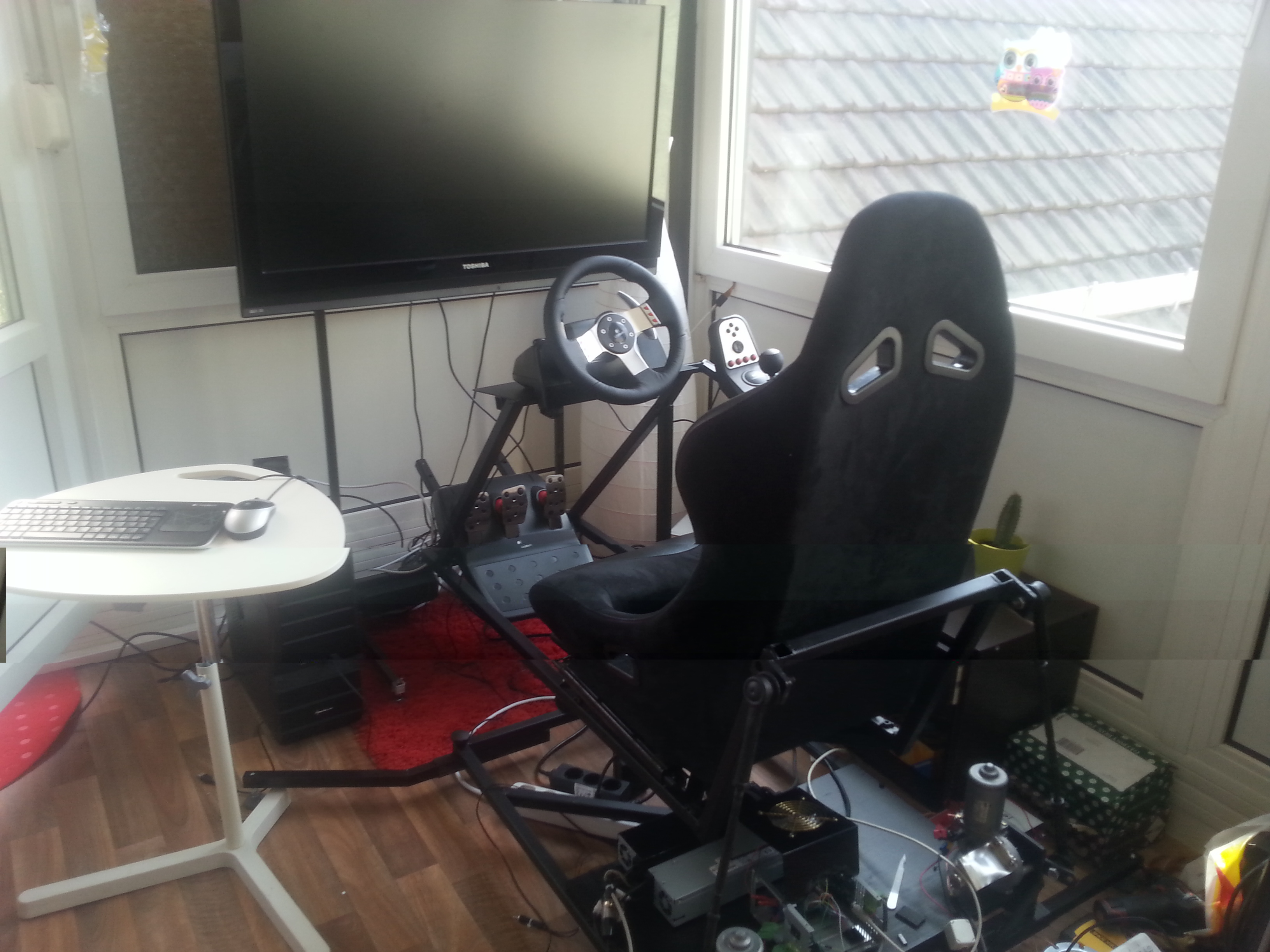

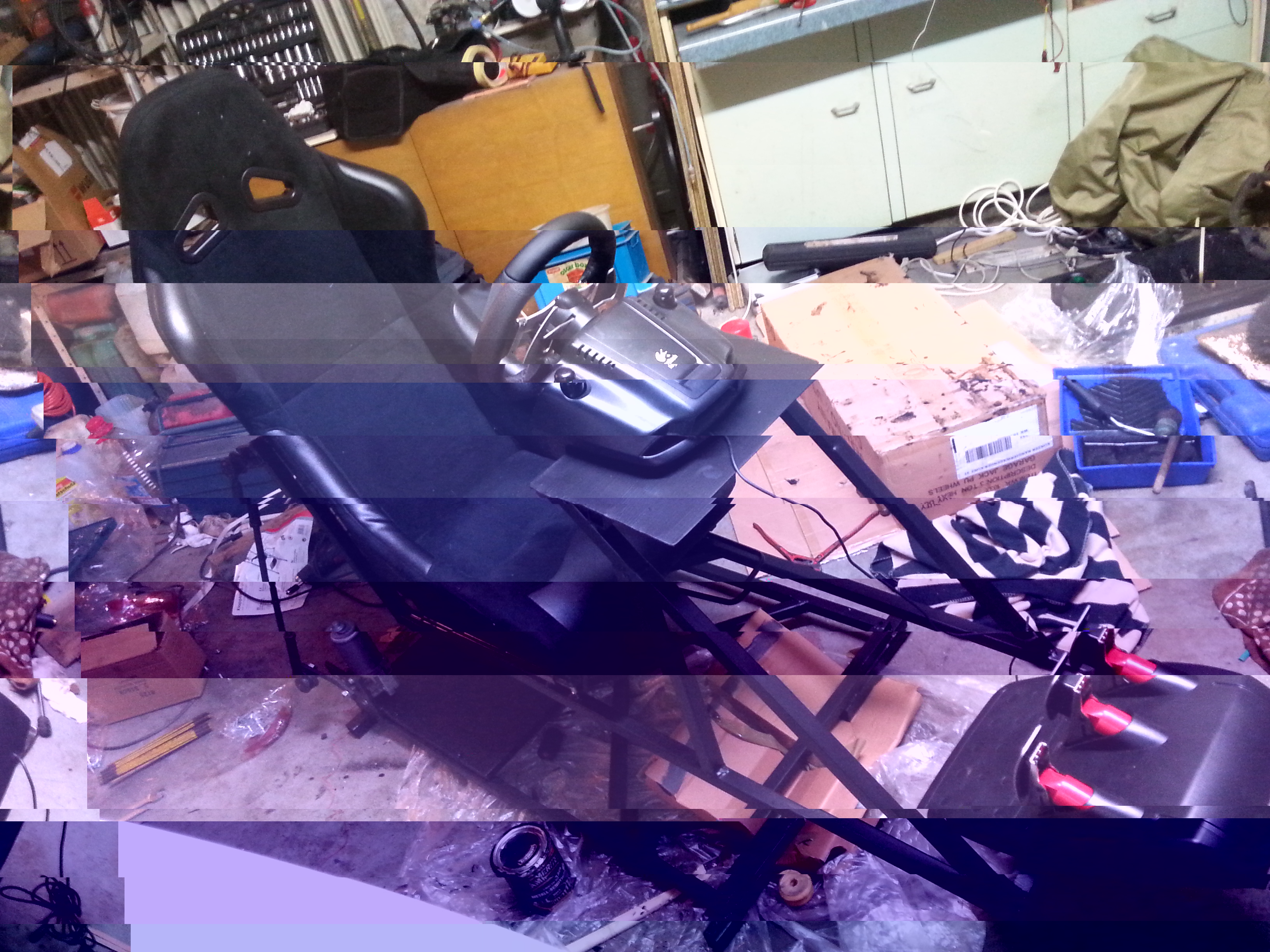

Postby Monaco85 » Sat 22. Feb 2014, 01:05
I finished Hardware. Now i will start with arduino and wiperdriver.

Re: 2DOF 24V Wiper Arduino Motomonster
Postby RacingMat » Sat 22. Feb 2014, 09:48
hi Monaco85!
It looks good! Well done!
