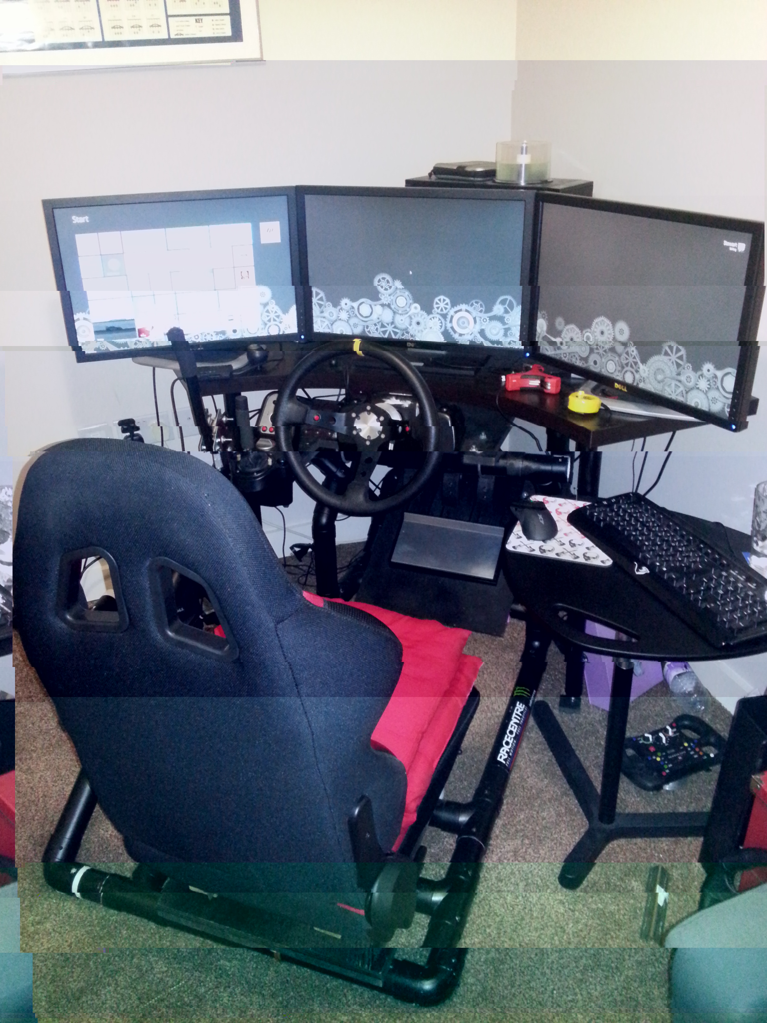

My rig at the minute....
PVC Rig

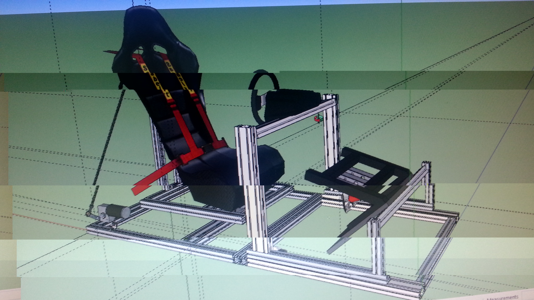

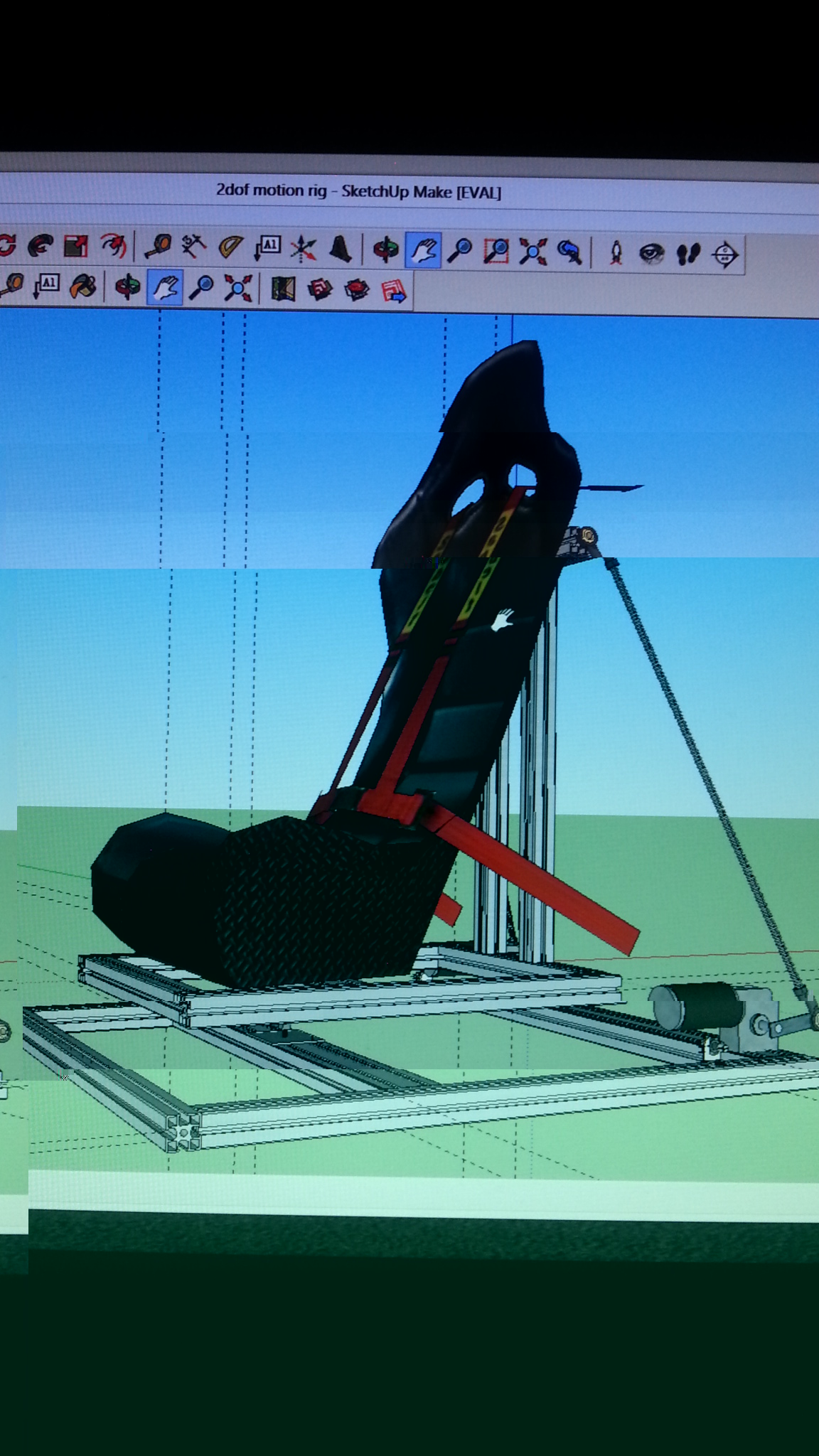

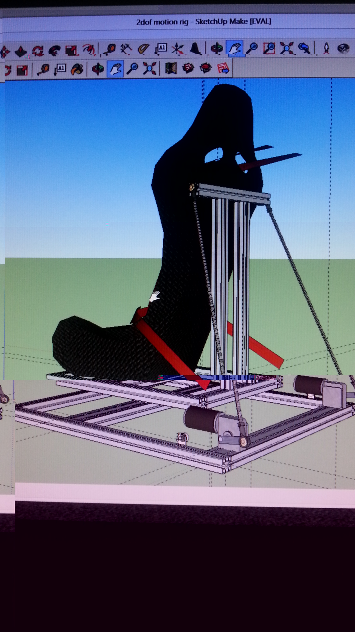

Decided on a seat mover and working from viewing plans from MotionDave and yokoyoko I have came up with these sketches in Sketchup 2013 :D
I will cut down my current rig from the seat backwards to leave steering wheel etc untouched until new motion part is up and running.
front
back
Search 2dof motion sim in 3D Warehouse if u want a download of my sketch :)
I will be adding a front half to hold steering wheel and pedals etc as soon as the motion end is built and also after all that maybe adding a traction loss option. (something similar to YokoYoko's rig.
Front half and back half will be separate builds but bolted together and the front of cockpit will be on sliders to adjust leg room.

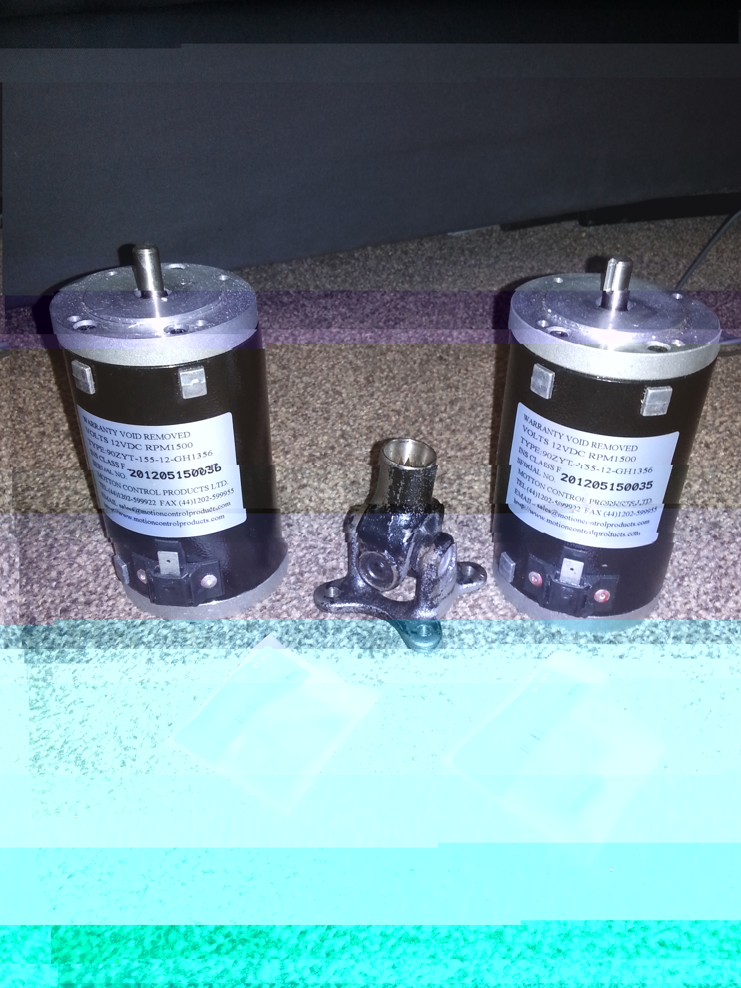

2 90ZYT-155-12-GH1356 motors http://www.motioncontrolproducts.co.uk/ ... /24/zyt90-
155_12v_traction_motor_04_nm/
These motors I ordered thinking they were the same as Prodigys motors (same model number) but they are keyend instead of D end which involves buying a way more expensive gearbox than the £20 mcp4s.
I found this out after speaking to Zach from motioncontrolproducts uk.
I told him I meant to buy these motors with the mcp4 combo and they dont sell them any more.
http://item.mobileweb.ebay.com/viewitem ... 0393781762
Anyway he knew of the demand for these motors on the x-sim forums and has told me they are going to re stock this combo :)
Im planning on returning my motors and getting the ones I originally wanted.
Just letting u all know incase u plan to buy these motors which were originally delisted :)

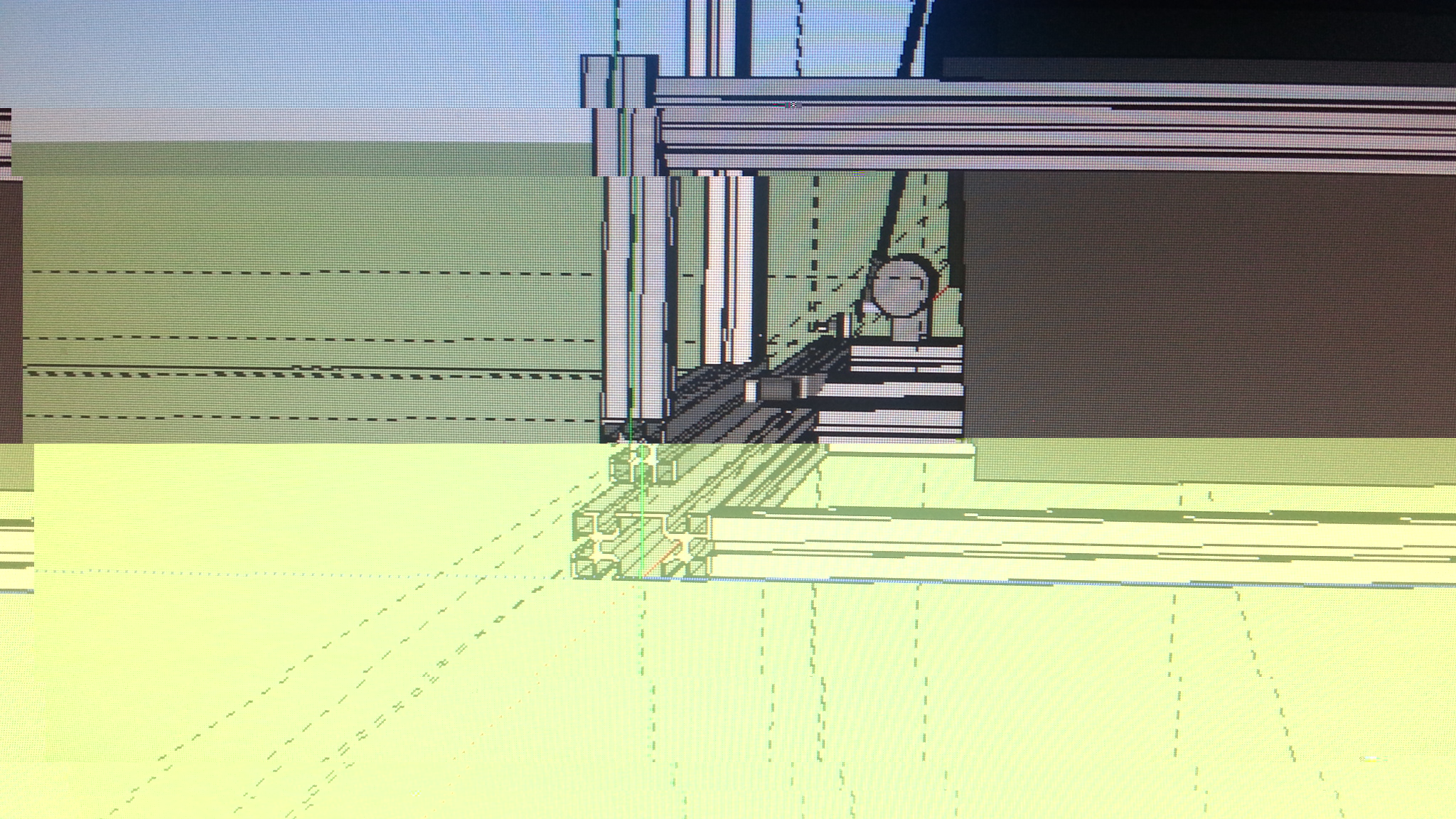

This is my plan for the front of rig :mrgreen: It can be bolted to the rear section and removed when needing to move house etc.
I will decide on a triple monitor mount later on in build.
sliding cockpit
I plan to use these sliders in between the base and lower base of front section so the pedals and wheel etc can be moved toward and away from you depending on your leg room needs.
http://www.aluminium-profile.co.uk/acat ... iders.html

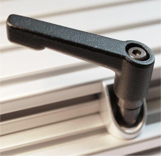

I will lock the sliding cockpit in the desired position with these locking levers :D
http://www.metallin.co.uk/shop/series-8 ... lever.html
Updates to follow :mrgreen:

Postby yokoyoko » Tue 20. Aug 2013, 15:42
The aluminium parts are the correct one's! 40x40mm is pretty stiff - the right choice if you want to go for traction loss later. Perhaps 30x30mm is stiff enough, but I never calculated them for this use.
Very good idea with the sliding parts between the two profiles! --> I think I will copy this ;-)
If you need any further dimensions from my rig please ask.

yokoyoko wrote:The aluminium parts are the correct one's! 40x40mm is pretty stiff - the right choice if you want to go for traction loss later. Perhaps 30x30mm is stiff enough, but I never calculated them for this use.
:) will do.

I made an error ordering my motors, see OP.
Motioncontrolproducts will now be restocking this motor gearbox combo due to the demand from x-sim they had :)
http://item.mobileweb.ebay.com/viewitem ... 0751091855
These motors were delisted by motioncontrolproducts but will now be re stocked.
They currently sell the same model on the online store but are different. I didnt know about keyend and D :oops:
The geabox for these current motors are very pricey apparently.

Postby prodigy » Sat 24. Aug 2013, 14:52
Those motors are very good maybe even too good for JRK's, I had a lot of difficulties while setting them up, JRK's were returning me a lot of errors, especially when motors were loaded with me on the sim, it didn't work at all. I've tried a lot of PID settings and tuning but JRK's couldn't handle those motors under load. That resulted in me leaving my project aside for a few months * I will give my project one more chance soon, I'll try to reposition the motors far back with shoulder mount. If that doesn't work, I will probably sell my ZYT90 motors with gearboxes and return to wipermotors..
