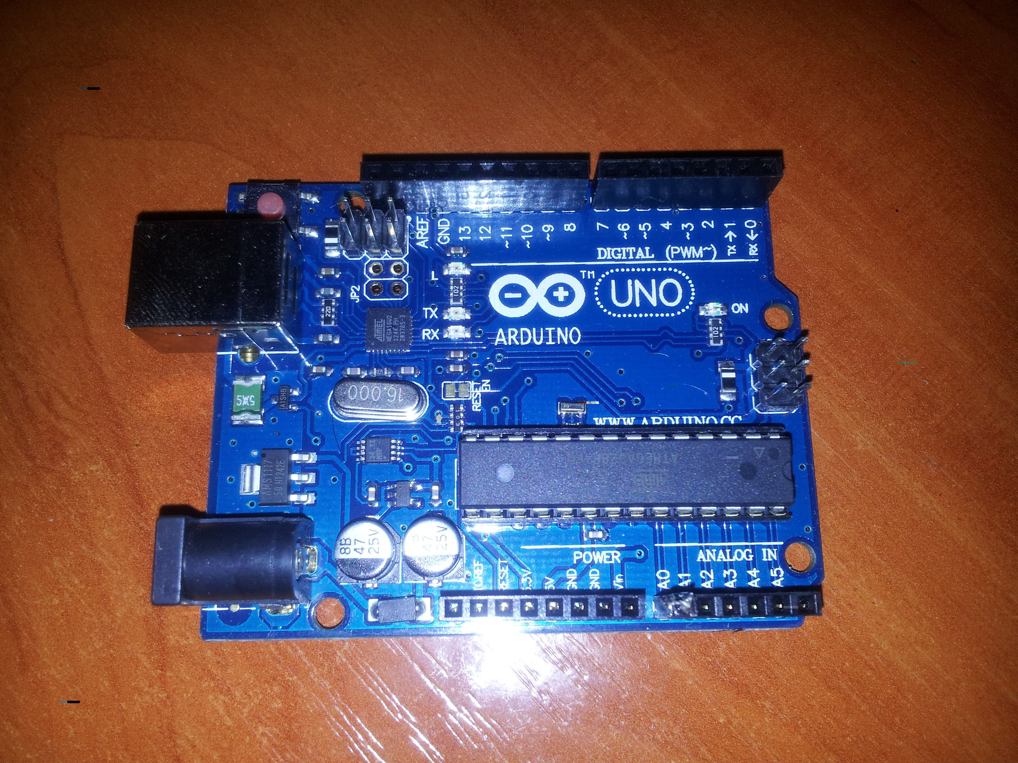

Arduino uno r3 with atmega328p-pu

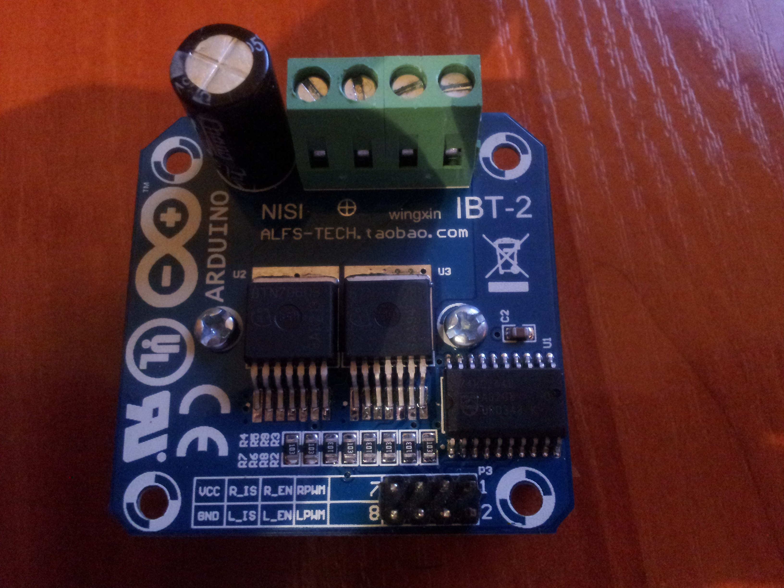

TOP view H-drive

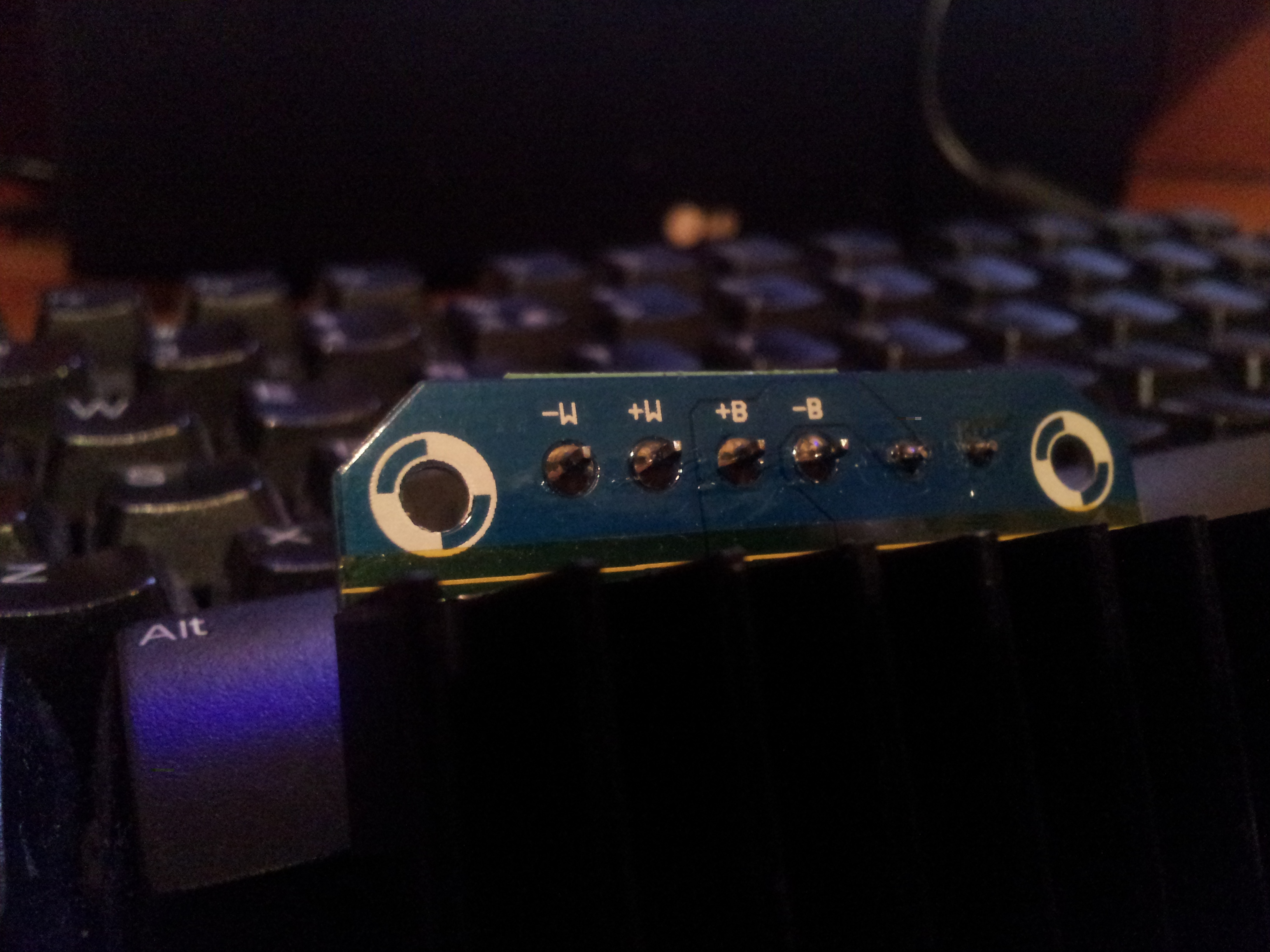

H-Drive bottom side of motor connection in and?

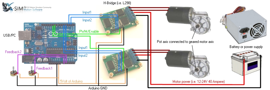

I was using these drivers and connection schematic:
But NO result at all.
First, arduino installed and set to 57600 in com port settings (windows)
Second, i downloaded from x-sim
viewtopic.php?f=39&t=723 firmware and uploaded to arduino uno threw software (arduino)
Third i did connections for 1motor as shown i that picture or arduino post
Result NOTHING :(((((
SO GUYS :] help me to connect correctly everything, i think that i connect arduino correctly, uploaded firmware too, but
but question is which positions and which wires to connect on H-DRIVE???? Maybe you can provide me some paintings how to connect correctly???

You did read the post?
Especially the part below the schematic and the part of the wiring information and where you can find it?
This bridge is not compatible with the firmware, you have to change the output code to drive such a device. The PID part will be the same.

Postby RufusDufus » Wed 4. Sep 2013, 13:56
Hi, these H-Bridges can be used with the Arduino XPID firmware.
You need to:
1. connect the H-Bridge R_EN and L_EN pins together and link to the Arduino XPID PWM output
2. connect the H-Bridge RPWM to the Arduino XPID INPUT1
3. connect the H-Bridge LPWM to the Arduino XPID INPUT2
There is a schematic for the H-Bridge attached for confirmation...
IBT-2.pdf
(7.85 KiB) Downloaded 1577 times

Postby amoras10 » Wed 4. Sep 2013, 15:12
RufusDufus wrote:Hi, these H-Bridges can be used with the Arduino XPID firmware.
You need to:
Ohhh man you save me couple bucks !
you save the day ! ;] thanks

Postby chsieh123 » Fri 15. Nov 2013, 09:09
I have got the exact same hardware as yours. There is no problem using this H-Bridge with X-PID. The connection described by Armos is correct.
