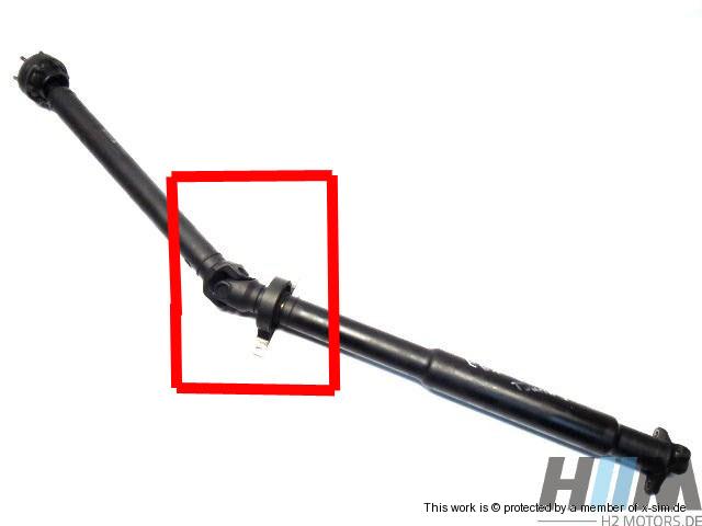

For U Joint i used the red marked part out from an Bmw from the yunk jard and welded it on to 5mm steel plates wchich are screwed with M8 screws to the wood.

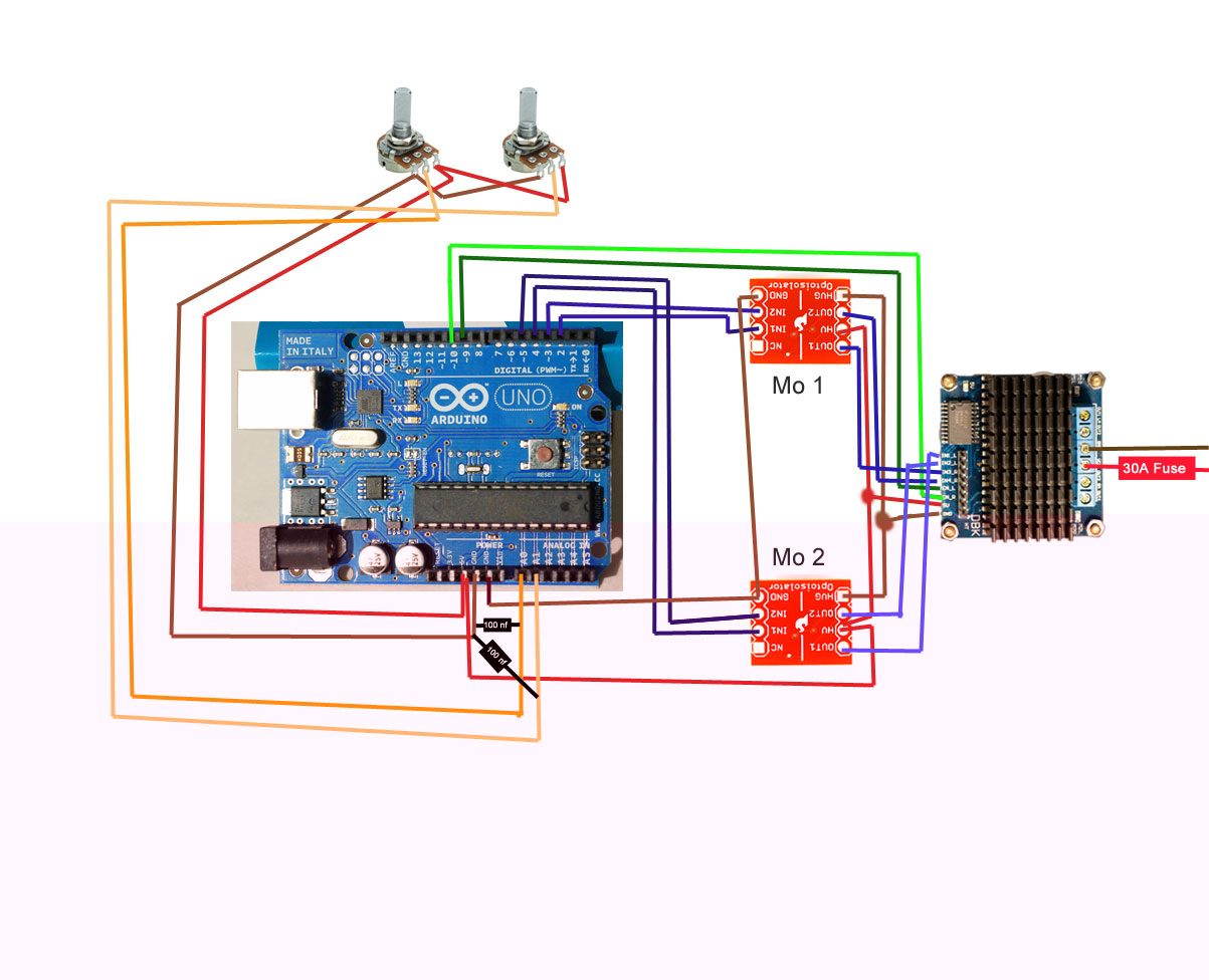

Since if builded The platform Pivot and motormonting, i startetwith the electrics.
But there I stuck really.
I try to use an Arduino with an dual h Bridge and 2 car wiper motors.
I' ve isolatet the Motors and wired everything like in the picture and followed the Tutorial from Sirnoname step by step.
I've broken 2 Hbridges, last time it worked for about 10 min, then one motor begins to turn slow and hbrdige got down.
So please can you confirm the wireing below and mybe give me a reason for my hbridge knock out. I tried it without fuse.
Because i really don't know if i should buy another hbridge.

Postby RacingMat » Tue 1. Oct 2013, 21:16
Hi!
That's a pity!
Your wiring looks okay for the pots...
but I can not read the Hbridge pinout nor the optoisolator : can you upload their specs ?
- Did you try with toy's motor and battery first?
- Maybe your Hbridges are too cheap?...

Re: 2 Dof Arduino Simrig
Postby Tombo » Fri 4. Oct 2013, 13:26
here is the opto board i'm using
https://www.sparkfun.com/products/9118
and thats the Hbridge
http://www.ebay.de/itm/221197919764?ssPageName=STRK:MEWNX:IT&_trksid=p3984.m1439.l2649
I don't test it with small motors, because i don't have some. What hBridge will be recommended?
Maybe this one? http://www.exp-tech.de/Shields/Pololu-Dual-VNH5019-Motor-Driver-Shield-for-Arduino.html
But i don't know how to change code for this hbridge.

Postby RacingMat » Fri 4. Oct 2013, 22:27
Hi Tombo!
- First bridge, there are no specs in the ebay description: hard to say if it's fine
- Second, the "Pololu Dual VNH5019" has same pinout as Motomonster, so my arduino code will work fine!
Have a look here: viewtopic.php?f=37&t=943
You may find everything you need: code and hbridge reference
- I do not use opto-board...
