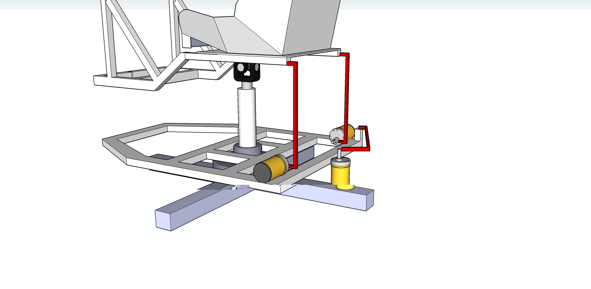

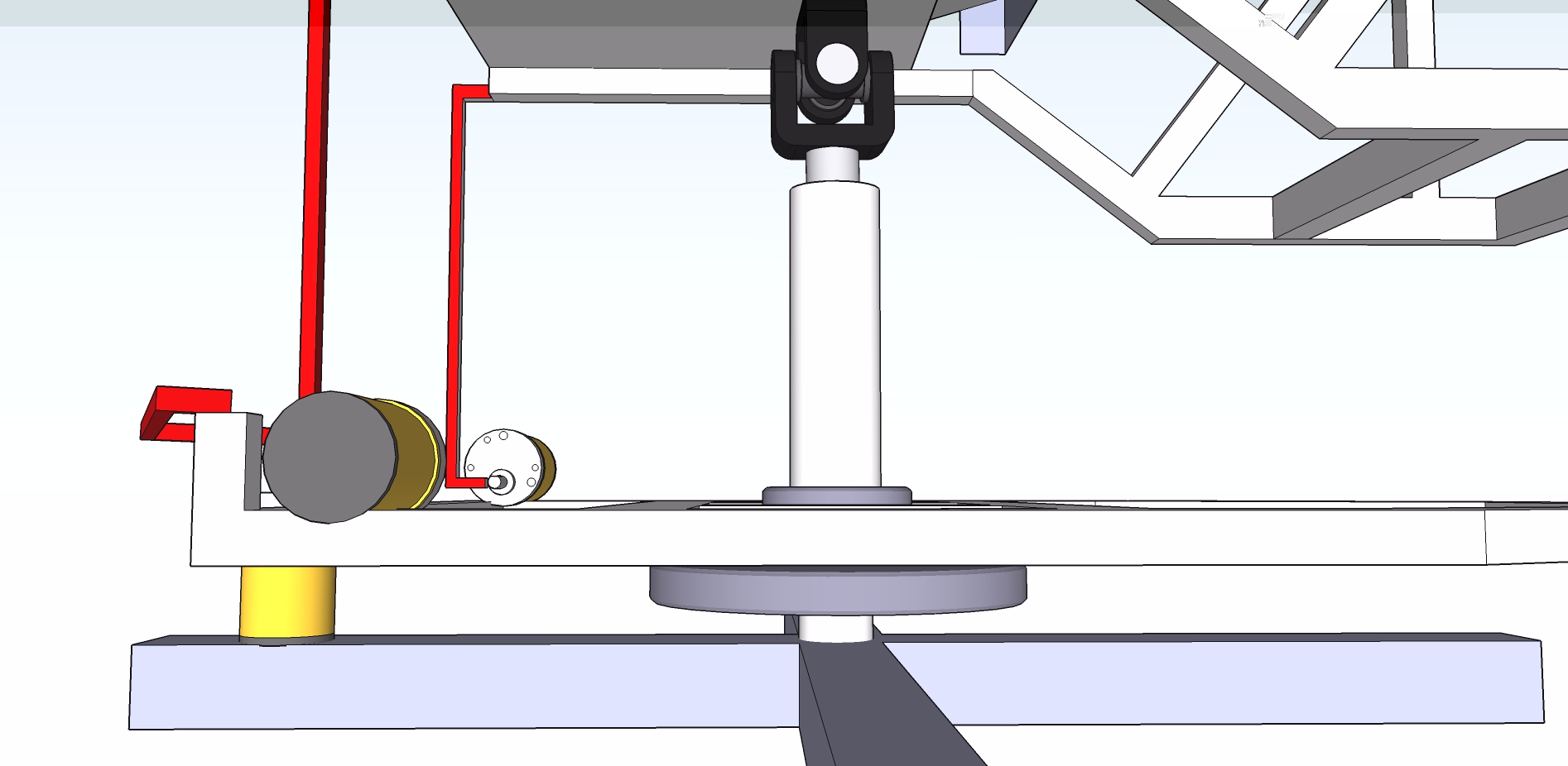

I have been toying with a design in my head that manifested itself in google sketchup this morning.
*It basically centres around a brake disc that is mounted on a stub axle welded to a lower frame.
*An upper frame would mount to the brake disc and would hold the chair actuating motors.
*A uni joint would be welded to the hub and the seat etc would be mounted from there.
Brake rotor sim design.
Brake rotor sim design 2
Brake rotor sim design 3
Any ideas/criticism? Would love some feedback and links to similar designs. Motor/linkage placement is just for conceptual purposes and would obviously need adjustment. My real concern is the brake disc as a pivot point i suppose.

using the big motor for the tl sounds good. The wiper should be fine for seat moving. I use a wiper for my tl too and it works really well. But more power should give you some reserve for more motion of the tl. I only use 15cm+15cm (feft /right) at the moment.
Perhaps you know my thread? If not please compare our both designs. I use a distance between the front bearing and the seat. This inertia (in the seat) while rotation gives the immersion in my opinion. I don't think you will feel a lot with your planed design. You sit on top of the bearing - in a real car the rear axis "rotates around the front wheels" when traction is lost. I would use the bearing where you expect the front wheels in your simulator. Of course you would need a second bearing in the rear...

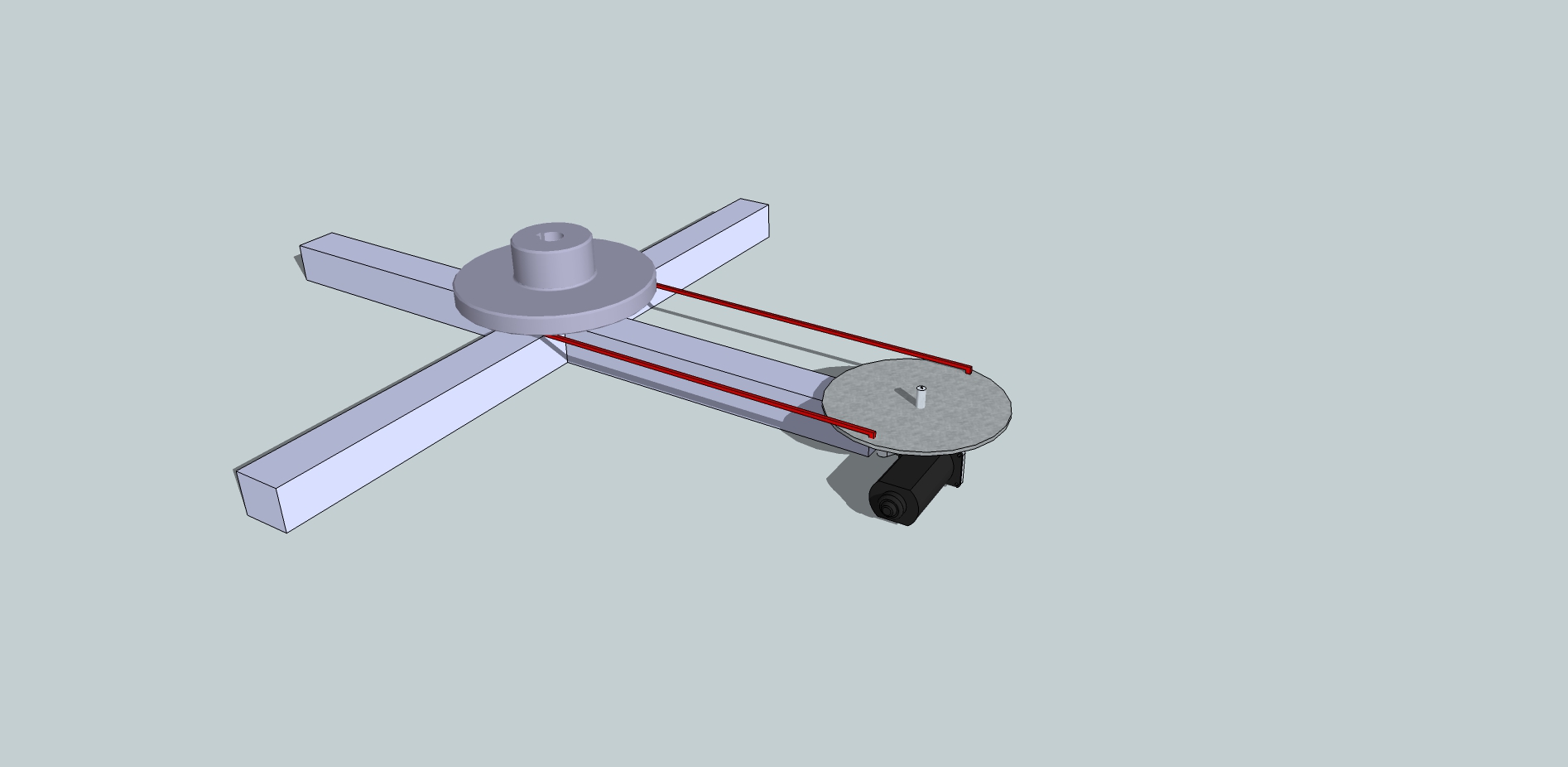

I get what you are saying about maximising the felt force by moving the pivot point forward but like you said that would require extra support at the rear and I am trying to keep this as simple as I can. I had a rethink and was wondering what people think about this pivot design trying to maximise movement. Too much for a worm drive or winch motor to handle with the extra load closer to the axis?

Postby RacingMat » Wed 10. Jul 2013, 12:51
Hi Bodgy !
nice to see your beautiful drawings : it makes the subject clear !
the brake disk is interesting but I would see two drawbacks :
- how you will lubricate it ? for this rotation, a ball bearing woul be more appropriate, no ?
- I agree with Yokoyoko, in this design you will fell spinning on yourself but it will be different than in a car. But the magic of simulation is that you don't always need to stick to reality to fool your feelings ! So, if you're convinced, try it !!
