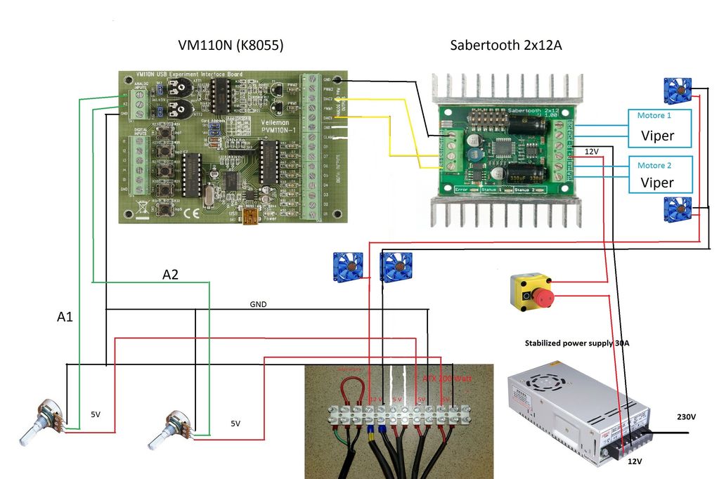

connections

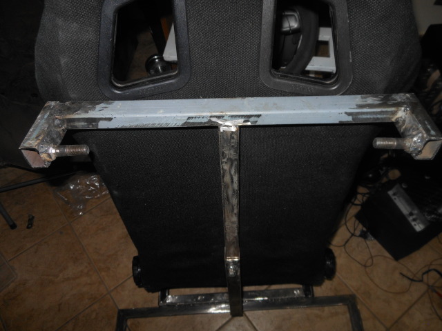

base seat

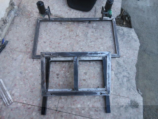

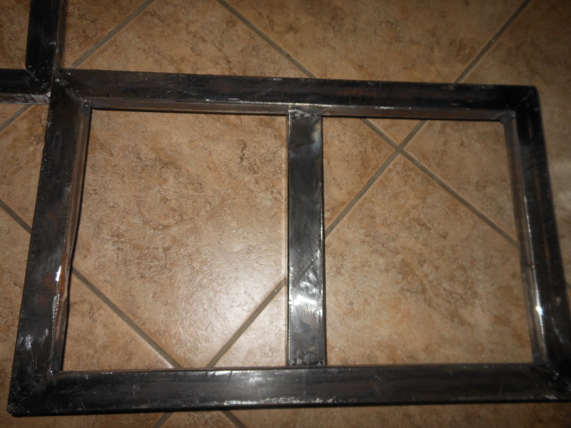

iron for 2 30x20 bases, so as to make more 'weight construction
2 threaded rods 12 m
n4 rod ends m12
1 stabilized power supply 30a
sabertooth 2x 12 + velleman K8055

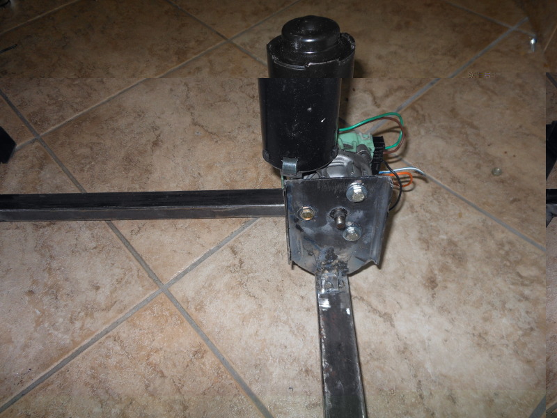

2 front wiper motors fiat panda old type + steering column universal joint
potentiometers 10k

seat base
motors
saber+k8055

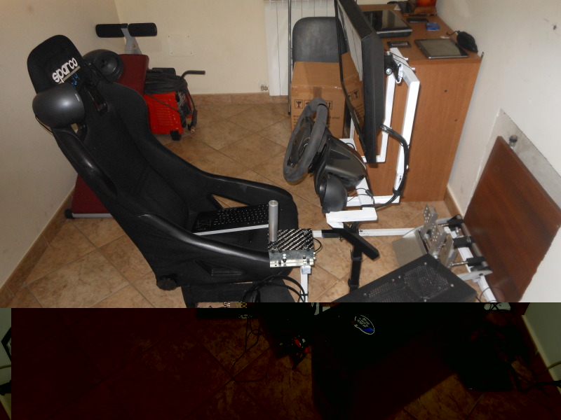

photo of the work
the station has many adjustments in height and in length
this and 'the provisional result, the last upgrade took 3 monitors and change the movement
soon will insert 'new video with the latest upgrade
