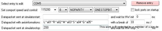

now i have install x-sim software 3.0.x.x
in converter i configure :
- output setup the USO interface selecting the available comport (for me COM6), 8 bit resolution, binary output, 115200,8,n,1
- in datapacket : L~a01~~13~R~a02~~13~
- with the break of : from 33 to 40 ms
1857

and converter setup
Output Setup USO - RPM, Speed, Gear (16 bit, binary output)
2374
2373
2372
Output Setup USO - Command
with this string also change my left and right axis from 'binary output' to 'hexadecimal output'
in simulatorstop add Z00 to some reset needed if change car or game without reload Arduino code
2377
2375
2376
Math setup (0-32768) for Speed (Extractor input:56), RPM (Extractor input:57), Gear (Extractor input:60)
2135
