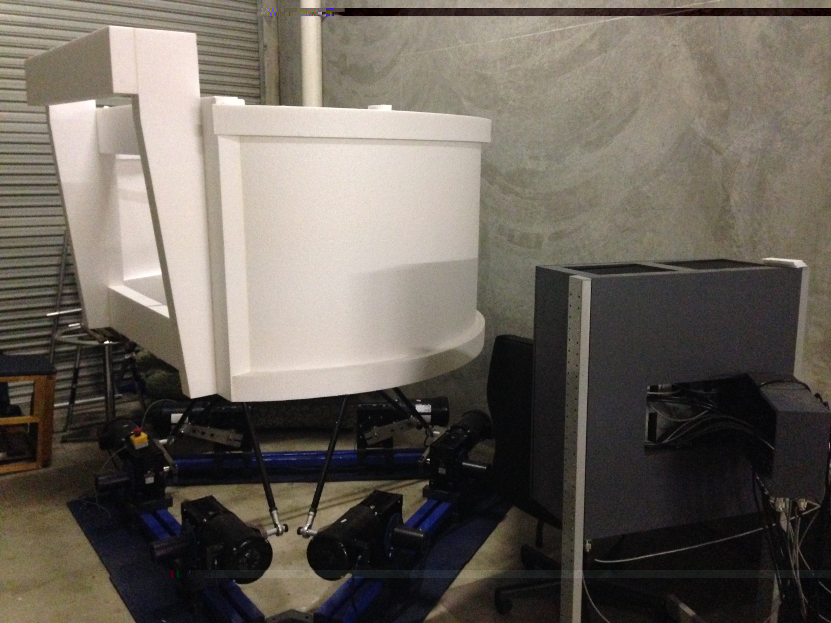

Postby DoctorD » Tue 13. Jan 2015, 11:45
Heya Billo :)
The geometry in your design is excellent. You should see a good amount of movement in all directions (with plenty of power and speed).
The only reason I suggest closing in the distance between the upper mounts is so that they form more of a 'triangle' than a 'hexagon'. A triangle is geometrically easier to solve and will make the software/callibration side of things easier to tune.
i.e. you can define a plane with three points. Any more just overconstrains the plane.
...kind of like why four legged tables at restaurants always have a little rock (and why they would never have that problem if they all had three legged tables).
Here's a quick pic of where the screen is up to:
