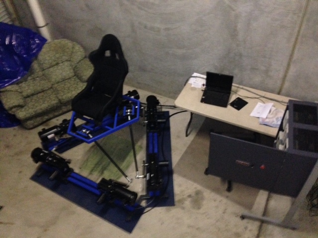

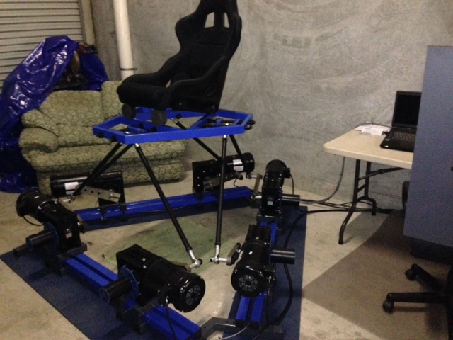

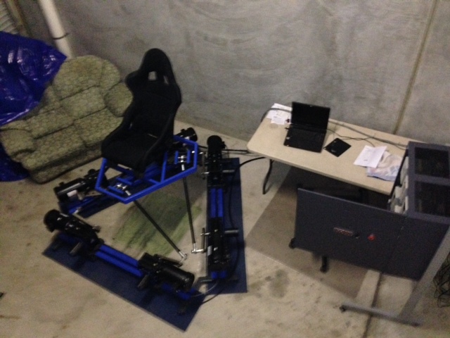

Well, tonight I experienced a certain little sense of accomplishment and pride as I sat back and took in the machine.
I still have a few things to complete before I can run the full test routine, but it certainly moves well using the positioning sliders individually.
I can get 38 degrees of pitch and roll (looks scary) and a tad under 500mm of translation in all directions.
The max speed is limited to 30% for now, but it's certainly no slouch!
I'm wondering whether I'll get the nerve to run it anything faster than 75% from first impressions.
A few more bolts to go in tomorrow morning and I'll get out the camera for some recordings.

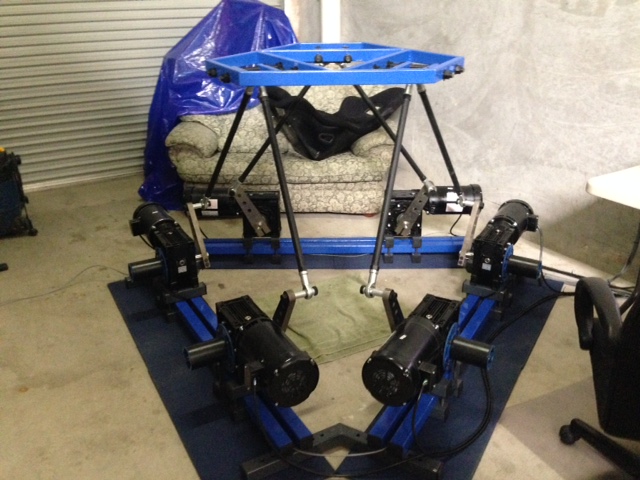

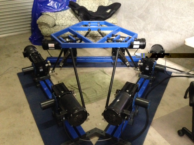

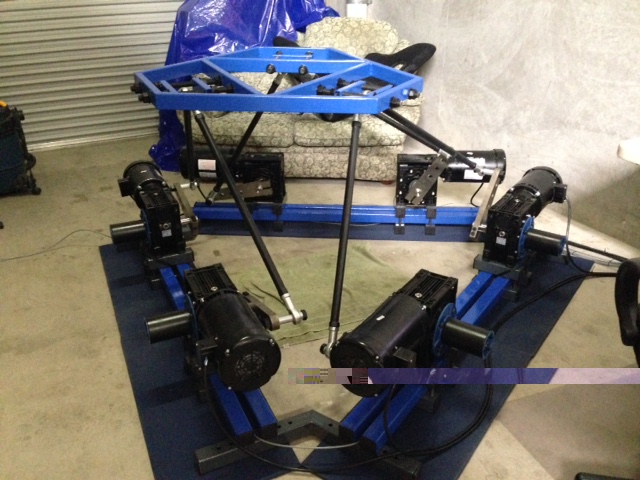

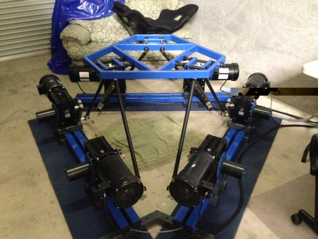

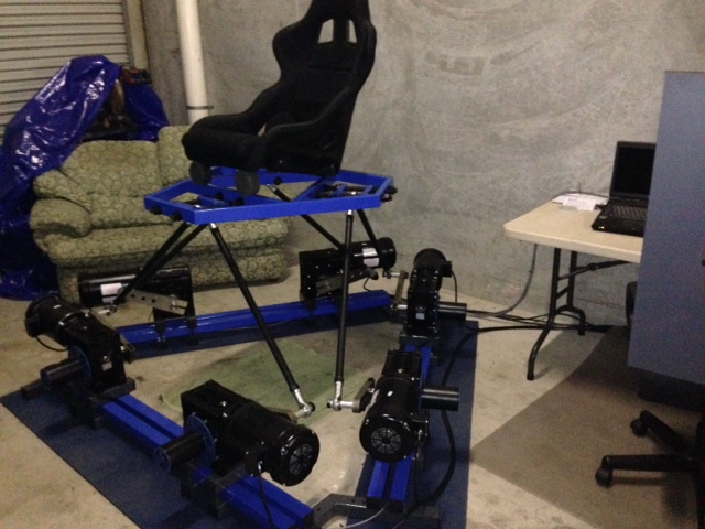

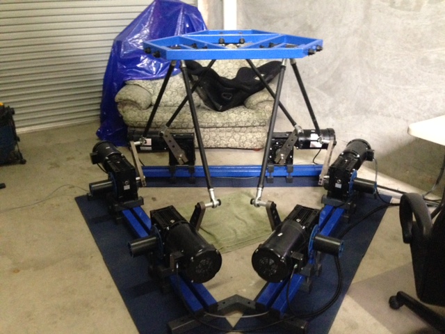

Postby DoctorD » Sun 2. Nov 2014, 07:43
No videos yet, but here are some shots of the platform going through some basic motions.
As you can see, there is plenty of range left on the actuators to mix in other motions (so you can still have bumps and sway whilst at full pitch/roll).

Postby DoctorD » Fri 7. Nov 2014, 05:34
Thanks for the lovely comments Dillydally :)
I'm pretty sure I went over the 6k mark last fortnight (currently at 6300 total expenses). I am very happy with how well it has gone together and also how neat/clean it looks when assembled.
Which reminds me. There are only 3 of those motors left, so I better pick up a spare or two for replacements/upgrades (should I add that to the build cost?... probably yes :P )
I'd love to add a 7th axis at some point (continuous yaw).
Videos should be inbound this weekend. I've spent a crazy amount of time working on the control rods. I didn't trust msyelf to weld them sufficiently well enough (considering the relatively small contact ring between the rod and the tube) so I've gone to a more 'composite' approach, a combination of high-roughness/high-surface-contact JB Weld (epoxy) coupled with multiple high strength dowels which I calculate will give me at least 5400N (540kg) of longitudinal resistance in shear per control rod. I have allowed for a factor of safety of 10 to allow for the dynamic nature of the platform and the variability of the epoxy adhesion forces, creep, vibration and the fact that someone has to sit on it :P (that's over 5 tonnes, when unfactored, per rod).
I guess patience and time will tell (coupled with a healthy maintenance and inspection regime)
