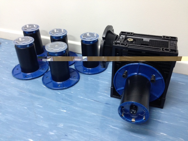

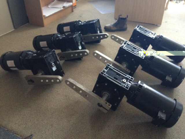

I went pretty "all-out" with mine. Going for the larger RV90 gearbox frame with hardened stainless steel working gear (instead of carbon steel). They are each rated at 480Nm continuous torque.

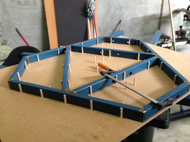

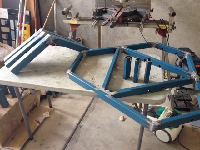

Saturday started with the drill press. With over 100x 12mm holes to get through, it was only going to be a matter of rolling up the sleeves and getting on with it.

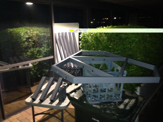

Eventually, I ended up with a set of pieces - ready for welding.
A few practice runs with my mig welder and I was off and welding the frame. Several hours later (plus a bit of grinding and JB weld to neaten things up a bit) I had a frame!

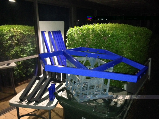

Starting late on the Sunday, I started to prep the pieces for painting. The first list on the agenda being a coat of etch-primer (after a good cleaning with wax & grease remover).

...at least my drive components wanted to give me a high five (or a 12 horsepower salute) for the effort :lol:

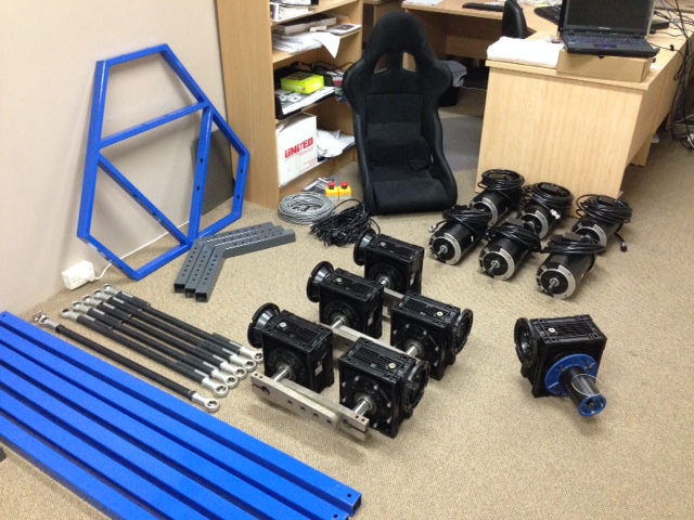

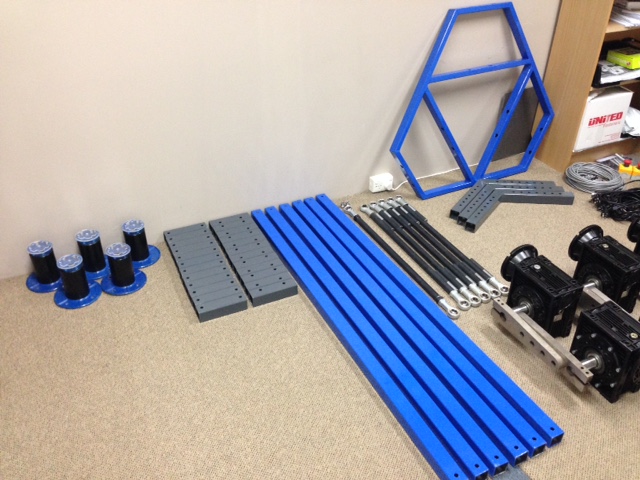

Almost everything is made and ready to be assembled.

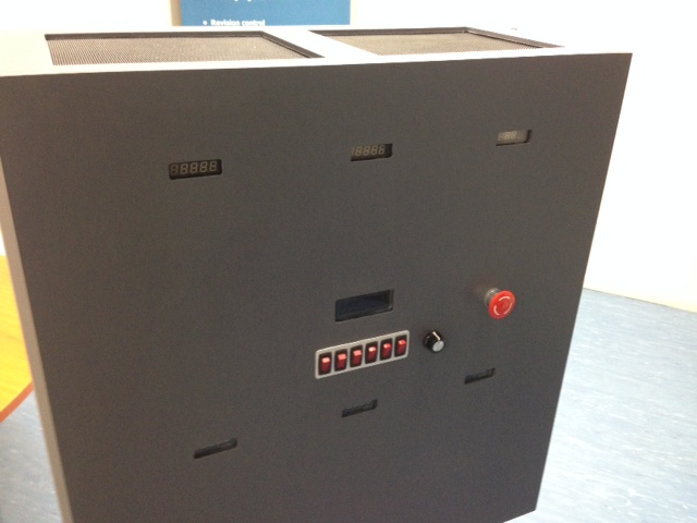

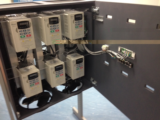

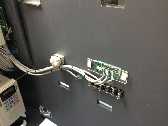

The electronics enclosure is almost complete. The only remaining connections being those between the VFDs and Thanos' board.
Following that, it will be time to start testing the motors & sensors via the AMC1280USB.
Hands up if anybody recognises what I managed to use for the sensor mounts? ;)
basically, I'm really looking forward to next week's progress...

Postby Riton » Mon 6. Oct 2014, 15:53
it's coils cables
Riton
Posts: 291
Images: 70
Location: France
Been thanked: 16 times
Postby DoctorD » Mon 6. Oct 2014, 15:56
10 Points to the man above :D
Correct you are my friend. At 50 cents each I could never complain :P
