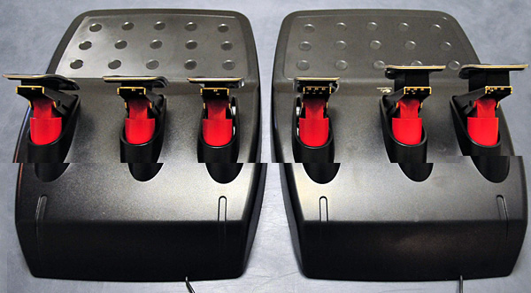

I know how it works :o , but i´ve to modd my Pedals like the G27 look:
G25/G27 pedals
But this i no problem for me 8-)

With g25 just design a wooden block that you put between pedal frame and stick metal.( I made this with a t500 rs pedal )
For the screenshot for the G27 this plastic block have to be removed from the throttle pedal.
Re: My selfmade 2DOF racing SIM
Postby mario318i » Thu 7. Mar 2013, 14:31
how thick did you have the block? 20-30 mm? is it better without a block on the throttle pedal?
