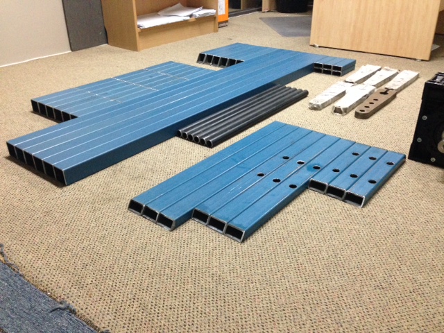

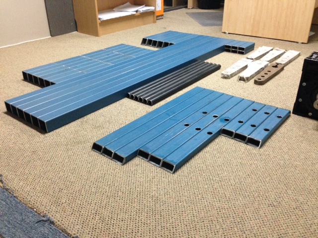

I think I'll be dreaming of metalwork, cutting, grinding and drilling for some nights to come :lol:
I've managed to put a good amount of time into the framing components for the remainder of the platform, with the following image the result:

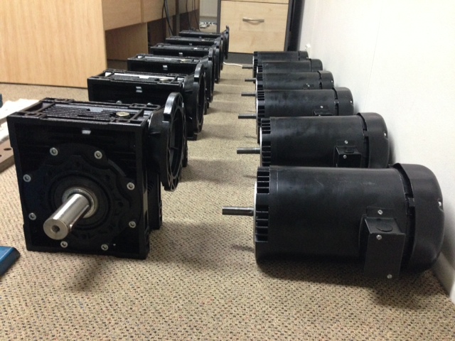

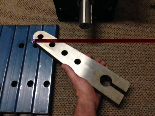

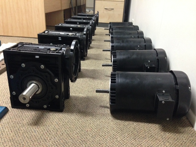

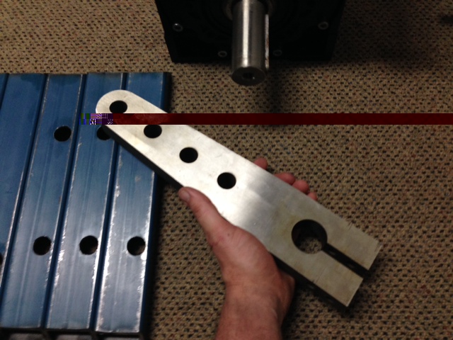

I am now also the proud owner of some fantastically made stainless steel torque arms and RV90 size gearboxes:
I'm absolutely aching to finish up the frame (welding, drilling, priming and painting to go) in readiness to start testing Thanos' electronics :)

Postby Riton » Wed 24. Sep 2014, 16:11
very nice
ready for welding
why did you not centering the drilling on the tubes?

Postby DoctorD » Wed 24. Sep 2014, 17:13
Heya Riton, thanks for the comment.
I think you are referring to the 20mm drill holes in the blue steel sections?
They are offset so that my upper platform bearings and control rods miss the outer edge of the platform at high tilt angles.
Have a look in the following picture. Hopefully this answers your query :)

Postby Riton » Wed 24. Sep 2014, 18:16
I am not sure understanding.
I would see in operation.
This is a safeguard, that's it.
engines by the soft going well limit the angle?

Postby TripRodriguez » Thu 25. Sep 2014, 07:11
Thanks DoctorD!
I'm building my platform with the same motors, gearboxes, inverters, and dimensions as several other people including Stevant above so I can keep this fairly simple I think.
Expected payload about 200 Kilos max but some extra capacity would be nice just to be safe so let's shoot for 300 kilos.
Moment arm length 160mm but I'd also like to add holes like your arms for shorter and for longer moment arm length just in case I want to experiment. If this adds much cost we can just do the 160mm. As for the shorter and longer moment arm lengths I'm open to suggestions.
I'm happy to hear the shipping was reasonable!
Also a possible error in the dimensions I gave before: My ball joints have 5/8" holes. I said the holes the arms should be 5/8" but I'm actually not sure what hardware to use, whether to use a sleeve, etc. so I'm open to suggestions on that as well. Once the ball joints get here I'm planning to take one to the hardware store and check the fit on various hardware.
