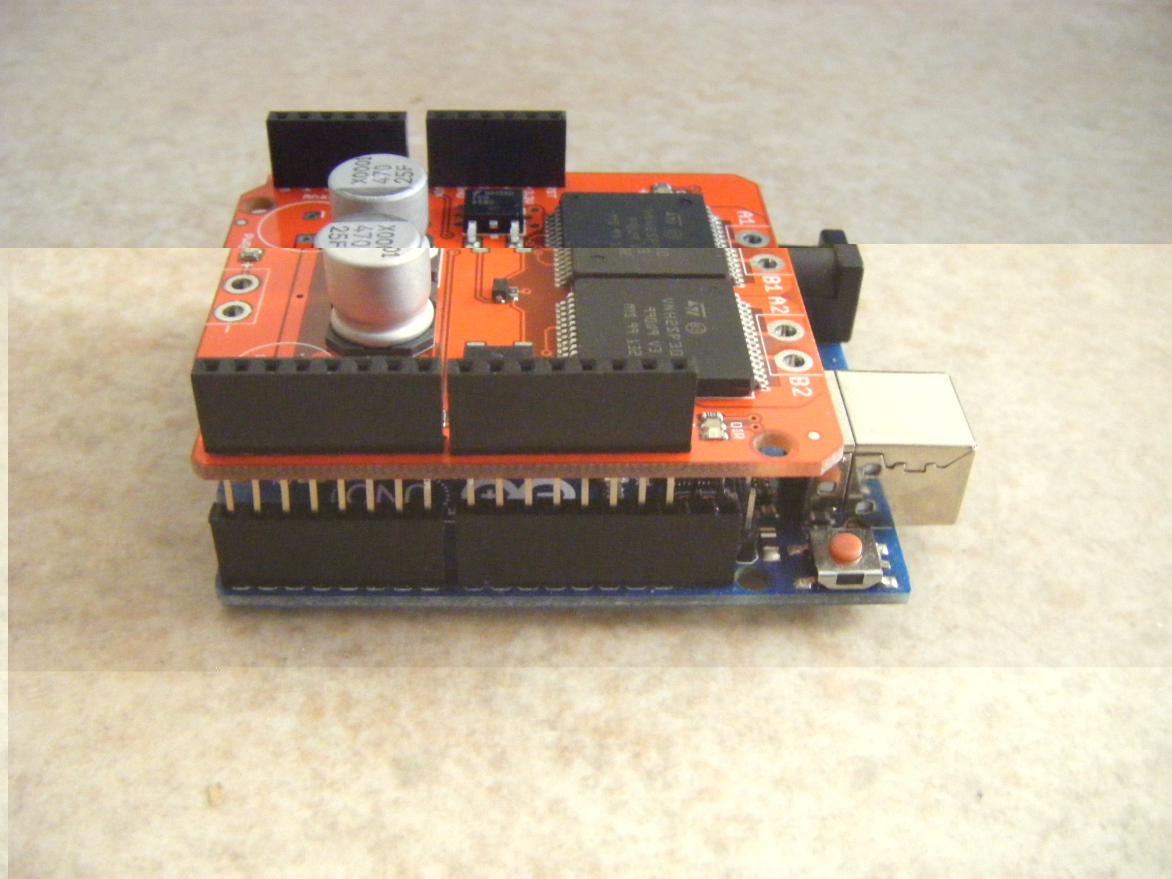

Postby RacingMat » Sun 15. Sep 2013, 10:48
Hello Aboodix5,
If you bought the Motomonster board, the simpliest is to stack it onto Arduino !
If you don't, you have to follow the following pinout :
Arduino and Motomonster have same pin's number !
connect together
Arduino .../...Motomonster
......GND <-> GND pin
........5V <-> 5V
.....pin 4 <-> pin 4
.....pin 5 <-> pin 5
.....pin 6 <-> pin 6
.....pin 7 <-> pin 7
.....pin 8 <-> pin 8
.....pin 9 <-> pin 9
pin 13 is not needed
In the initial post, I've soldered more wires but they are unused wire...
On Arduino pin A4 and A5 connect Pot left and Pot Rigth.
Mat

Postby aboodix5 » Sun 15. Sep 2013, 11:02
connect on two side of the arduino the same Sequence?
aboodix5
Posts: 4
Joined: Thu 15. Aug 2013, 10:14
Postby RacingMat » Sun 15. Sep 2013, 12:20
No...
the wire should connect the Arduino's pin 4 to the Motomonster's pin 4
and so on !
Just like if it would be stacked ;)

Postby mleunam » Mon 16. Sep 2013, 21:22
If i dont connect the analog pin of arduino to the monster motor shield analog pin, should work ?
mleunam
Posts: 11
Joined: Wed 10. Apr 2013, 20:58
Postby RacingMat » Mon 16. Sep 2013, 21:59
Hello mleunam !
In my configuration, the potentiometer's values are "read" by the Analog pins of Arduino .
So, there is no need to connect Anolog pins between Arduino and Motomonster.
Motomonster is an H-bridge without feedback loop capabilities : it doesn't have analog pins.
Arduino tells to motomonster information as "this way" and at "this speed".
This requires only 2 pins for direction and 1 pin for speed per motor : (2+1) x 2 = 6 wires and 5V and GND.
Mleunam, what is exactly your hardware setup ?
Mat
Posts: 456
Images: 147
Location: Marseille - FRANCE
Been thanked: 130 times
Postby mleunam » Tue 17. Sep 2013, 10:10
my seup is the same of you, monster motor shield and arduino but i cant send the strings for arduino,
wen i manualy turn the pot to roll one motor, the 2 motor turn with the same pot, i dont know wy
mleunam
