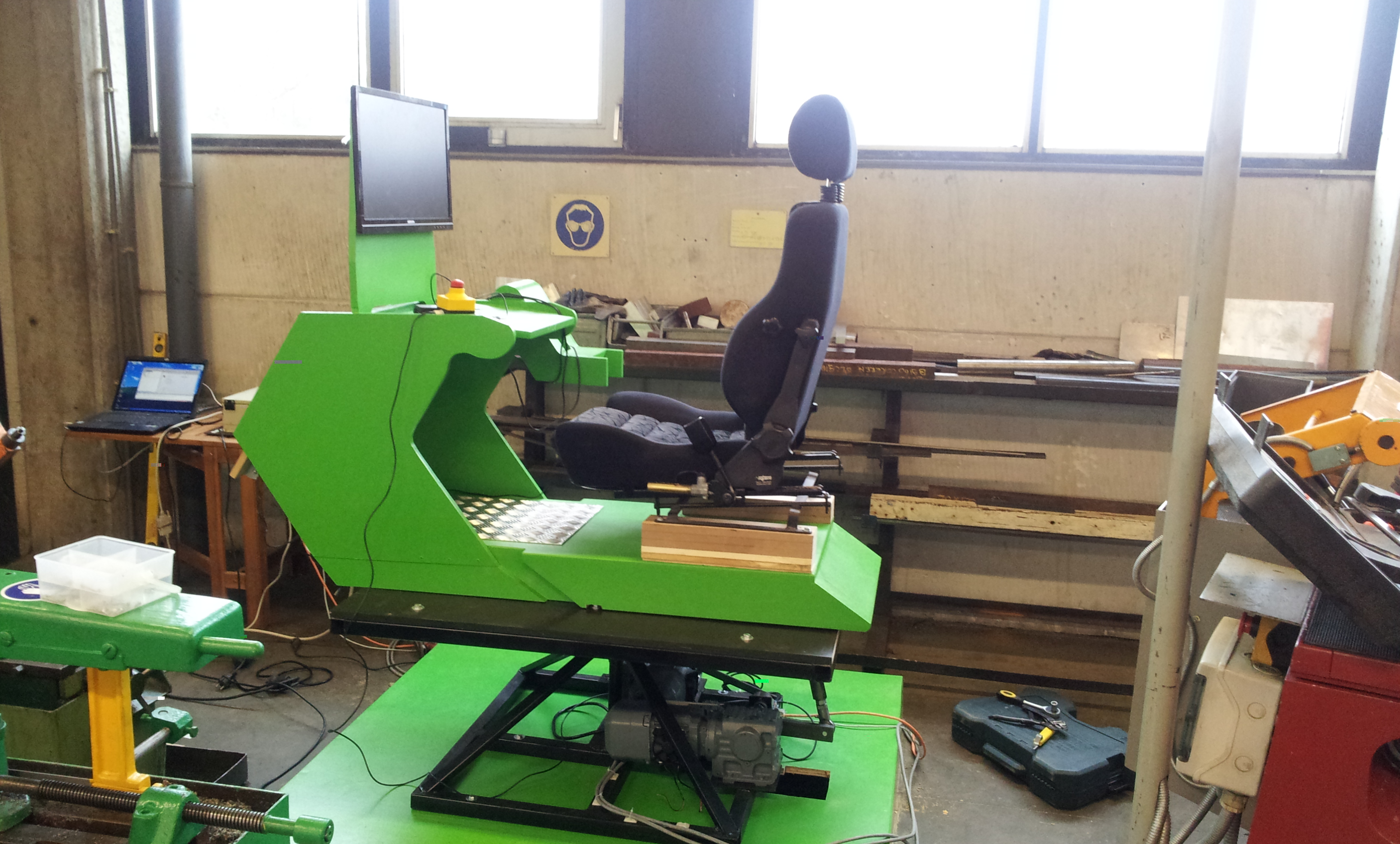

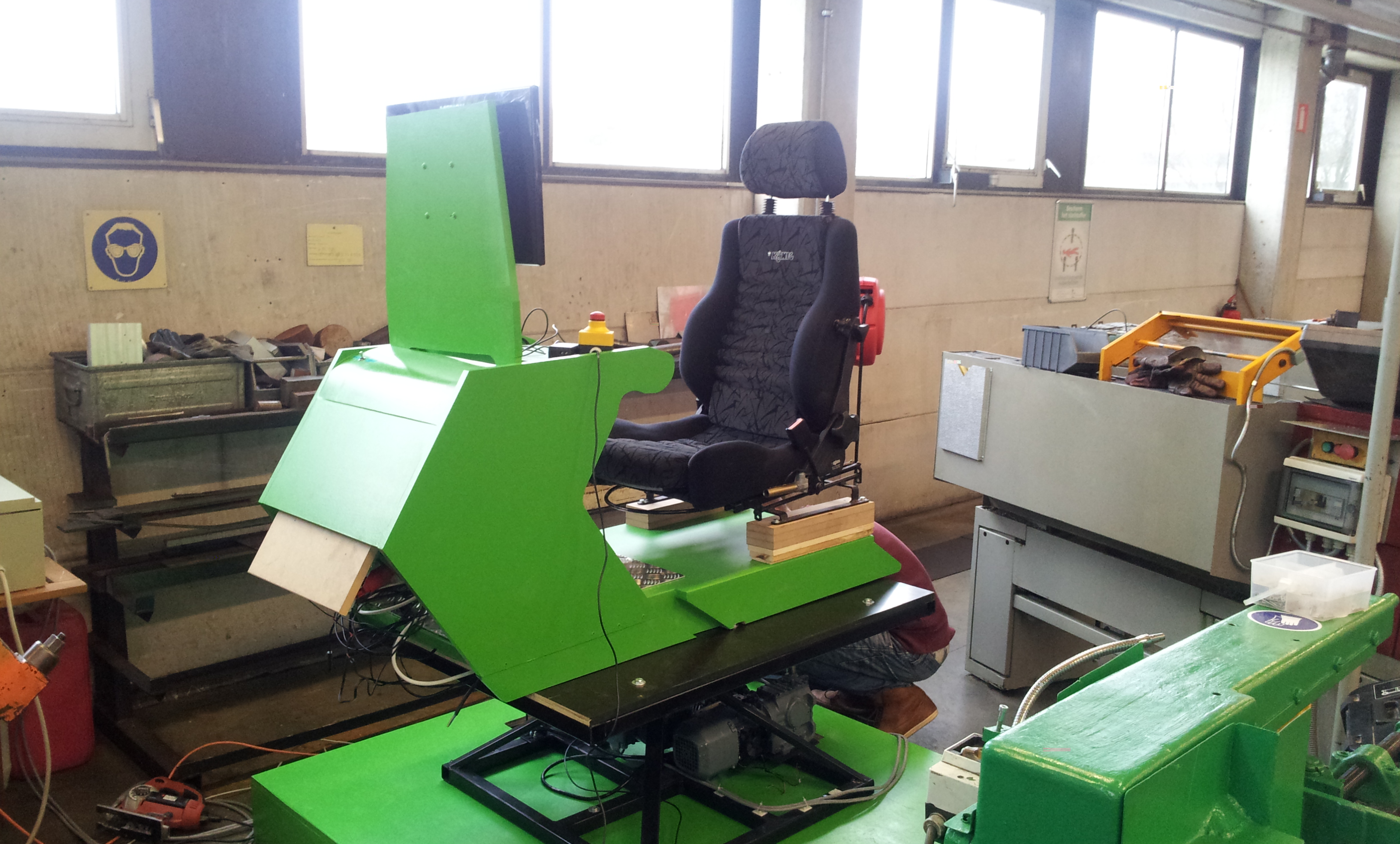

Hello everybody,
The racesimulator is assembled. We should have tuned it within the next three weeks. Below you can find some pictures of the assembled simulator.

Postby motiondave » Sat 16. Mar 2013, 00:31
Hey that looks great!
I can see where most people will be at lunch time.... ;)
