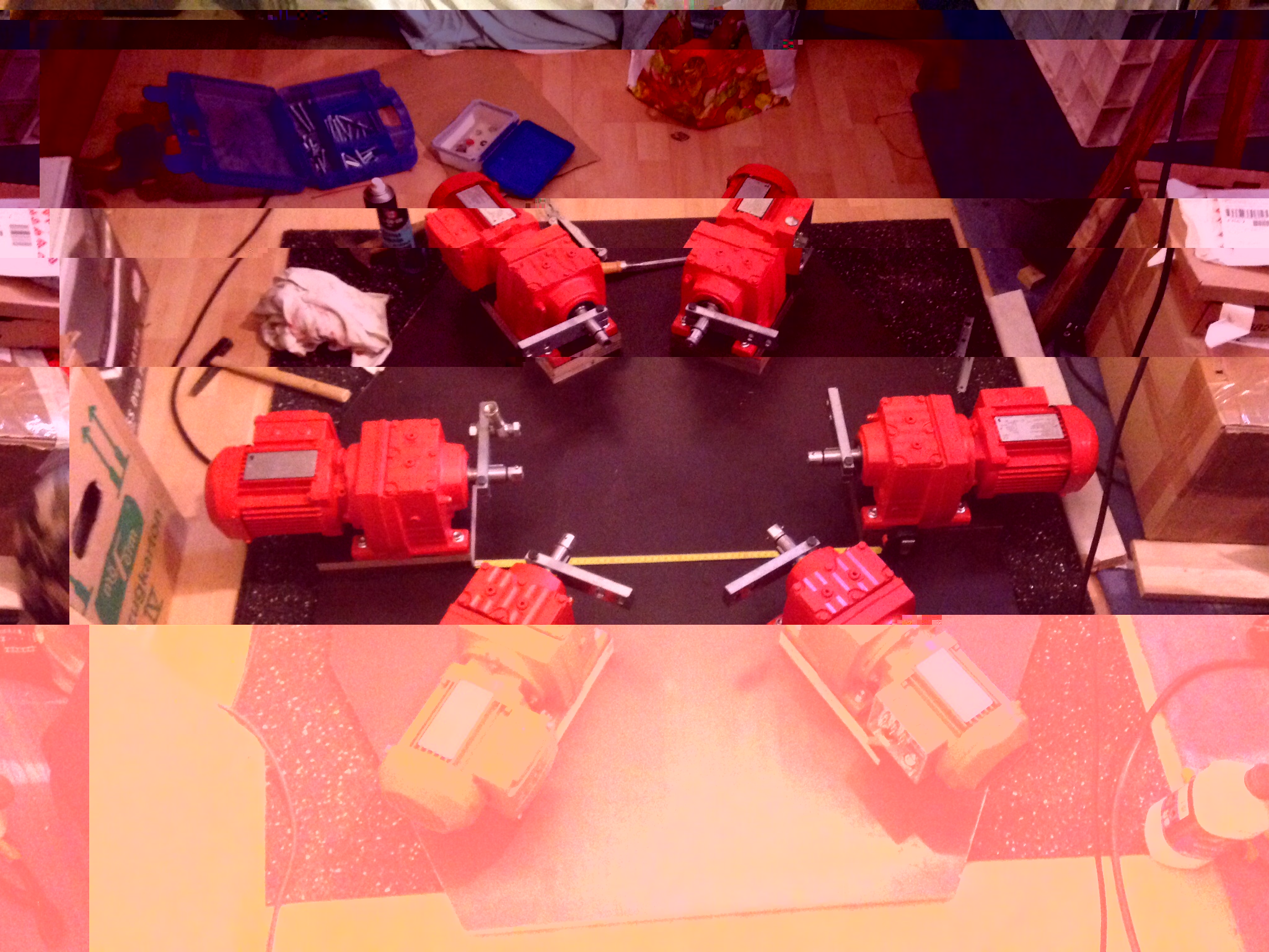

A little point from my project .I finished the motors uper plateform.They all are in place and the designe looks great for me (hope the motion too ;) ).
The distance between 2 motors where you see the ruler is about 58cm.My arms will measure 30cm between up and down platforms and 2 positions for the arms attached to the gearbox output shaft with 8cm and 11cm.

Platform

This looks really awesome, and is quite a compact design, I really like it!
Can't wait to see it in motion.
