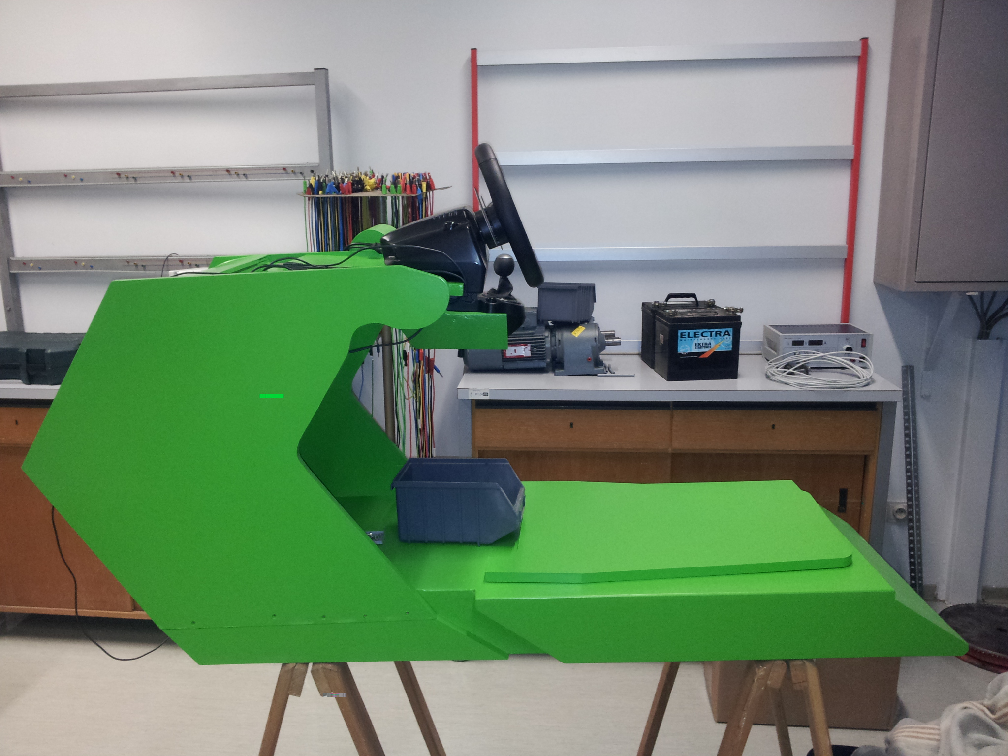

Hello everybody,
The wooden structure of the cockpit is ready. Next up will be installing the transducer, seat and pedals. The seat and pedals will take a while since we will keep this as the last part. Don't mind the colour, that is the schoolcolour :-) . I would be prefer black or red but the principal insisted on the green colour :-) .
For anybody who would be interested, the plans for the platform can be found here:
http://www.ricmotech.com/store/diy_chas ... kpit_plans
Tomorrow pictures will follow from the steel structure. I Hope to start testing movement next week.

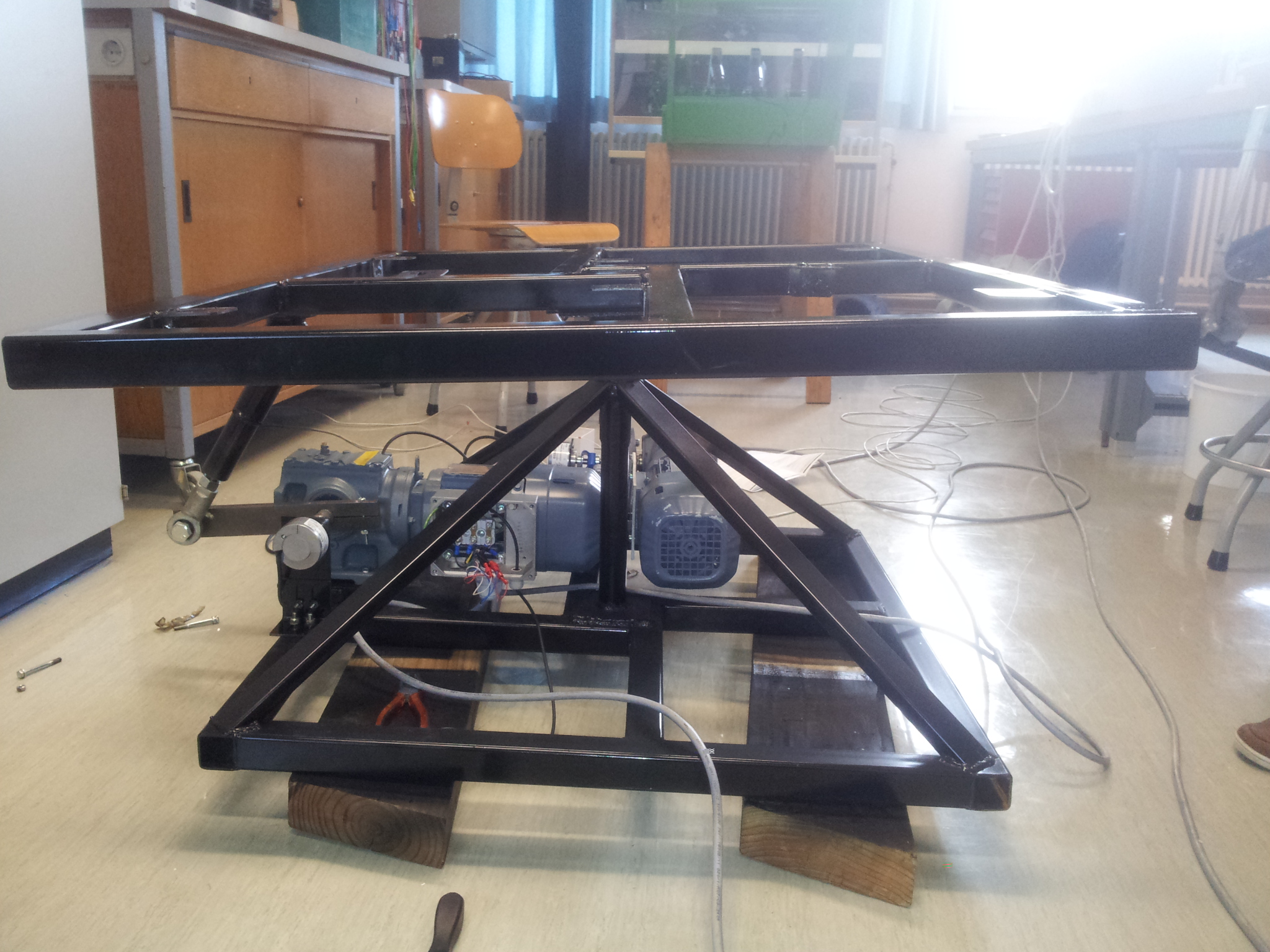

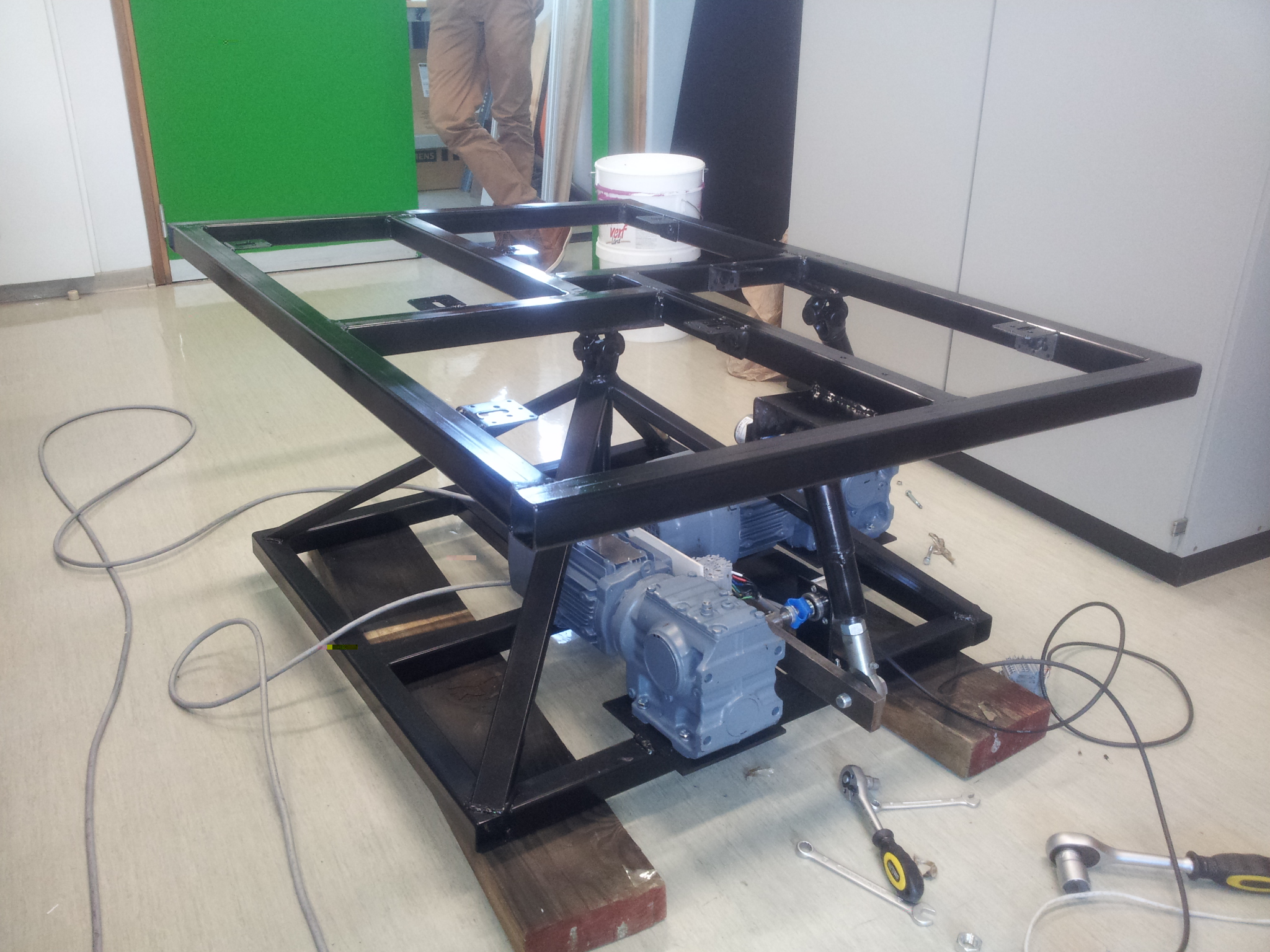

In the meanwhile the students have spraypainted the platform and assembled the motors and encoders. Below you can find some pictures, a drawing and two animations of how it will work. When the simulator is ready I will make a detailed document so that others can build the simulator should they want to.
First manual test seems to point a maximum roll- and pitchangle of 16°.
Greetings,
Bart

Postby Mertensbart20 » Thu 28. Feb 2013, 20:13
Hello everybody,
The platform is almost finished. Below you can find a video of the movement. Exact positioning is already possible. Speed can be much higher but since the limit switches are not in place yet I tested at lower speeds for the moment.
The goal is:
- pitch and roll-movement of 16° (already tested)
- speed of maximum 40° per second (of the platform)
- load 180 kg (already tested with 150kg).
I hope to have the platform operational next week. The cockpit will be installed soon after.
