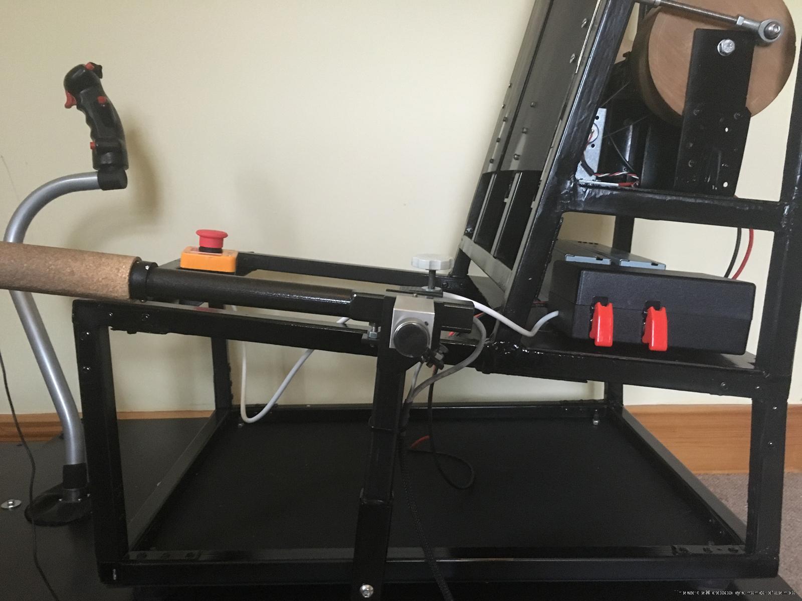

Postby RiftFlyer » Sun 17. Apr 2016, 19:31
I have finalized the power system for the actuators. I am using separate 12volt supplies for the base and back of the chair. Power is being provided by the trusty HP DPS600pb server power supplies. Each is rated for 47amps.
I made up a switch box to keep the wiring tidy. Each supply has its own switch. Power is passed through a fuse to a relay to the motor monster shields. The relays are connected to a kill switch which is mounted within easy reach ;-)
Internals of the power box
4056
Power supply switches
4057
Here you see the proposed mounting location.
4058
