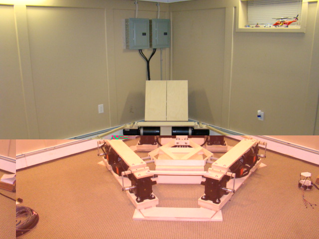

For those following my thread, I had the electrical panel installed today. You'll notice the panels in the top of the picture. Here in the US we use 110v as standard power, I think outside the US they use 210-230? I had to run 6 220v, 20 amp circuits, one for each motor. I'm getting that much closer to testing. Waiting for my board from Thanos, my brake resistors and my 24v power supply.
I'll keep you posted....... :D

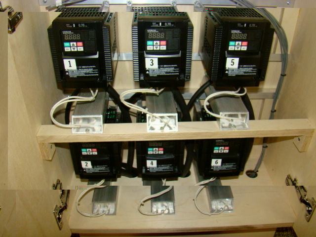

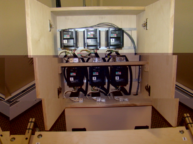

My 300w 200ohm brake resistors came in. I installed them as you can see in the pics. Once my board comes in I can hook it up to see how she moves!!

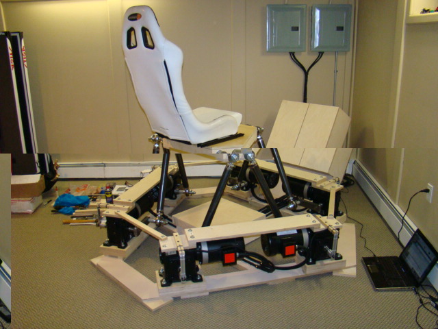

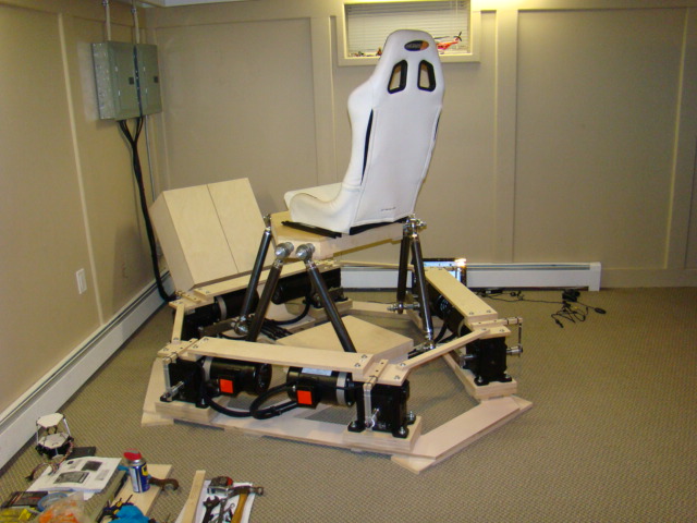

My new HEIM joints will be in tomorrow. I will shoot a before and after video showing both joints. I mounted my old chair to my temporary platform to see what it is going to look like. I went for a ride of course on x-sim test mode. Works great. I know it will be much smoother with the new joints as the current joints bind due to the injection molded plastic in the joint. These are definitely not for this application, way to heavy duty. I know you cannot feel it but I know you'll see a smoother movement in the platform. Here are a few pics of the chair mounted.
Thanks for everyone's input. I truly appreciate it. I will be mounting my new platform later this week and will also be putting my triple screen setup in place. I'll load pics and video when I get to that point. Attached is a pic of my setup I will be placing on my platform. I will not be placing the entire setup, the base you see there will be removed. Only the seat and the sides going up to the screens will be mounted. A picture tells a thousand words as you will see when I'm at that point. :)
