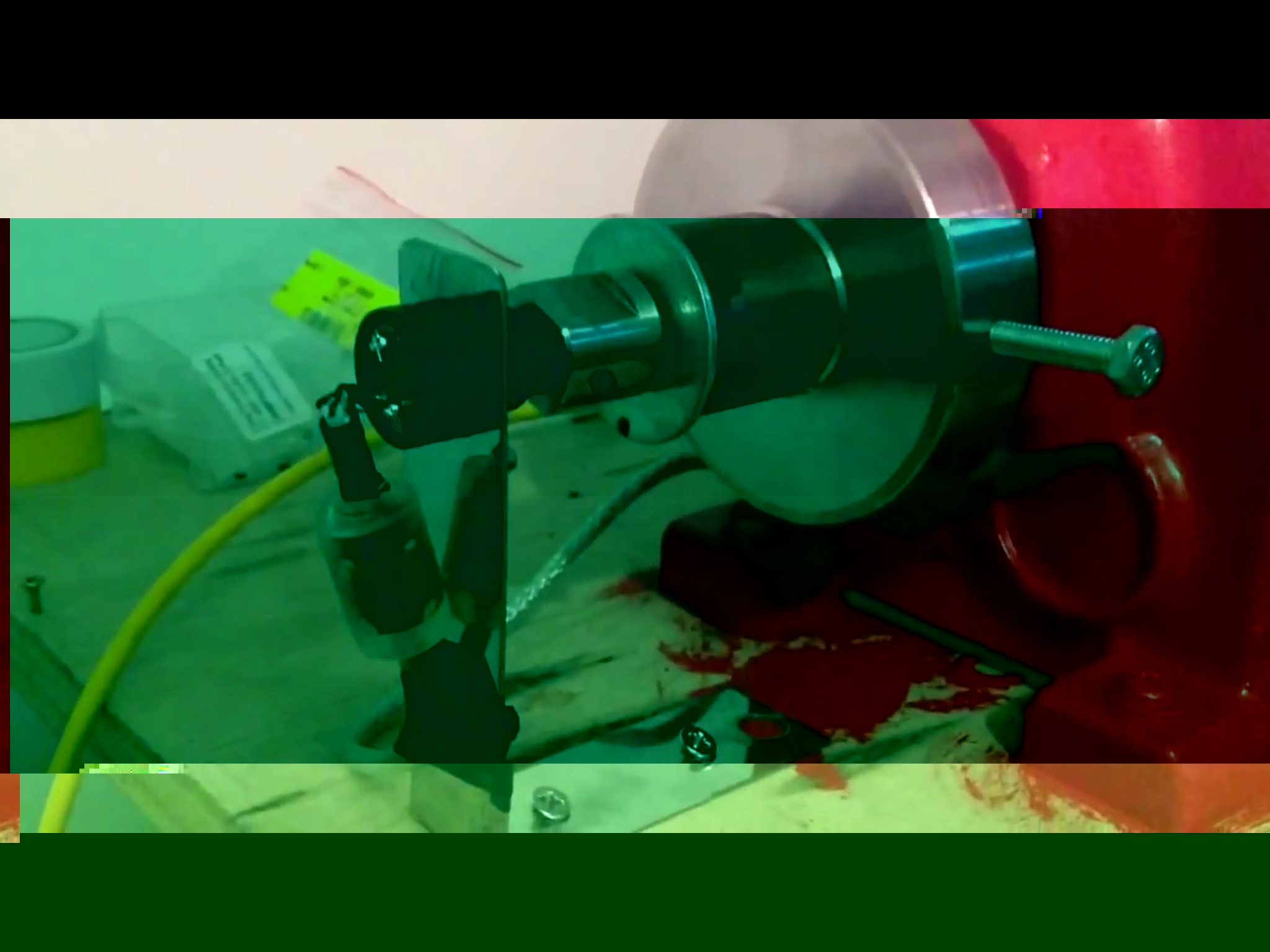

Do you have technilogy Level for your movitrac's ? Do you use real Encoder for your Motor ?
Monaco85

Postby vicpopo » Sun 30. Mar 2014, 13:59
Monaco85 wrote:Do you have technilogy Level for your movitrac's ? Do you use real Encoder for your Motor ?
What do you mean technology level ?
In the the movitrac there is a simple start up procedure , it's quiet easy .With 5 paramaters more that's enough for our need.
No I don't have real encoder , just a sensor position (linear hall sensor) connected directly on the gearbox output shaft.
Below pic.
Sensor

Postby Monaco85 » Sun 30. Mar 2014, 15:47
I thought u have programmed in ipos. This is only possible with the Movitrac Technology Level.

Postby vicpopo » Sun 30. Mar 2014, 19:01
Hi ,
No I do not programed Movitrac via Ipos.
Thanos amc1280usb is the master and Movitrac B is the slave!
Amc1280usb give the setpoint 0-10v according the game g-force and the direction 0-24v.
The MovitracB executes orders.
