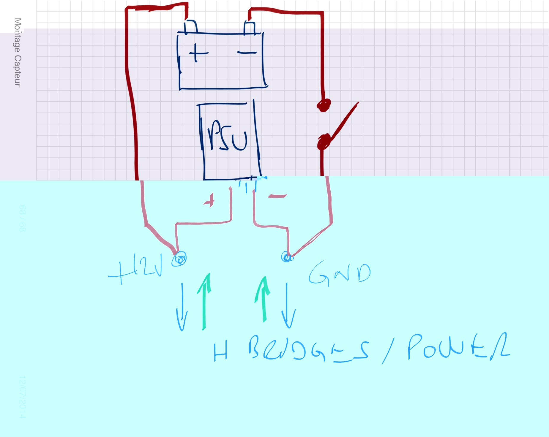

latest news .... unfortunately we have a problem :evil: . We replaced the batteries with this power supply ( look this link for the reference ).
http://www.tme.eu/it/details/rsp-2400-2 ... ean-well/#
In practice, the electric motor generates a voltage that goes inside the power supply (through the meter we measured about 30 v :shock: )...not good !!!
the power unit go into protection
possible solution ? tks

Postby vicpopo » Sat 12. Jul 2014, 14:02
Hi ,
Why didn't you leave battery paralel with the psu?

Postby thecure » Sat 12. Jul 2014, 16:51
vicpopo wrote:Hi ,
Because the battery will lose his power during the use while the psu won't do it.. How can I do to use both as you said? Could you make a draw of it, please?

Postby vicpopo » Sat 12. Jul 2014, 18:26
Draw
For my first simulator with sabertooth and dc motors I used this setup.
When I played I switched ON the button for using the battery.If I was needing more Amp the current could come from the battery and help the psu.
And in case of back current , Voltage the battery could assume better this problem as the psu.
And If you want to re charge , re-load the battery you leave the switch OFF.
And when you stop playing you switch OFF .

Postby thecure » Sun 13. Jul 2014, 15:07
tks..i tried this solution !!!!

hello thanos,, ... We replaced the battery at 24 volts with a 24 volt power supply ( this http://www.tme.eu/en/details/rsp-2400-2 ... mean-well/ ) always and 100 amperes, we've our first problems with it.The test 'was done in a manual way .When we turn the potentiometer in a sense, in "normal" mode, or in a "fast", there are no problems.Anyway if I suddenly ride the potentiometer in the other direction, the power supply goes into protection.
Nb: This issue has been resolved with a diode (see thelink), 'cause the engine was sending inside the power supply voltage
