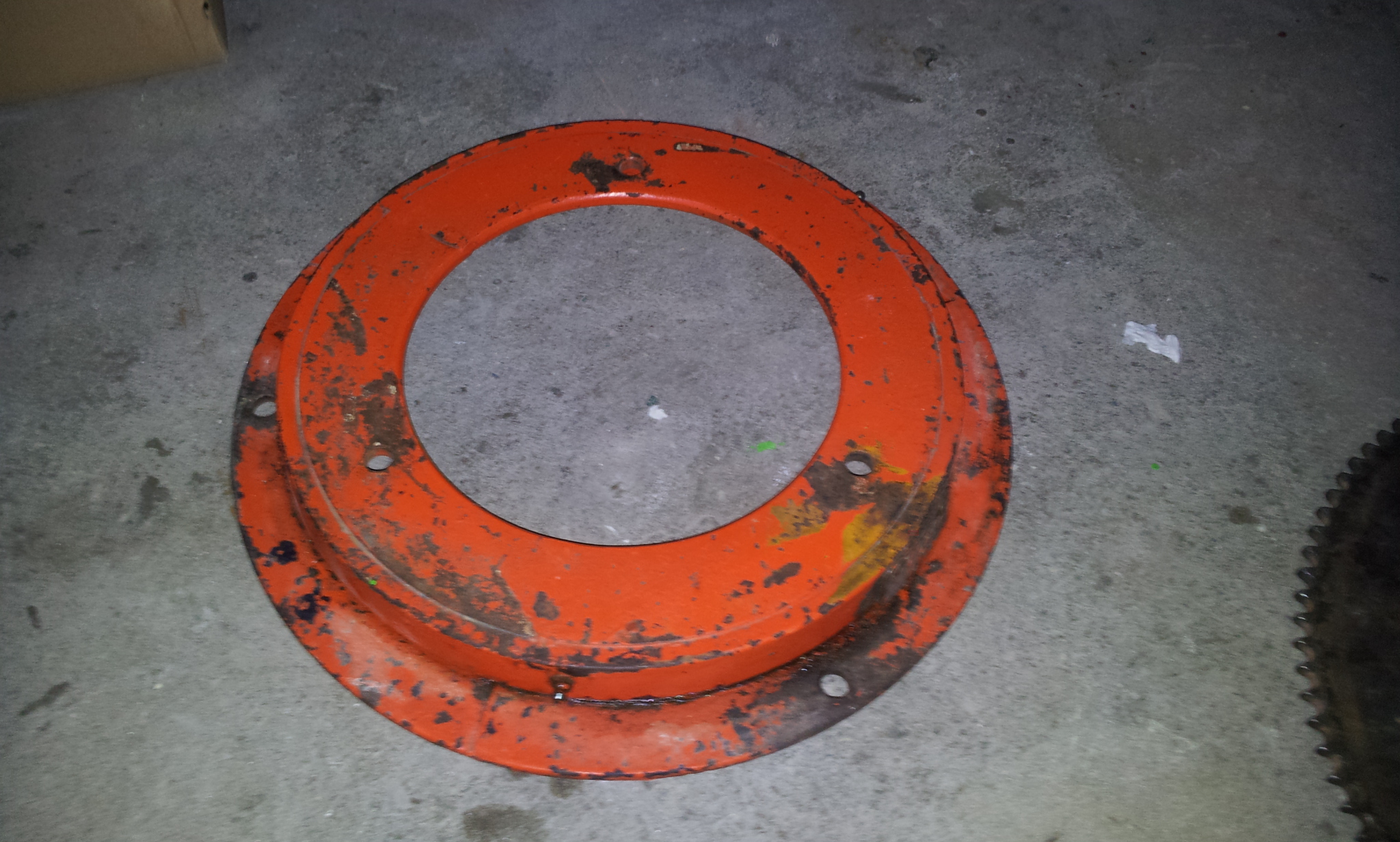

That is indeed what I am talking about, looks good. Would you mind sharing the desingschematics? My students will have to design one for my platform but a good example is always handy. I am planning to use another approach though. I was planning to use a threephasemotor with a big reduction (about 8rpm) and drive directly the center. The contruction would be supported by an axel (see the photo in the attachment, I don't know the correct term). But for a good balance I would like to a supporting wheels that would be incased in a sort of railsystem. But I don't know where you can find such railsystems.

Hello, I'm the other construction of this project ...
if I understand it you want to know what kind of railsystem we used:
for traction as he mentioned my friend THE CURE is a drive system with
toothed belts with a double reduction ratio, which allows us to have a rotation (at max speed) to 72 degrees per sec. :oops: :oops:
Traction
We wanted to use those Vulkollan but were too hard and slippery so ...
so now the whole structure is moving on polyurethane wheels with cast iron center (those of traspallet to speak, because they are dimensionally stable even if they remain still for a long time in the same position) .... one of which we have modified to insert ourselves traction;
an example for sampling can be found here ... http://www.tellurerota.com/en/product-range
On the other hand though, if you want to put the engine in the middle you should use the wheels from sliding gate, costuire a circular track and appoggiarcele above ... (the only flaw is that they are intemante metal, so there may arise some noise)
If you want to take example, some video here could be for you ...
you do not see so well but I think it is sufficient to
http://www.youtube.com/watch?v=U82iHzs2 ... iUwAZyLEio
I hope I was helpful .... greetings and news updates soon ... stay tuned

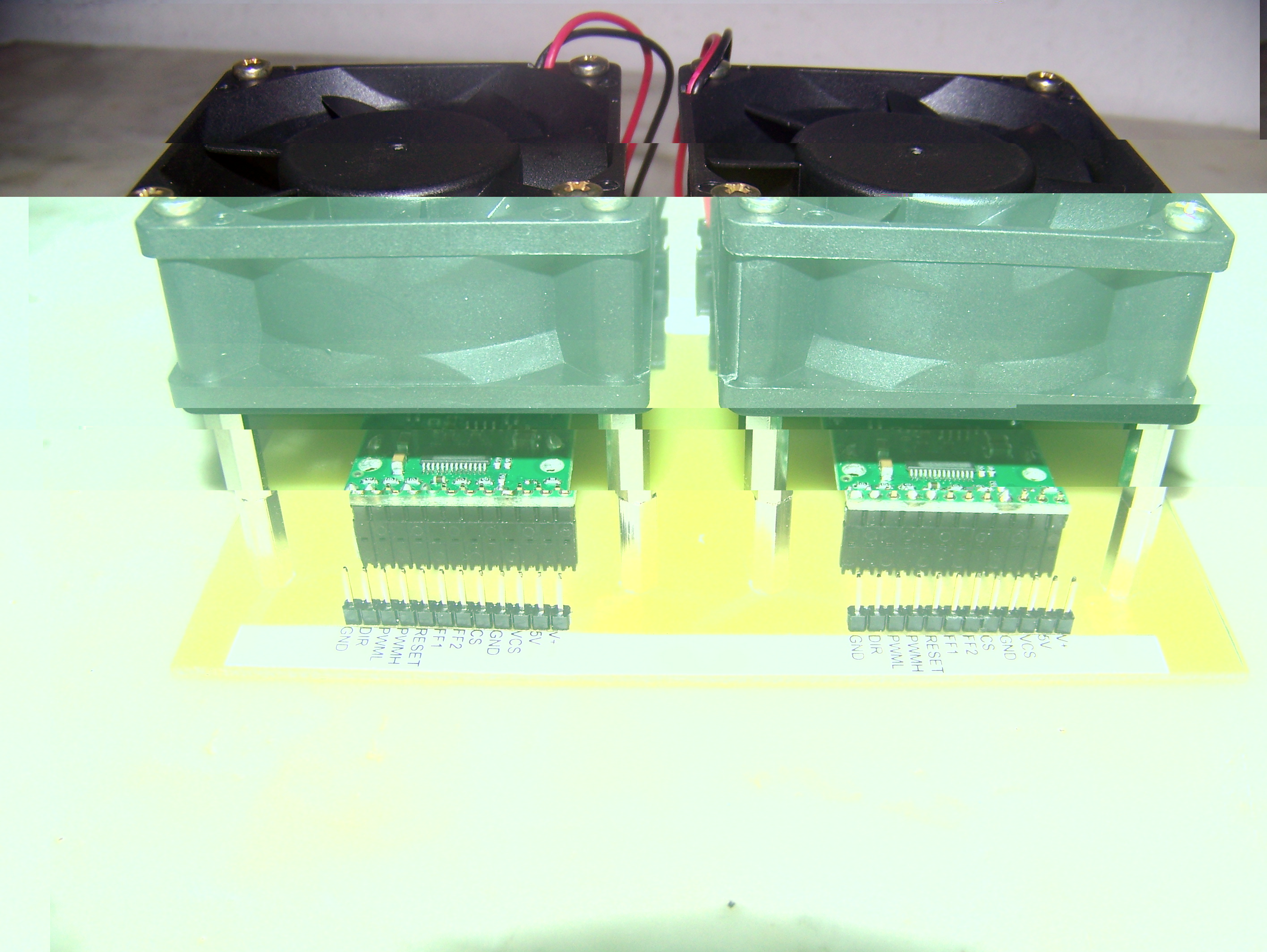

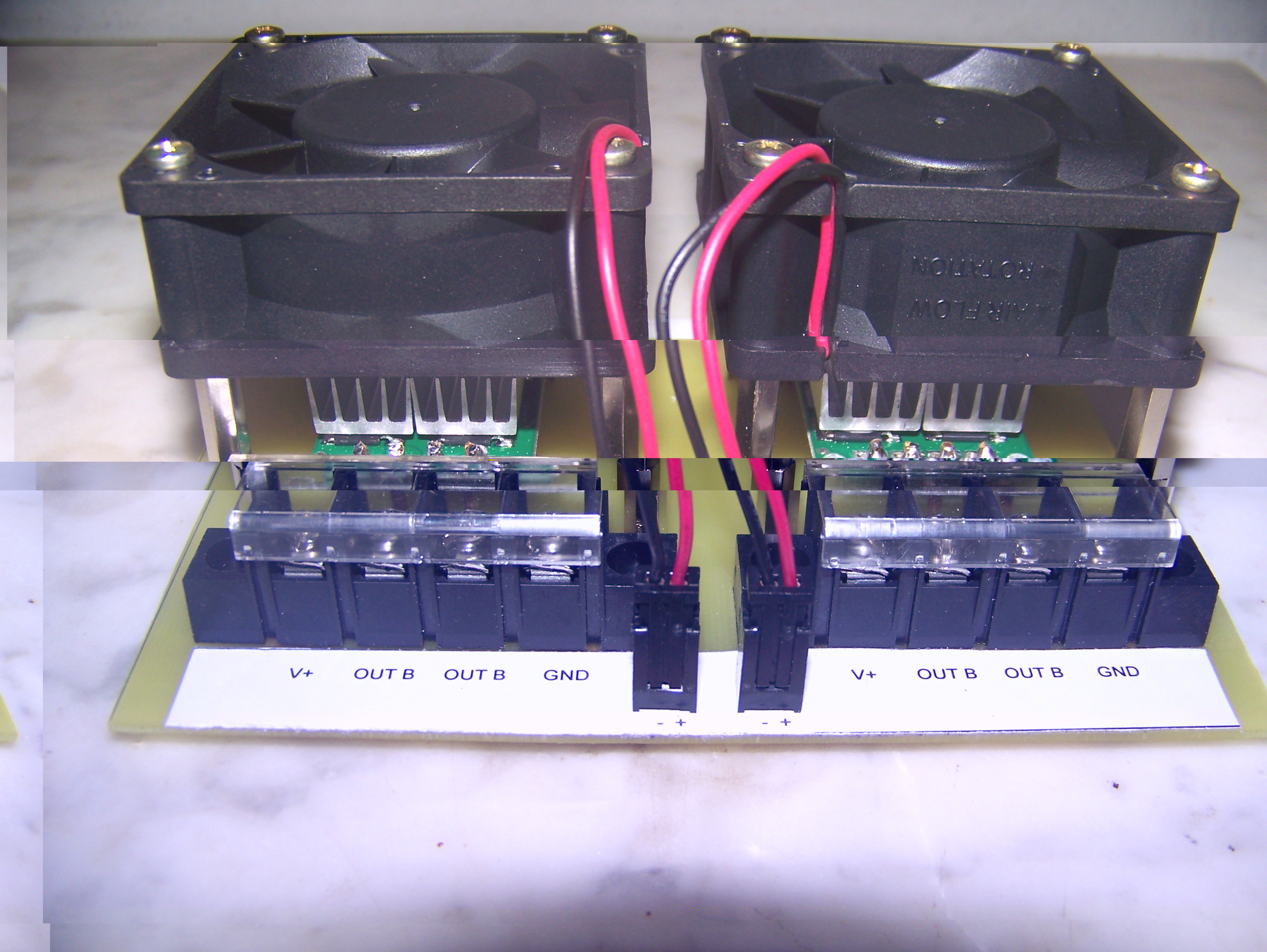

Postby thecure » Sat 31. Aug 2013, 13:54
work in progress !!! ;)
the pololu controller is burning !!!!!
thecure
Posts: 122
Been thanked: 5 times
Re: 3DOF power simulator
Postby RacingMat » Sat 31. Aug 2013, 21:23
it looks nice and robust !
well done ;-)
want to see more, of course !!
