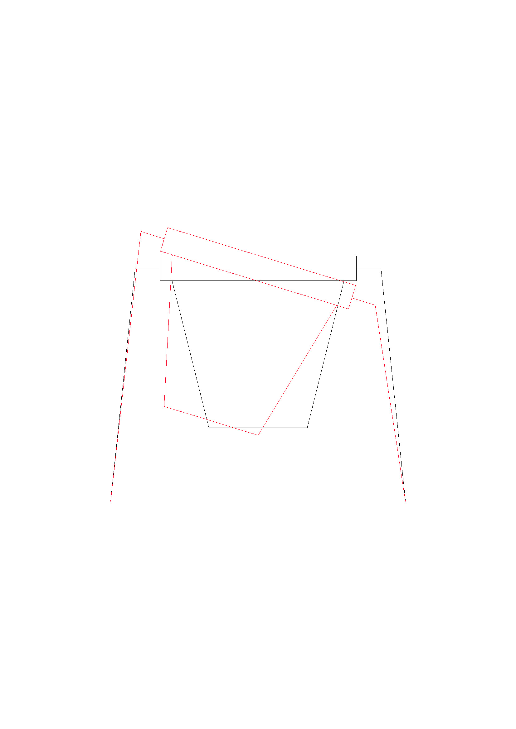

We're working on today, we have made ​​some changes in the drawings for
find the right spot to add PTFE pads inside the barrel and replace the one in the head! :cry:
Replace the old rod 20mm with a 32mm tube.
We also have a slight twist in the attack on the base, a few tweaks and we hope to reduce them as much as possible! :oops:
thanks for your interest and if you have any suggestions ... do not hesitate!
Stay tuned :mrgreen:

When the simulator is tilted, and when the simulator is horizontal, there is a difference in space between the cockpit and the cylinders.
It is therefore necessary that the cylinder moves away from the base to compensate.
Force Dynamics is doing like this.
I have a similar system on my simulator.

Re: 3DOF power simulator
Postby basthard » Thu 13. Jun 2013, 20:20
no, no space, I copied the FORCE Dyanamic in this! looks better :oops:
the distance up is always the same ...
the cylinders / actuators are pivoted at the lowest point and have the ability to tilt.
the vertical rail is maintained by the actuator back!
when the tilted diagonalle is always the same ... so!
then the cockpit was built in geometry rhomboid, more closely below,
this is what makes up for the distance.
Looking at your post known only one defect: how do you keep the center of the two front supports?
leaving them free you'll have a great game when they are horizontal?
and when you tilt, how do you not let them slip from the lower part?
at least that's what we used until now
greetings Basthard :mrgreen:

Postby Riton » Thu 13. Jun 2013, 20:28
Perfect!
I had not seen much if the bottom of your cylinders moved to follow the movement, I afraid that this is just flexing of cylinder rods.
Ok so it's good!

Postby Riton » Thu 13. Jun 2013, 20:37
a frame of this type demand stems rigid cylinders and very big.
it's not easy.
the offset height is important
requires a good support in the cylinder, the force in the rings within the cylinder is important.
when the cockpit is high, the swing is important and what is the cylinder rods that flex.
it is to avoid these constraints I chose my chassis and mounting the fixed rods.
you will need to strengthen seriously to reduce bending.
in any case, it's great work! ;)

Postby basthard » Thu 13. Jun 2013, 20:57
no problem guy!! :oops:
we are solving the problem by replacing the rings with PTFE pads
down instead had already planned to enlarge the support to prevent bending!
ready as soon as the pieces will let you know ...
