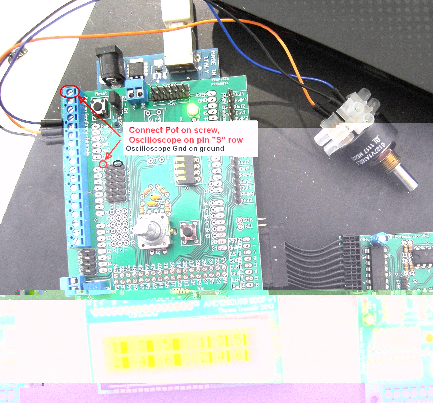

I would like you do with the oscilloscope. but I can not seem to set the oscilloscope;
where you connect the probe?

Connect the probe on the pin row "S" of the analog input on the AMC1280USB, and the potentiometer on the Screw terminal.
The alligator clip on the probe is the GND.

Postby Riton » Thu 9. Oct 2014, 00:49
that's what I did.
I must have a problem adjusting the oscilloscope ...
I do not see the downhill and overtaking.
I do not control well this scope ...
I wonder if I'm not a function that is the problem.
I have 1V per division.
the fastest rate.
