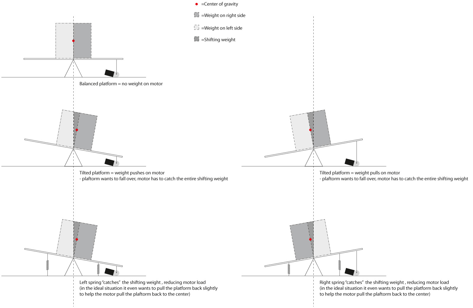

Regarding yokoyoko's remarkt about the balance point:
Finding the balance point is important for sure, but as soon as a platform style sim is tilted it "falls" out of balance (same happens with a seat mover but with less shifting weight). Here's a sample doc I made for someone else a while back:
In the most ideal situation the center of gravity and pivot are on the exact same spot, this would require the least force to move it around.
Hence my remarkt about the fact that I would have mounted the pivot through the platform and underneath the seat instead of underneath the plaftorm if I would do a same sort of build again. In my case the center of gravity is quite high above the pivot.
floriske

Re: Floriske.nl's 2DOF Playseat GT Wiper motor Project
Postby floriske » Fri 2. Nov 2012, 13:48
In your case your balance point is a lot lower than in mine (as mentioned sort of a flaw in my design that I would have done different if I had to do a new build). In my case more weight shifts while tilting and the springs are a precaution for "reducing" this weight. But you are absolutely right: springs are no must have with big motors, just helpers.
Postby floriske » Tue 6. Nov 2012, 09:44
I have only thoroughly tested the difference with and without springs when I was still using wiper motors, and yes they made a great difference. The sim felt more responsive and faster with bigger spring tension as it did with lower tension.
With the new wormgears I didn't do any more testing, but they helped with the wipers I reckon they will help with the wormgears as well.
One small extra advantage of the springs is that, if the motors power is cut, the sim tilts to the direction it was in at that point or where I shift my weight to a little slower instead of suddenly dropping over.
