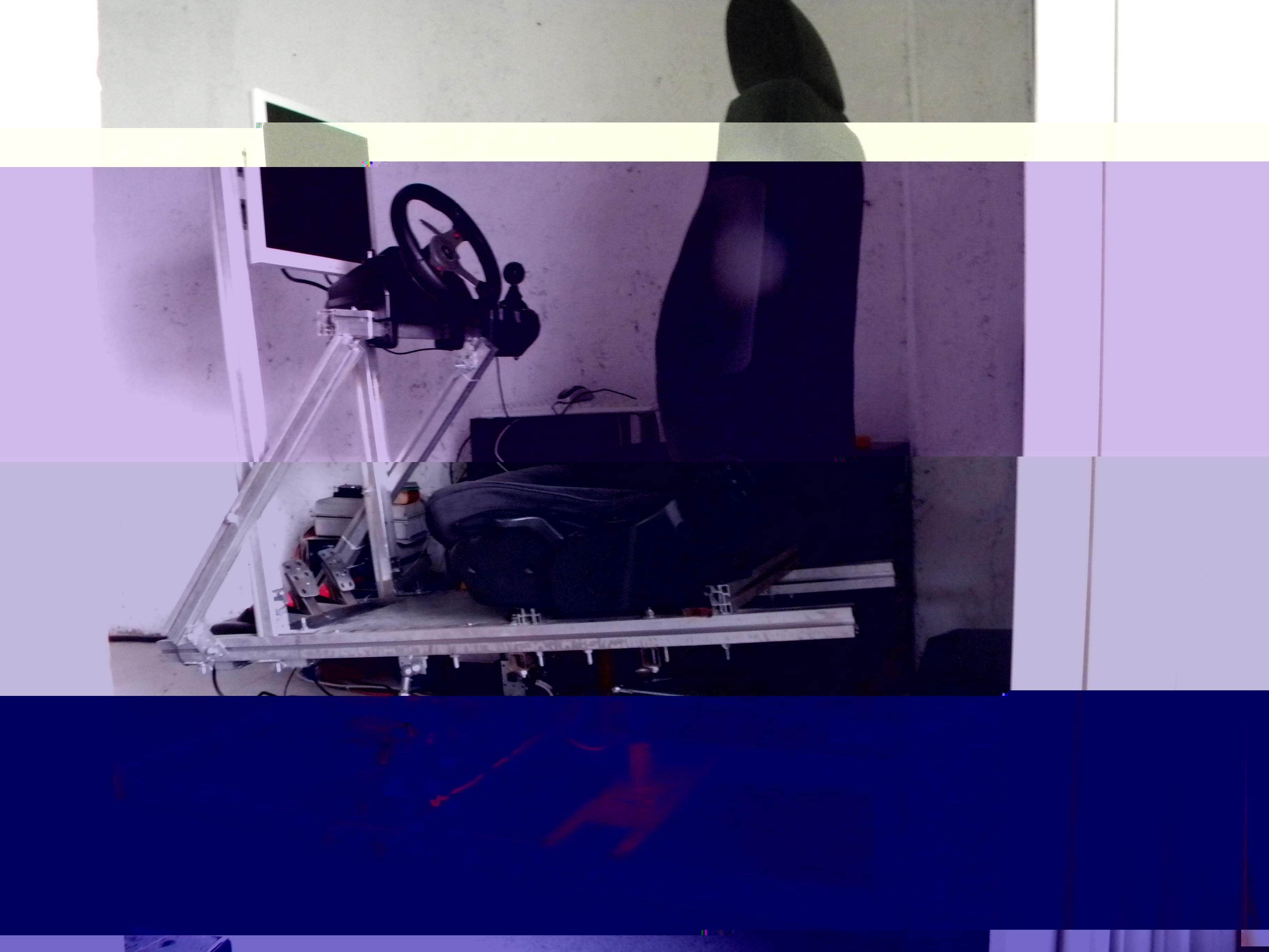

Hello,
I did it in a similar way, but looks not so nice as yours. As I have wiper, I needed to make some extensions. I've gone to the turner, to drill a hole into the wiper's gear. There's a thread in the hole and I glued into a bolt. So now, I have an extra axis at the back of the wiper, to drive my pot.

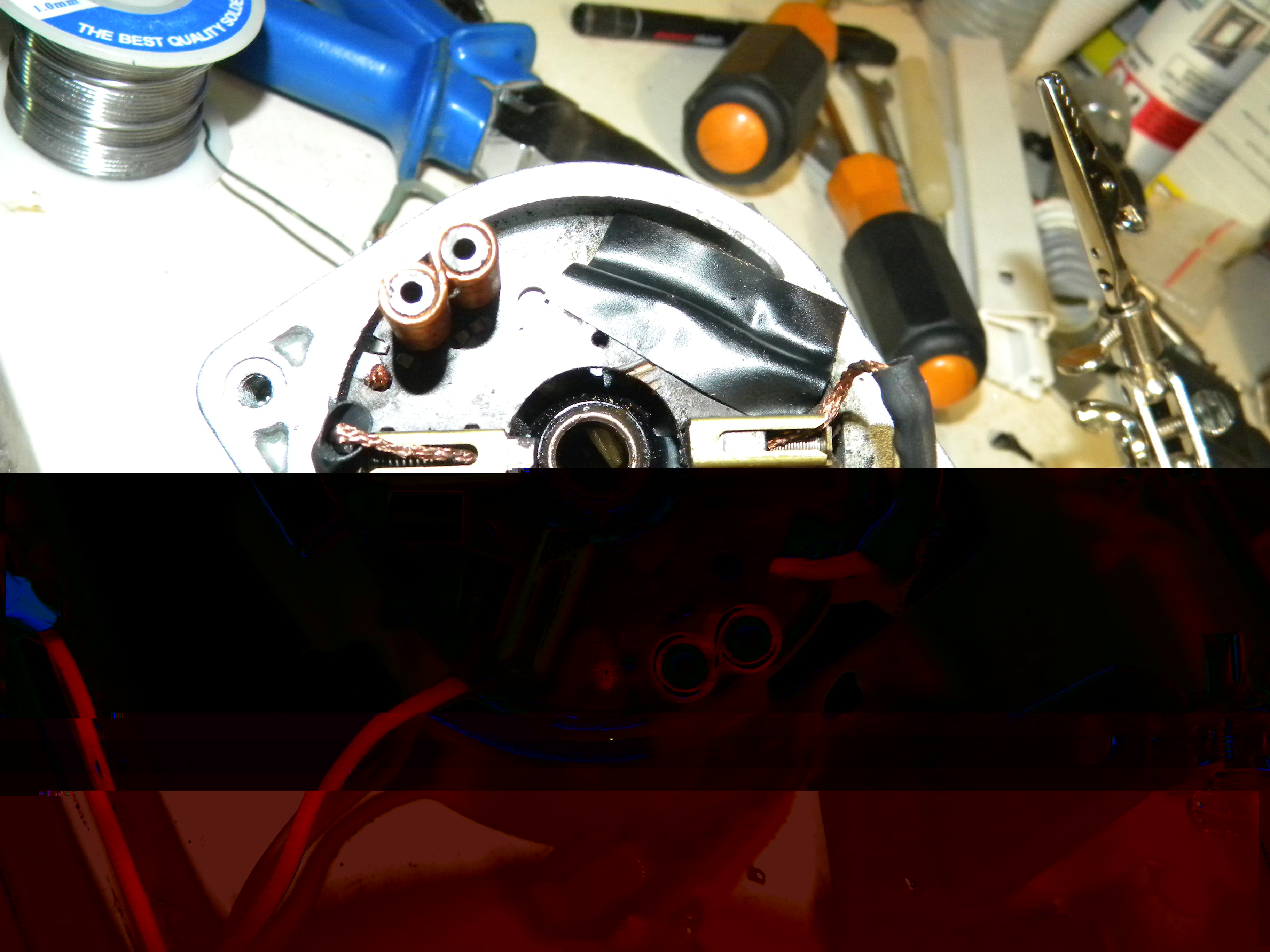

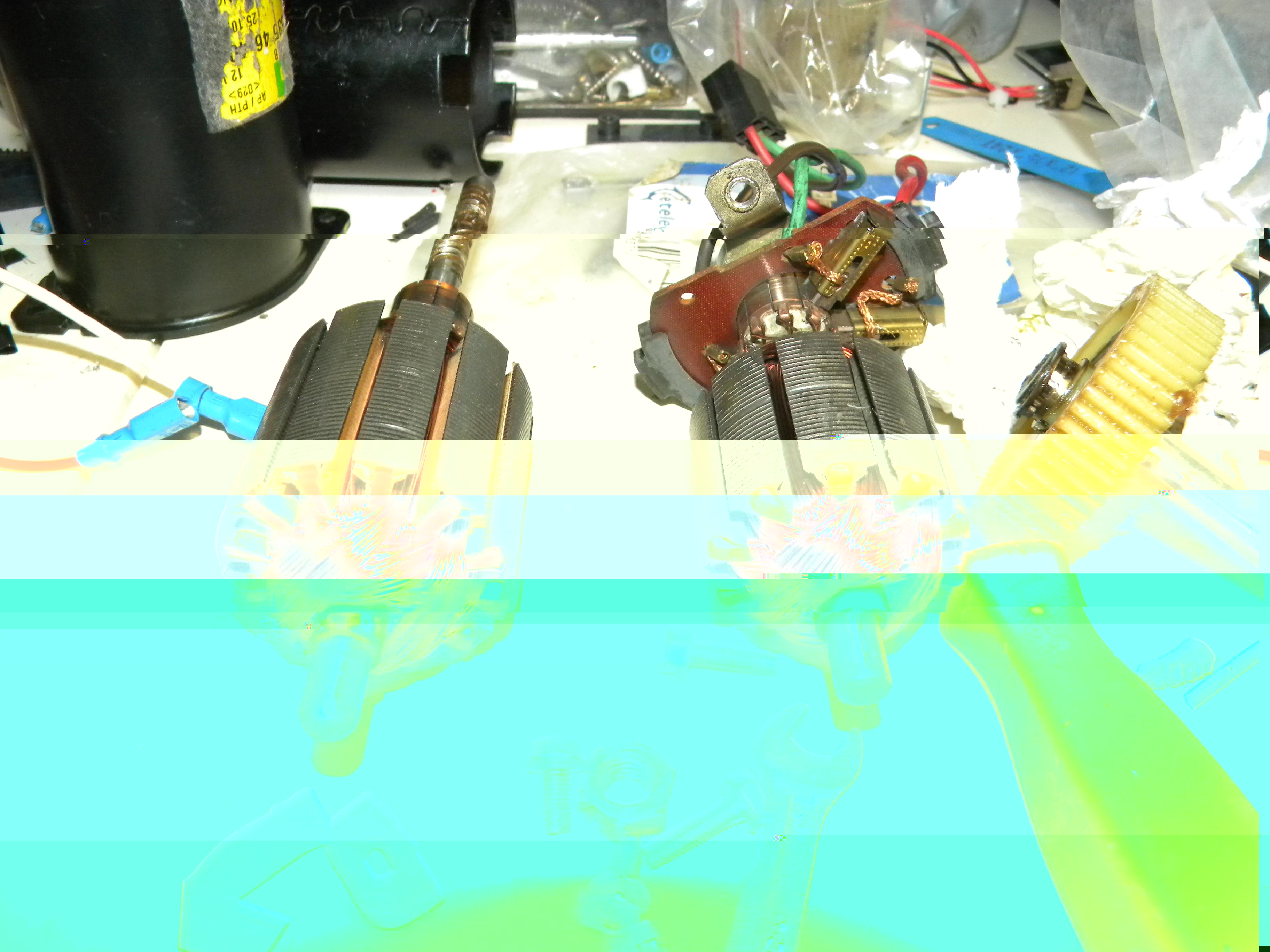

Postby micma80 » Sat 18. Jan 2014, 19:10
hi all,
new engine, I replaced the old that is broken. I modified the wiper motor, removing the ground connection, connected to the brushes you need and reassembled the whole thing (ps if you happen excludes inductors and the rest, directly connected to the brushes, because the power is PWM)
old and new engine, the newest and largest (VALEO 579151 - 1993 to 2002 peugeot 306)
change brushes, no grounding
engine ready
installed

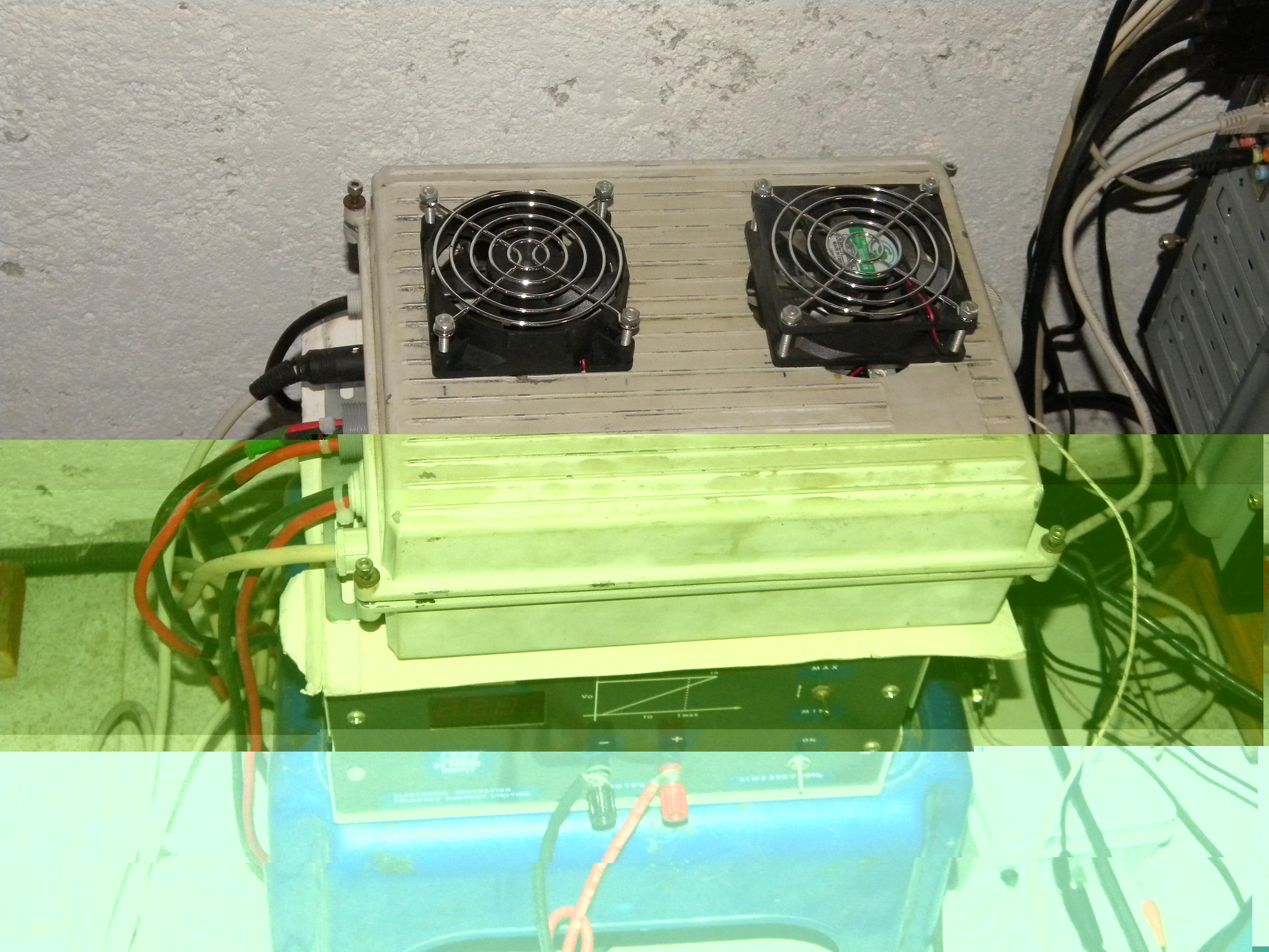

Postby micma80 » Sat 18. Jan 2014, 19:20
new look & AMC DSMhb boxed ... SIM again ready to run.
box AMC+DSMhb
box inside
SIM go go go
