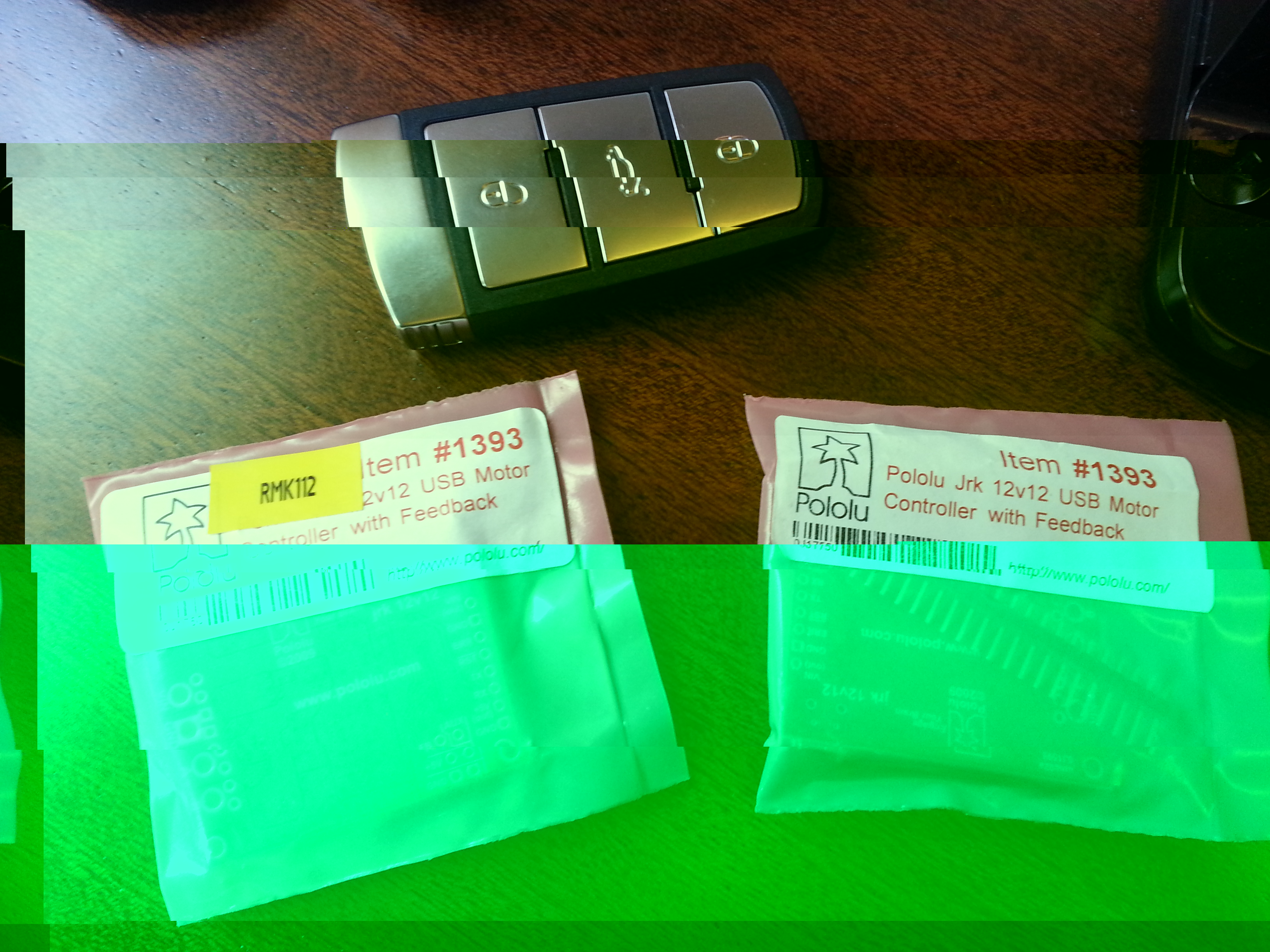

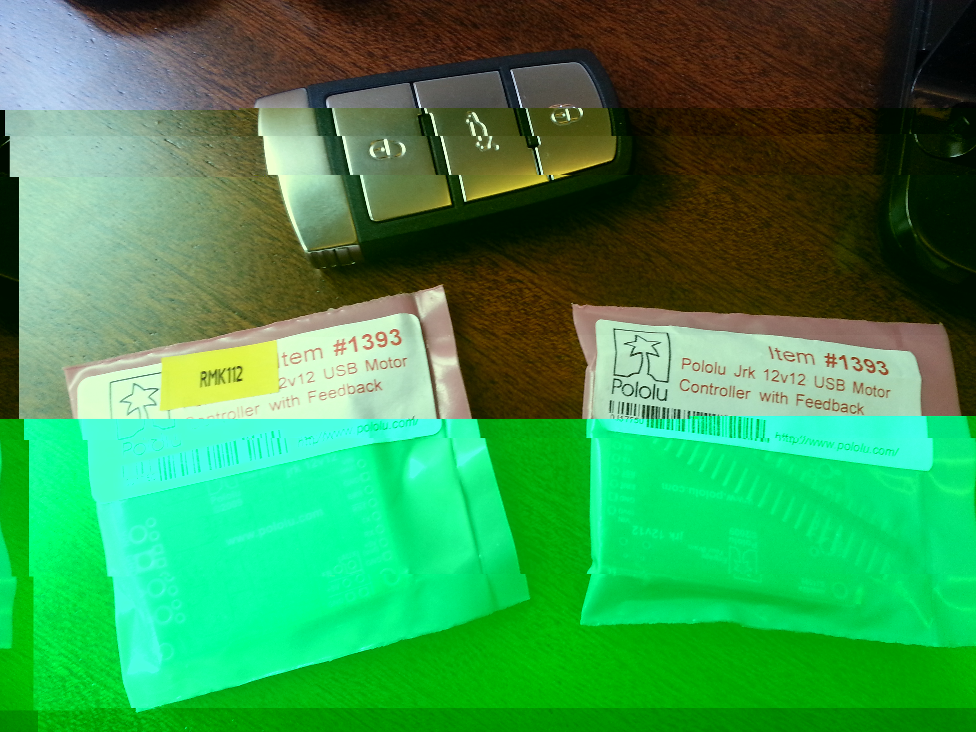

Postby nury961 » Thu 29. Nov 2012, 13:43
Today I got my pololu cards, I think I bought the last 2 cards in Turkey, because I called maybe 10 dealer but they didnt have this card, last change I bought one from a person I dont know him, and the other bought from a very small dealer and asked for anothers but he said that this was the last one...
Thanks a lot !
