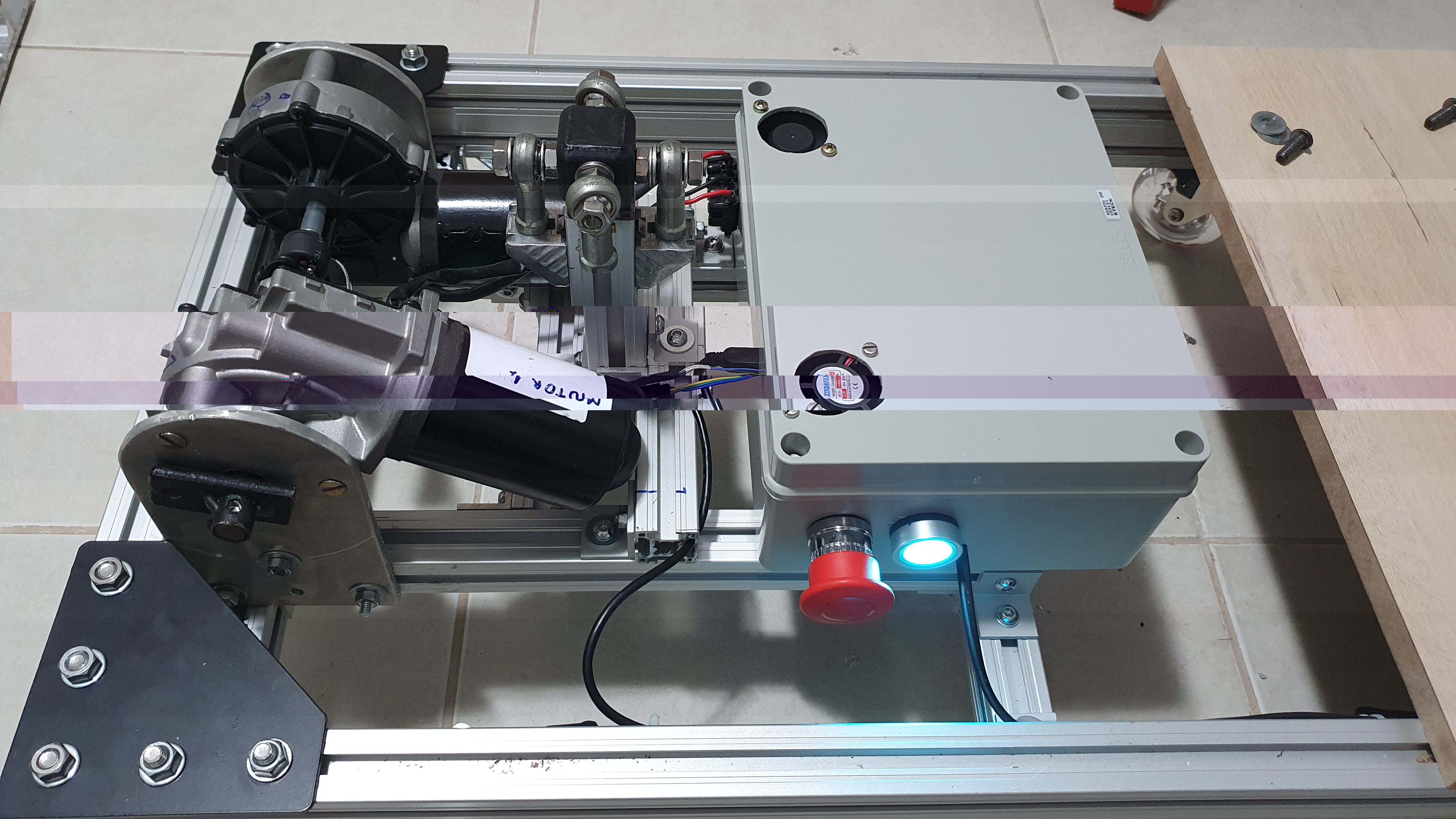

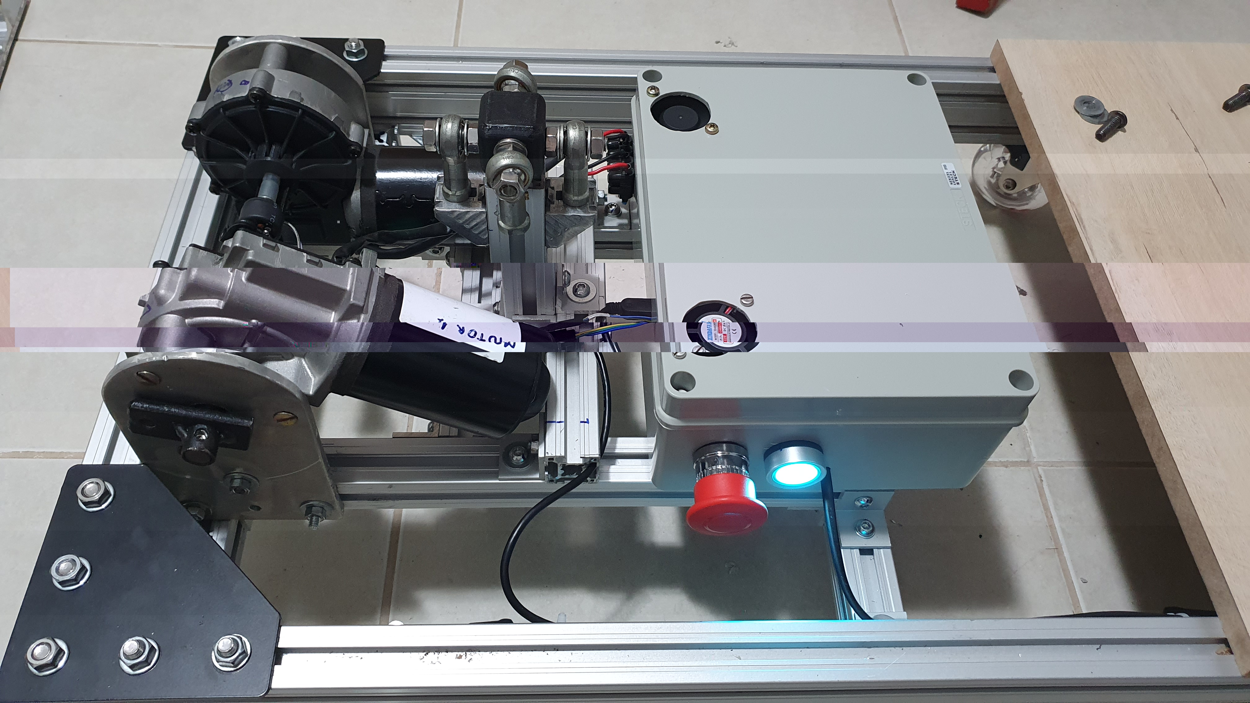

Postby johnnydb » Wed 25. Nov 2020, 21:12
Dear All,
Today I do some mods on my Rig.
Change the Joint for more strong:
Install All Eletronics on a plastic box, with coolers, Emergency button and "power light":
