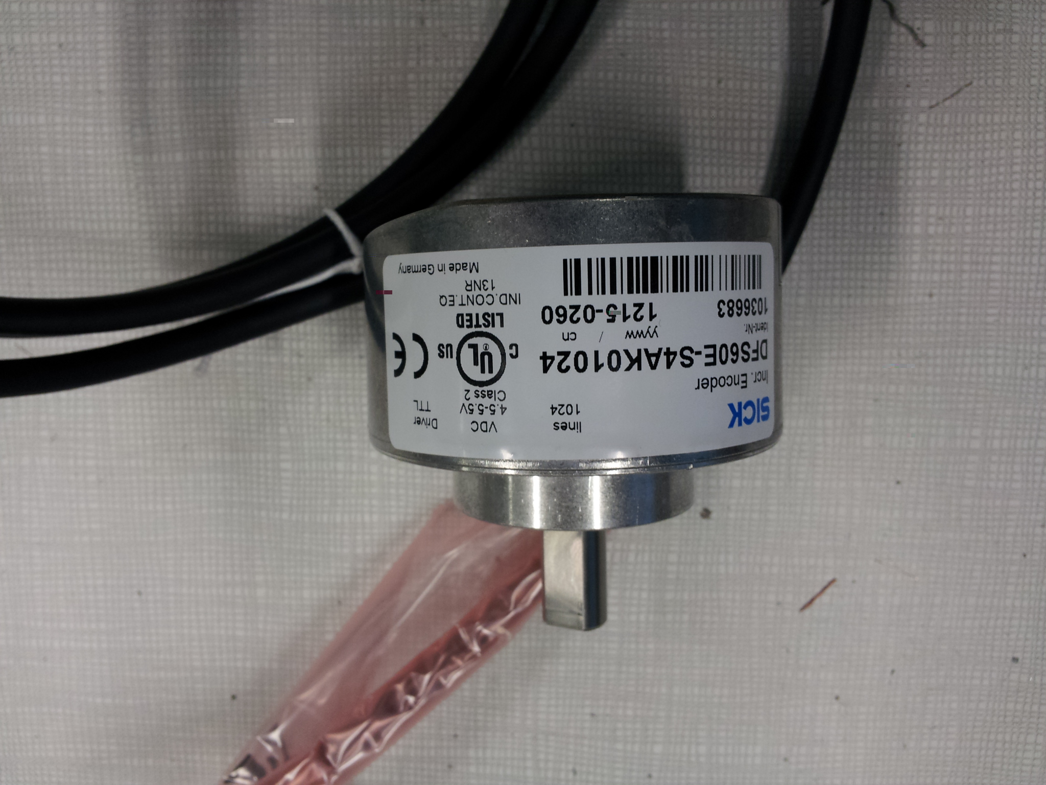

Postby Mertensbart20 » Mon 8. Oct 2012, 21:45

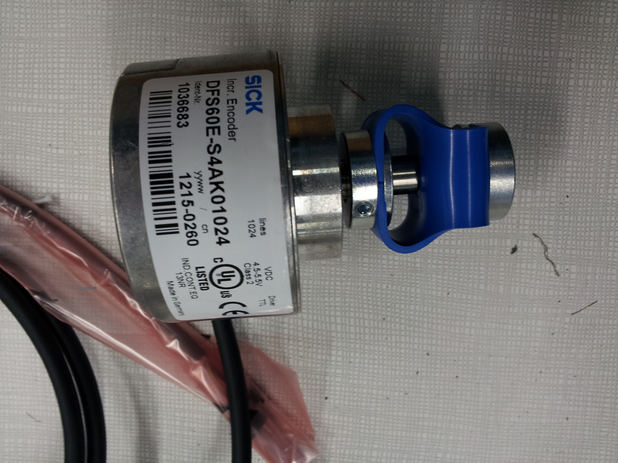

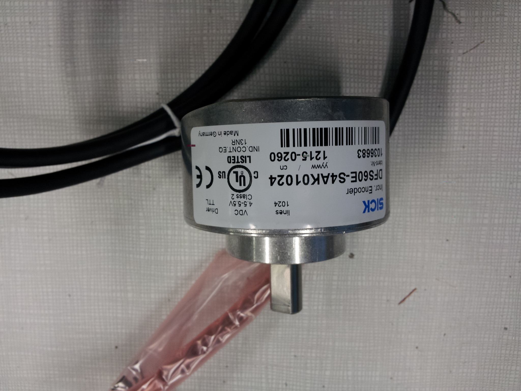

Hello everybody,

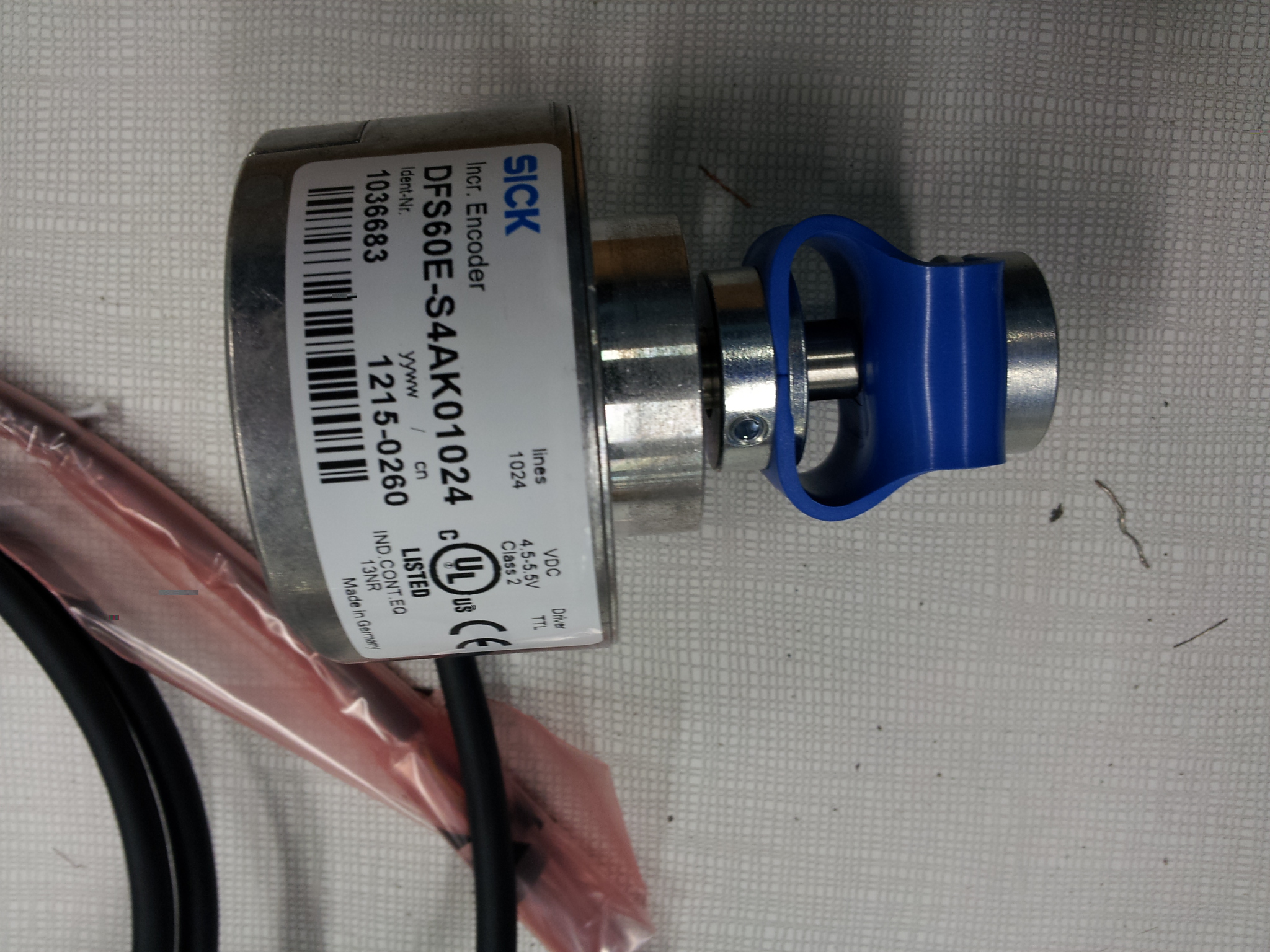

Quick update about the encoders. These are two industrial Sick incremental rotary encoders (including couplings) with following signals:
- 1024 pulses per revolution
- A, B and Z signal
- 5V pulses
- more information can be found in de datasheet I included
- price: 109 euro's a piece
With the right encodermodule you can get 4084 positions per revolution. For our simulator this means that we can measure the position of the platform up to 0,0225 degrees accurately. I hope the students can finish their holders soon en couple them to the motors. Once there we can start testing the movement of the motors.
In the meanwhile the woodshop has started sawing al the pieces for the cockpit that will be mounted on the platform.
Greetings,
Bart
online_data_sheet_DFS60E-S4EK01024_en_20120924_1433.pdf
(555.35 KiB) Downloaded 1102 times

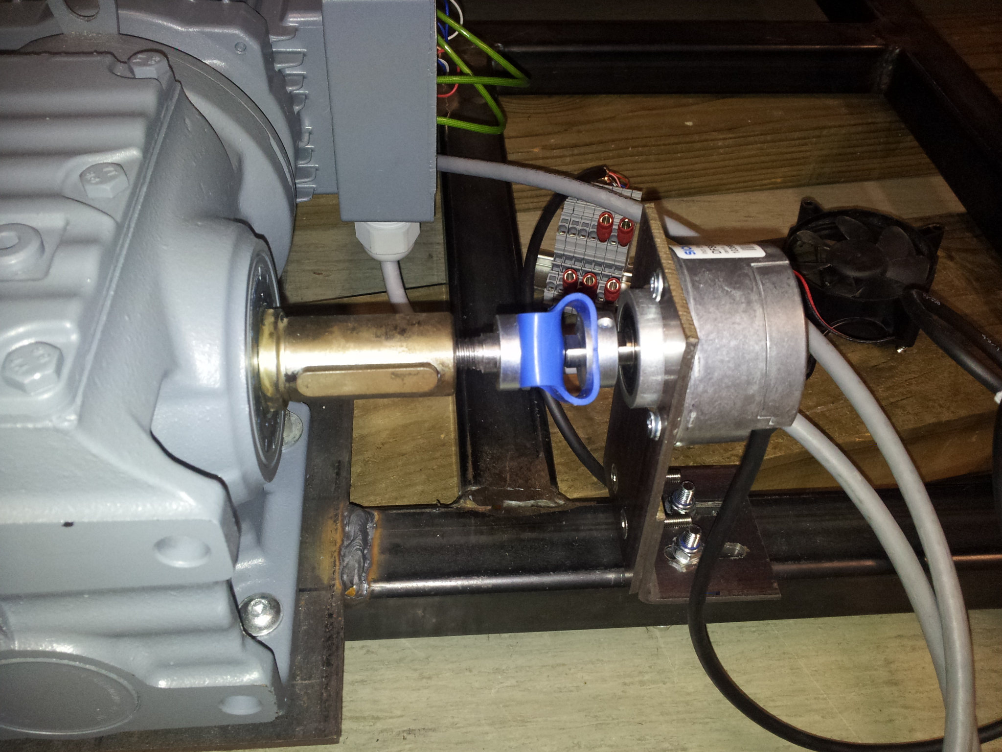

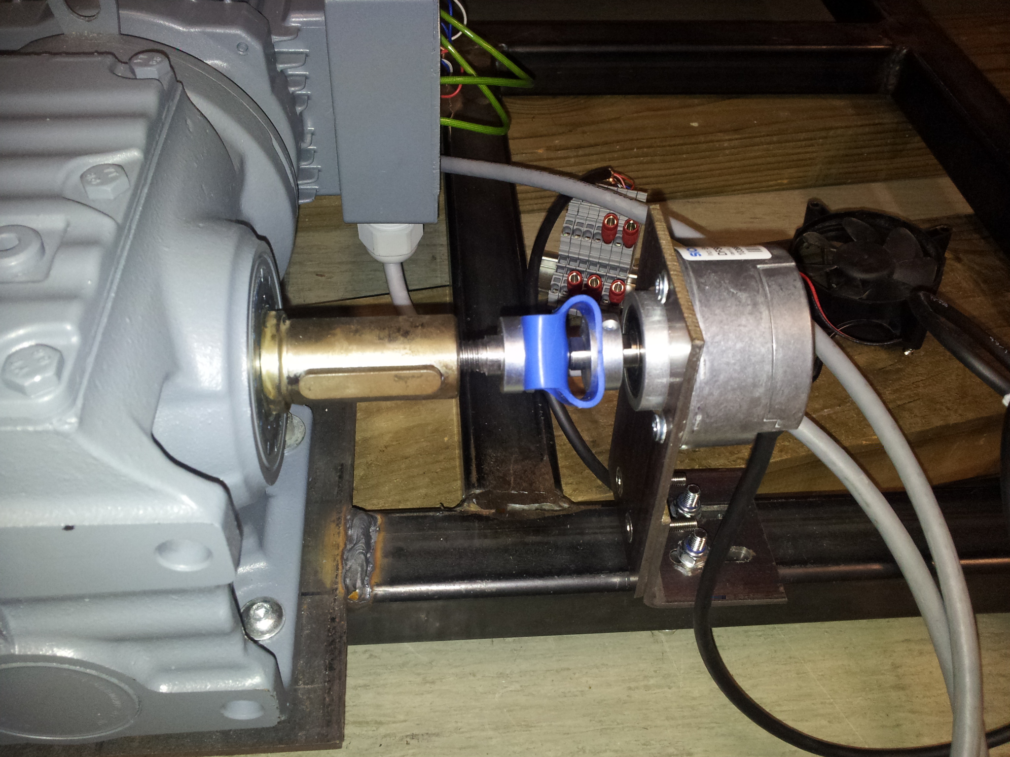

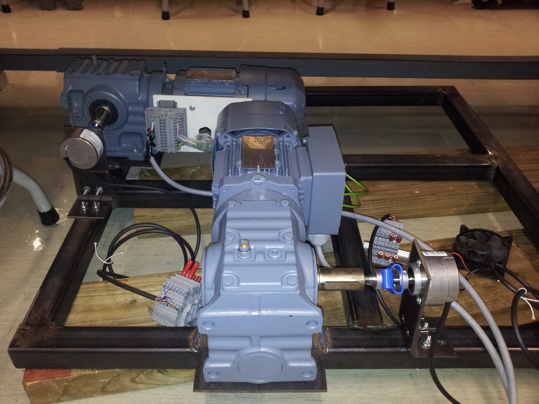

Postby Mertensbart20 » Sun 20. Jan 2013, 00:31
Hello everybody,
It has taken a while but we (the students) finally made good progress. We coupled the encoders onto the motors as can be seen in the picture.
Now testing can begin. Plans are to have a working simulator by the beginning of march. I will keep progress up to date.
Greetings,
Bart

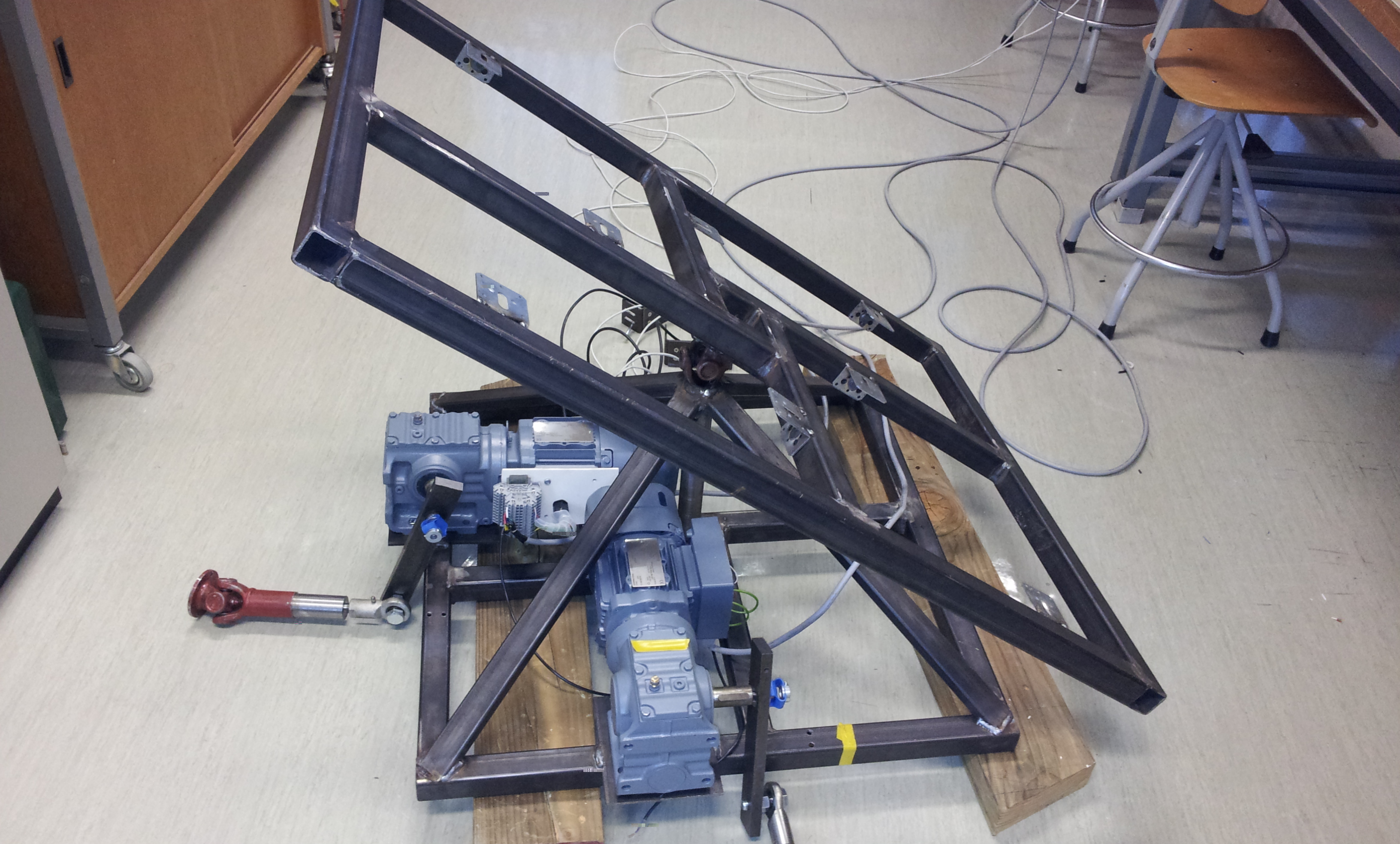

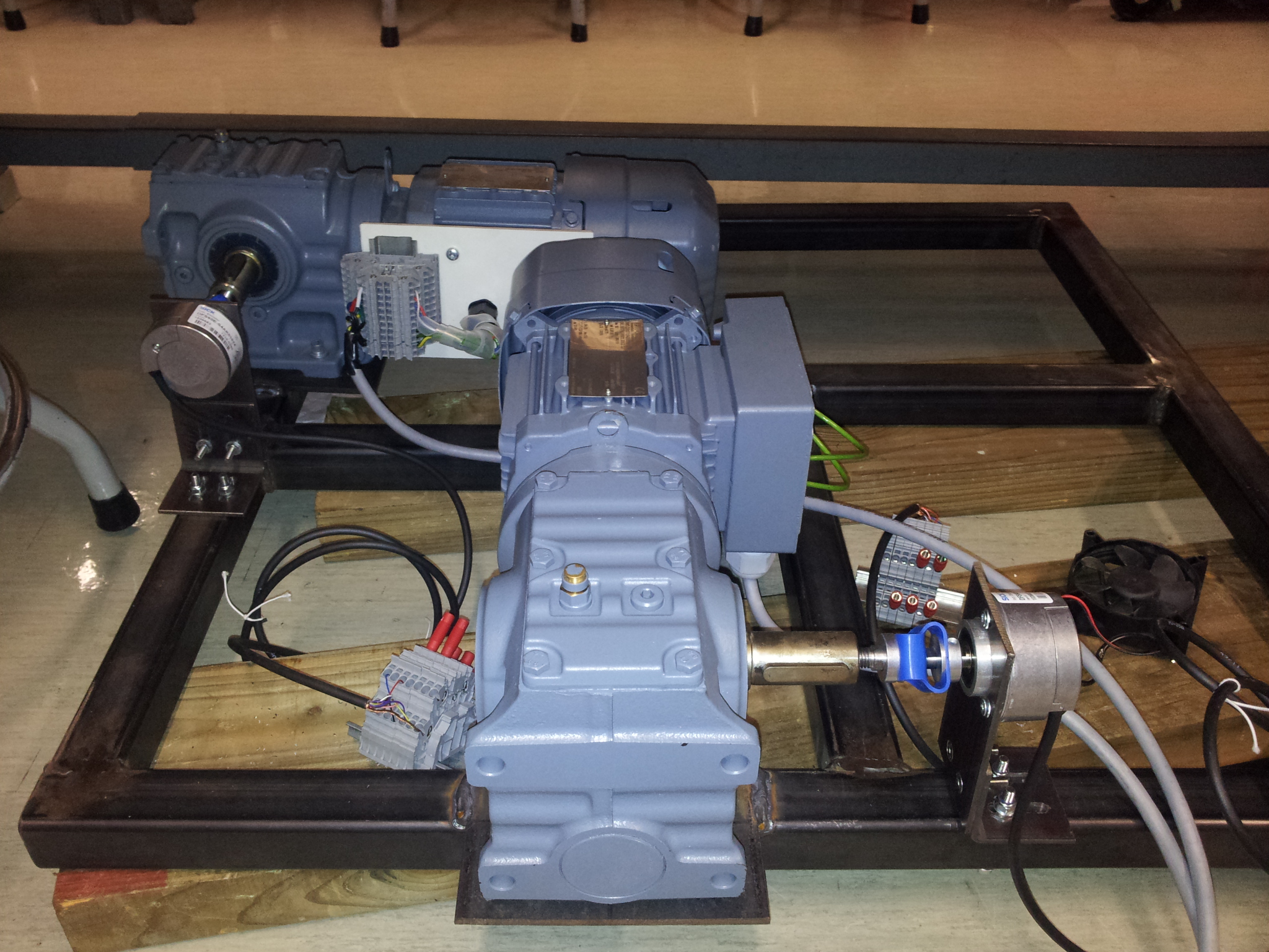

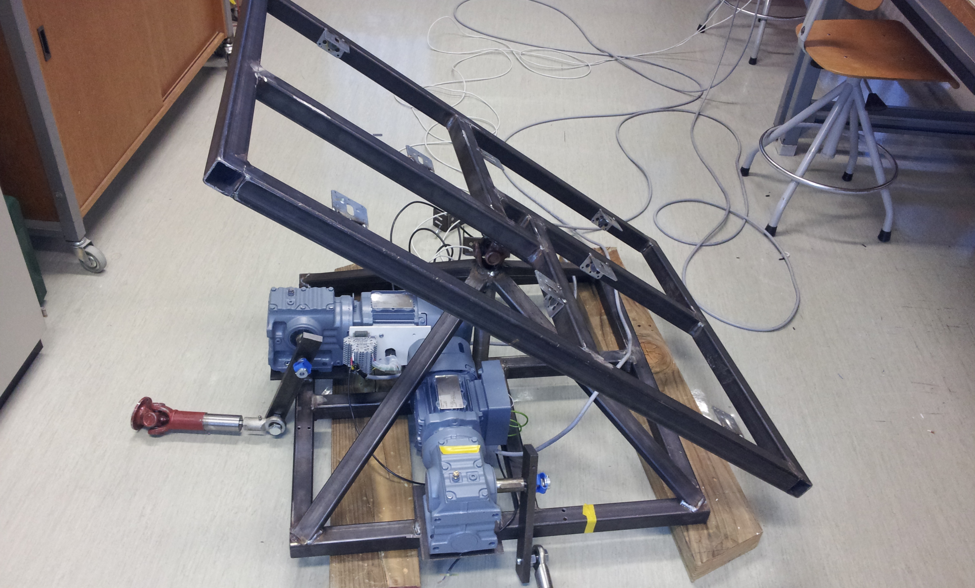

Postby Mertensbart20 » Fri 8. Feb 2013, 21:38
Hello everybody,
We have made some steps forward. The cockpit has been build (you can see some pictures below). Paintjob will be done soon.
The mechanical structure is almost finished. I also included some pictures. First tests should start within three weeks.
Greetings,
Bart
mechanical structure picture 1
mechanical structure picture 2
mechanical structure picture 3
cockpit picture 1
cockpit picture 2
cockpit picture 3

Re: 2DOF simulator based on CKAS Thruxim
Postby vicpopo » Fri 8. Feb 2013, 22:20
It looks really like CKAS 2DOF.Same frame , same motor manufacterer...
Impatient to watch it in motion.

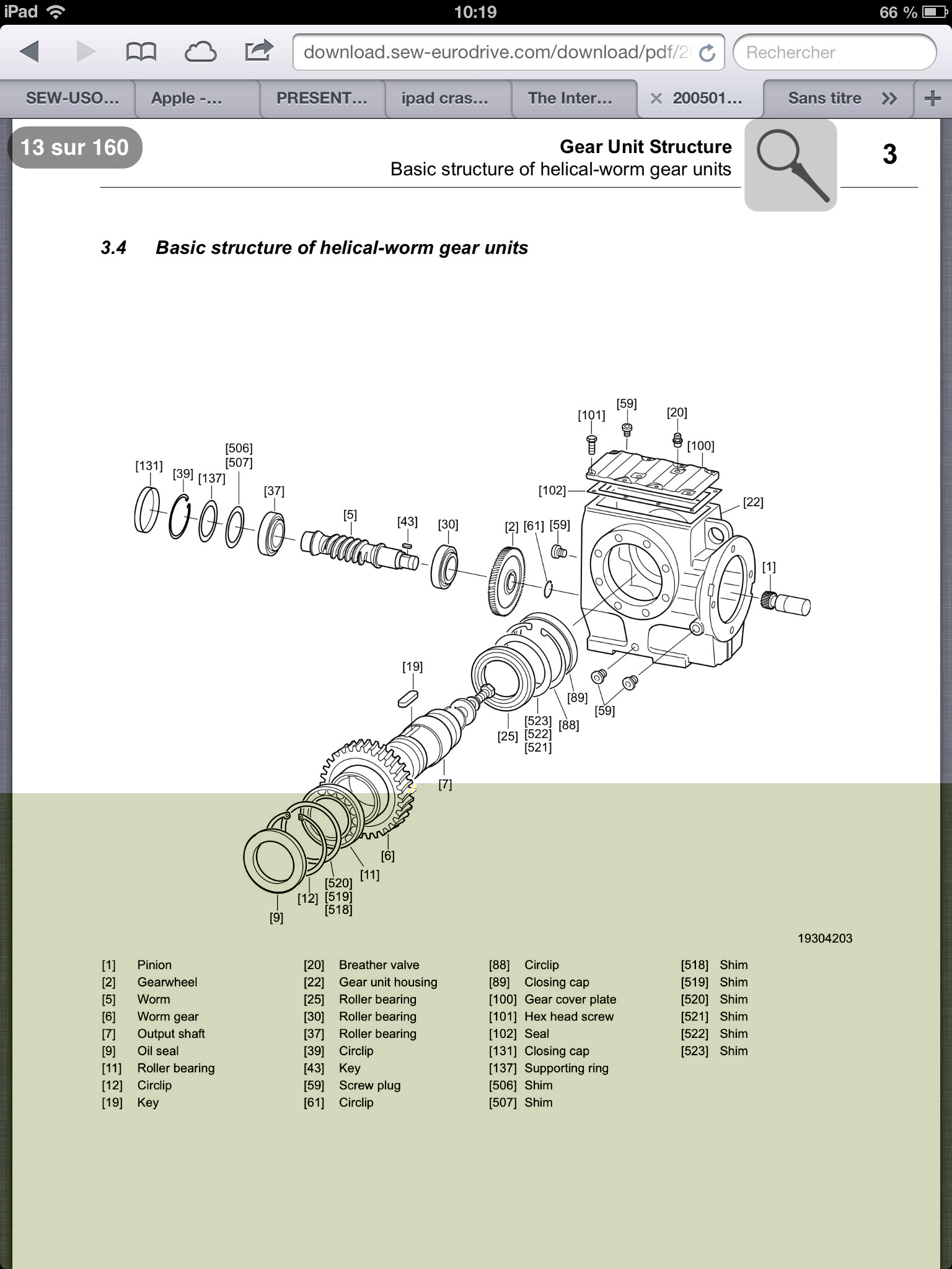

Postby vicpopo » Sat 9. Feb 2013, 10:14
Hi ,

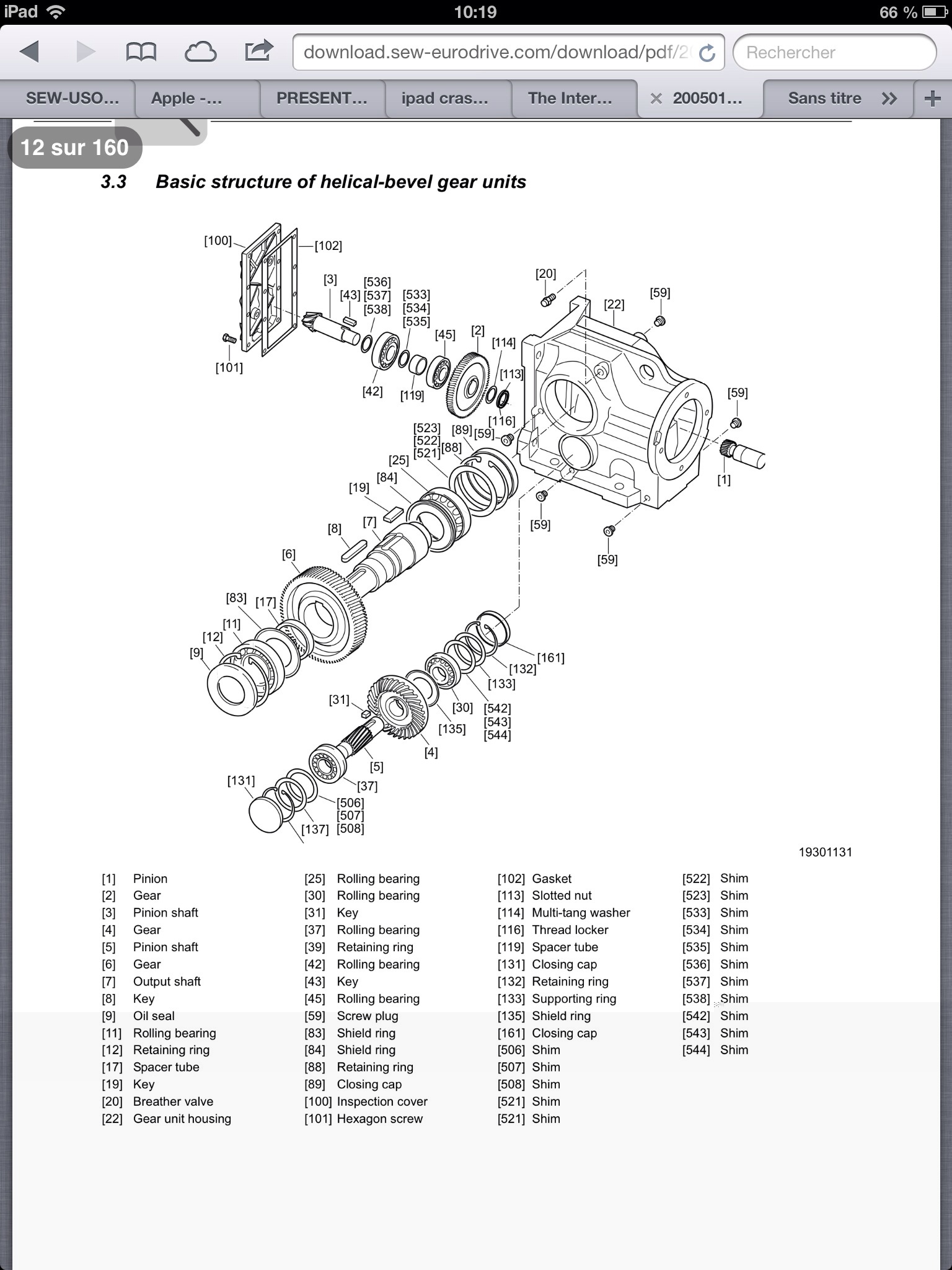

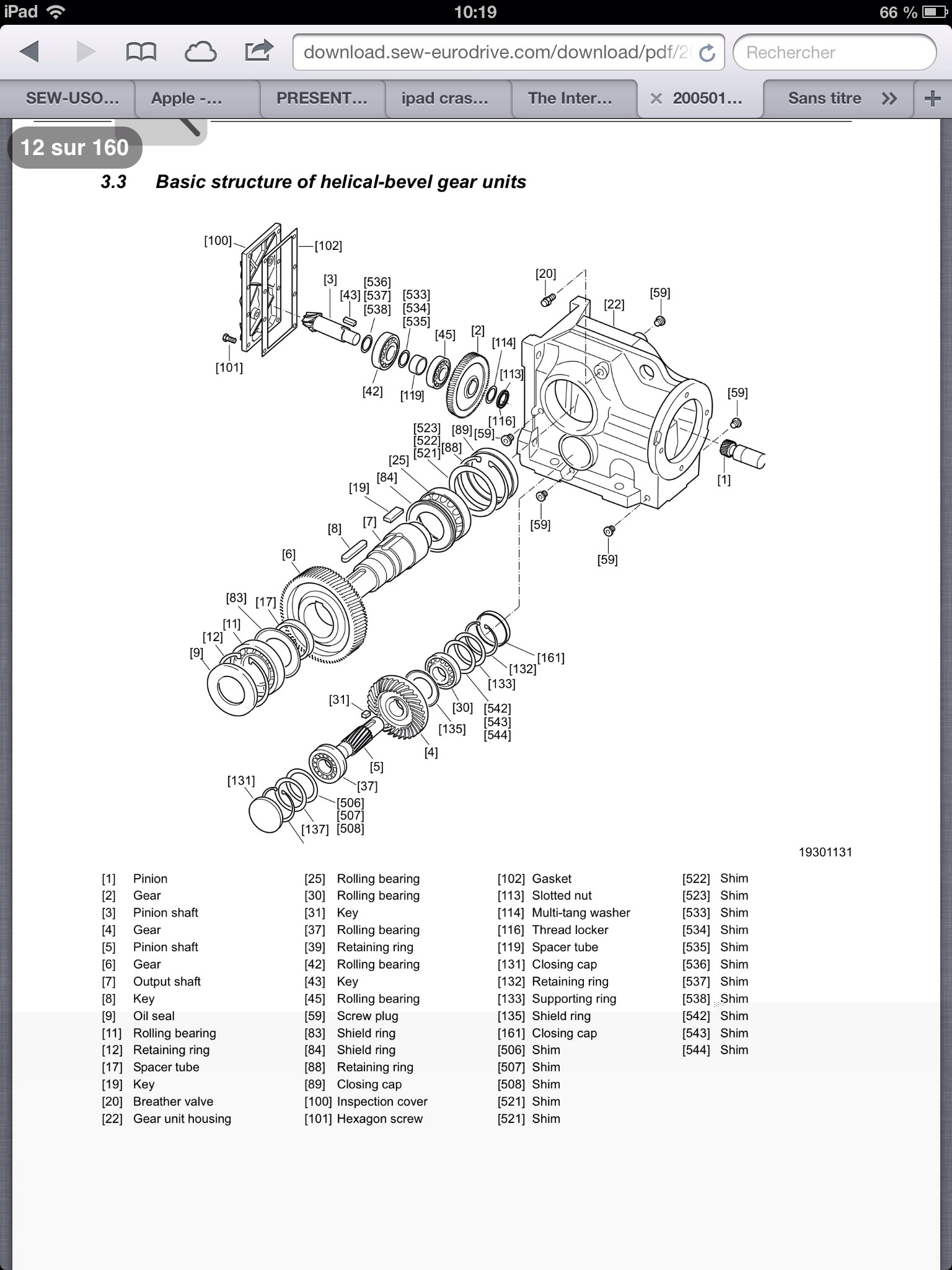

Yes you're right for the Thruxim that is helical gear box type R27 or R37 .
But with Ckas new 6 dof plateform " low cost " there are not the same gearbox as you that is helical-bevel gearbox unit.
When you look at the technical specification for the same power wanted (0,25 kW for example) with the the same gear ratio ( output shaft gearbox 12rpm) you've got the same amazing torque (between 150 and 180 Nm).
The efficiency is a little better with helical gear units but the torque is the same.
The big advantage for the helical bevel is the space you can win with the output shaft at 90° to the motor shaft.the design is compact and all the motors are under the plateform, nothing go outside from the lift plateform ( security advantage also).
And the last advantage is that the use a hollow shaft.One side there is the arm to lift the plateform and the other side you find the angle encoder .This solution is compact (room saved) and 100 % safe for the encoder.

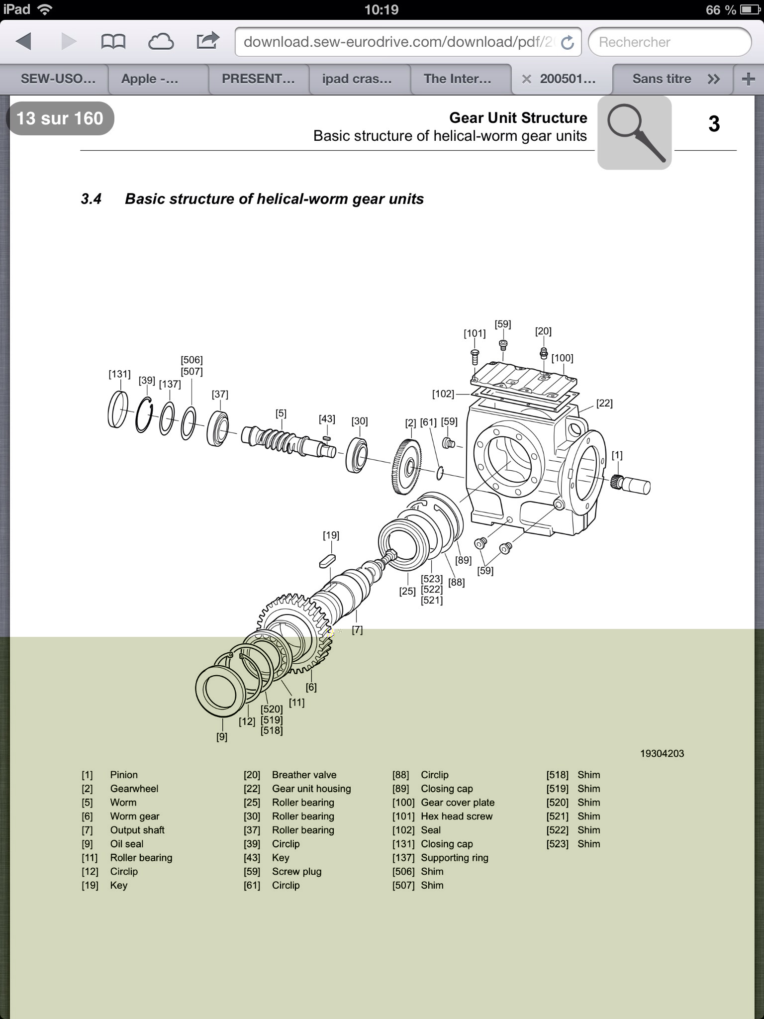

Edit : I don't really saw your gearbox is it a helical bevel gearunit or helical-worm gear units?
Seems to be helical worm gear units.
The helical worm gear unit is possible also but with less efficiency.
Edit :
Helical gear units
Helical
Helical bevel
Helical bevel
Helical worm
Helical worm
