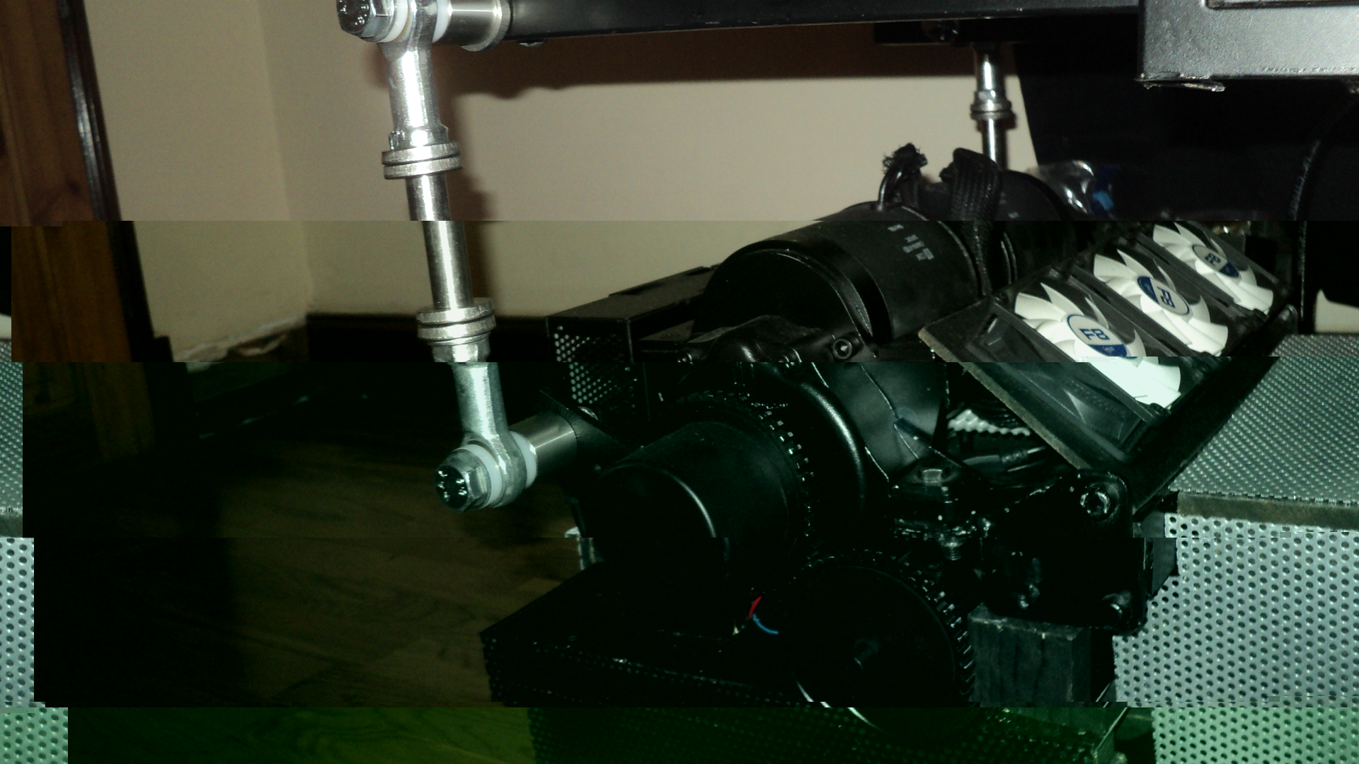

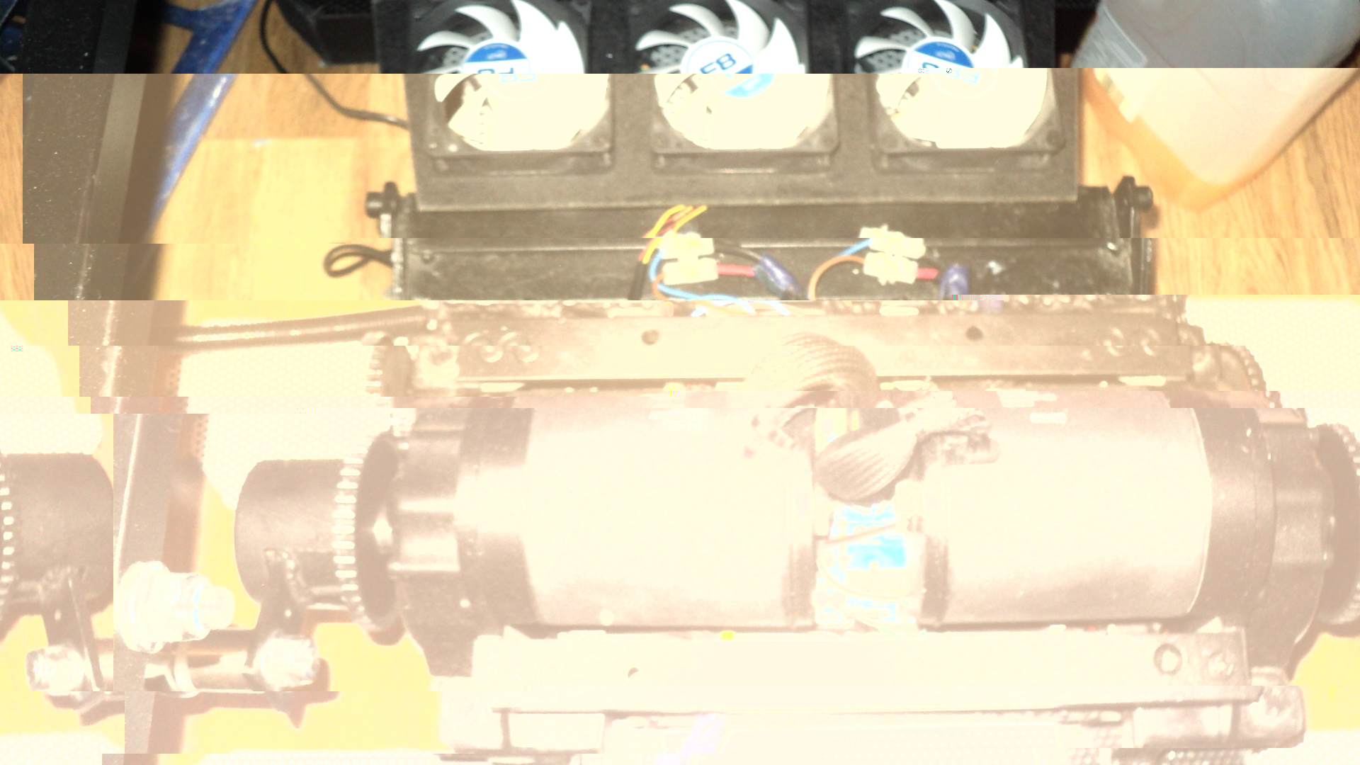

Postby kokopelli » Wed 3. May 2017, 21:10
3x 80mm cooling fans.

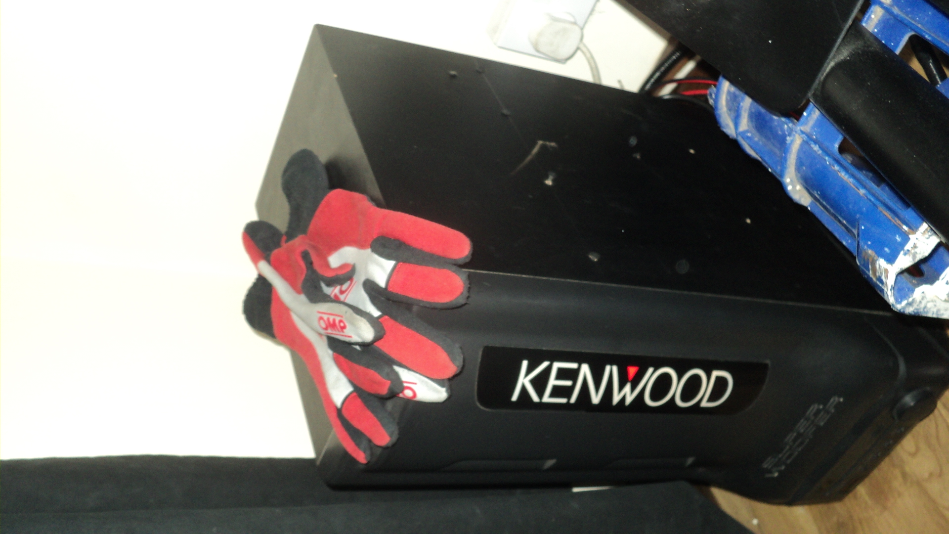

Postby kokopelli » Wed 3. May 2017, 21:25
2x buttkickers under the seat, you can just about see em. To power the buttkickers i using a old subwoofer. Simply disconnect the subwoofers speakers, and replace them with the buttkickers. I am lucky because the old subwoofer is one with lots of different presets and modes, so the buttkickers benefit from that, plus its a chaep way to run them.

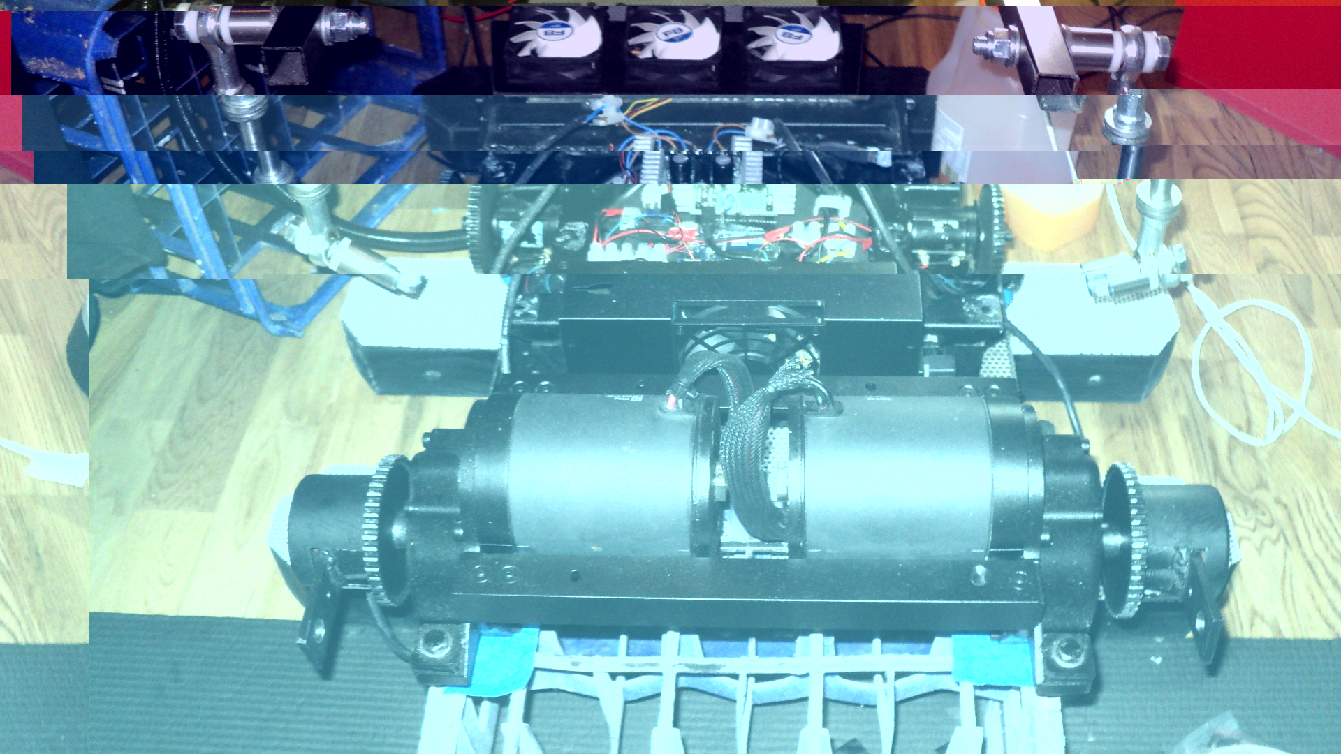

Postby kokopelli » Wed 3. May 2017, 21:33
but its time for X-Sim to get this party started. Got my test bed sorted, (see pic's), back soon.....
