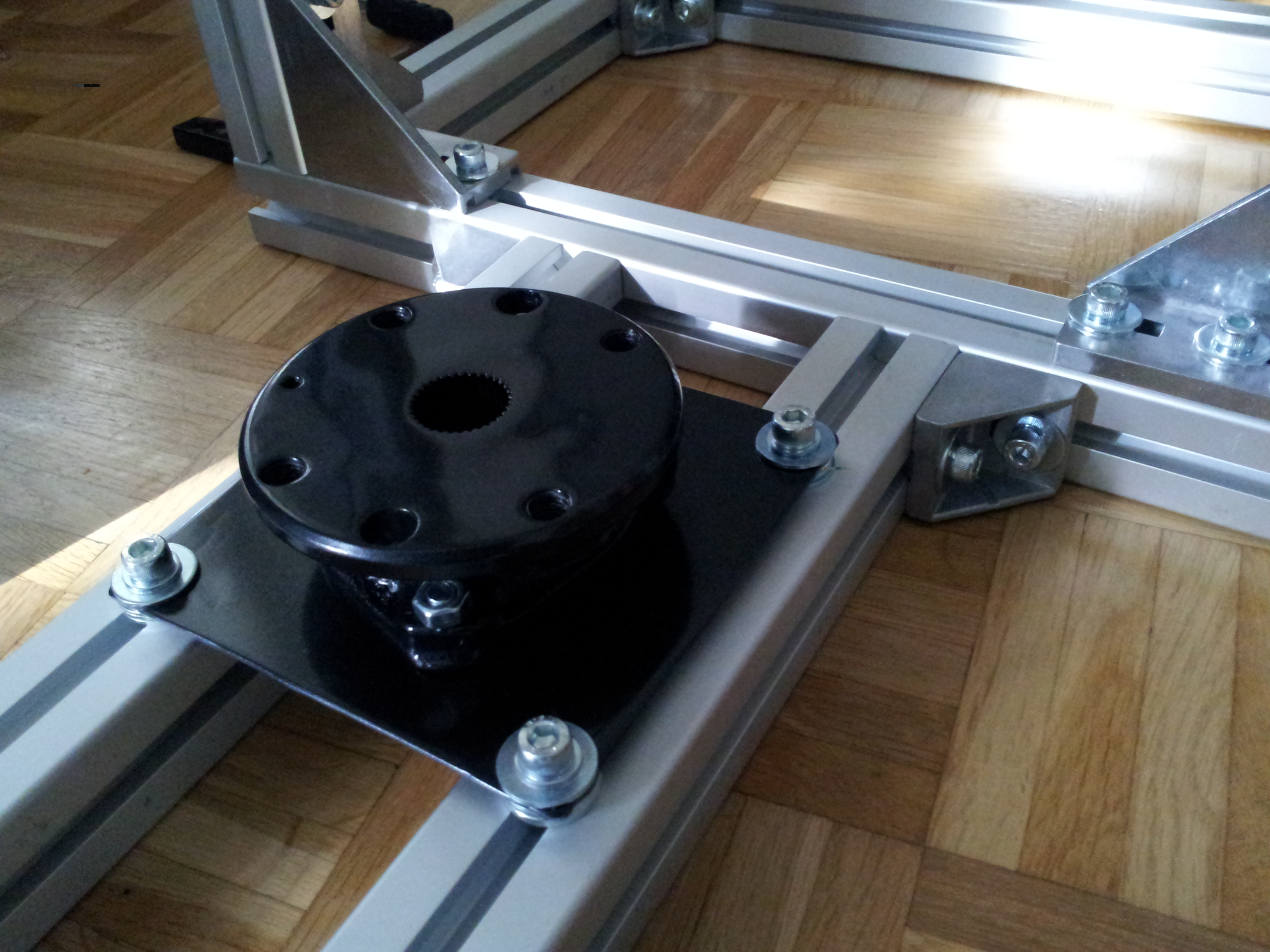

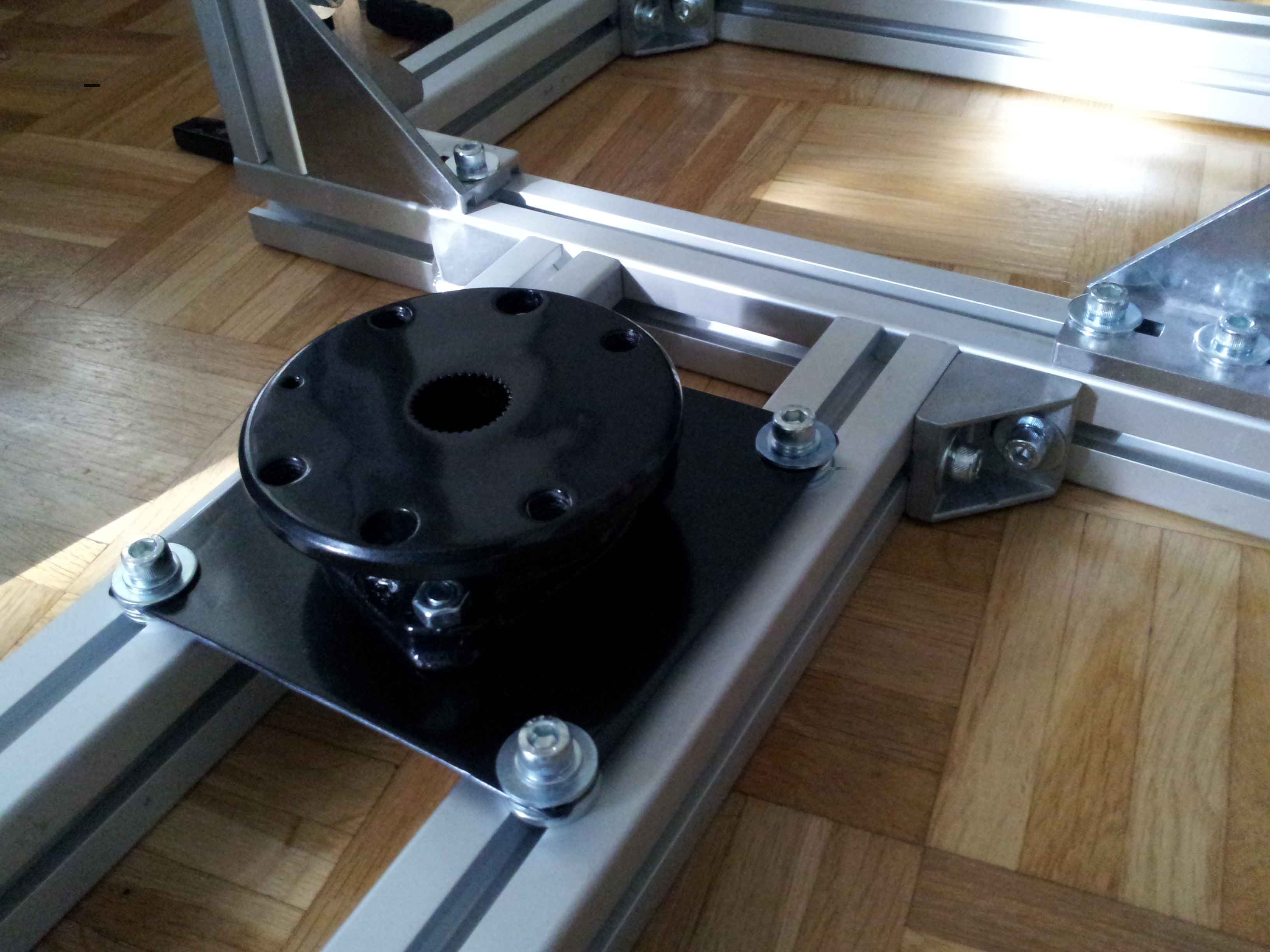

Postby yokoyoko » Thu 20. Sep 2012, 16:46
Preview:
Guess what's comming next... I will post here as soon as ready.
Re: 2 DOF Wiper-Sim + Pololu problems
Postby yokoyoko » Thu 20. Sep 2012, 18:21
Hi BobBuilt - you are correct. As first price I can offer you a grilled Jrk :lol:
The existing Sim will be slightly modified and more framework will be added. This will be attached to the frame you can see on the picture on prev post. The unit in the front of the TV-bracket is a front wheel bearing of a Opel (Vauxhaul) Astra G which I changed to my desires.
The existing sim will be mounted on this wheelbearing. At the end of the sim I will use a "kind of linear unit" with the radius of the "leverarm" (1,60m) for very easy movement and up to 1600N of forceresisting... also plates of PTFE (delrin stuff) will be used - hope everything will work. I ordered a third 12v12 and another Wiper for first try. But I have also ordered 3 piece - 25:1 gearworm motors like Floris uses and another Power supply for the next stage up.
The angle of movement is set to ~9° for first tries. This will give me ~30cm movement at the end of sim - or ~25cm where I sit. I desinged and calculated everything in Dassaults Catia and there everything is fine (FEM; kinematics; co).
Sorry for the short explain but this time(!!!) I document every step very detailed with pictures and will post when everything is ready.
Best regards
yoko
